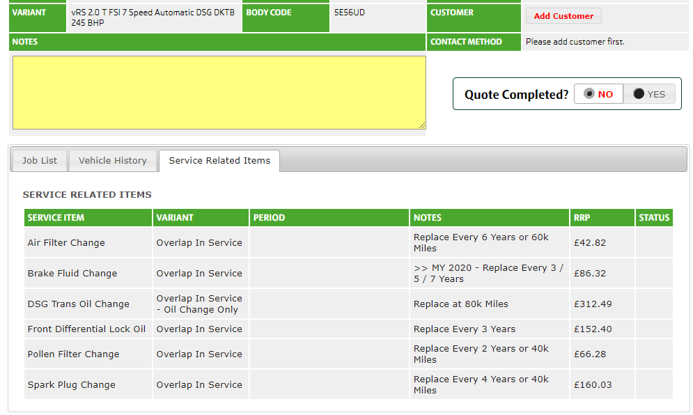

    @hawkx617 - sorry, I'm wrong! I just checked back through my records and I didn't get the diff oil changed at point of sale. It had been done 2 years prior, so wasn't due. Sorry. I did buy the car from a Skoda dealer and had to push hard to get things done as part of the pre-sales prep. I managed to get a DSG service, plugs, brake fluid and air filter done before sale - but getting a detailed service history out them was like getting blood from a stone. Their terminology and service intervals for servicing are really confusing and lack detail, and I get the feeling it's done this way on purpose so they can wriggle out of things as and when they need to. I may be wrong, but this has been my experience! As for whether 'final drive oil' means diff oil, I couldn't say for sure - maybe someone else can answer that? I do however have a screenshot from the service dept's system at the main dealer showing what they call it internally - which is what any normal person would also refer to it as ('Front differential lock oil') and it shows the service intervals and cost, which might be useful for you: I would suggest ringing the service department at the dealer you bought it from, and asking them. Or if they don't give you a clear answer, try another Skoda dealer who don't have skin in the game!

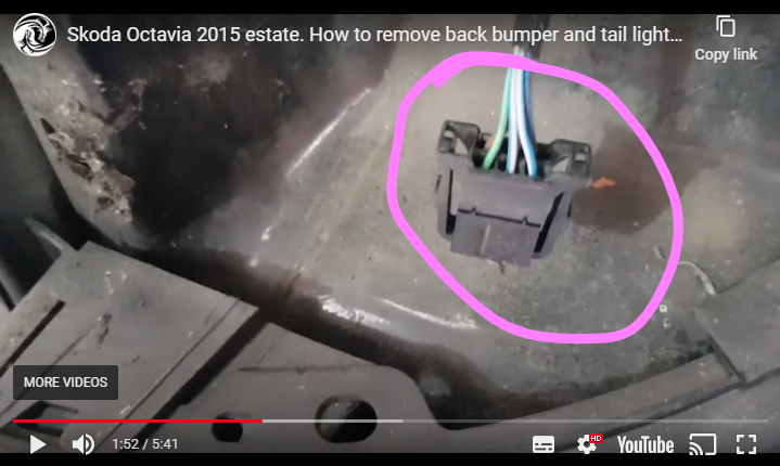

  6. Sorry to hijack the thread, but can anyone tell me the part number for this connector, or where to get one, by any chance? Previous owner must have ripped it off accidentally when they removed the tail light, as mine looks like this 🤦‍♂️: Wondering if this is what I need: https://www.skoda-parts.com/spare-part/1j0972723-flat-contact-housing-6-pin-skoda-17256.html Mine is a post facelift VRS estate with LED tail lights. Any suggestions very much appreciated!
