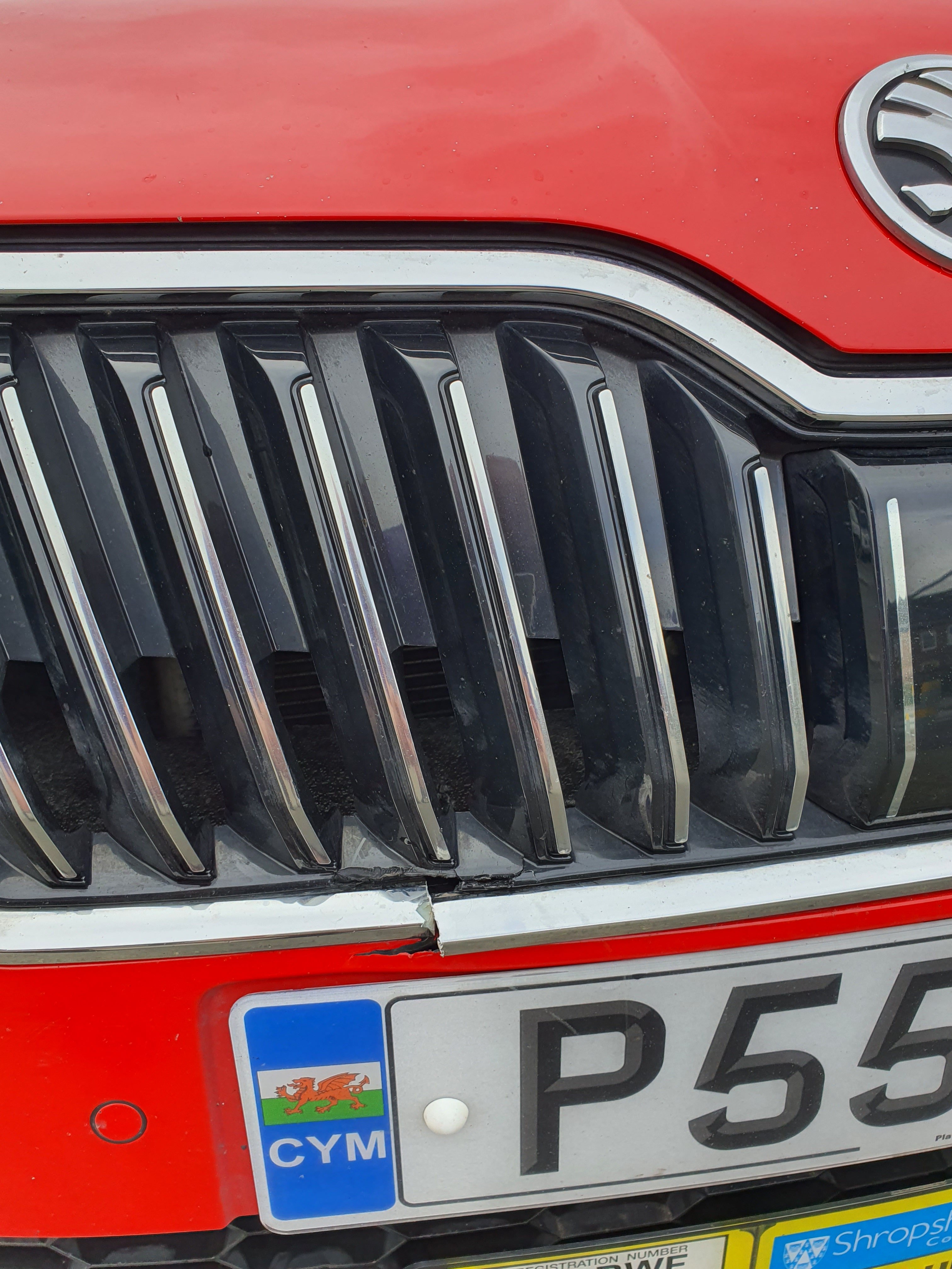

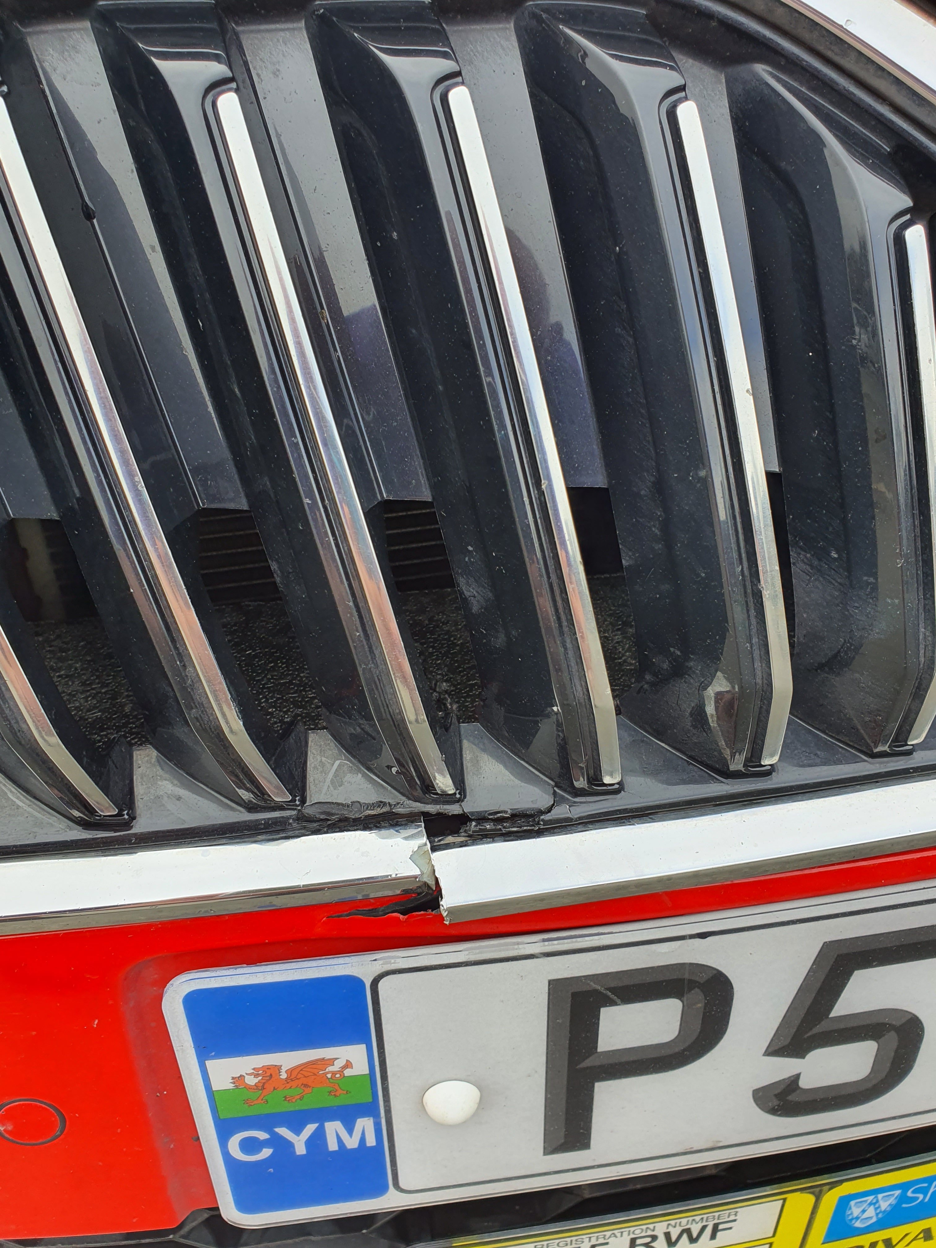

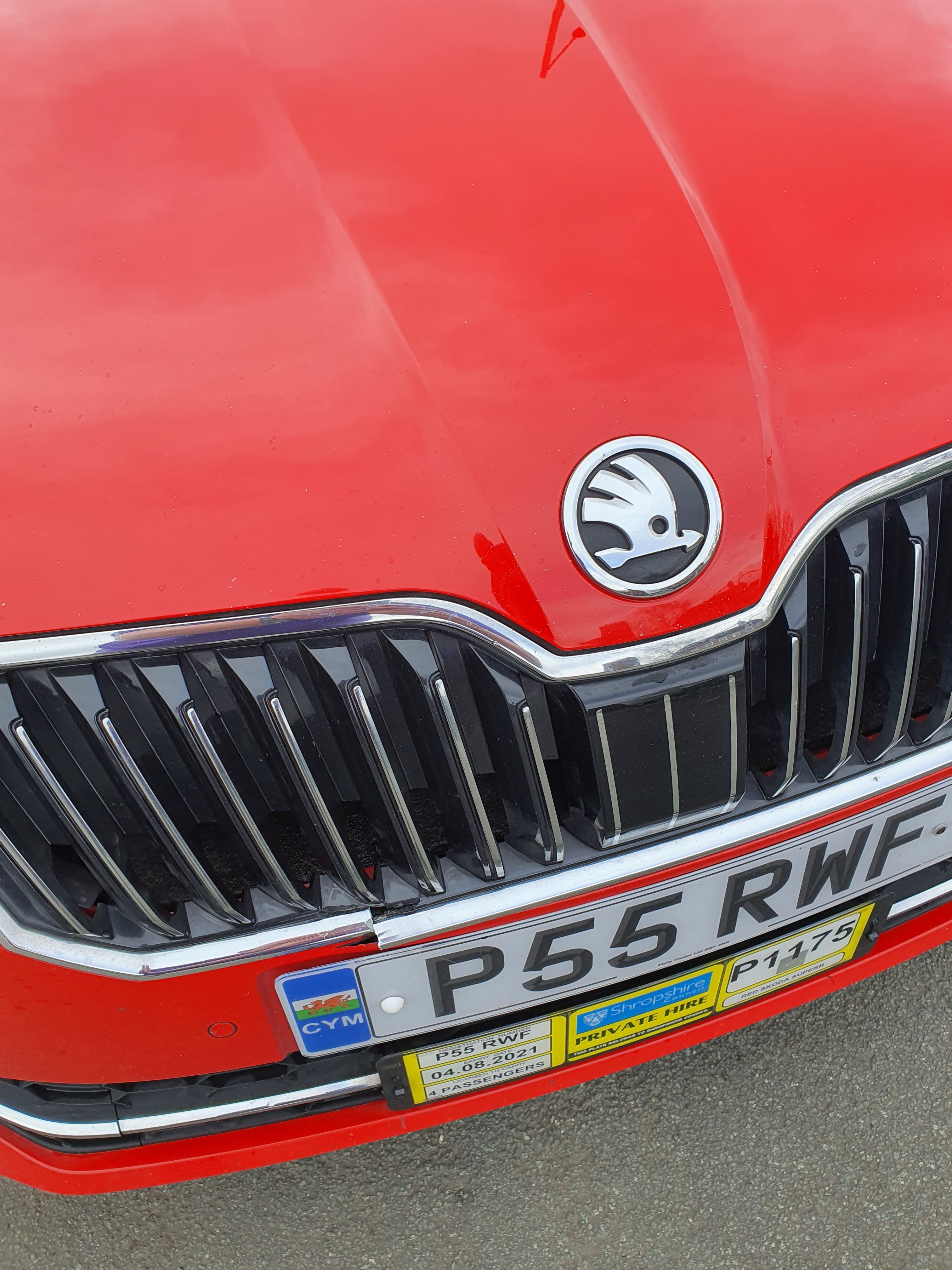

  10. Hello again been a while. Need help please, is it possible to remove the front radiator grill and chrome surround without taking the bumper off? I hit a pheasant and it's damaged the grill and I'm trying to to a cheap repair. Been to dealers and they've quoted nearly £700 for this....
