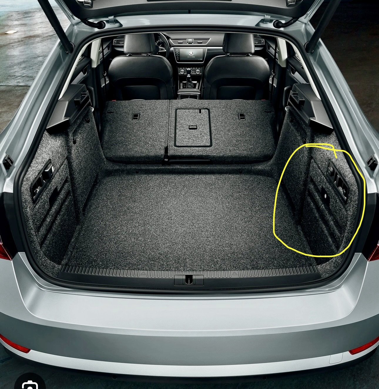

  1. Hello, I opened the trunk liner where you place first aid box and placed it horizontally using double sized tape. I did not have tools to remove bumber instead i simply stuck it above rear wheel well by opening trunk lining. Its been few months and it simply works fine.Including picture of the exact location.

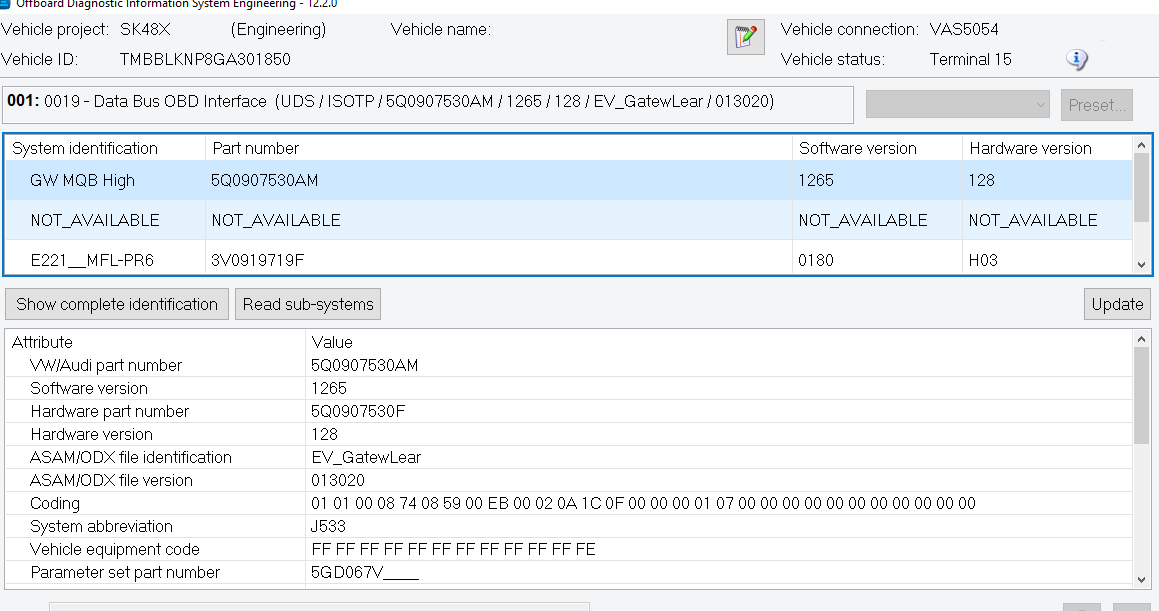

  8. Hey mate, reviving this thread...my gateway is 5Q0907530AM...with this my both drive modes and some adaptation to show VC settings on headunit are missing. I am not sure if this is due to incompatible canbus (suggested by another member who scanned my car)... Can you pls confirm?

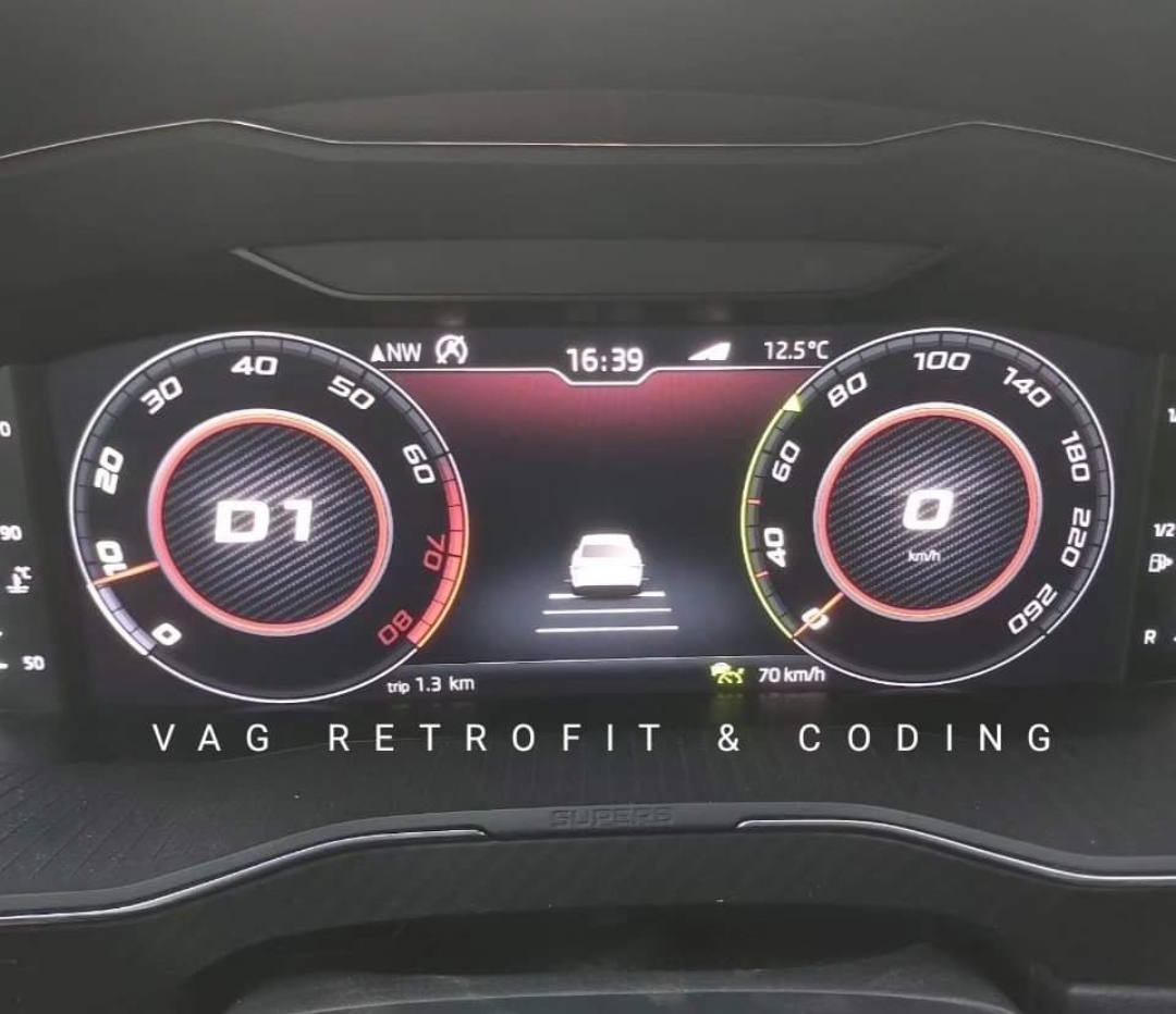

  12. I recently retrofitted virtual cockpit on my skoda superb 2017. How do i get sports dial something like in the picture?

  14. Current one is : 5Q0907530AM. I have two problems with my car right now: 1.Drive Modes not working. Carisma adaptations are active. 2.Unable to find "expansion-display configuration" adaptions missing because of which i am unable to view VC settings on mu MIB display. Rest everything is working flawlessly including my new virtual cockpit. I am still not sure if above problems due to incompatibe canbus gateway. I couldnt find anything wrong with coding/adaptations.
  15. @ApertureSDo you have any idea abt canbus gateway? I ordered 3q0907530AC for my car. Will attempt to replace it.
