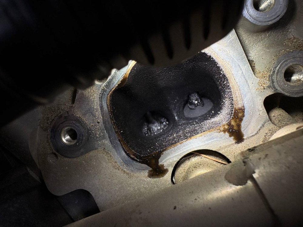

1.0 TSI additional oil catch
Has anyone added a oil catch can kit to 1.0TSI? My Monte Carlo has 103k km's on the clock and I got the inlet passages cleaned and they were dirty... Is there a plug in kit for the 1.0 TSI on the market?
