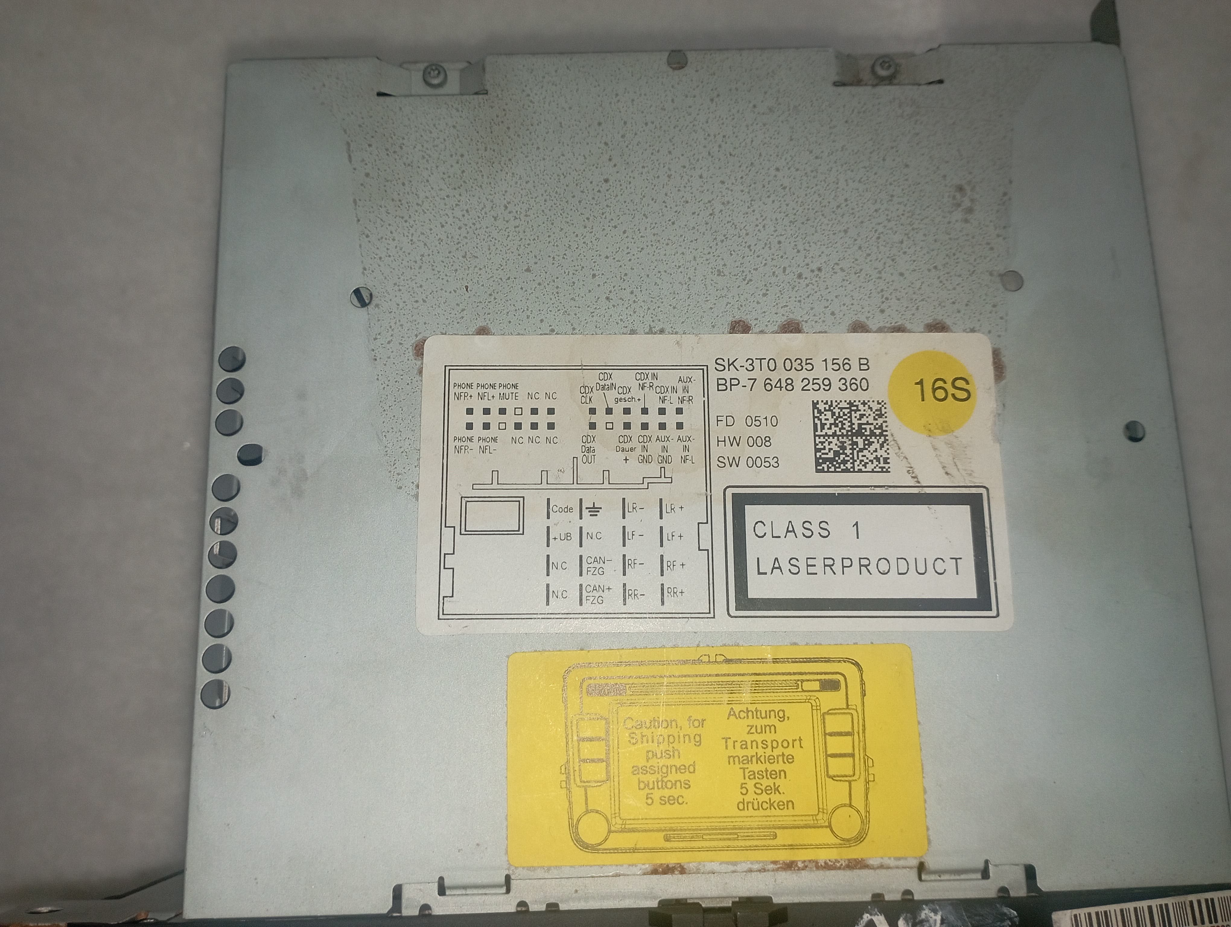

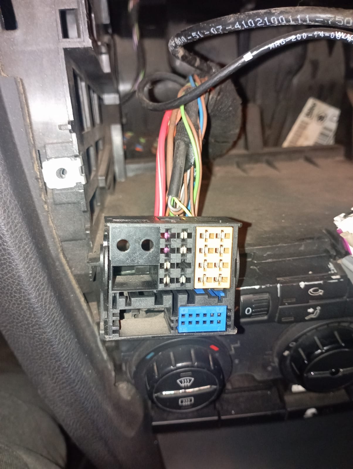

  5. Hello, I have an Octavia mk2 pre-fl 2009, which has the audience head unit along with the 12 speakers setup and an amp under the passengers seat. Current CAN gateway from factory is 1K0 907 530Q with HW: 1K0 907 531 & SW: H16. I recently decided to upgraded from the audience head unit (1K0 035 456) to a bolero unit (3T0 035 156B) built by Blaupunkt from a Superb mk2. Now the problem is that the unit powers up as it should but I have no sound when I try to play any music. I have tried to play music from the AUX and CD, the screen displays that a track is playing from the CD but there is no sound whereas if I reconnect the audience head unit the speakers come back to life. I haven't been able to test the radio the antenna cable for the audience head unit is different from what is required for the bolero. Attached herewith are pictures of the audience pin out diagram, the quad-lock setup and the bolero pin out diagram. Any help is highly appreciated.
