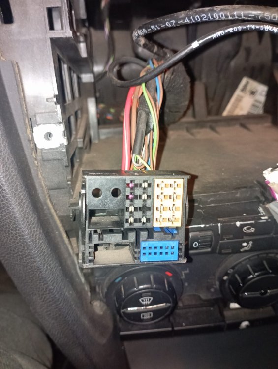

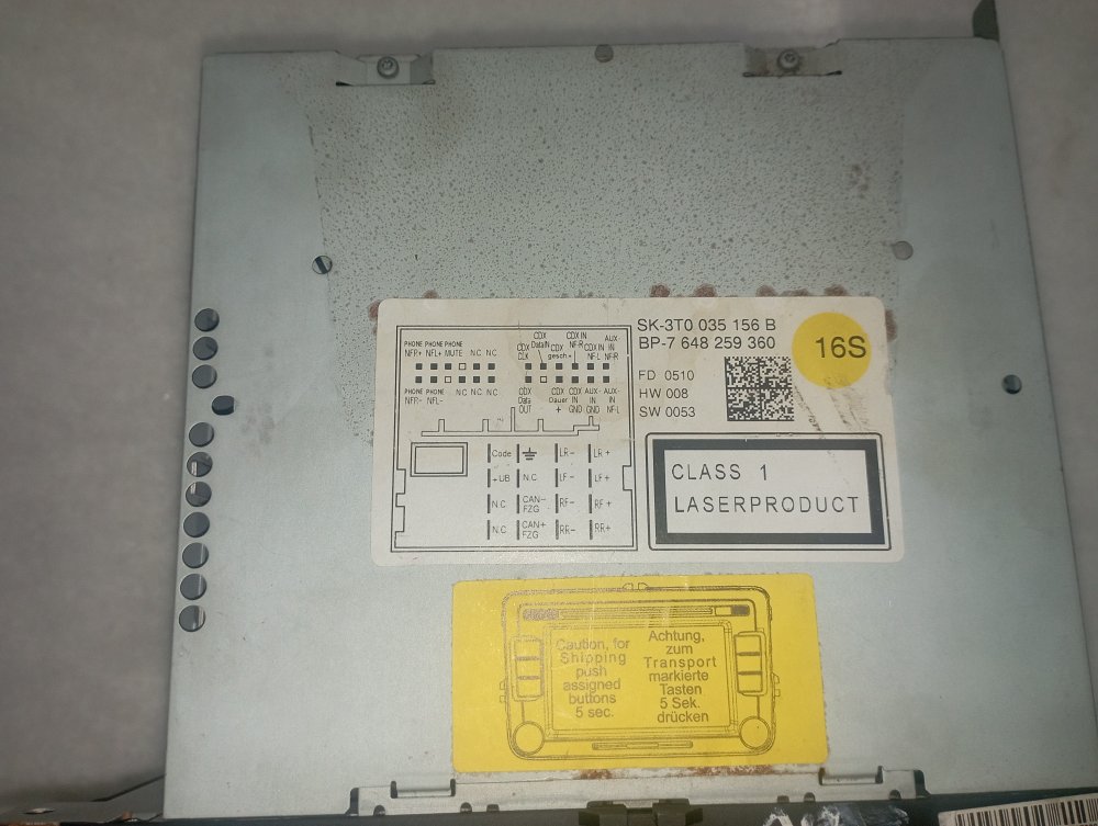

Attached herewith are pictures of the audience pin out diagram, the quad-lock setup and the bolero pin out diagram.
Pin out diagram of the audience head unit
Quad-lock setup from the factory
Pin out diagram of the bolero head unit

Hello, I believe these infotainment units have component protection - which means they cannot be used in a different vehicle without them being unlocked, was this done?
Hello,
I have already entered the 4 digit security pin that is asked for upon starting the bolero unit, if that's what you mean.
I am able to access all the functions and mess around with the settings, but the only thing that is amiss is the sound from the speakers.
