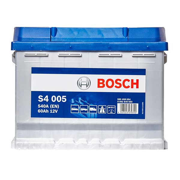

  1. I can only describe what my experience was with the nightmare electric windows scenario The battery is a battery comment is so subjective, every β€œcheap” battery I have fitted over the years have always let me down varta and bosch are reliable
  2. That is what i fitted
  3. You could try cleaning up the battery terminals and torque them down nice and tight my lion brand battery was only 6 months old, load of ****! bosch one fixed it
  4. I know I never believed the brand would make a difference but some cars are more sensitive to voltage drops apparently bosch have a cleaner current maybe i was just lucky because I replaced the door switch, fuses and two window modules before trying the battery
  5. A brand new battery? I tried everything and a new bosch battery sorted it been a month now no issues
  6. Like I said before, replace the battery!
  7. I tried all the usual suspects like i said, a new battery was my result i replaced fuses, door switch and the door control module, basically replacement door motors, all still didn’t solve it
  8. Hmmm strange i fitted a bosch battery, been 3 weeks no issue
  9. That will only work as a short term fix mate
  10. Yeah that is an inconvenience though try a new battery πŸ‘
  11. Change the battery That is the only solution I found good luck
  12. Does seem odd because if your car starts fine then replacing the battery seems pointless but that is what sorted my issue maybe a better brand of battery provides a cleaner power delivery more amps
  13. Hi i would try a new battery, or borrow one and try that That solved my issues
  14. Hi guys had this exact problem with my 2005 Fabia VRS tried new fuses, new window motors and door switch, no joy ! then i replaced the battery with a decent brand, on this case a bosch tada!!! windows have worked perfectly for 2 weeks! worth a go
