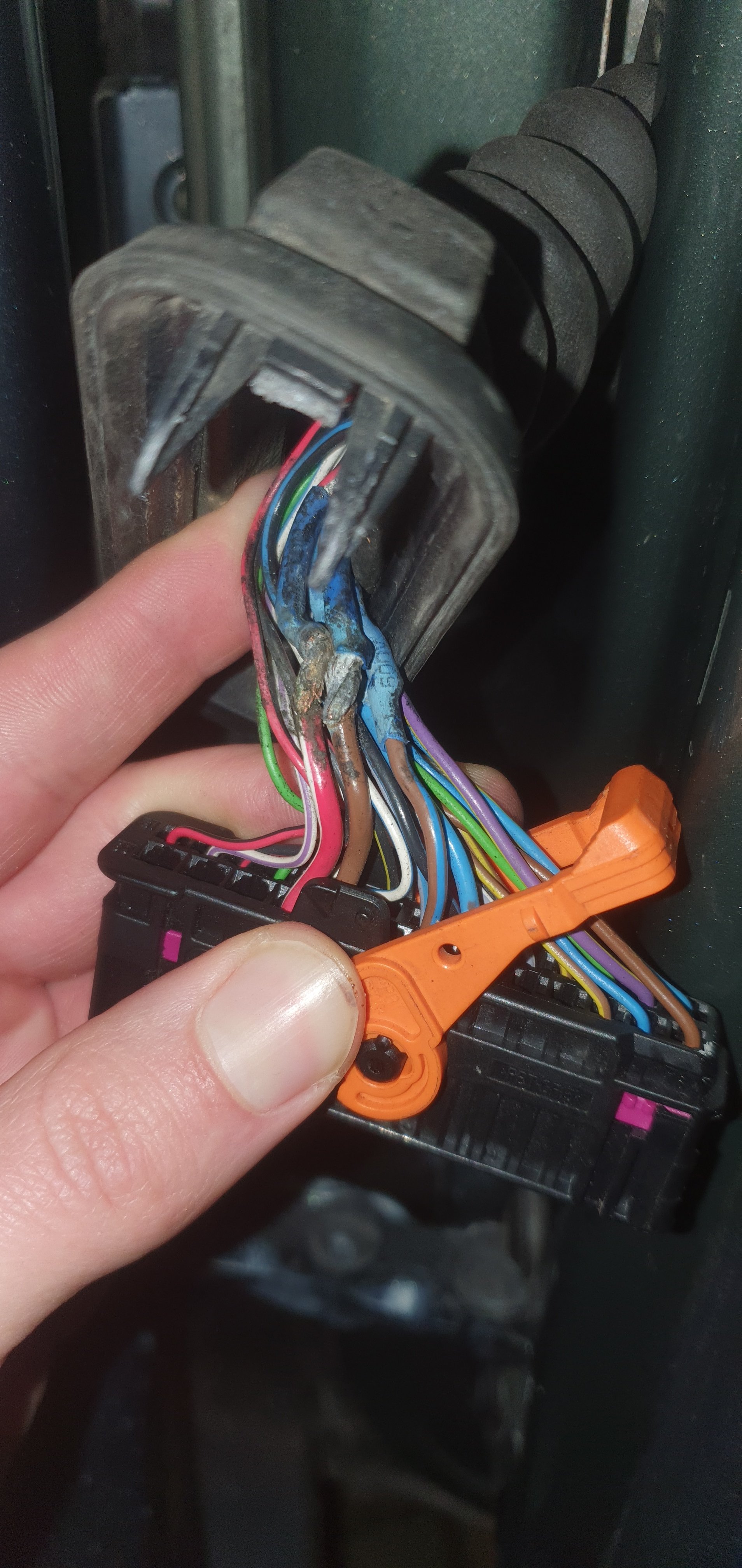

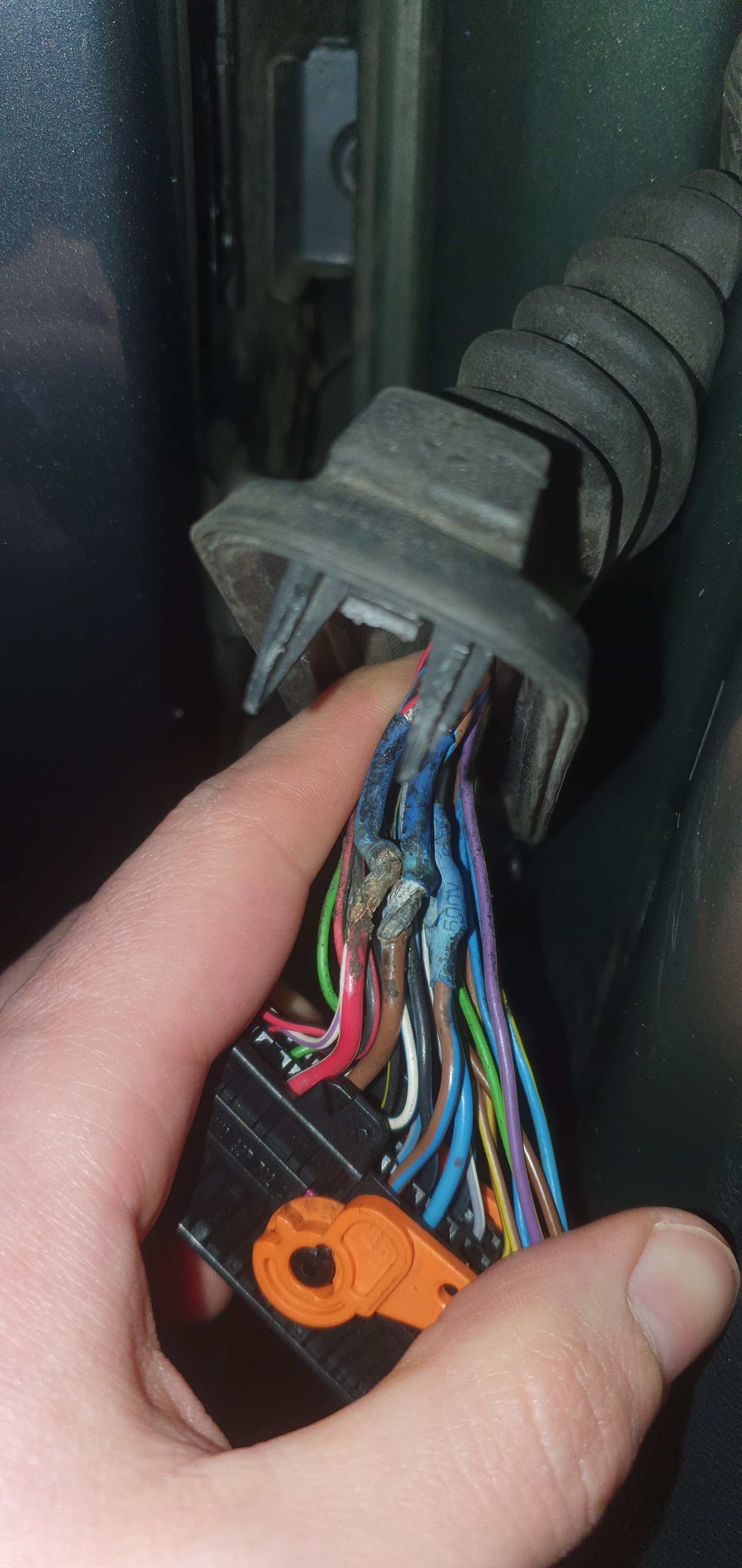

I checked the wiring harned in both doors and the passenger side is intact. The drivers side has been mendended, about 3 wires were soldered.

you need to verify the door looms especially the previously repaired ones to ensure all is good, soldering on a car is often not a good idea especially on something that moves and flexes.
But why does the passenger door side works only for 5min?
to be honest no idea, but anything is possible with these VAG cars and the way they are wired, especially when a fault is present somewhere.
The main issue is......The drivers door is the "master" control unit for the windows, so "if" there is a fault there and OR with the wiring then any combination of errors is possible.
The loom has obviously been repaired before, now personally I don't think there is enough room to do a decent repair in that small area, many will argue different I'm sure, but for me a new loom is the best fix. So yours has been
soldered, this has to be the first port of call to check the repair is still sound because over time, vibration and OR corrosion can affect a soldered joint in vehicle wiring and offcourse that is also "assuming" it was a good repair to start with.
Have a good look at the solder repairs and check continuity "either" side of the repair to prove its good.
PS what colour wires were repaired ?
Edited by UrbanPanzer
Cheers. The soldering does look a bit crap. From memory it's a thick red, a brown one and a blue one.
The thick red is most likely red with white trace, this is the main power feed to the motor for the window lift, all browns are earth and the Blue will also probably have a trace colour as well.
Fyi it wasn't me that soldered those.
do the wires test ok ?
I am assuming you have pulled back what looks like heatshrink otherwise it looks very easy for the red/ white trace to short to earth
I tested power to the motor and power to the switch. Both 12v. I don't know how to test for continuity

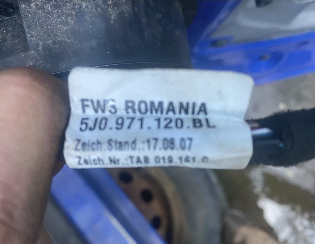

Just to update, the door was replaced due to an accident an I believe the wiring harness is not the correct one for the car. I looked on the parts finder and there are many many variations of this harness. Struggling to find one from the breakers that fits mine :(

But anyway, point is, I don't know if the loom is the correct one because it would 1. Belong to the donor car 2. It might have been swapped over when the door was changed so I don't know. eBay breakers have very different part numbers compared to what's on the parts sistems and yet they have power windows, heated mirrors, central locking etc. I even noticed the connector for the window motor on one of them was different than mine and it was from a 2008 Roomster (mine is a 2007). Dealer quoted me £150 doh!
I guess I have to tear it down and check what's on it.
dunno what dealer was quoting.......
I bought the "most connections" electrical drivers door loom for Fabia 2 which is 4 electric windows, heated electric mirrors etc and that was only £95.........unless offcourse prices have gone up a lot.

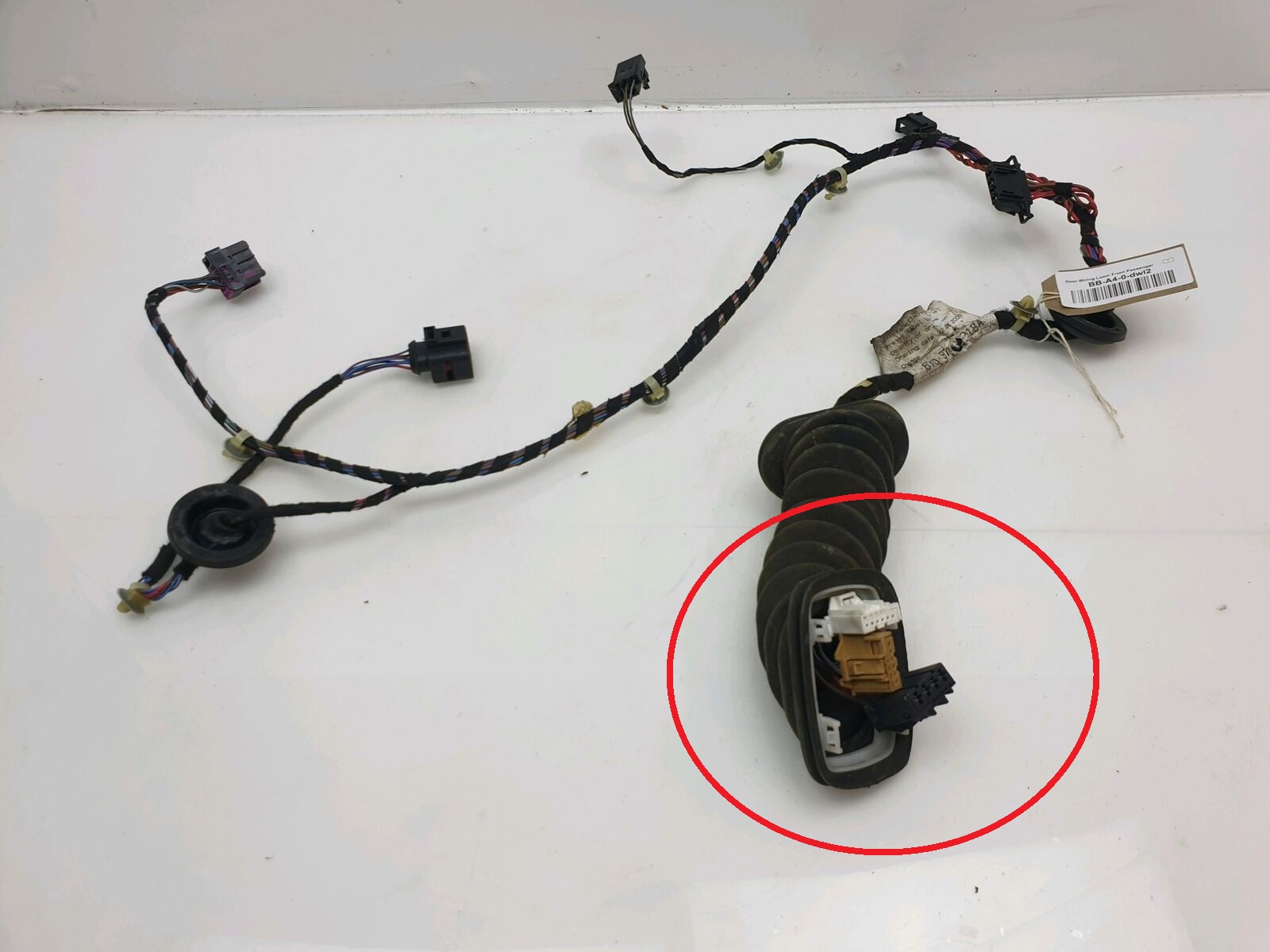

The loom is the correct "fit", but A) may not be ref what equipment and B ) maybe faulty....
if you look at the attached images, the 07 looms have a totally different connection at the A pillar (circled), yours has the large "big" plug from 2008 onwards as in the other image.
The dealer quoted me for a brand new loom. Anyway I bought one from eBay used for £50. Waiting to be delivered now and see what I get. According to the parts diagram it should fit.
