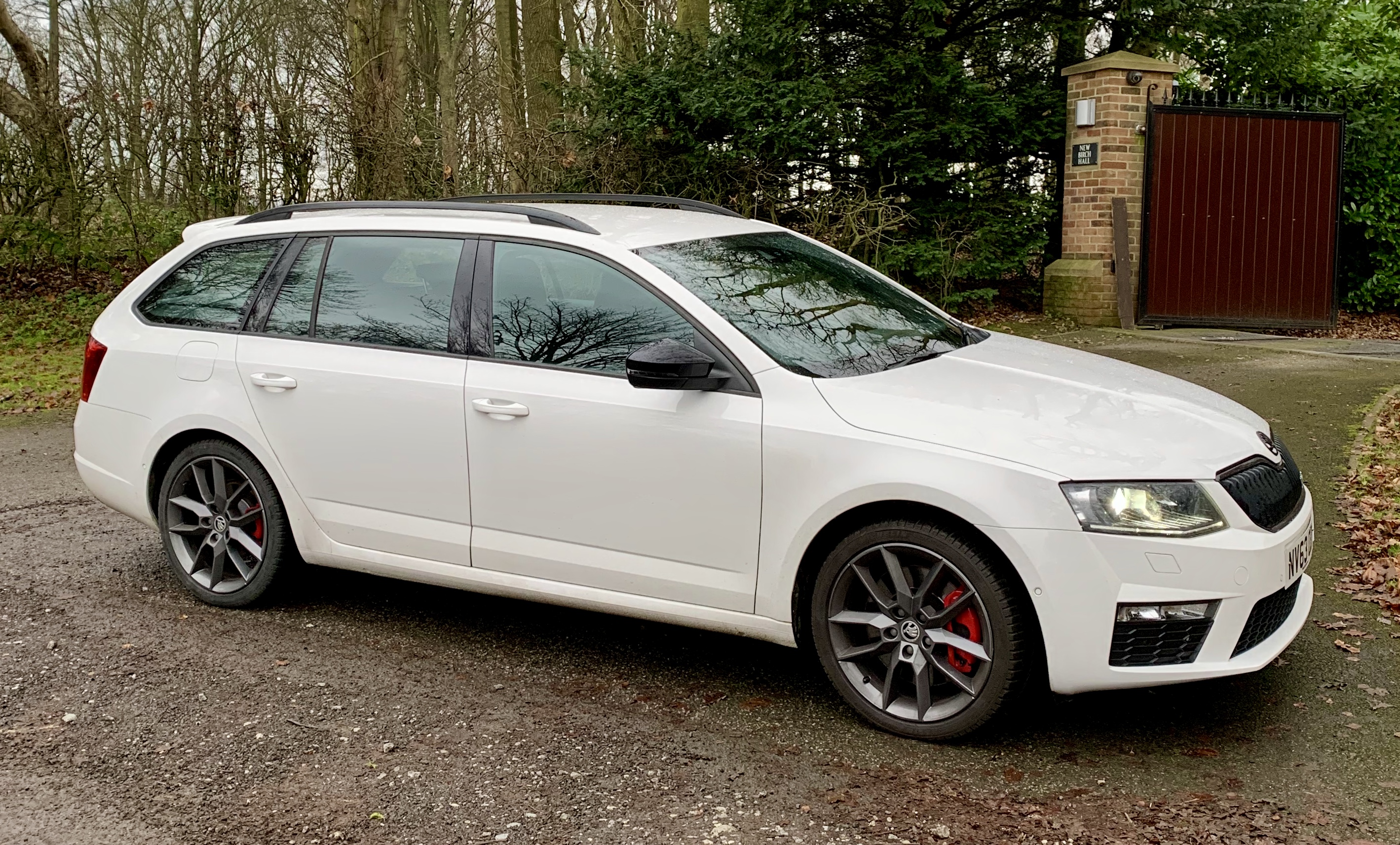

  3. Goodbye Octy!
  4. Moving on to a well known German car brand with 2 extra cylinders.
  5. Well, after 4 years of owning the Octavia vRS, it’s time to move on. Couldn’t really fault the Skoda......fairly quick......economical......and practical. I’m moving on to something just as economical, just as practical, but a little bit quicker! Who knows, I’m might return to Skoda ownership in the future.
