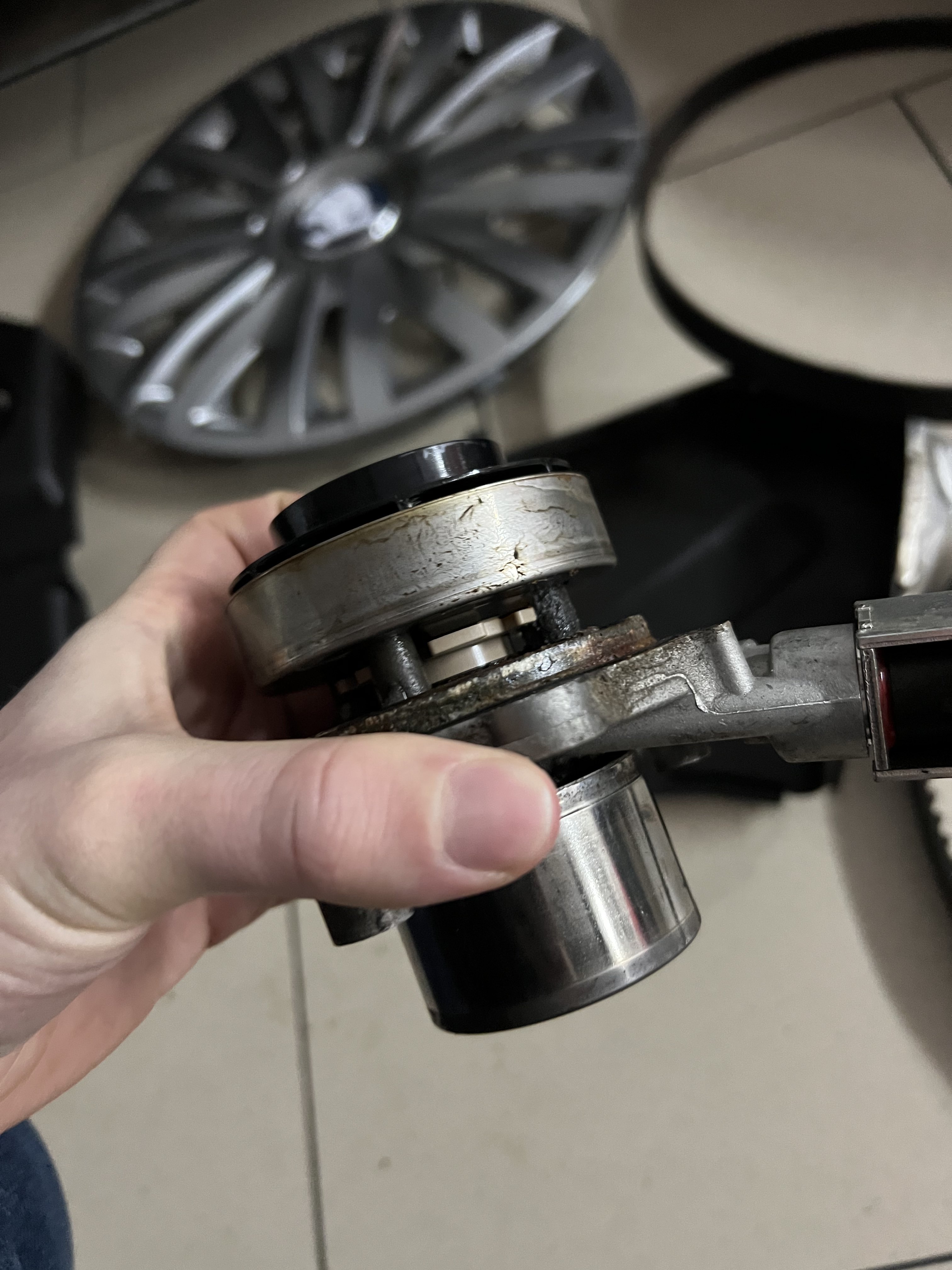

Škoda Octavia MK III TDI - Overheating after coolant flush
UPDATE Changed the water pump. It was stuck on closed. OE pump lasted 3 years and 40.000 km( aprox). The issue of this failure was the coolant. Maybe a bad proportion of coolant and water or the coolant itself ( G13). The next step it’s to wash all the system properly and to change front radiator, but all of these after the wedding. Thank you all for your support.
I saw a guy on youtube who changed the water pump on a Golf 7 TDI with an aftermarket one without the electric sleeve. With the electrical sleeve partially stuck, there was no flow on the inlet hose on the expansion tank. After he put aftermarket pump without sleeve, there was water flow on that hose even with cold engine. I know the sleeve actual block the water flow to let the engine warm-up quickly, but I checked when the temperature was at 90 degreese, so the sleeve has to be opened.
I just tried to unplug the connector of the water pump. Only difference was the fault code on VCDS. With water temperature on VCDS at 90 degrees, I unpluged the inlet hose from the expansion tank and no water flow from it. I think I have a totally stucked sleeve in the closed position. Btw, the heating in the cabin was off(climatronic turned off) while I was doing this test, when I put the heating on 24 degrees, I had water flow from the inlet hose. It’s a 5 speed manual, so no DSG thermostat.
Thank you again for the replys. Now I suspect the wather pump, even if it was changed 3 years ago with OE.. Is there any way to see if it’s working(water pump)?
Initially I thought VCDS would make the Bleeding process ok but now I’m having doubts. I will ask the local dealer to run a odis bleeding and hope it will be ok after. Is there any way I can diagnose the switchable water pump?
Yes, there is an option where you can run bleeding process. @J.R. Definetely it’s not the case with silikat bag. I’m not having the reservoir with that bag. It’s the reservoir from the factory. I parked the car in the garage and left it through the night without the shield under the engine. No leaks on the floor. Just one strange case: I could hear a noise from the coolant reservoir and I presume the cap or the reservoir could not mentaim the pressure. It could be a good idea to change both( I will have them changed). My water pump has 3 years old and 60.000 km. The thing is each time the behave not normal. I can’t make the pump work by off and on the engine. Maybe my pump it’s fully stuck..but without the coolant cap I can make the thermostat to open. When I put the cap on, it’s starting to overheat. Thank you guys for the answers.
