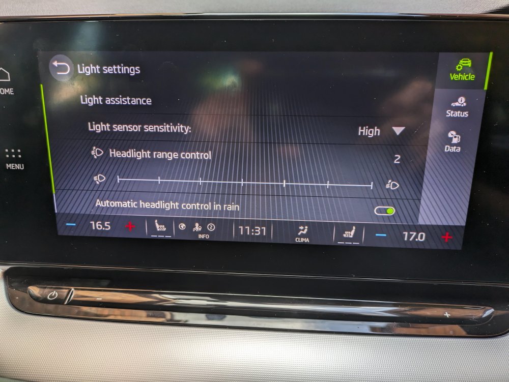

  4. Hi, yes, I have tried driving at night and nothing happens. Thanks for the photo, that should help make it really clear to the dealer what the issue is now. I've attached a screenshot and you can see that I don't have it. Thanks for your help. Will let you know what they say.

  7. Thank You. That's really helpful, and great to know that you find it of value. I guess that something has gone wrong and it's not properly activated as I don't get the A symbol. Am waiting for dealership to book it in to analyse but I guess maybe they need to reset the whole infotainment screen. If you go into the Vehicle settings on the infotainment screen do you see any new option there? I have a Light Assist setting but that was there previously and I think that is the setting that determines as what point the dipped headlights come on. Also, at any point in the App or Infotainment did you see a message similar to 'To secure full and proper functionality please visit your authorised dealer'. Am just looking for any clues that I can point the dealership at given the confusion this seems to have caused them so far.
