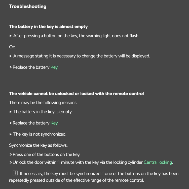

One of the keys brings up the immobiliser warning on the dash and wont start the car, which sounds like the condition mentioned. The other key will start the car without issue, it's just the remote won't operate the central locking. I tired the method in the hand book and another one on the net where they state to put the kiy in the ignition after opening the locks, but no joy on either. It feels to me like the second one that does start the car, should be able to be made to work based on the handbook and YT tutorials, but not getting anywhere. Tried original battery and two different new batteries, red light flashes on the them all so as content as I can be that the battery is not the issue. This one is puzzling.

I found this in the handbook, but didn't work. (Red light on key is flashing confirming new battery working).
