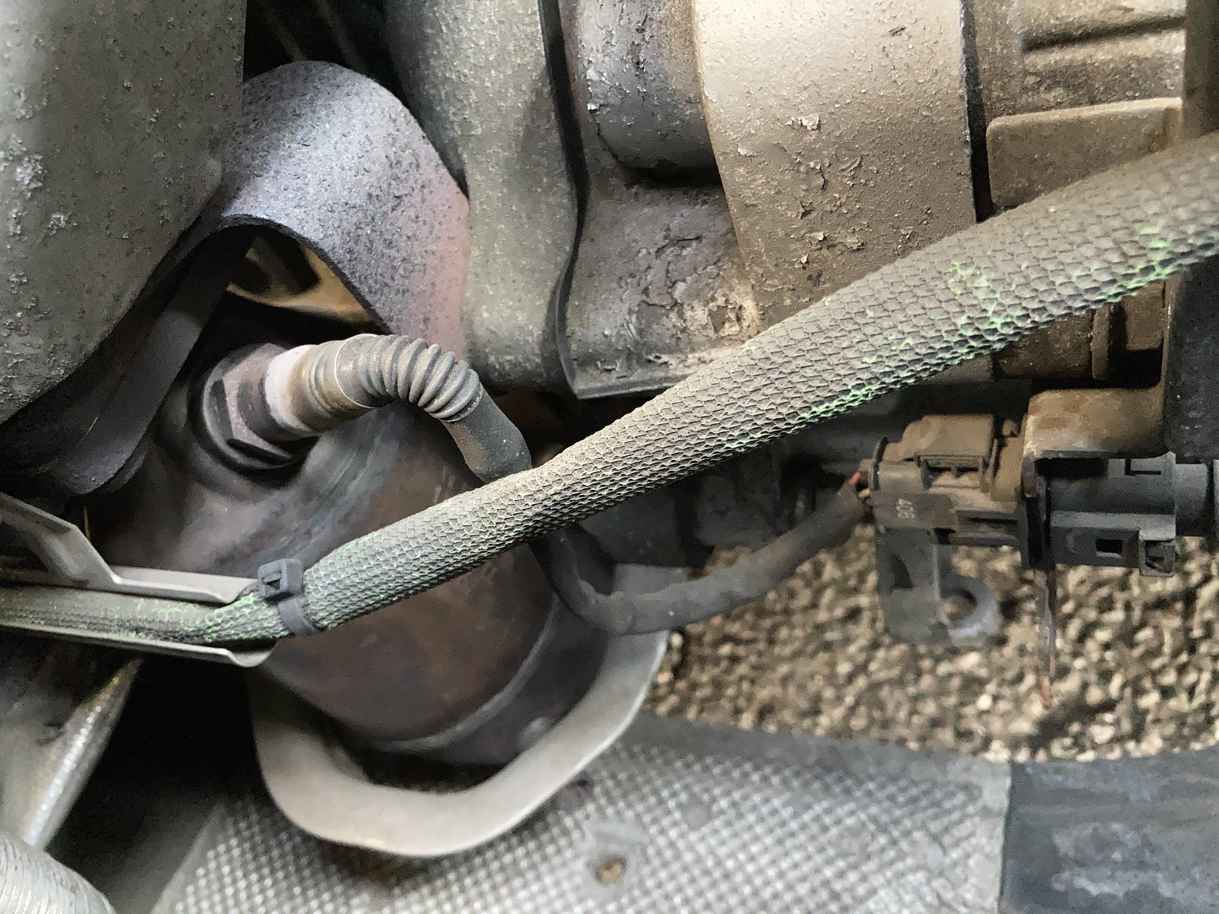

Hi All I assume the lambda sensor is at the front of the engine (pre cat). Is this correct, as some Octavia models have the lambda underneath the car. Also how do I unclip the sensor? Is it by unclipping the plug to the right of the sensor plug? Thanks

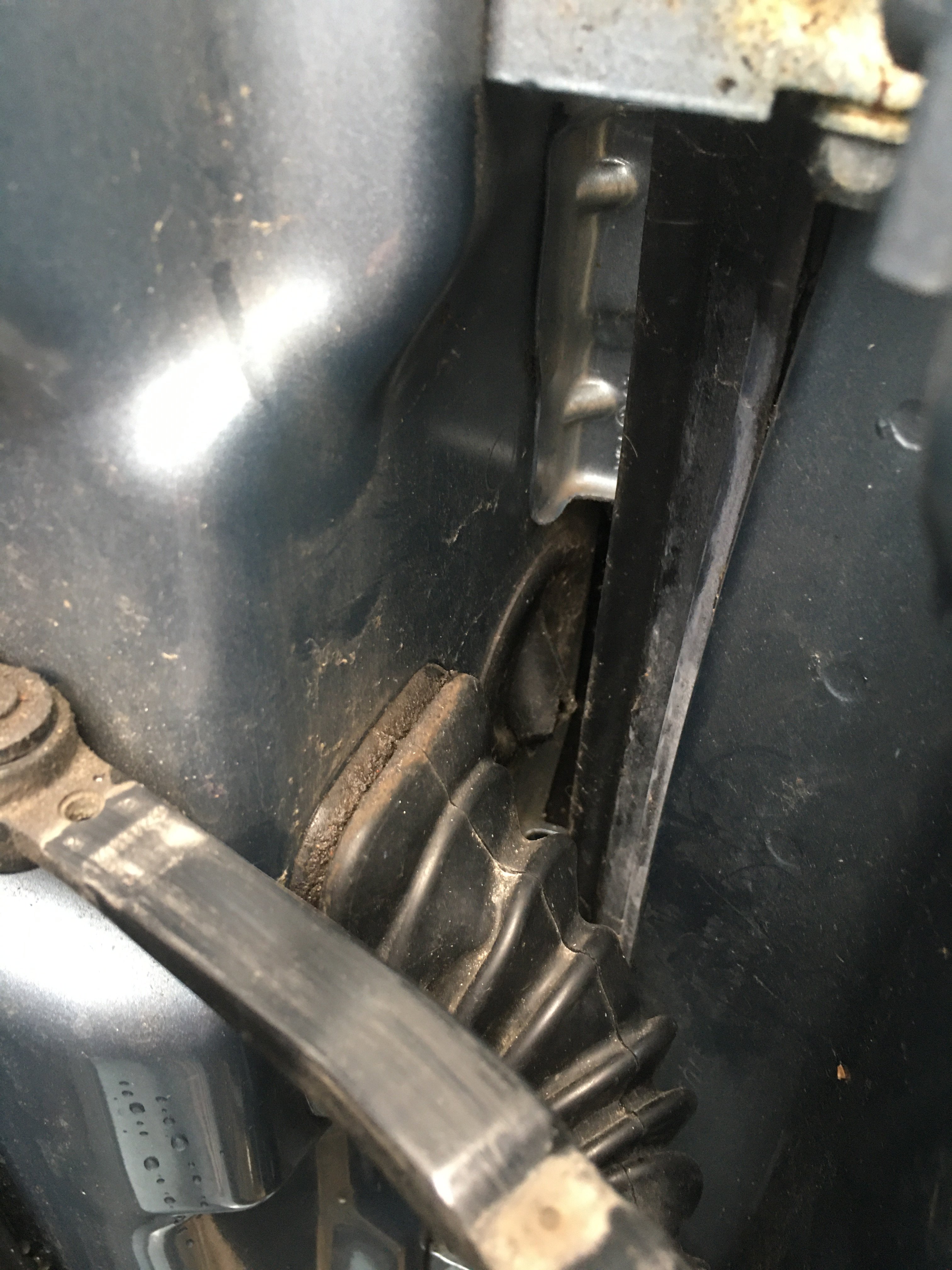

I think I have a problem with sun roof drain pipe. I discovered a lot of water in the driver footwell. I dried the carpet and pour water in the sunroof trap to test it, and the footwell was wet again. Water is not coming out of the water pipe outlet? (See picture) so i assume the drain pipe is not connected. Does anyone know how do I get to the inside of the drain pipe connector? Is access from the wheel arch? Or elsewhere ?
