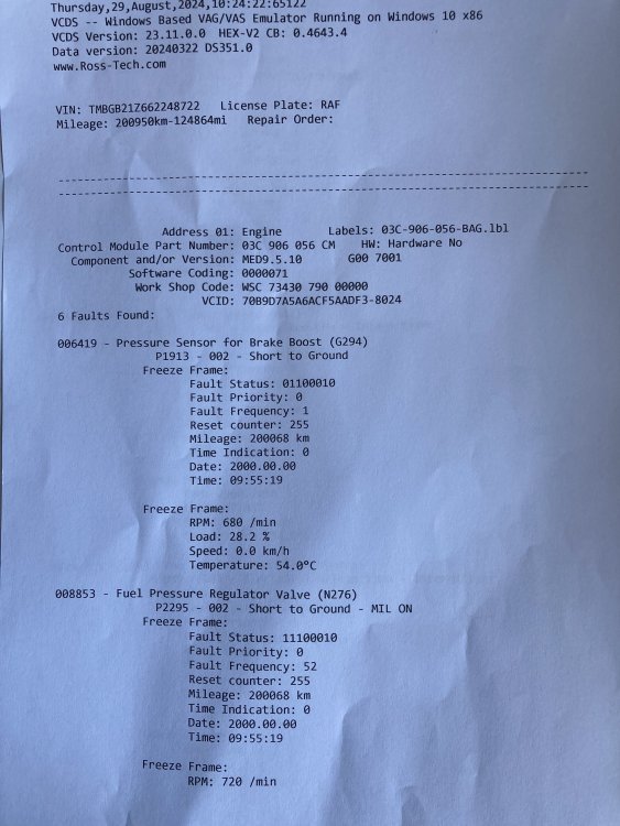

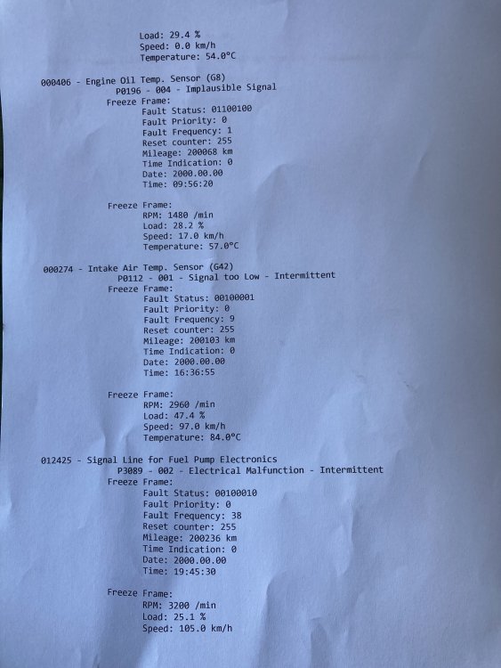

This week I tested all grounding points I could find as the latest error was fuel regulator short to ground. all grounding points tested ok and gave the same reading as the battery (12.10v) any suggestions on what check or change? I have read a lot of posts where owners have changed fuel pumps and a lot of sensors but it still didn’t cure the problem. Car still runs, except it is using a lot more fuel (15% to 20% approx) and occasionally is lumpy on hard acceleration.

Hi all stick not fully sorted. plugs, air filter and fuel filter changed. car more responsive but I have still epc and emission error, with the main error being fuel regulator anyone know if the fuel regulator is part of the fuel pump on the 1.6 FSI? any help much appreciated

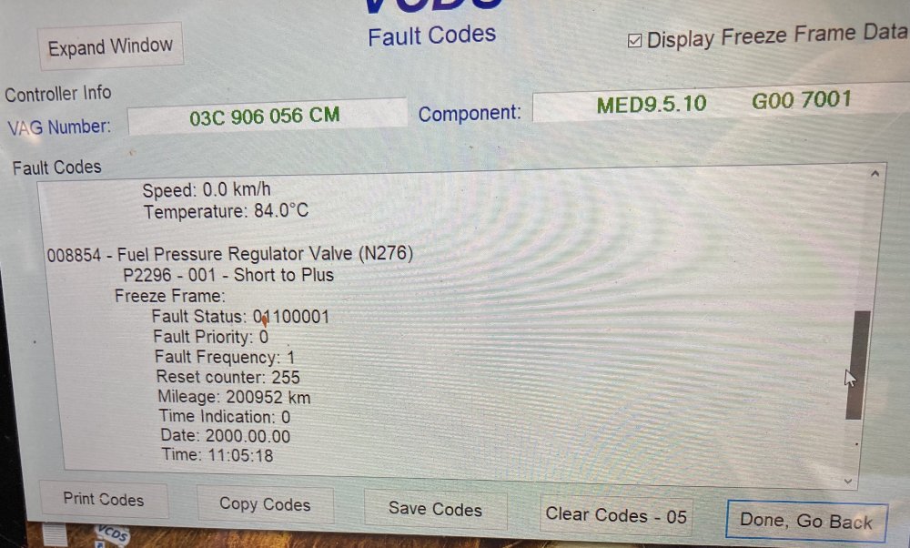

My 1.6fsi had the EPC and emissions warning come on. I bought a basic VAG reader (ancel vd500), the error codes were 08854 fuel pressure regulator control B control circuit high 08851 Fuel pressure regulator B performance The car idles a bit rough and occasionally when accelerating hard, the car can fill chocked and not smooth. also there is occasionally an external smell of excess fuel Any ideas on what to change/fix first? Is it the fuel regulator or fuel sensor? I saw a video where a mechanic said the mini container bucket under the fuel pump can corrode (solid bottom disintegrates), this affects the fuel pump performance.

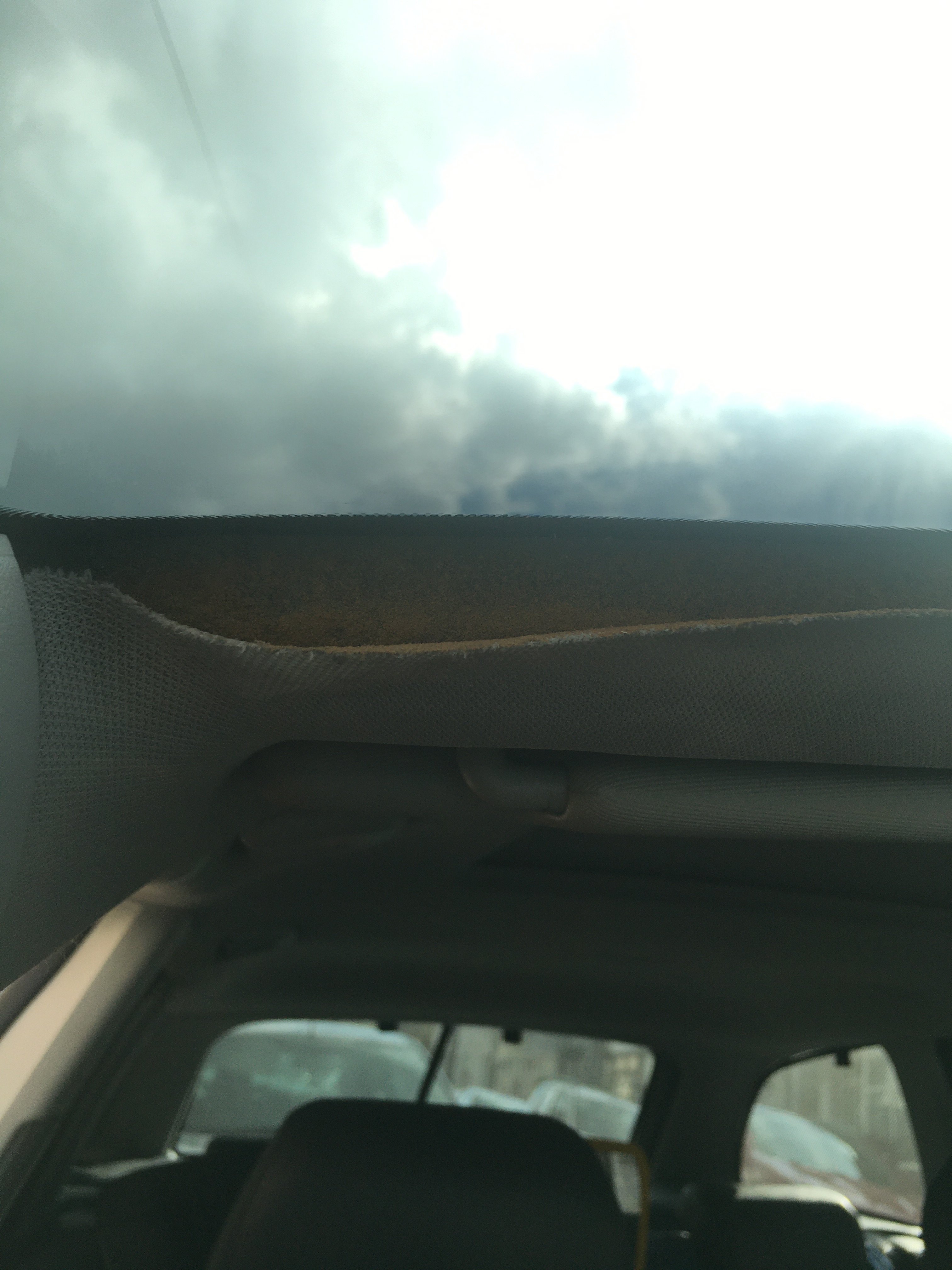

Best glue for Octavia mk2 roof lining, peeling
Thanks for the quick reply the alternative I thought might be double sided carpet tape. Perhaps this option is if the glue doesn’t work
