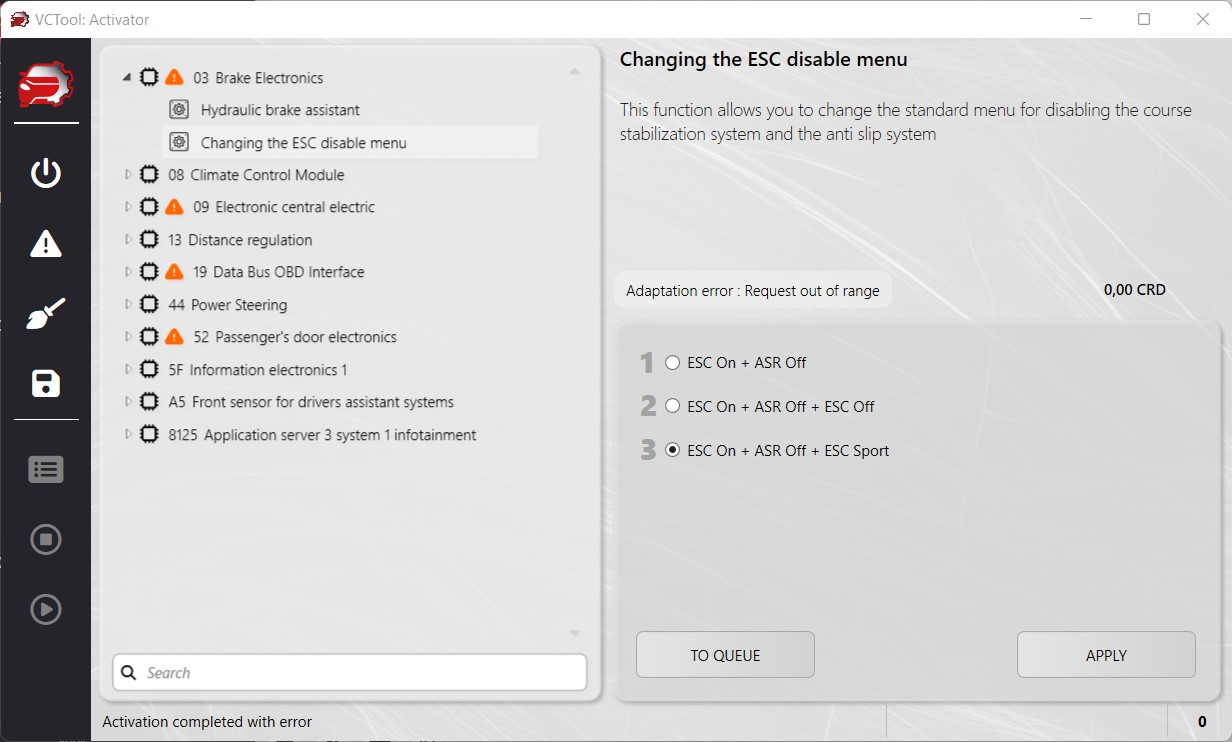

  1. Hey! I tried to code the Skoda Enyaq MY21 ESC On+ASR Off+ESC Sport/Off, but the coding failed. The hood is up, the electric handbrake is on and the "ignition" is on in the car. Is there any information on how to code this? VCDS Auto-Scan log: Wednesday,03,May,2023,17:07:59:00464 VCDS -- Windows Based VAG/VAS Emulator Running on Windows 11 x64 VCDS Version: 23.3.1.0 (x64) HEX-V2 CB: 0.4631.4 Data version: 20230421 DS346.2 www.Ross-Tech.com Dealer/Shop Name: J.P - V3lmu VIN: TMBJB7NYXNF009086 License Plate: SKODA ENYAQ Mileage: 36787km-22858mi Repair Order: 1. kierros -------------------------------------------------------------------------------- -------------------------------------------------------------------------------- Chassis Type: NY-SKE3 (1EA) Scan: 01 03 05 08 09 10 13 15 17 19 23 2B 3C 42 44 51 52 5F 69 6C 75 8C A5 C0 C6 D6 D7 8105 811E 811F 8120 8121 8123 8124 8125 C002 C003 VIN: TMBJB7NYXNF009086 Mileage: 36787km-22858miles 01-Engine -- Status: OK 0000 03-ABS Brakes -- Status: Malfunction 0010 05-Acc/Start Auth. -- Status: OK 0000 08-Auto HVAC -- Status: OK 0000 09-Cent. Elect. -- Status: OK 0000 10-Park/Steer Assist -- Status: OK 0000 13-Auto Dist. Reg -- Status: OK 0000 15-Airbags -- Status: OK 0000 17-Instruments -- Status: OK 0000 19-CAN Gateway -- Status: Malfunction 0010 23-Brake Booster -- Status: Malfunction 0010 2B-Steer. Col. Lock -- Status: OK 0000 3C-Lane Change -- Status: Malfunction 0010 42-Door Elect, Driver -- Status: OK 0000 44-Steering Assist -- Status: OK 0000 51-Electric Drive -- Status: Malfunction 0010 52-Door Elect, Pass. -- Status: Malfunction 0010 5F-Information Electr. -- Status: OK 0000 69-Trailer -- Status: OK 0000 6C-Back-up Cam. -- Status: OK 0000 75-Telematics -- Status: OK 0000 8C-HV Battery -- Status: OK 0000 A5-Frt Sens. Drv. Assist -- Status: OK 0000 C0-Act. for Ext. Noise -- Status: OK 0000 C6-Batt. Chrg. -- Status: Malfunction 0010 D6-Light Ctrl Left 2 -- Status: OK 0000 D7-Light Ctrl Right 2 -- Status: OK 0000 8105-DC/DC Converter 12V -- Status: Malfunction 0010 811E-Burglary Protection FL -- Status: OK 0000 811F-Burglary Protection FR -- Status: OK 0000 8120-Burglary Protection RL -- Status: OK 0000 8121-Burglary Protection RR -- Status: OK 0000 8123-App server 1 system 1 adaptive -- Status: Malfunction 0010 8124-App server 1 system 2 Java -- Status: Malfunction 0010 8125-App server 3 system 1 infotaint. -- Status: Malfunction 0010 ------------------------------------------------------------------------------- Address 01: Engine (J623-EBJC) Labels: 0EA-907-425-V1.clb Part No SW: 0EA 906 012 AT HW: 0EA 907 425 C Component: E-Vehicle H01 1533 Dataset Number: V03935352AT 0001 Coding: 040200060364140070080000001000802008060000000000 ASAM Dataset: EV_VCU00XXX0200EA906012AT 001003 ROD: EV_VCU00XXX0200EA906012AL.rod VCID: 7DA7F9E3DD7173E264D-8028 SFD VINID: 91D49A4877A9A1E58000900818DAEF6EF1 Selector lever: Subsystem 1 - Part No SW: 5LA 713 203 HW: 5LA 713 203 Component: ZSB_SB_mono H01 0014 Serial number: 21 159 0221 0 Radiator shutter: Subsystem 2 - Part No SW: 1EA 965 501 HW: 1EA 965 501 Component: V711 022 0006 Serial number: 20210518060604075134 4 Faults Found: 31949 - Front Camera for Driver Assist Systems U1229 00 [032] - Implausible Message [Front camera for driver assistance systems implausible] Intermittent - Not Confirmed - Tested Since Memory Clear 25575 - Camera control module U107A 00 [032] - No communication Intermittent - Not Confirmed - Tested Since Memory Clear 43491 - Communication Authentication U3035 00 [032] - Invalid Signal [Communication Authentication Signal Invalid Data] Intermittent - Not Confirmed - Tested Since Memory Clear 38468 - Implausible Data Received from ESP Control Module U0416 00 [096] - - Intermittent - Not Confirmed - Tested Since Memory Clear Readiness: N/A ------------------------------------------------------------------------------- Address 03: ABS Brakes (J104) Labels: 1EA-614-517.clb Part No SW: 1EA 614 517 AA HW: 1EA 614 517 Component: ESC-ZF_EBC470 H15 0177 Serial number: B005ELE Dataset Number: V03935352LL 0001 Coding: 1A9E54AC393B583F2A3C9CE622DF32A6484A6D266433114928444C651252B66426CC889214EECBBEFD0077D37DBF00 ASAM Dataset: EV_Brake1ZFESCEPBMEB 013149 ROD: EV_Brake1ZFESCEPBMEB.rod VCID: 71BFD5D391290782F05-8024 SFD 1 Fault Found: 16401 - Tire Pressure Warning C102D 00 [108] - - [RKA_DEM_MON_P_WARN] Intermittent - Confirmed - Tested Since Memory Clear Freeze Frame: Fault Status: 00000001 Fault Priority: 5 Fault Frequency: 25 Reset counter: 40 Mileage: 36160 km Date: 2071.03.08 Time: 10:24:03 ------------------------------------------------------------------------------- Address 05: Acc/Start Auth. (J518) Labels: 5WA-959-436.clb Part No SW: 5WA 959 436 G HW: 5WA 959 436 C Component: Kessy IOBOX 070 0706 Serial number: --------------- Dataset Number: V03935341NA 0001 ASAM Dataset: EV_Kessy37w 003022 ROD: EV_Kessy37w_003_VW38.rod VCID: 58E98877129376CA17B-800C No fault code found. ------------------------------------------------------------------------------- Address 08: Auto HVAC (J979) Labels:* None Part No SW: 1EA 907 727 R HW: 1EA 907 727 R Component: Climatronic H01 0383 Serial number: --------------- Dataset Number: V03935351GA 0001 Coding: 001022017020320010100010111001102000102100221001000000000000 ASAM Dataset: EV_ACClimaBHBMEB31X 002007 ROD: EV_ACClimaBHBMEB31X.rod VCID: 49CF5D33D9391F42985-801C Fresh air blower control module (front): Subsystem 1 - Part No SW: 1EA 820 021 A HW: 1EA 820 021 A Component: J126 J126 002 0004 Serial number: 00000000000000000995 A/C compressor sub: Subsystem 2 - Part No SW: 1EA 816 551 G HW: 1EA 816 551 G Component: J842 eKK H07 0003 Serial number: 1EA816551G14062130E3 Humidity sensor: exterior: Subsystem 3 - Part No SW: 4H0 907 658 C HW: 4H0 907 658 C Component: G935 MuFu H05 0010 Serial number: AB5D014E00PAG0MUFU04 Auxiliary Heater Control Module/PTC 2: Subsystem 4 - Part No SW: 1EA 963 581 D HW: 1EA 963 581 D Component: 0123456789012 010 0160 Serial number: 5390220CA21179000325 Interior temperature sensor: Subsystem 5 - Part No SW: 5WA 907 527 A HW: 5WA 907 527 A Component: E857 H01 0103 Serial number: 00002100621163443513 Expansion valve 1 for refrigerant: Subsystem 6 - Part No SW: 1EA 816 681 A HW: 1EA 816 681 A Component: N636 EV1_KaMi 003 0003 Serial number: E1000000000001005433 Expansion valve 2 for refrigerant: Subsystem 7 - Part No SW: 1EA 816 682 A HW: 1EA 816 682 A Component: N637 EV2_KaMi 003 0003 Serial number: E20000000000000074OI Expansion valve 3 for refrigerant: Subsystem 8 - Part No SW: 1EA 816 682 A HW: 1EA 816 682 A Component: N638 EV3_KaMi 003 0003 Serial number: E30000000000000074OI Carbon dioxide content sensor: Subsystem 9 - Part No SW: 4N0 907 658 HW: 4N0 907 658 Component: G929 ICO2S H04 0231 A/C pressure/coolant temperature sensor 2: Subsystem 10 - Part No SW: 4N0 959 126 G HW: 4N0 959 126 G Component: G826 pT-Sens2 H04 0002 A/C pressure/coolant temperature sensor 3: Subsystem 11 - Part No SW: 4N0 959 126 H HW: 4N0 959 126 H Component: G827 pT-Sens3 H04 0002 Shut-off valve 1 for refrigerant: Subsystem 12 - Part No SW: 1EA 816 681 A HW: 1EA 816 681 A Component: V424 AV1_KaMi 003 0003 Serial number: A1000000000001005433 Shut-off valve 2 for refrigerant: Subsystem 13 - Part No SW: 1EA 816 701 A HW: 1EA 816 701 A Component: N640 AV2_KaMi 003 0003 Serial number: A2000000000000006ZYR Shut-off valve 3 for refrigerant: Subsystem 14 - Part No SW: 1EA 816 701 A HW: 1EA 816 701 A Component: N641 AV3_KaMi 003 0003 Serial number: A3000000000000006ZYR Shut-off valve 4 for refrigerant: Subsystem 15 - Part No SW: 1EA 816 702 A HW: 1EA 816 702 A Component: N642 AV4_KaMi 003 0003 Serial number: A4000000000000006J9A Shut-off valve 5 for refrigerant: Subsystem 16 - Part No SW: 1EA 816 702 A HW: 1EA 816 702 A Component: N643 AV5_KaMi 003 0003 Serial number: A5000000000000006J9A A/C pressure/coolant temperature sensor 4: Subsystem 17 - Part No SW: 4N0 959 126 F HW: 4N0 959 126 F Component: G395 pT-Sens1 H04 0002 A/C pressure/coolant temperature sensor 5: Subsystem 18 - Part No SW: 4N0 959 126 G HW: 4N0 959 126 G Component: G826 pT-Sens2 H04 0002 A/C pressure/coolant temperature sensor 6: Subsystem 19 - Part No SW: 4N0 959 126 H HW: 4N0 959 126 H Component: G827 pT-Sens3 H04 0002 Rear air conditioning block 1: Subsystem 20 - Part No SW: 565 907 049 HW: 565 907 049 Component: E265KlimaHeck H02 0201 Serial number: 06051501850797 5 Faults Found: 263681 - Exterior Air Quality/Humidity Sensor B137A 04 [032] - Internal System Fault Intermittent - Not Confirmed - Tested Since Memory Clear Freeze Frame: Fault Status: 00000001 Fault Priority: 3 Fault Frequency: 6 Reset counter: 19 Mileage: 27618 km Date: 2022.10.16 Time: 09:30:02 Outside temperature: 15.00 C Voltage terminal 30: 13.70 V System run time-Engine running time: 253 s System run time-Terminal 15 on: 253 s Air quality status: Initialization 524112 - No Communication with Diagnostic Gateway U0146 00 [032] - - [Lost Communication With Gateway "A" 19] Intermittent - Not Confirmed - Tested Since Memory Clear Freeze Frame: Fault Status: 00000001 Fault Priority: 4 Fault Frequency: 1 Reset counter: 20 Mileage: 35779 km Date: 2023.02.24 Time: 09:33:57 1244969 - Control Module for HV-Heater B1581 F6 [032] - Temperature Protection Active [HV heater control module Malfunction 10] Intermittent - Not Confirmed - Tested Since Memory Clear Freeze Frame: Fault Status: 00000001 Fault Priority: 3 Fault Frequency: 1 Reset counter: 0 Mileage: 25774 km Date: 2022.10.01 Time: 07:52:57 Voltage terminal 30: 13.70 V Outside temperature: 10.00 C System run time-Engine running time: 253 s System run time-Terminal 15 on: 253 s High-voltage air heater status: global-Requirement: not active High-voltage air heater status: global-Specified value: left: 0 % High-voltage air heater status: global-Specified value: right: 0 % High-voltage air heater status: global-Center target value: 0 % High-voltage air heater status: global-Number of heat zones: 3 zones High-voltage air heater status: global-Heating system used: Heat pump High-voltage air heater status: internal-Supply voltage: OK High-voltage air heater status: internal-Timeout: OK High-voltage air heater status: internal-Current: actual value: 0.00 A High-voltage air heater status: internal-High voltage supply voltage: 434 V High-voltage air heater status: internal-Response error: OK High-voltage air heater status: internal-Vehicle high voltage system: OK High-voltage air heater status: internal-HV heater: status: Power restriction due to hardware High-voltage air heater status: internal-Supply voltage: actual value: 0.00 V High-voltage air heater status: internal-Heater electronics and circuit board temperature (PCB): -50 C High-voltage air heater status: internal-Heating circuit 1 status: OK High-voltage air heater status: internal-Heating circuit 2 status: OK High-voltage air heater status: internal-Heating circuit 3 status: OK High-voltage air heater status: internal-Heating circuit 4 status: OK High-voltage air heater status: internal-Current flow with heating circuit not activated: OK High-voltage air heater status: internal-Total current over long period of time too high: OK High-voltage air heater status: internal-Circuit board temperature: shut-off value: OK High-voltage air heater status: internal-Internal error (other): OK 524091 - No Communication with Diagnostic Gateway U0146 00 [032] - - [Lost Communication With Gateway "A" 24] Intermittent - Not Confirmed - Tested Since Memory Clear Freeze Frame: Fault Status: 00000001 Fault Priority: 4 Fault Frequency: 1 Reset counter: 20 Mileage: 35779 km Date: 2023.02.24 Time: 09:33:57 523548 - Engine Control Module U12DB 00 [032] - Received Malfunction Message [Engine Control Module (ECM) received malfunction 3] Intermittent - Not Confirmed - Tested Since Memory Clear Freeze Frame: Fault Status: 00000001 Fault Priority: 6 Fault Frequency: 1 Reset counter: 0 Mileage: 31126 km Date: 2022.12.22 Time: 13:10:51 ------------------------------------------------------------------------------- Address 09: Cent. Elect. (J519) Labels: 1EA-937-BCM-V1.clb Part No SW: 1EA 937 089 L HW: 1EA 937 089 A Component: SAM_H H22 0130 Serial number: 06102116800688- Dataset Number: V03935352JH 0001 ASAM Dataset: EV_SAMVW31x 003001 ROD: EV_SAMVW31x_003_VWE3.rod VCID: 47CB5B0BCF2DE9328E1-8012 SFD Wiper motor control module: Subsystem 1 - Part No SW: 11B 955 119 A HW: 11B 955 119 A Component: FWISCHER_MYJT 003 0032 Serial number: 907353F0402113600530 Rain/Light Recognition Sensor: Subsystem 2 - Part No SW: 5Q0 955 555 B HW: 5Q0 955 555 B Component: RLHSS 054 0208 Serial number: S6Y21M06D25H05M04S30 Light switch: Control head for driving and comfort functions: Roof electronics control module: Subsystem 5 - Part No SW: 5H0 959 561 AR HW: 5H0 959 561 AR Component: -VW----LINDA- 502 0813 Serial number: MW3LND20052100010326 Steering Column Switch: Subsystem 6 - Part No SW: 5Q1 953 507 GF HW: 5Q1 953 549 F Component: J527 SMLS MQB 005 0080 Serial number: 00000009062120241133 No fault code found. ------------------------------------------------------------------------------- Address 10: Park/Steer Assist (-----) Labels:| 1EA-919-294.clb Part No SW: 1EA 919 294 B HW: 1EA 919 294 Component: PDC08K------- H02 0208 Serial number: 000019062194560 Dataset Number: V03935340FE 0001 Coding: 0040014101 ASAM Dataset: EV_EPHBO18VW3100000 002016 ROD: EV_EPHBO18VW3100000_VWE3.rod VCID: 3B2337FB83E5BDD21A9-806E 3 Faults Found: 12648976 - Databus U1121 00 [032] - Missing Message [Steuerger t f r Aussentemperatur - Temperaturen_01 - kein Signal/keine Kommunikation] Intermittent - Not Confirmed - Tested Since Memory Clear 13688835 - Databus U1123 00 [032] - Received Error Message [Steuerger t f r Rear Cross Traffic Alert - RCTA_01.RCTA_Status - Fehlerspeicher auslesen] Intermittent - Not Confirmed - Tested Since Memory Clear 13959169 - Parking Sensor(s); Front B10FC F0 [036] - Function Limitation due to External Factors [Geber f r Einparkhilfe - Schmutz bzw. Eisbildung vorn] Intermittent - Not Confirmed - Tested Since Memory Clear ------------------------------------------------------------------------------- Address 13: Auto Dist. Reg (J428) Labels:* None Part No SW: 1EA 907 572 G HW: 1EA 907 572 Component: ARS510VW19 H02 0123 Dataset Number: V03935345DL 0001 Coding: 058300734071404512474000000040C5AE4020000000000000000000000000 ASAM Dataset: EV_FRONTRADARCONTIVW310 003008 ROD: EV_FRONTRADARCONTIVW310_003.rod VCID: 3C2134E786EBBAEA133-8068 10 Faults Found: 196800 - Databus U1123 00 [160] - Received Error Message [VDY_FS_VEH_CORR_MONITOR] MIL ON - Intermittent - Not Confirmed - Tested Since Memory Clear 209054 - Databus U1123 00 [032] - Received Error Message [FAULT_BV_BLINDNESS_ERROR] Intermittent - Not Confirmed - Tested Since Memory Clear 0578 - Databus U1122 00 [032] - Implausible Message [FAULT_APS_BLINDNESS_DETECTED] Intermittent - Not Confirmed - Tested Since Memory Clear 1538 - Sensor for Automatic Distance Control C110B F0 [160] - Limited Visibility [FAULT_SENSOR_BLINDNESS] MIL ON - Intermittent - Not Confirmed - Tested Since Memory Clear 1396 - Sensor for Automatic Distance Control C110B F0 [160] - Limited Visibility [FAULT_SENSOR_NO_FREE_SIGHT] MIL ON - Intermittent - Not Confirmed - Tested Since Memory Clear 204812 - Databus U1121 00 [160] - Missing Message [FAULT_TIMEOUT_EINHEITEN_01] MIL ON - Intermittent - Not Confirmed - Tested Since Memory Clear 204815 - Databus U1121 00 [160] - Missing Message [FAULT_TIMEOUT_FAS_ANZEIGEN_01] MIL ON - Intermittent - Not Confirmed - Tested Since Memory Clear 1076 - Databus U1121 00 [160] - Missing Message [FAULT_TIMEOUT_GRA_ACC_01] MIL ON - Intermittent - Not Confirmed - Tested Since Memory Clear 1107 - Databus U1121 00 [160] - Missing Message [FAULT_TIMEOUT_KAMERA_STATUS] MIL ON - Intermittent - Not Confirmed - Tested Since Memory Clear 0536 - Databus U1121 00 [160] - Missing Message [FAULT_TIMEOUT_VZE_04] MIL ON - Intermittent - Not Confirmed - Tested Since Memory Clear ------------------------------------------------------------------------------- Address 15: Airbags (J234) Labels: 1EA-959-655.clb Part No SW: 1EA 959 655 CE HW: 1EA 959 655 CE Component: VW40Airbag 009 0366 Serial number: V170VyE0DE3 Dataset Number: V03935350AG 0001 Coding: 88CC008000F0C000000000200000000051540000A0540000C000F68000100065 Shop #: WSC 131071 1023 2097151 ASAM Dataset: EV_AirbaVW40ALVVW38X 001012 ROD: EV_AirbaVW40ALVVW38X.rod VCID: 0655960F88A7303A357-8052 SFD 6 Faults Found: 9634963 - Control Module for Front Left Belt Tensioner B1304 93 [032] - No Operation Intermittent - Not Confirmed - Tested Since Memory Clear 1075464 - Databus U1123 00 [032] - Received Error Message [NWD: 0x0DB AWV_03 error value AWV_Time_to_collision] Intermittent - Not Confirmed - Tested Since Memory Clear 1075461 - Databus U1123 00 [032] - Received Error Message [NWD: 0x0DB AWV_03 error value SDF_PSF_Objektstatus] Intermittent - Not Confirmed - Tested Since Memory Clear 1075462 - Databus U1123 00 [032] - Received Error Message [NWD: 0x0DB AWV_03 error value SDF_PSF_CW] Intermittent - Not Confirmed - Tested Since Memory Clear 1075463 - Databus U1123 00 [032] - Received Error Message [NWD: 0x0DB AWV_03 error value SDF_PSF_Kollisionsueberdeckung] Intermittent - Not Confirmed - Tested Since Memory Clear 1075465 - Databus U1123 00 [032] - Received Error Message [NWD: 0x0DB AWV_03 error value SDF_PSF_v_rel] Intermittent - Not Confirmed - Tested Since Memory Clear ------------------------------------------------------------------------------- Address 17: Instruments (J1254) Labels:. 10A-920-320.clb Part No SW: 5LA 920 320 HW: 5LA 920 320 Component: FAHRERDISPLAY 021 0520 Serial number: 1G1X1084-514928 Dataset Number: V03935341GX 0001 Coding: CE70 ASAM Dataset: EV_DashBoardLGMEB 001027 ROD: N/A (VIN: N/A) VCID: 72BDDADF942F3C9A09F-8026 No ASAM data for: "EV_DashBoardLGMEB" (SK35) No fault code found. ------------------------------------------------------------------------------- Address 19: CAN Gateway (J533) Labels: 1EA-937-012.clb Part No SW: 1EA 937 012 L HW: 1EA 937 012 A Component: ICAS1 Host-SG 065 0123 Serial number: SJ8ICS200621117 Dataset Number: V03935351P 0001 GVL: 2D0000000608D0CC8060904648180040C400400000020000000000000000DE47 ASAM Dataset: EV_GatewICAS1MEB 005001 ROD: EV_GatewICAS1MEB_VWE3.rod VCID: 392F2DF389D98FC2085-806C SFD Battery Monitoring Control Module: Subsystem 1 - Part No SW: 1EA 915 181 A HW: 1EA 915 181 A Component: J367-BDMConti H04 1073 Serial number: 773861010021053104A1 Multifunction steering wheel control module: Subsystem 2 - Part No SW: 5E3 919 719 E HW: 5E3 919 719 E Labels: 3C8-959-537.CLB Component: E221__MFL-PR6 H02 0100 Serial number: PR6-0440062168210555 Steering Wheel Touch Recognition Control Module: Subsystem 3 - Part No SW: 5E3 959 542 J HW: 5E3 959 542 J Component: KLR 082 0020 Serial number: 3133273AB21158082903 left tail lamp 1: Subsystem 4 - Part No SW: 5LA 945 207 A HW: 5LA 945 207 A 063 0215 left tail lamp 2: Subsystem 5 - Part No SW: 5LG 945 307 B HW: 5LX 945 307 B 063 0215 Right rear tail lamp 1: Subsystem 6 - Part No SW: 5LA 945 208 A HW: 5LA 945 208 A 063 0215 Right rear tail lamp 2: Subsystem 7 - Part No SW: 5LG 945 308 C HW: 5LX 945 308 C 063 0215 28 Faults Found: 1049259 - Ethernet Databus; Branch 11 U14A8 00 [036] - No Communication Intermittent - Not Confirmed - Tested Since Memory Clear Freeze Frame: Fault Status: 00000001 Fault Priority: 4 Fault Frequency: 1 Reset counter: 7 Mileage: 31736 km Date: 2022.12.29 Time: 15:39:20 2502759 - Ethernet Module for Emergency Call U1642 00 [044] - No Communication [Emergency-call_module_no_communication_vlan] Intermittent - Confirmed - Tested Since Memory Clear Freeze Frame: Fault Status: 00000001 Fault Priority: 4 Fault Frequency: 2 Reset counter: 13 Mileage: 31736 km Date: 2022.12.29 Time: 15:39:20 8397062 - 12V Test Pulse Diagnostics P1A85 00 [044] - Not Possible [12_V_test_pulse_not_available_by_reason_of_EMHLR] Intermittent - Confirmed - Tested Since Memory Clear Freeze Frame: Fault Status: 00000001 Fault Priority: 6 Fault Frequency: 13 Reset counter: 30 Mileage: 26346 km Date: 2022.10.10 Time: 15:46:47 Reason for rejection: 1 Bad counter: 41 Test pulse counter not OK: 0 Counter increase not OK: 0 BZE_test_pulse_request: 1 BZE_test_pulse_result: 0 8397569 - Quiescent Current U1406 00 [036] - Too High Intermittent - Not Confirmed - Tested Since Memory Clear 8397571 - LV Energy Management B1802 F1 [044] - Warning Triggered Intermittent - Confirmed - Tested Since Memory Clear Freeze Frame: Fault Status: 00000001 Fault Priority: 3 Fault Frequency: 46 Reset counter: 39 Mileage: 26069 km Date: 2022.10.04 Time: 04:11:14 51 8540417 - EgoMaster U15FA 00 [044] - Input Data Error Intermittent - Confirmed - Tested Since Memory Clear Freeze Frame: Fault Status: 00000001 Fault Priority: 6 Fault Frequency: 46 Reset counter: 36 Mileage: 25717 km Date: 2022.09.30 Time: 11:57:39 153102 - Control Module for Theft Protection; Front Left B1A61 29 [100] - Signal Implausible Intermittent - Not Confirmed - Tested Since Memory Clear Freeze Frame: Fault Status: 00000001 Fault Priority: 6 Fault Frequency: 1 Reset counter: 40 Mileage: 36757 km Date: 2023.05.01 Time: 14:11:30 153134 - Control Module for Theft Protection; Front Left B1A63 29 [100] - Signal Implausible Intermittent - Not Confirmed - Tested Since Memory Clear 8786912 - Control Module for Steering Wheel Touch Detection B17B8 F2 [040] - Sensor Malfunction [Control_module_for_steering_wheel_touch_regulation_malfunction_sensor_1] Intermittent - Confirmed - Tested Since Memory Clear Freeze Frame: Fault Status: 00000001 Fault Priority: 4 Fault Frequency: 120 Reset counter: 30 Mileage: 28450 km Date: 2022.10.21 Time: 04:24:10 8491266 - Secure Onboard Communication U14FE 00 [044] - Signature Verification Failed [SOK_signature_verification_failed] Intermittent - Confirmed - Tested Since Memory Clear Freeze Frame: Fault Status: 00000001 Fault Priority: 1 Fault Frequency: 42 Reset counter: 32 Mileage: 25723 km Date: 2022.10.01 Time: 04:58:11 8511746 - Unknown Error Code U173E 00 [044] - - [Occupant_Presence_Service_Error] Intermittent - Confirmed - Tested Since Memory Clear Freeze Frame: Fault Status: 00000001 Fault Priority: 6 Fault Frequency: 246 Reset counter: 39 Date: 2022.10.01 Time: 14:52:59 9371914 - predictive route data B1630 02 [109] - Signal Failure Confirmed - Tested Since Memory Clear Freeze Frame: Fault Status: 00000001 Fault Priority: 6 Reset counter: 40 Mileage: 25717 km Date: 2022.09.30 Time: 11:42:19 9371915 - predictive route data B1630 02 [044] - Signal Failure Intermittent - Confirmed - Tested Since Memory Clear Freeze Frame: Fault Status: 00000001 Fault Priority: 6 Fault Frequency: 9 Reset counter: 30 Date: 2022.10.02 Time: 22:05:45 8557314 - Databus U1122 00 [044] - Implausible Message [ZM_GNSS_Implausible] Intermittent - Confirmed - Tested Since Memory Clear Freeze Frame: Fault Status: 00000001 Fault Priority: 6 Fault Frequency: 5 Reset counter: 18 Date: 2022.10.13 Time: 20:01:43 1376305 - Control Module for Multi-Function Steering Wheel B114D F2 [047] - Implausible Message [Multi_function_steering_wheel_control_module_implausible_frame_lin] Confirmed - Tested Since Memory Clear Freeze Frame: Fault Status: 00000001 Fault Priority: 4 Fault Frequency: 1 Reset counter: 40 Mileage: 25717 km Date: 2022.09.30 Time: 11:37:17 2494569 - Ethernet Module for Back-Up Cam U1643 00 [047] - No Communication [Rearview_camera_system_control_module_no_communication_vlan] Confirmed - Tested Since Memory Clear Freeze Frame: Fault Status: 00000001 Fault Priority: 4 Fault Frequency: 1 Reset counter: 40 Mileage: 25717 km Date: 2022.09.30 Time: 11:37:28 8515632 - Emergency Charging Function P10BA 00 [100] - Active [HVLM_limp_home_plug_detection] Intermittent - Not Confirmed - Tested Since Memory Clear 8515664 - Control Pilot P0CF4 00 [108] - Implausible Signal [HVLM_no_cp_communication_possible] Intermittent - Confirmed - Tested Since Memory Clear Freeze Frame: Fault Status: 00000001 Fault Priority: 6 Fault Frequency: 56 Reset counter: 30 Mileage: 25723 km Date: 2022.09.30 Time: 15:02:47 8515843 - Unknown Error Code B1ACC FA [108] - Unknown Error Elaboration [HVLM_timeout_charging_readiness_onboard_charger] Intermittent - Confirmed - Tested Since Memory Clear Freeze Frame: Fault Status: 00000001 Fault Priority: 3 Fault Frequency: 4 Reset counter: 15 Mileage: 32179 km Date: 2023.01.06 Time: 07:21:54 8515849 - High Voltage Coordinator B1AF9 F0 [108] - No Charging Approval [HVLM_high_voltage_coordinator_no_approval] Intermittent - Confirmed - Tested Since Memory Clear Freeze Frame: Fault Status: 00000001 Fault Priority: 3 Fault Frequency: 3 Reset counter: 16 Mileage: 32179 km Date: 2023.01.06 Time: 07:44:02 8515856 - Unknown Error Code P1BEC 00 [108] - - [HVLM_no_charging_readiness_by_control_pilot] Intermittent - Confirmed - Tested Since Memory Clear Freeze Frame: Fault Status: 00000001 Fault Priority: 6 Fault Frequency: 4 Reset counter: 13 Mileage: 32310 km Date: 2023.01.06 Time: 11:51:11 8516354 - Unknown Error Code P1CC3 00 [108] - - [HVLM_vehicle_to_grid_processing_timeout] Intermittent - Confirmed - Tested Since Memory Clear Freeze Frame: Fault Status: 00000001 Fault Priority: 6 Fault Frequency: 4 Reset counter: 31 Mileage: 29091 km Date: 2022.11.06 Time: 14:11:44 2232399 - No Communications with Front Sensor Package for Driver Assist. Systems U10E0 00 [040] - - Intermittent - Confirmed - Tested Since Memory Clear Freeze Frame: Fault Status: 00000001 Fault Priority: 4 Fault Frequency: 2 Reset counter: 36 Mileage: 30570 km Date: 2022.12.10 Time: 04:57:25 8515586 - Databus U1121 00 [108] - Missing Message [HVLM_occ_01_timeout] Intermittent - Confirmed - Tested Since Memory Clear Freeze Frame: Fault Status: 00000001 Fault Priority: 6 Fault Frequency: 2 Reset counter: 6 Mileage: 31129 km Date: 2022.12.22 Time: 13:20:59 8515670 - Unknown Error Code B17E0 F0 [108] - Unknown Error Elaboration [HVLM_plug_not_locked] Intermittent - Confirmed - Tested Since Memory Clear Freeze Frame: Fault Status: 00000001 Fault Priority: 6 Fault Frequency: 105 Reset counter: 30 Mileage: 25723 km Date: 2022.09.30 Time: 15:02:49 8516406 - Unknown Error Code C1249 F6 [046] - Unknown Error Elaboration [HVLMSF_error_plug_locking_status_not_locked] Intermittent - Confirmed - Tested Since Memory Clear Freeze Frame: Fault Status: 00000001 Fault Priority: 4 Reset counter: 40 Mileage: 25717 km Date: 2022.09.30 Time: 11:43:48 2498823 - Application Server 1 for System 2 Java U1662 00 [044] - Internal Malfunction [Application_server_1_system_2_Java_internal_malfunction_vlan] Intermittent - Confirmed - Tested Since Memory Clear Freeze Frame: Fault Status: 00000001 Fault Priority: 4 Fault Frequency: 253 Reset counter: 40 Mileage: 25968 km Date: 2022.10.01 Time: 15:15:39 2498824 - Ethernet Application Server 3 for System 1 Infotainment U1663 00 [044] - No Communication [Application_server_3_system_1_infotainment_no_communication_vlan] Intermittent - Confirmed - Tested Since Memory Clear Freeze Frame: Fault Status: 00000001 Fault Priority: 4 Fault Frequency: 2 Reset counter: 29 Mileage: 35726 km Date: 2023.02.23 Time: 12:40:17 ------------------------------------------------------------------------------- Address 23: Brake Booster (J539) Labels: None Part No SW: 1EA 909 059 N HW: 1EA 909 059 Component: EBB-ZF-Gen1 H28 0275 Serial number: Dataset Number: V03935344BQ 0001 Coding: 189E22AC003B183F443C00E620DF2020202020202021212121000404040404040404848484840008001000 ASAM Dataset: EV_BrakeBoostZFMEB 012139 ROD: EV_BrakeBoostZFMEB_012_VWE3.rod VCID: 45D75103F521FB227CD-8010 SFD 1 Fault Found: 2101863 - Combination / Chassis CAN Bus (SAE Bus D) U0056 00 [040] - Performance [MSG_DATA_BUS_0_GLOBAL_TIMEOUT] Intermittent - Confirmed - Tested Since Memory Clear Freeze Frame: Fault Status: 00000001 Fault Priority: 2 Fault Frequency: 1 Reset counter: 23 Mileage: 36155 km Date: 2023.04.06 Time: 13:23:24 ------------------------------------------------------------------------------- Address 2B: Steer. Col. Lock (J764) Labels:| 1EA-905-861.clb Part No SW: 1EA 905 861 HW: 2Q0 905 861 B Component: ELV-MEB H09 0040 Serial number: 21000172549004 Dataset Number: V03935308NF 0001 Coding: 8800000000000000 Shop #: WSC 31000 074 00316 ASAM Dataset: EV_ELVMarqMQBA0 002004 ROD: EV_ELVMarqMQBA0_VW27.rod VCID: 74B1DCC7EE3B32AA1B3-8020 No fault code found. ------------------------------------------------------------------------------- Address 3C: Lane Change (J1086) Labels:* None Part No SW: 2Q0 907 686 E HW: 2Q0 907 686 E Component: HRE_Master H25 0284 Serial number: 14520010396036 Dataset Number: V03935345FN 0001 Coding: 6A954750 ASAM Dataset: EV_HREntryHellaGen3Mstr 001015 ROD: EV_HREntryHellaGen3Mstr_VW38.rod VCID: 3C2134E786EBBAEA133-8068 Lane change assistance control module 2: Subsystem 1 - Part No SW: 2Q0 907 685 E HW: 2Q0 907 685 E Component: HRE_Slave H25 0284 Serial number: 14520010287163 1 Fault Found: 2236437 - Databus U1123 00 [040] - Received Error Message [databus error value received - Parkhilfe_04 - APSOPS_PaCo_MainState] Intermittent - Confirmed - Tested Since Memory Clear Freeze Frame: Fault Status: 00000001 Fault Priority: 6 Fault Frequency: 1 Reset counter: 29 Mileage: 35779 km Date: 2023.02.24 Time: 09:34:03 ------------------------------------------------------------------------------- Address 42: Door Elect, Driver (J386) Labels:* None Part No SW: 1EB 959 593 HW: 1EB 959 593 Component: TSG FS003 0636 Serial number: YE007UFA03799 Dataset Number: V03935354FR 0001 Coding: 003F1120D000048001001000 ASAM Dataset: EV_DCU3DriveSideMAXHKLO 001002 ROD: EV_DCU3DriveSideMAXHKLO_VWE3.rod VCID: 55F7814305814BA20CD-8000 Rear Driver Side Door Control Module: Subsystem 1 - Part No SW: 5Q4 959 812 G HW: 5Q4 959 812 G Component: Fond FHSG DRV 010 0004 Serial number: 00000000000118963306 No fault code found. ------------------------------------------------------------------------------- Address 44: Steering Assist (J500) Labels:* None Part No SW: 1EA 907 144 AG HW: 1EA 907 144 H Component: BASGEN1MQB37 246 5024 Serial number: 00363031 Dataset Number: V03935350ZL 0001 Coding: 0000000000000201000002010100010000000100010102 ASAM Dataset: EV_SteerAssisBASGEN1MQB37 007046 ROD: EV_SteerAssisBASGEN1MQB37_007_VW38.rod VCID: 78A9E8F7F25356CA37B-802C No fault code found. ------------------------------------------------------------------------------- Address 51: Electric Drive (J841) Labels: 1EA-907-121.clb Part No SW: 1EA 907 121 C HW: 1EA 907 121 C Component: MEB PSM H09 6035 Serial number: VES_N4000573046 Dataset Number: V03935328UF 0001 ASAM Dataset: EV_DMCM15000F11EA907121C 001009 ROD: EV_DMCM15000F11EA907121C_VWE3.rod VCID: 2E050EAF4097587AAD7-807A No ASAM data for: "EV_DMCM15000F11EA907121C" (SKE3) No fault code found. ------------------------------------------------------------------------------- Address 52: Door Elect, Pass. (J387) Labels:* None Part No SW: 1EB 959 592 HW: 1EB 959 592 Component: TSG BFS003 0636 Serial number: YE007UFA0507A Dataset Number: V03935354FS 0001 Coding: 003F1120D000048001801000 ASAM Dataset: EV_DCU3PasseSideMAXHKLO 001002 ROD: EV_DCU3PasseSideMAXHKLO_VWE3.rod VCID: 7F5B03EBD77D61F2761-802A Rear Passenger Door Control Module: Subsystem 1 - Part No SW: 5Q4 959 811 G HW: 5Q4 959 811 G Component: Fond FHSG PSG 010 0004 Serial number: 00000000000118965749 1 Fault Found: 196663 - Motor for Window Regulator B1487 4B [008] - Over Temperature Intermittent - Confirmed - Tested Since Memory Clear Freeze Frame: Fault Status: 00000001 Fault Priority: 5 Fault Frequency: 1 Reset counter: 48 Mileage: 33470 km Date: 2023.01.27 Time: 19:21:55 ------------------------------------------------------------------------------- Address 5F: Information Electr. (J794) Labels:* None Part No SW: 5LA 035 820 C HW: 5LA 035 820 A Component: IC3-SF--EU H20 0795 Dataset Number: V03935341JW 0001 Coding: 33157030000000000000000000000000000000000000000000 ASAM Dataset: EV_MUICASSAFEPart 001001 ROD: EV_MUICASSAFEPart_001_VWE3.rod VCID: 372B2BCBBFCD99B2FE1-8062 SFD Display and control head 1 for information electronics: Subsystem 1 - Part No SW: 5LA 919 606 HW: 5LA 919 606 Component: ABT_W_13 H07 0108 Serial number: BHB00123062104350151 1 Fault Found: 6179 - Display Module 1 for Multimedia System B1297 F6 [044] - Cable for Video Signal; Open Circuit Intermittent - Confirmed - Tested Since Memory Clear Freeze Frame: Fault Status: 00000001 Fault Priority: 4 Fault Frequency: 2 Reset counter: 40 Mileage: 30937 km Date: 2022.12.16 Time: 12:59:58 ------------------------------------------------------------------------------- Address 69: Trailer (J345) Labels:| 5H0-907-383.clb Part No SW: 5H2 907 383 B HW: 5H2 907 383 Component: Anhaenger H10 0057 Serial number: 000000000005795 Dataset Number: V03935302HN 0001 Coding: 0100000202001400 ASAM Dataset: EV_TrailFunctGener3Hella 001012 ROD: EV_TrailFunctGener3Hella_VW27.rod VCID: 2F3B13AB479D5172A61-807A No fault code found. ------------------------------------------------------------------------------- Address 6C: Back-up Cam. (J928) Labels:* None Part No SW: 1EA 907 556 G HW: 5WA 907 556 C Component: TV eEntry H17 0154 Serial number: FZ6ESP280521000 Dataset Number: V03935345JV 0001 Coding: 030331009C3000 ASAM Dataset: EV_CamSysTVFicosMEB 006005 ROD: EV_CamSysTVFicosMEB.rod VCID: 3E253EEF90F7A8FA3D7-806A Subsystem 1 - Part No SW: * HW: * Component: Serial number: No fault code found. ------------------------------------------------------------------------------- Address 75: Telematics (J949) Labels:* None Part No SW: 10A 035 284 F HW: 10A 035 284 Component: OCUGen4 H17 0442 Serial number: 0000000106VITDA Dataset Number: V03935349UW 0001 Coding: 03310010106880008005460000000000 ASAM Dataset: EV_OCUGen4 001034 ROD: EV_OCUGen4.rod VCID: 1E65DE6F3037C8FA1D7-804A SFD 1 Fault Found: 1375744 - Secure Onboard Communication U14FE 00 [047] - Signature Verification Failed [SOK_signature_verification_failed] Confirmed - Tested Since Memory Clear Freeze Frame: Fault Status: 00000001 Fault Priority: 1 Mileage: 25717 km Date: 2022.09.30 Time: 11:36:57 ------------------------------------------------------------------------------- Address 8C: HV Battery (J840) Labels: 0Z1-915-184.clb Part No SW: 0Z1 915 184 F HW: 0Z1 915 184 D Component: J840 K8C BMC 007 0920 Serial number: 000000080621090 Dataset Number: V03935352BL 0001 CVN: EADD3EDD0000000037CBCE7B3DFBA09F3DFBA09F ASAM Dataset: EV_BMCeVWBSMEB 001012 ROD: EV_BMCeVWBSMEB_001.rod VCID: 3D2739E39DF1B3E224D-8068 Cell module control module 1: Subsystem 1 - Part No SW: 0Z1 915 140 BD HW: 0Z1 915 140 BC Component: SX6 X74 CMC 005 0900 Serial number: 00000031052108010164 Cell module control module 5: Subsystem 2 - Part No SW: 0Z1 915 140 E HW: 0Z1 915 140 D Component: SX6 X74 CMC 005 0900 Serial number: 00000008062108020564 Cell module control module 9: Subsystem 3 - Part No SW: 0Z1 915 140 E HW: 0Z1 915 140 D Component: SX6 X74 CMC 005 0900 Serial number: 00000008062108020543 Coolant heating: Subsystem 4 - Part No SW: 1EA 963 231 HW: 1EA 963 231 Component: J848 HV-PTC H03 0500 Serial number: CH211543014403000015 No fault code found. ------------------------------------------------------------------------------- Address A5: Frt Sens. Drv. Assist (R242) Labels:* None Part No SW: 1EA 980 654 J HW: 1EA 980 654 Component: MEB MFK 4.1 H03 5230 Dataset Number: V03935349TV 0001 Coding: 0208302E1F9108E0062420000000000000000000000000000000000000000000 ASAM Dataset: EV_MFK41ValeoMEB 001053 ROD: EV_MFK41ValeoMEB_VWE3.rod VCID: 41DF4513E109D702405-8014 8 Faults Found: 1124496 - Databus U1123 00 [044] - Received Error Message [ACC_18_ACC_Status_ACC_reversibel_ERROR] Intermittent - Confirmed - Tested Since Memory Clear Freeze Frame: Fault Status: 00000001 Fault Priority: 6 Fault Frequency: 39 Reset counter: 30 Mileage: 29877 km Date: 2022.11.22 Time: 05:14:05 1124198 - Development code 1 B2F01 00 [044] - - [VZF_Init] Intermittent - Confirmed - Tested Since Memory Clear Freeze Frame: Fault Status: 00000001 Fault Priority: 2 Fault Frequency: 1 Reset counter: 6 Mileage: 32573 km Date: 2023.01.11 Time: 18:13:06 1124633 - Databus U1123 00 [044] - Received Error Message [KLR_01_KLR_Touchintensitaet_2_ERROR] Intermittent - Confirmed - Tested Since Memory Clear Freeze Frame: Fault Status: 00000001 Fault Priority: 6 Reset counter: 28 Mileage: 29817 km Date: 2022.11.21 Time: 16:04:31 1124632 - Databus U1123 00 [044] - Received Error Message [KLR_01_KLR_Touchintensitaet_1_ERROR] Intermittent - Confirmed - Tested Since Memory Clear Freeze Frame: Fault Status: 00000001 Fault Priority: 6 Reset counter: 28 Mileage: 29817 km Date: 2022.11.21 Time: 16:04:31 1124634 - Databus U1123 00 [044] - Received Error Message [KLR_01_KLR_Touchintensitaet_3_ERROR] Intermittent - Confirmed - Tested Since Memory Clear Freeze Frame: Fault Status: 00000001 Fault Priority: 6 Reset counter: 28 Mileage: 29817 km Date: 2022.11.21 Time: 16:04:31 1124631 - Databus U1123 00 [044] - Received Error Message [KLR_01_KLR_Touchauswertung_ERROR] Intermittent - Confirmed - Tested Since Memory Clear Freeze Frame: Fault Status: 00000001 Fault Priority: 6 Reset counter: 28 Mileage: 29817 km Date: 2022.11.21 Time: 16:04:31 1124755 - Databus U1121 00 [044] - Missing Message [POS_MM_06_Status_TIMEOUT] Intermittent - Confirmed - Tested Since Memory Clear Freeze Frame: Fault Status: 00000001 Fault Priority: 6 Fault Frequency: 105 Reset counter: 39 Mileage: 25968 km Date: 2022.10.01 Time: 15:15:29 1126420 - Databus U1121 00 [044] - Missing Message [FAS_Anzeigen_01_TIMEOUT] Intermittent - Confirmed - Tested Since Memory Clear Freeze Frame: Fault Status: 00000001 Fault Priority: 6 Fault Frequency: 1 Reset counter: 26 Mileage: 35779 km Date: 2023.02.24 Time: 09:33:57 ------------------------------------------------------------------------------- Address C0: Act. for Ext. Noise (J943) Labels: 1EA-035-335.clb Part No SW: 5LA 035 335 HW: 1EA 035 335 Component: E_SOUND_SG H05 0003 Serial number: JTK072240621812 ASAM Dataset: EV_ESoundMEBHarma 004011 ROD: EV_ESoundMEBHarma.rod VCID: 75B7E1C3E5412BA22CD-8020 No fault code found. ------------------------------------------------------------------------------- Address C6: Batt. Chrg. (J1050) Labels:| 1EA-915-684.clb Part No SW: 1EA 915 684 BG HW: 1EA 915 684 BF Component: HV_CHARGER H52 0013 Serial number: 92832UDU0003D Dataset Number: V03935328RP 0001 Coding: 1080 ASAM Dataset: EV_OCCXPhase1KLOMEB01B 002010 ROD: EV_OCCXPhase1KLOMEB01B.rod VCID: 015F8513A1891702005-8054 9 Faults Found: 4194316 - Intermediate Circuit Voltage Warning P195C 00 [032] - - [Over_voltage_shutoff_dc_link_rail3_hint] Intermittent - Not Confirmed - Tested Since Memory Clear 1061380 - Function Restriction due to C1249 F4 [032] - Too Many Wake-Up Requests in Charging Infrastructure Intermittent - Not Confirmed - Tested Since Memory Clear 3276854 - Intelligent Charging Function U15BF 00 [096] - Communications Error [SCC_TCP_ERROR] Intermittent - Not Confirmed - Tested Since Memory Clear 3280899 - Charging Station B1AD0 F0 [109] - Identification Failed [ETHTRCV_30_AR7000_SLAC_STEP_3_PARAM_REQ_Timeout] Confirmed - Tested Since Memory Clear Freeze Frame: Fault Status: 00000001 Fault Priority: 6 Fault Frequency: 30 Reset counter: 40 Mileage: 23937 km Date: 2022.08.21 Time: 20:52:42 DID 1DA0: Standby DID 1DAC: Standby Frequency: 999 Hz Control voltage: 6352.0 mV Duty cycle: 14.4 % Activation charge cover lock charge socket A: not requested Lock for high-voltage charging connector: locked Status connect. recognition: detected Charge socket temperature sensor AC: 30.0 C Temperature sensor 1: resistance value: 1072 Ohm DID 15E2: 23.0 C DID 081C: 148 W DID 081D: 143 W DID 081E: 151 W DID 0286: 12.3 V DID 497C: not active DID 537A: 14.4 V DID 1525: 3222 mV DID 4219: High voltage power off recognized DID 5372: 23.0 C No. of lockings: 784 No. of connections: 0 Number of successful charging connector locks: 360 Wake-up counter: contact (proximity): 1 Wake-up counter: Control Pilot: 2 Charging standard abort: status: not active Loading plan: status: Not available Price/performance table: status: Not available Transport Layer Security (TLS) status communication: not active DID 103A: supported number_evse_slac: 0 PLC_modem_status: active number_slac_attemps: 1 DID 1033: SLAC_failed DID 1038: no_description DID 1039: supported Target HV charge current: 0.0 A Powerline communication: charging process status: Standby 5242881 - Secure Onboard Communication U14FE 00 [096] - Signature Verification Failed [SOK_signature_verification_failed] Intermittent - Not Confirmed - Tested Since Memory Clear 13705218 - Databus U1121 00 [046] - Missing Message [HVK_01_TimeOut] Intermittent - Confirmed - Tested Since Memory Clear Freeze Frame: Fault Status: 00000001 Fault Priority: 6 Reset counter: 40 Mileage: 23834 km Date: 2022.08.17 Time: 07:52:58 DID 0286: Write only channel V DID 1DA0: Write only channel DID 1DAC: Write only channel Reserved: Write only channel Activation charge cover lock charge socket A: Write only channel Lock for high-voltage charging connector: Write only channel Status connect. recognition: Write only channel Charge socket temperature sensor AC: Write only channel C Temperature sensor 1: resistance value: Write only channel Ohm DID 15E2: Write only channel Reserved: Write only channel DID 497C: Write only channel DID 537A: Write only channel DID 4219: Write only channel DID 5372: Write only channel 14746211 - Battery Charger; Primary Voltage L2 P31EB 00 [096] - Too Low Intermittent - Not Confirmed - Tested Since Memory Clear 14750979 - Unknown Error Code P1CF4 00 [096] - - [Plug_locking_blocked] Intermittent - Not Confirmed - Tested Since Memory Clear 14750980 - Unknown Error Code P1CF5 00 [104] - - [Plug_locking_error] Intermittent - Confirmed - Tested Since Memory Clear Freeze Frame: Fault Status: 00000001 Fault Priority: 6 Fault Frequency: 1 Reset counter: 22 Mileage: 36687 km Date: 2023.04.30 Time: 12:34:56 DID 1DA0: Standby DID 1DAC: Standby Activation charge cover lock charge socket A: not requested Lock for high-voltage charging connector: not locked Status connect. recognition: detected Charge socket temperature sensor AC: 30.0 C Temperature sensor 1: resistance value: 1082 Ohm DID 15E2: 11.0 C Sensor 1: 2.0 V Sensor 2: 2.0 V Sensor 3: 5.7 V DID 0286: 12.5 V DID 497C: not active DID 537A: 14.4 V DID 5372: 10.0 C DID 4219: High voltage power off recognized ------------------------------------------------------------------------------- Address D6: Light Ctrl Left 2 (A31) Labels: 7PP-941-572.clb Part No SW: 992 941 572 AD HW: 992 941 572 A Component: LED1L H08 9102 ASAM Dataset: EV_LLPGen3LKEBODPO68X 001003 ROD: EV_LLPGen3LKEBODPO68X_001_VW27.rod VCID: 6597B18355E1DB229CD-8030 No fault code found. ------------------------------------------------------------------------------- Address D7: Light Ctrl Right 2 (A27) Labels: 7PP-941-572.clb Part No SW: 992 941 572 AD HW: 992 941 572 A Component: LED1R H08 9102 ASAM Dataset: EV_LLPGen3RKEBODPO68X 001003 ROD: EV_LLPGen3LKEBODPO68X_001_VW27.rod VCID: 6597B18355E1DB229CD-8030 No fault code found. ------------------------------------------------------------------------------- Address 8105: DC/DC Converter 12V (A19) Labels: 1EA-907-190.clb Part No SW: 1EA 907 190 G HW: 1EA 907 190 G Component: DCDC Gen4H13 1142 Revision: 00H13000 ASAM Dataset: EV_DCDC10030111EA907190G 001022 ROD: EV_DCDC10030111EA907190G.rod VCID: 382928F7B2D396CAF7B-806C 3 Faults Found: 0110 - No Communication with Engine Control Module (SAE ECM/PCM) U0100 00 [040] - - [Lost Communication with ECM/PCM] Intermittent - Confirmed - Tested Since Memory Clear Freeze Frame: Fault Status: 00000001 Fault Priority: 1 Fault Frequency: 1 Reset counter: 4 Mileage: 33810 km Date: 2023.01.30 Time: 05:23:05 DC/DC Converter traction power supply: 3.53 V DC/DC Converter controlled output current terminal 30: 12.480 V DC/DC converter: voltage 1 active rectifier: 9.092 V DC/DC converter: voltage 2 active rectifier: 9.037 V DC/DC converter: transformer current 1: 0.000 A DC/DC converter: transformer current 2: 0.000 A DCDC temperature sensor 1: 16.59 C DCDC temperature sensor 2: 14.13 C DC/DC converter: operating mode output path 1: rbe_CmnGlb_DcdcMod_Stb_e DC/DC converter: operating mode output path 1-Test_Program_Rbe Asw Dcdc Sym Enum rbe Cmn Glb St Dcdc Mod UBYTE: 1 0134 - No Communication with Engine Control Module (SAE ECM/PCM) U0100 00 [032] - - [Lost Communication with ECM/PCM] Intermittent - Not Confirmed - Tested Since Memory Clear Freeze Frame: Fault Status: 00000001 Fault Priority: 2 Fault Frequency: 112 0092 - Control Module Improper Shut Down U3001 00 [032] - - [Control Module Improper Shutdown] Intermittent - Not Confirmed - Tested Since Memory Clear Freeze Frame: Fault Status: 00000001 Fault Priority: 2 Fault Frequency: 112 ------------------------------------------------------------------------------- Address 811E: Burglary Protection FL (J518) Labels: 5WA-962-133.clb Part No SW: 5WA 962 133 D HW: 5WA 962 133 B Component: Kessy RSAD 070 0636 Serial number: --------------- ASAM Dataset: EV_RSADVL37w 002013 ROD: EV_RSADVL37w_002_VW38.rod VCID: 49CF5D33D9391F42985-801C No fault code found. ------------------------------------------------------------------------------- Address 811F: Burglary Protection FR (J518) Labels: 5WA-962-133.clb Part No SW: 5WA 962 133 D HW: 5WA 962 133 B Component: Kessy RSAD 070 0636 Serial number: --------------- ASAM Dataset: EV_RSADVR37w 002013 ROD: EV_RSADHL37w_002_VW38.rod VCID: 49CF5D33D9391F42985-801C No fault code found. ------------------------------------------------------------------------------- Address 8120: Burglary Protection RL (J518) Labels: 5WA-962-133.clb Part No SW: 5WA 962 133 D HW: 5WA 962 133 B Component: Kessy RSAD 070 0636 Serial number: --------------- ASAM Dataset: EV_RSADHL37w 002013 ROD: EV_RSADHL37w_002_VW38.rod VCID: 49CF5D33D9391F42985-801C No fault code found. ------------------------------------------------------------------------------- Address 8121: Burglary Protection RR (J518) Labels: 5WA-962-133.clb Part No SW: 5WA 962 133 D HW: 5WA 962 133 B Component: Kessy RSAD 070 0636 Serial number: --------------- ASAM Dataset: EV_RSADHR37w 002013 ROD: EV_RSADHL37w_002_VW38.rod VCID: 49CF5D33D9391F42985-801C No fault code found. ------------------------------------------------------------------------------- Address 8123: App server 1 system 1 adaptive (SWC4) Labels: V04-007-003.clb Part No: V04 007 003 EA Component: ICAS1 Sys_Ada 0123 Dataset Number: V03935341JD 0001 ASAM Dataset: EV_AppServe1Syste1ICAS1 005001 ROD: EV_AppServe1Syste1ICAS1.rod VCID: 6A8DC2BFBCFFF45AB1F-803E SFD No fault code found. ------------------------------------------------------------------------------- Address 8124: App server 1 system 2 Java (SWC5) Labels: V04-007-003.clb Part No: V04 007 003 EB Component: ICAS1 Sys_Jav 0123 Dataset Number: V03935332P 0001 ASAM Dataset: EV_AppServe1Syste2ICAS1 005001 ROD: EV_AppServe1Syste2ICAS1.rod VCID: 6B83C7BBB305ED52CA9-803E SFD No fault code found. ------------------------------------------------------------------------------- Address 8125: App server 3 system 1 infotaint. (SWC6) Labels:* V04-007-003.clb Part No: V04 007 003 CM Component: IC3-IVI-D-EU 0795 Dataset Number: V03935350CM 0001 Coding: 33157030000000000000000000000000000000000000000000 ASAM Dataset: EV_MUICASIVIPart 002007 ROD: EV_MUICASIVIPart_002_VWE3.rod VCID: 74B1DCC7EE3B32AA1B3-8020 SFD 1 Fault Found: 0021 - Functional Limitation due to Energy Management B10CD 00 [008] - - [Function restriction via shutoff stage Q2] Intermittent - Confirmed - Tested Since Memory Clear Freeze Frame: Fault Status: 00000001 Fault Priority: 9 Fault Frequency: 3 Reset counter: 29 Mileage: 35803 km Date: 2023.03.27 Time: 06:00:44 Voltage terminal 30: 11.3 V ------------------------------------------------------------------------------- Address C002: SW Cluster Embedded (SWC2) Labels: V04-007-003.clb Part No: V04 007 003 EC Component: ICAS1 SWCL_Em 0123 Dataset Number: V03935350BY 0001 ASAM Dataset: EV_SWCLEmbed1ICAS1 005001 ROD: EV_SWCLEmbed1ICAS1_VWE3.rod VCID: 6C81C4A7B60BEA6AC33-8038 SFD 1 Fault Found: 13706049 - Databus U1123 00 [032] - Received Error Message [WLA_Blindheit received error value] Intermittent - Not Confirmed - Tested Since Memory Clear ------------------------------------------------------------------------------- Address C003: SW Cluster Housekeeping (SWC3) Labels: V04-007-003.clb Part No: V04 007 003 ED Component: ICAS1 SWCL_HK 0123 ASAM Dataset: EV_SWCLHouse1ICAS1 005001 ROD: EV_SWCLHouse1ICAS1.rod VCID: 6D87C9A38D11E362D4D-8038 SFD No fault code found. End----(Elapsed Time: 02:38, VBatt start/end: 15.1V/15.2V. VIgn 0.0V)------
  2. Would this help? Skoda Octavia mk4 MY22 Control Map
