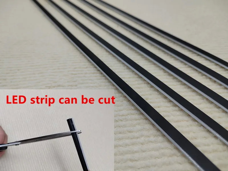

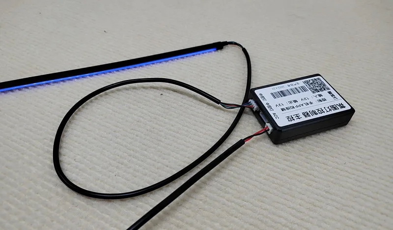

Well i did it my way.
I bought a set (ambient light) from Aliexpress with nice LED strips, very narrow and with smooth light effect.
Sc598e270764f4bb5ab7d9cf5ad1f99b3h.jpg.3ad7cf3c36184dd5fc714cf158a41200.jpgS18c94733f45f403eb42689e70c4132a88.jpg.54aad4b4c32669a557c15a4062e21526.jpg

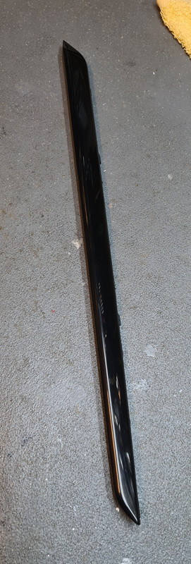

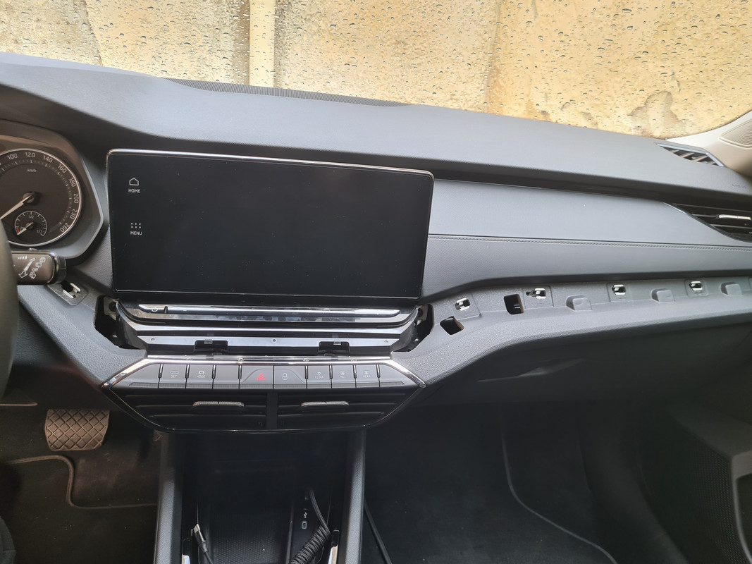

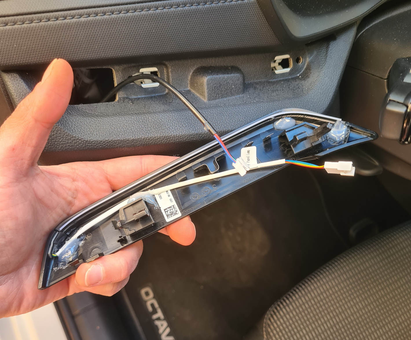

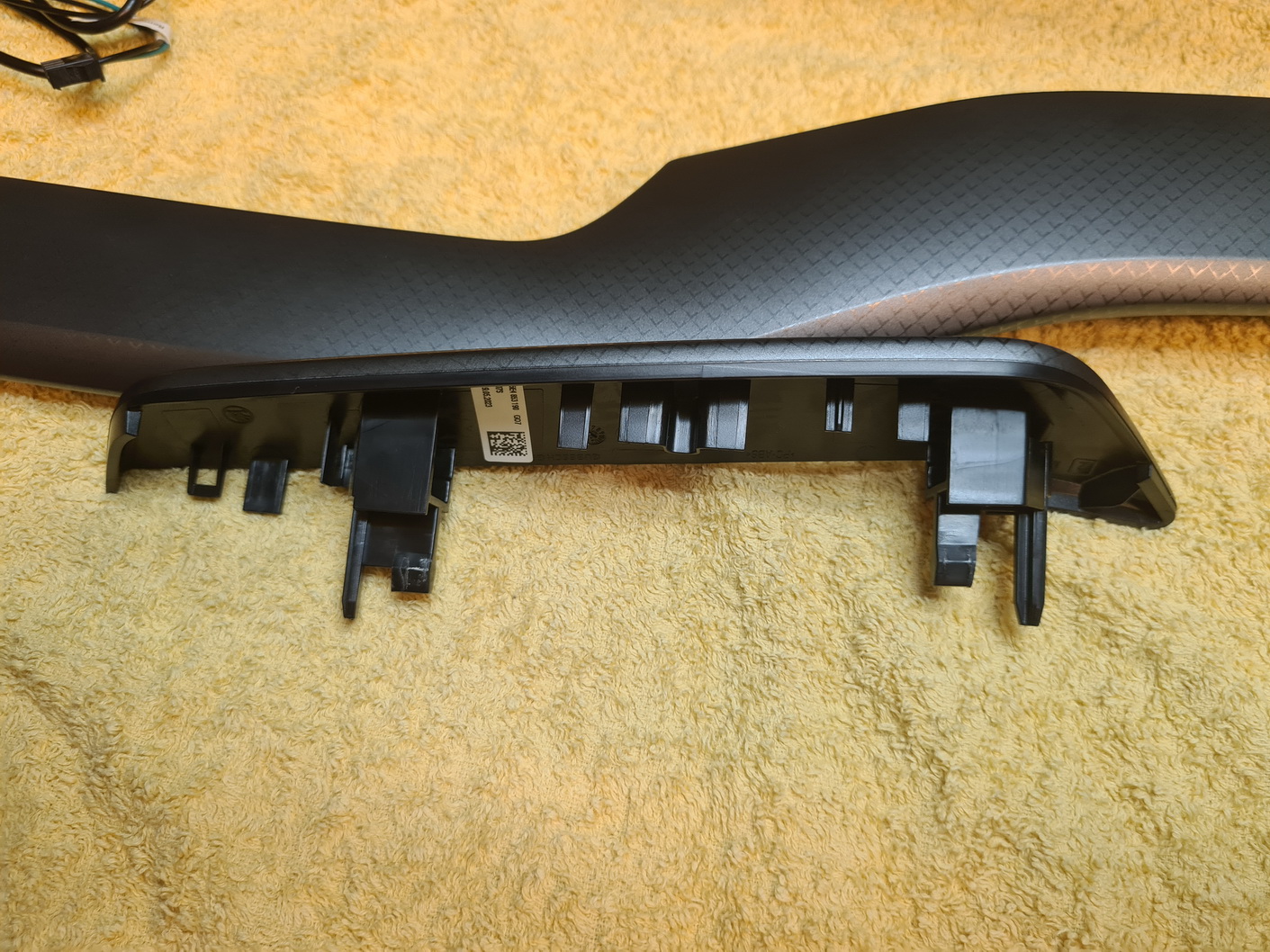

So i remove the dash trim inserts. It's pretty easy, you just pull them out of the dash.

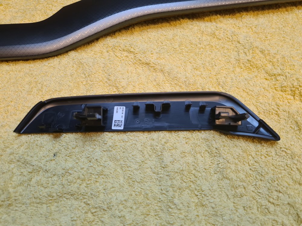

I will show you the procedure for the small one (from the driver's side)

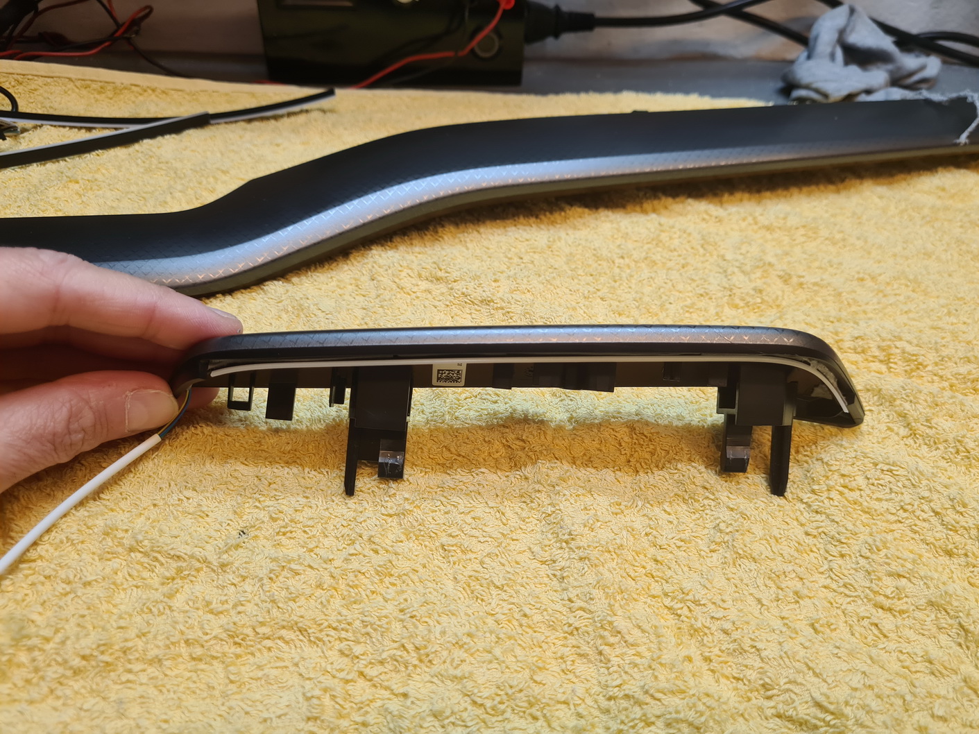

The trim :
20231222_064347_s.thumb.jpg.ac34f33c5caef260bed0f50338cade99.jpg20231222_064421_s.thumb.jpg.4a7357642fe58a3e0bef4e7e0d2c00d3.jpg

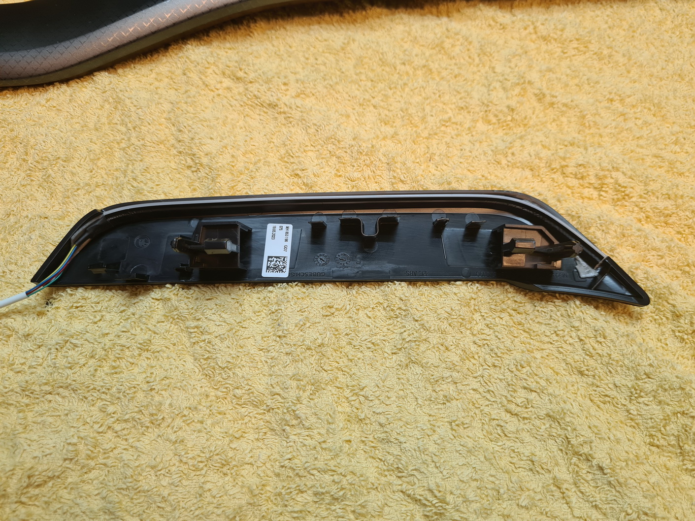

I cut and attached the LED strip with VHB 3M double side adhesive tape
20231222_071516_s.thumb.jpg.55391c7b1ff1e2dd29e846b31096df99.jpg20231222_071529_s.thumb.jpg.210606350e559dc0dcae9ab0ee947b36.jpg
Ready for the installation:

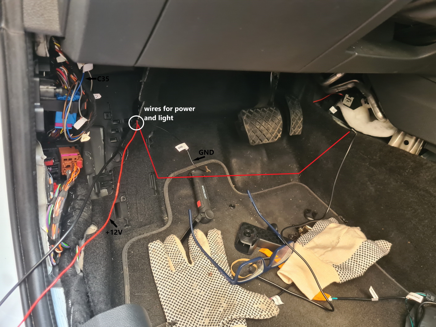

The wiring:
I decided to put the main module under the central console.
so i hid the wires under the driver's foot mat

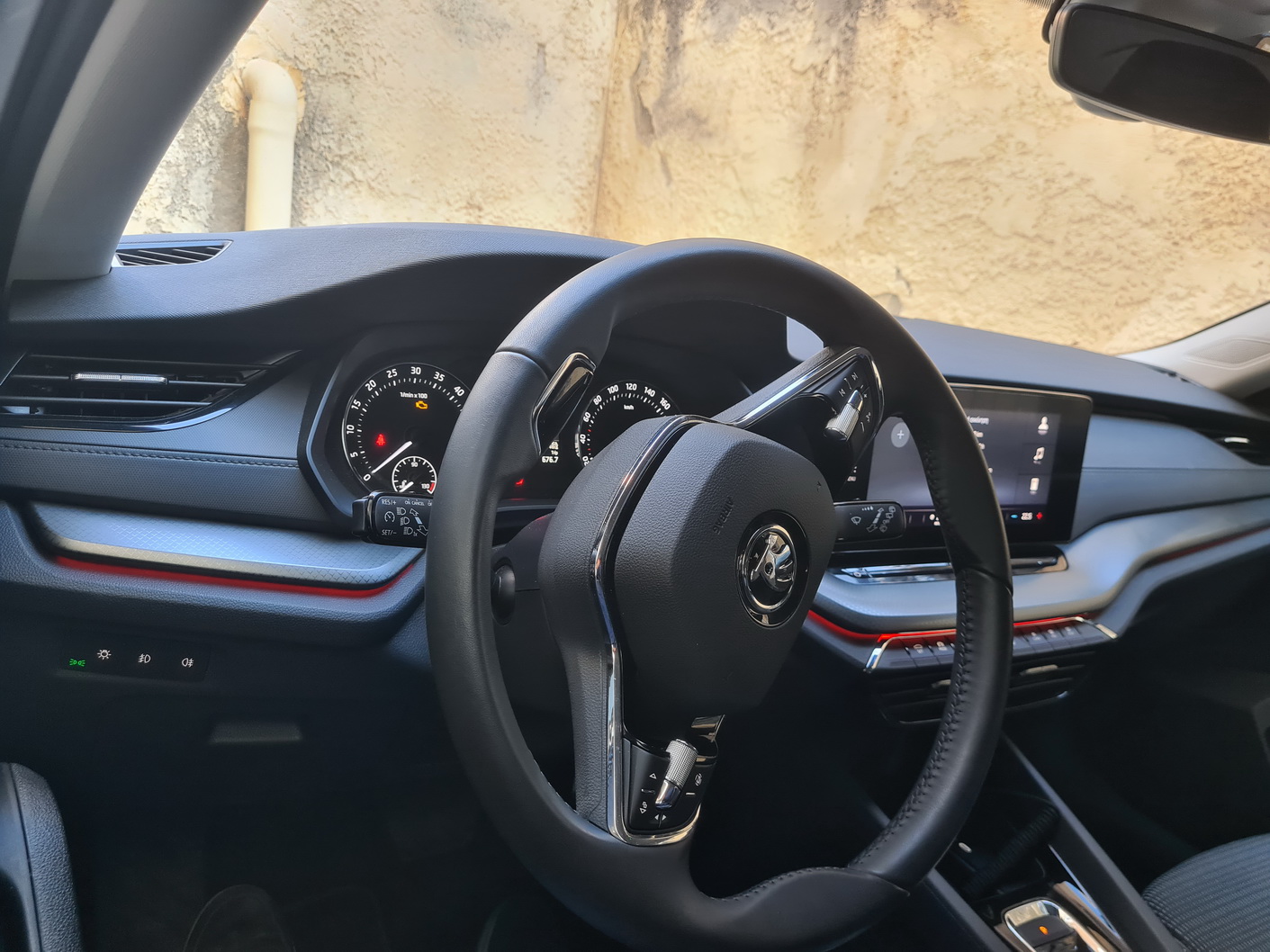

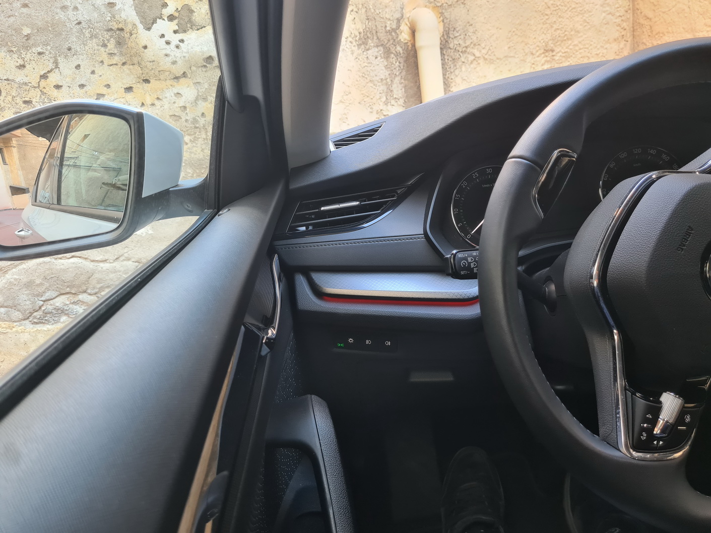

The final result
20231225_152820_s.thumb.jpg.b04b9c660ddd1df2f1b2e5ab2d39a736.jpg20231225_152725_s.thumb.jpg.419904497fbc571bd519d08ad6404f39.jpg
Excellent result.

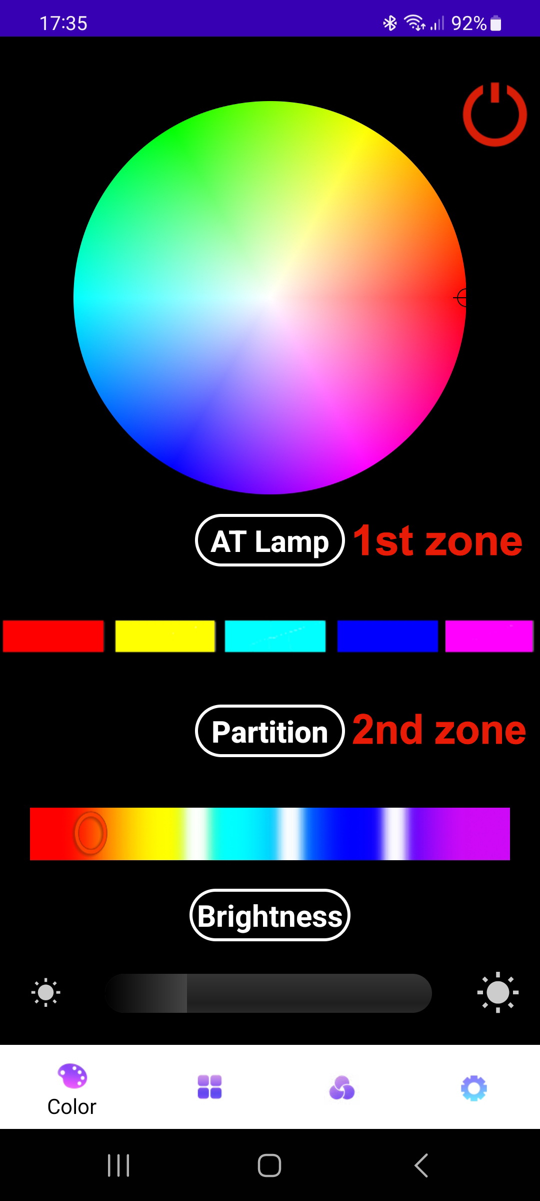

There is an application where via Bluetooth you can change the color and intensity of the lighting.
I love it. It has 2 zones, one for the dashboard and the second for the footwell lights (if you want to fit them)

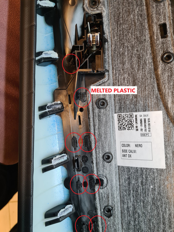

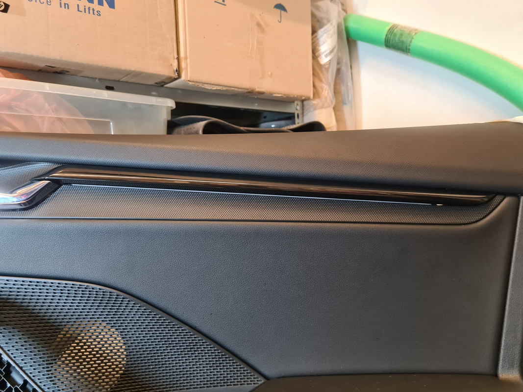

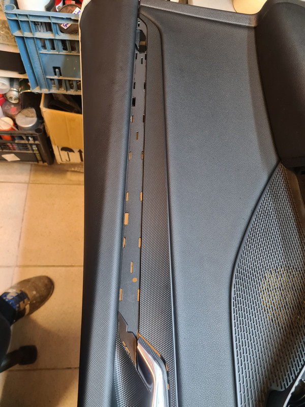

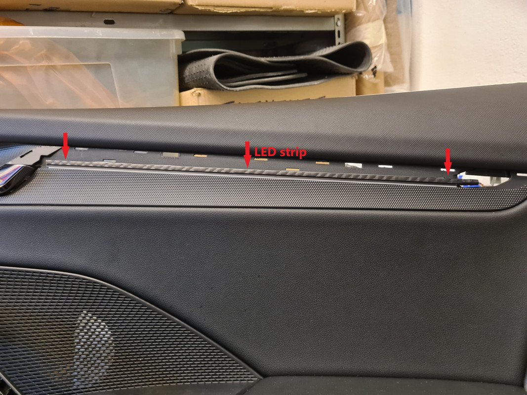

I did the installation myself on all the doors.
It was not an easy task. I spent many hours thinking about it.
I finally made the decision and did the installation.

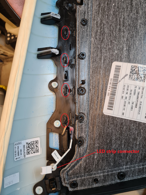

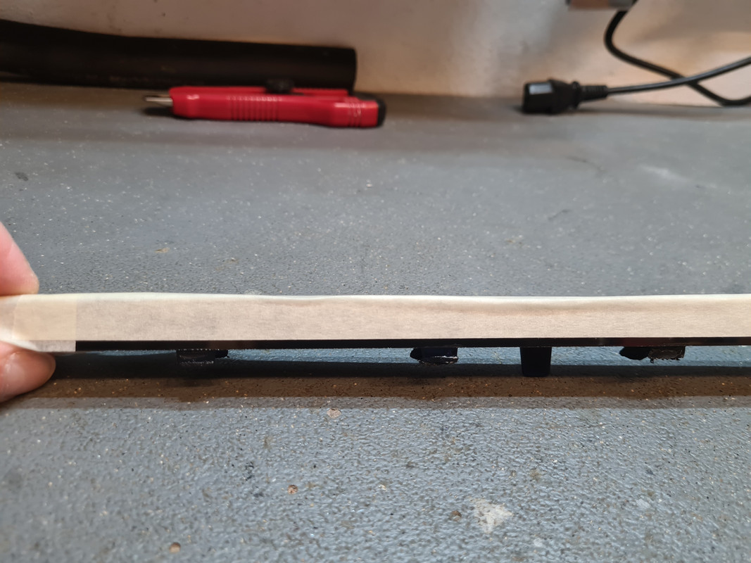

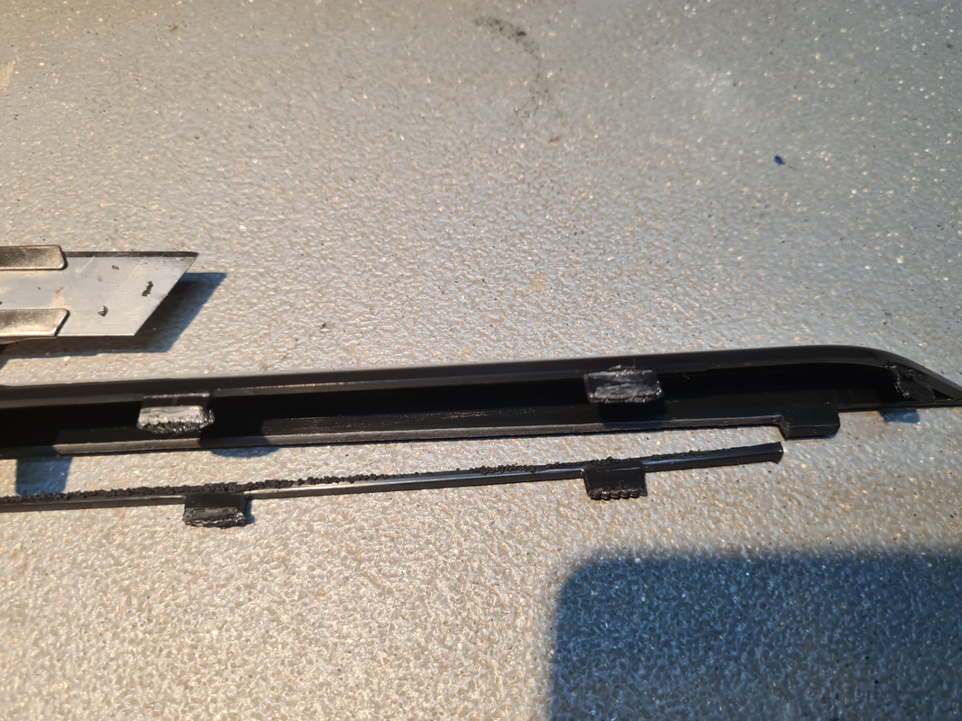

The door paneling needs to be removed of course. Then, removal of the plastic piece that in the best versions accepts the lighting.
Carefully cutting a thin line with a dremmel and gluing the LED strip.
Some photos from the "project"
The inside of the card door. Must be cutted with dremmel of with a iron solder.
After the removal of the plastic trim.
The plastic trim

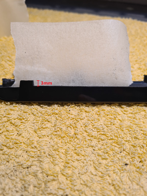

Masking with tape and ready for cutting.
Trim after cutting. The "gap" is almost 3mm.
I glued the LED strip with 3M double side tape.
I put the plastic trim back to its possition. I used a solder iron to melt the joints.
This is the final result.

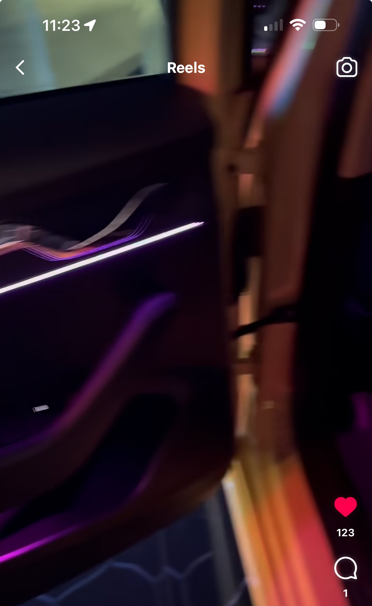

Amazing work my friend and I would love to see the final result of the car in a night mode !!!!
thank you for sharing all those details , I have already the “ambient light pack” when I bought the car but it’s less bright that I thought and it is really a bummer to not have led strips at the back doors when the rest of the car has , it takes away the feeling you know.
I think I will try to install this one at least for the back doors and find a way to connect it to the front or totally cancel the one from the factory and install something similar to your.

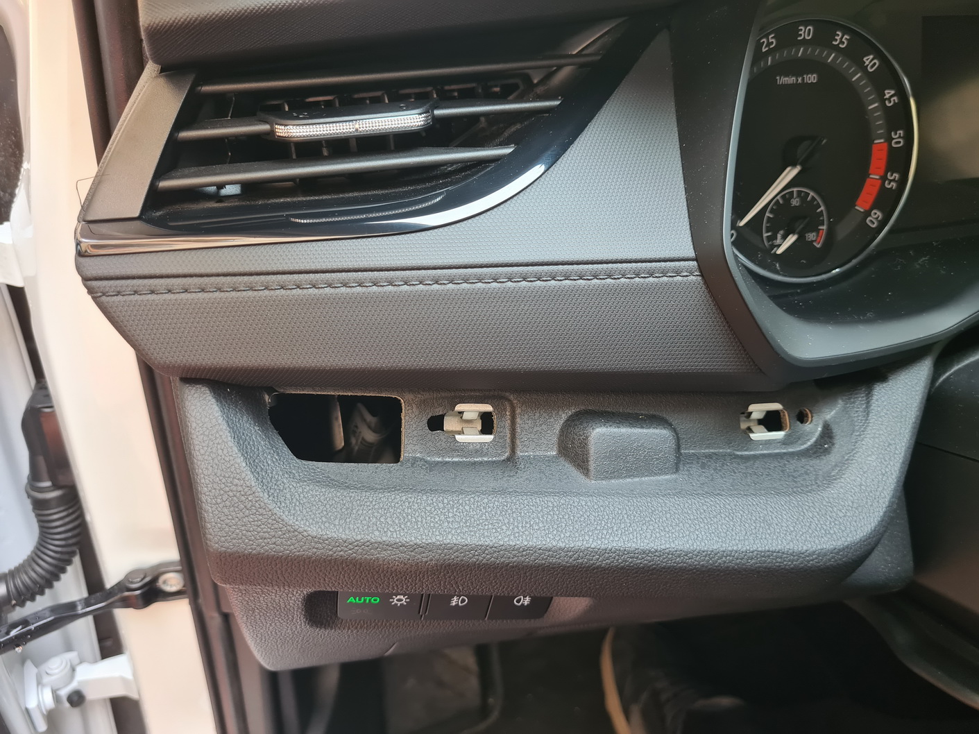

The dashboard decorations are very easy to remove. You don't need to remove anything else.
Just pull them out with your fingers, gently and carefully. There are no screws, just clips

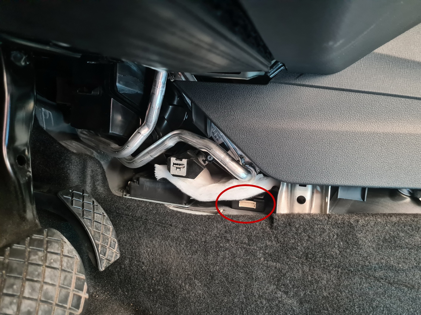

So there is a need for Pin 29 from the T73c connector and Pin70 from the same connector (T73c)
My BCM:
OK, pins are already exists, that's good (we have seen and read a lot about missing pins from various versions of BCMs)
The connector (from my car)
So far so good. Looks like I'll need to put a wire on pin 29 and  splice from pin 70 a wire for current.
And that's exactly where I'm at so far. I haven't made the connection, I'm making the wiring.

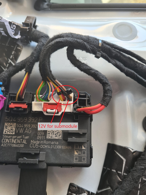

Can you help me, where do you connect power and earth for door lights? What wires did you splice in to?
Hello, I got electricity from the module of every door. I connected each light submodule to the constant current of the door module.
I suppose that it is switch power right?
Im thinking of using the rear wiper fuse fuse to power the main module, where do you power the main module?
  • Sponsor
Download the fuse assignments off of Skoda Erwin. If you want ignition switched, look for fuses that are "terminal 15"
