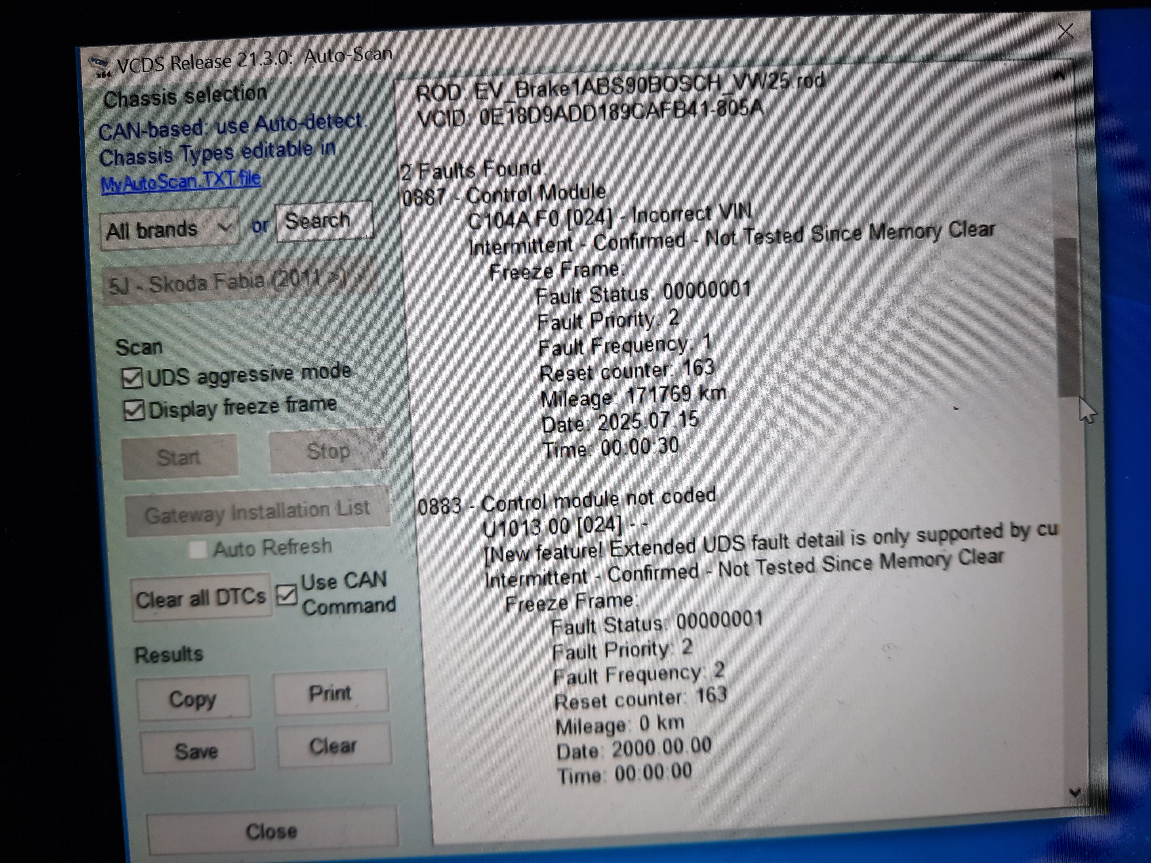

  3. Hi, I removed the indicator stalks from a fabia 2, I purchased and fitted onto mine.. which is also a fabia 2. Thinking it would be that simple to put cruise control onto my car. Obviously it didnt work. However somehow I have now managed to have the ABS lights on, on both of the cars. I seem that I have lost the Long Coding on the ABS Module... I dont know what I did for this to occur. My friend who has a ross-tech lead came and got this info, he along with me are a bit useless at anything like this. How do I remedy the faults on both cars ??? Regards Richard.
  4. I replaced both speed's back into the corresponding cars. Both now start. I have ordered the vag commander to try upon its arrival. But my main car is showing an ABS LIGHT along with codes 0887 & 0883, I seem unable to delete the codes with ross tech. Unsure how to proceed.
