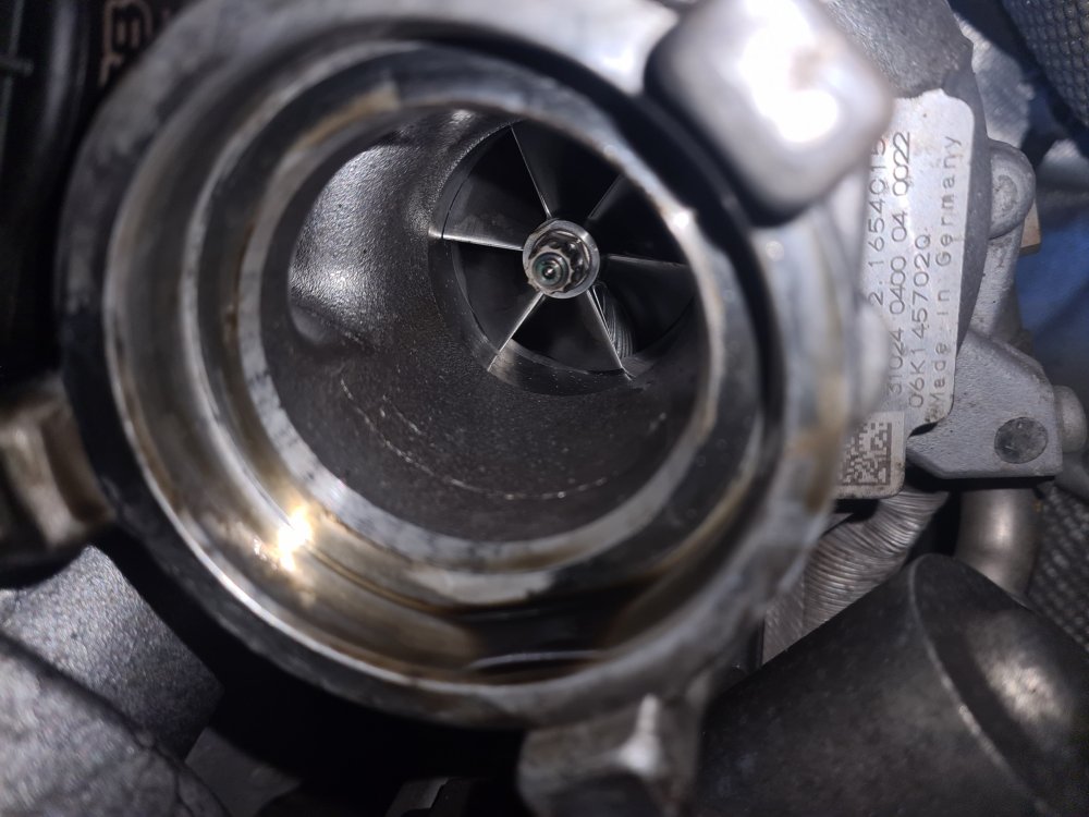

  9. If anyone has any other suggestions, thinks the turbo fin looks fine, then ill be delighted 😂 Siren noise only appears when starting to boost.
  10. First topic I could fine, but add me to the small list of Mk3 Octavia owners needing a turbo replacement. 63 VRS petrol with 80k miles, started howling like a siren one day. Huge play in the shaft and i think it looks like a damaged fin from the photo I got. Almost £1000 for a new turbo from a place in Glasgow, but they don't keep them in stock, so going to send mines away and hope it can be sorted.
