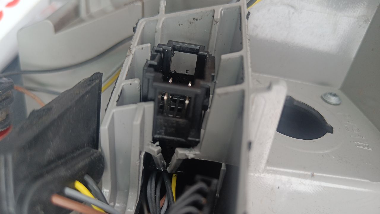

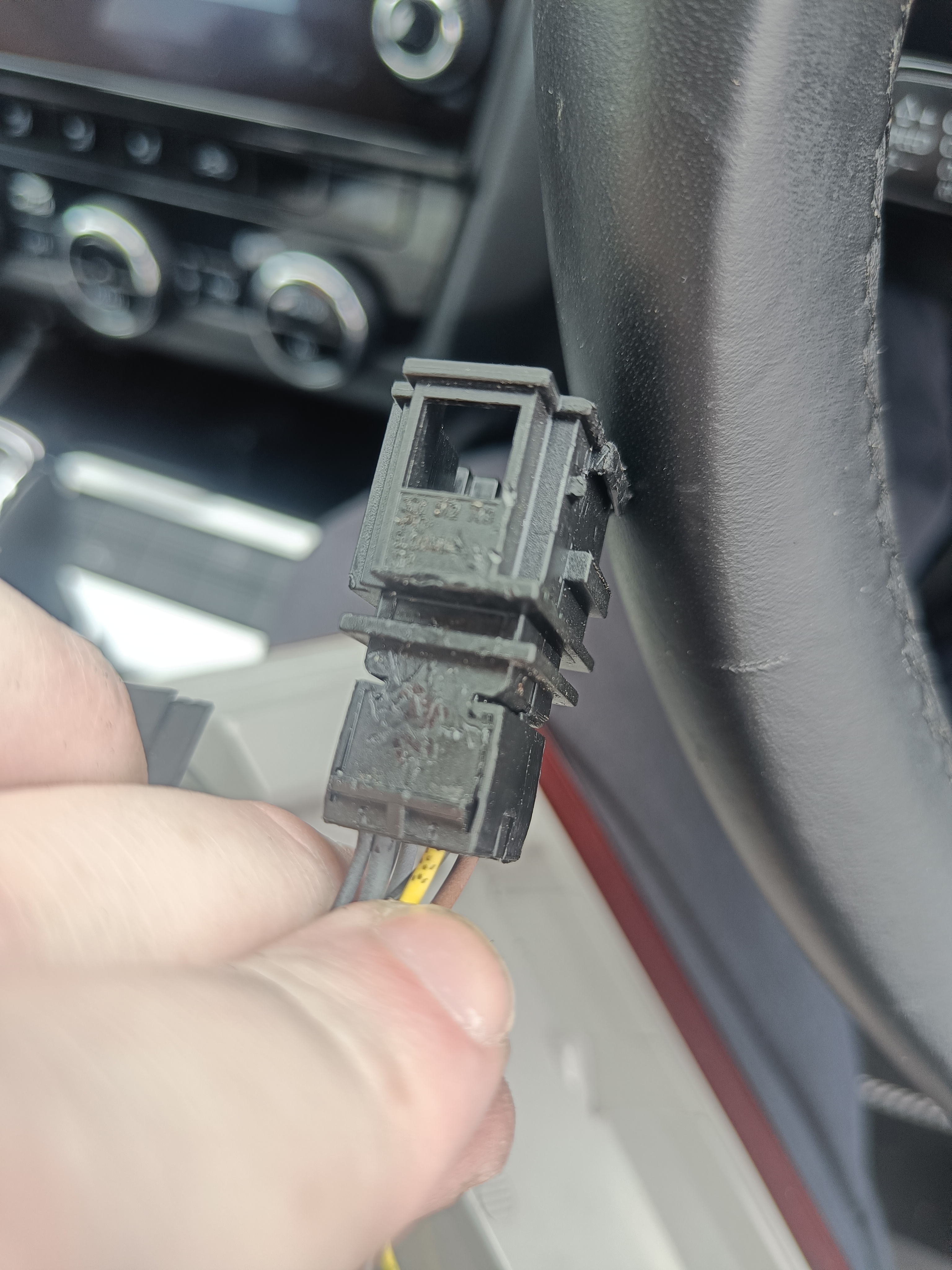

  2. Finally solved it. The solution is to apply leverage on the "ledge" roughly half way down and it comes free.

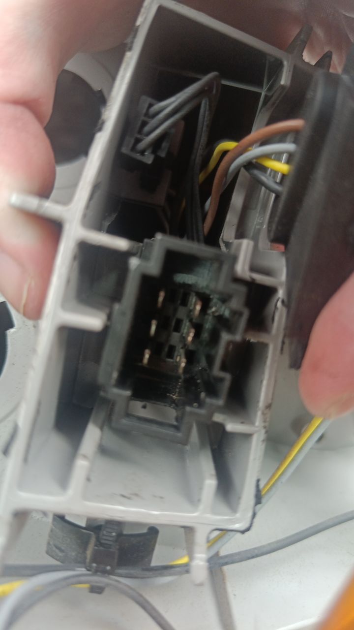

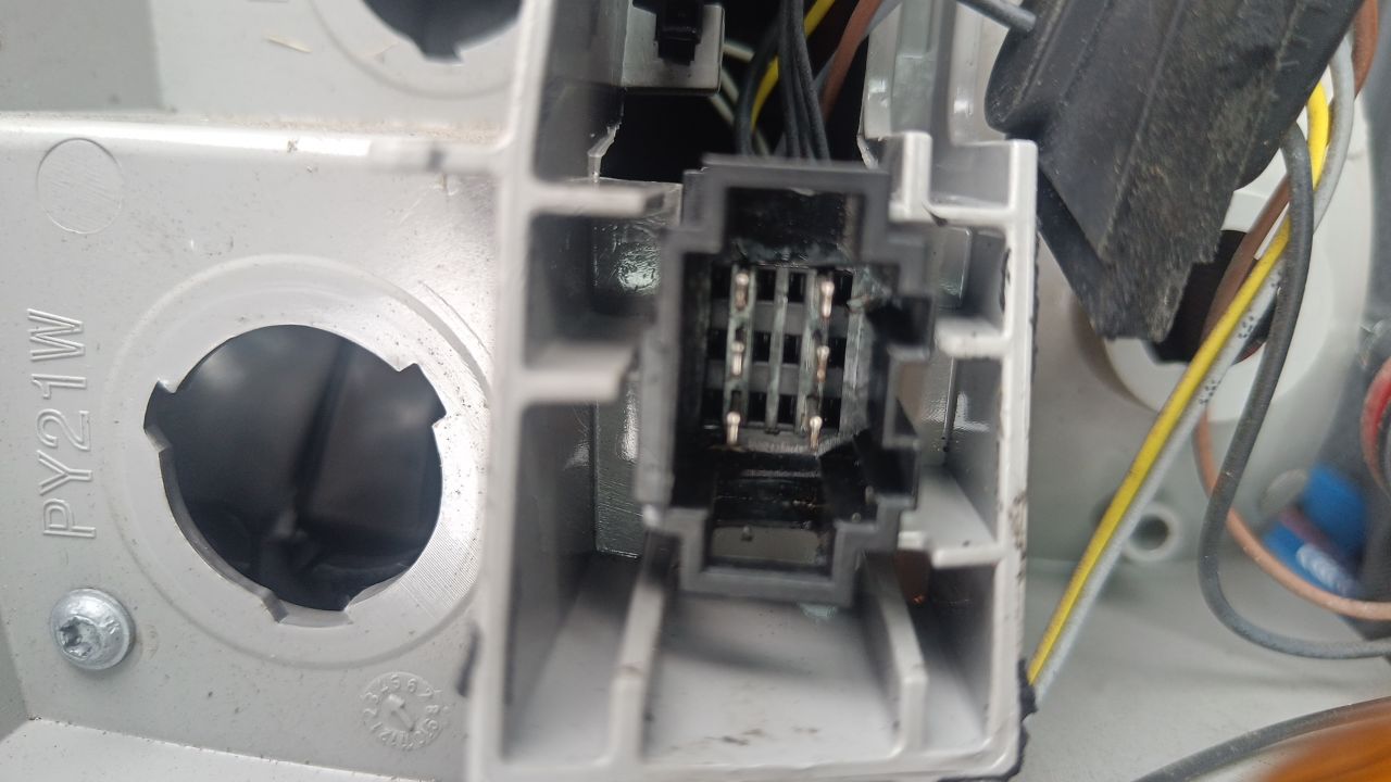

  3. Here are a few pictures of the connector in question. Couldn't get any more detail due to the amount of plastic surrounding it, alas.
  4. Having had an incident whilst my car was parked which resulted in the cover on my Driver's side rear light cluster - being a facelift vehicle, it's the part-LED version too - ending up in pieces on the ground, I duly ordered a replacement light cluster (as Škoda will only sell you a complete unit, not just a cover) from my usual dealership (given the part on its own was cheaper than my insurance excess), expecting it to simply be a case of removing the old one, swapping the bulbs into the new one and fitting it. Rookie mistake there, as all they've supplied is the bare shell! I've managed to get most of the wiring out of the old one, but can't for the life of me work out how to extract the socket that the plug from the car's wiring connects to. Short of extreme violence (given said socket needs to remain in one piece) does anyone have an idea as to how to remove it?
