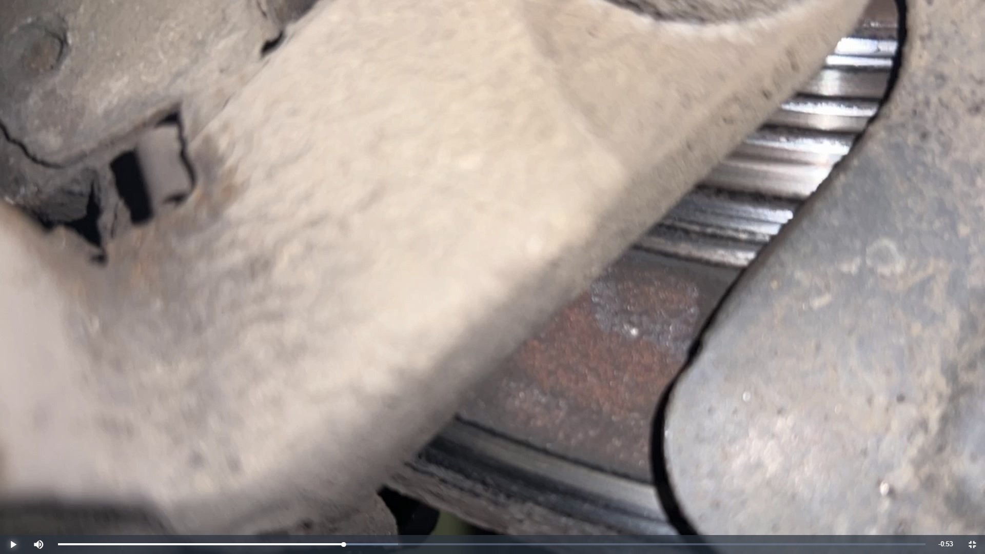

Yes they did a little walk around video and the contact area on the inside of the disc look awful to be fair. Heavily scored and then wide bands where there is little if any pad contact taking place at all. I've just independently bought some replacement discs and pads (Borg Beck) for around £85 and I'd be surprised if a local garage can't fit them for an hour or so worth of labour. So overall a likely >50% or £200+ saving compared to Skoda's price quoted.
