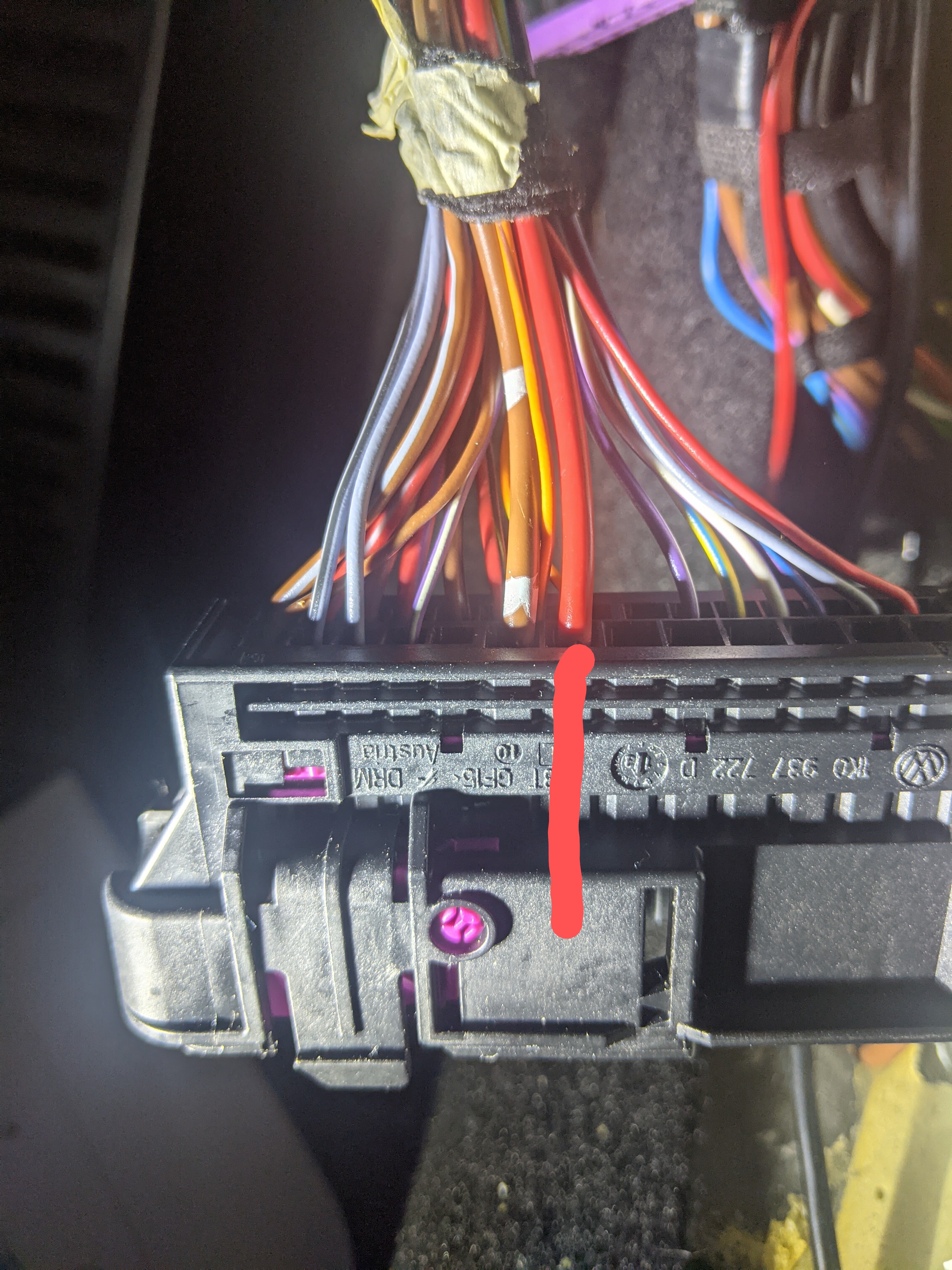

Could not find the problem.....mainly cos I can't read the wiring diagram! What I do know is there is no power for the red wire at the plug in the A pillar. It's the one identified with red line in the pic below.. Where the power comes from inside the car to there is a mystery to me!
