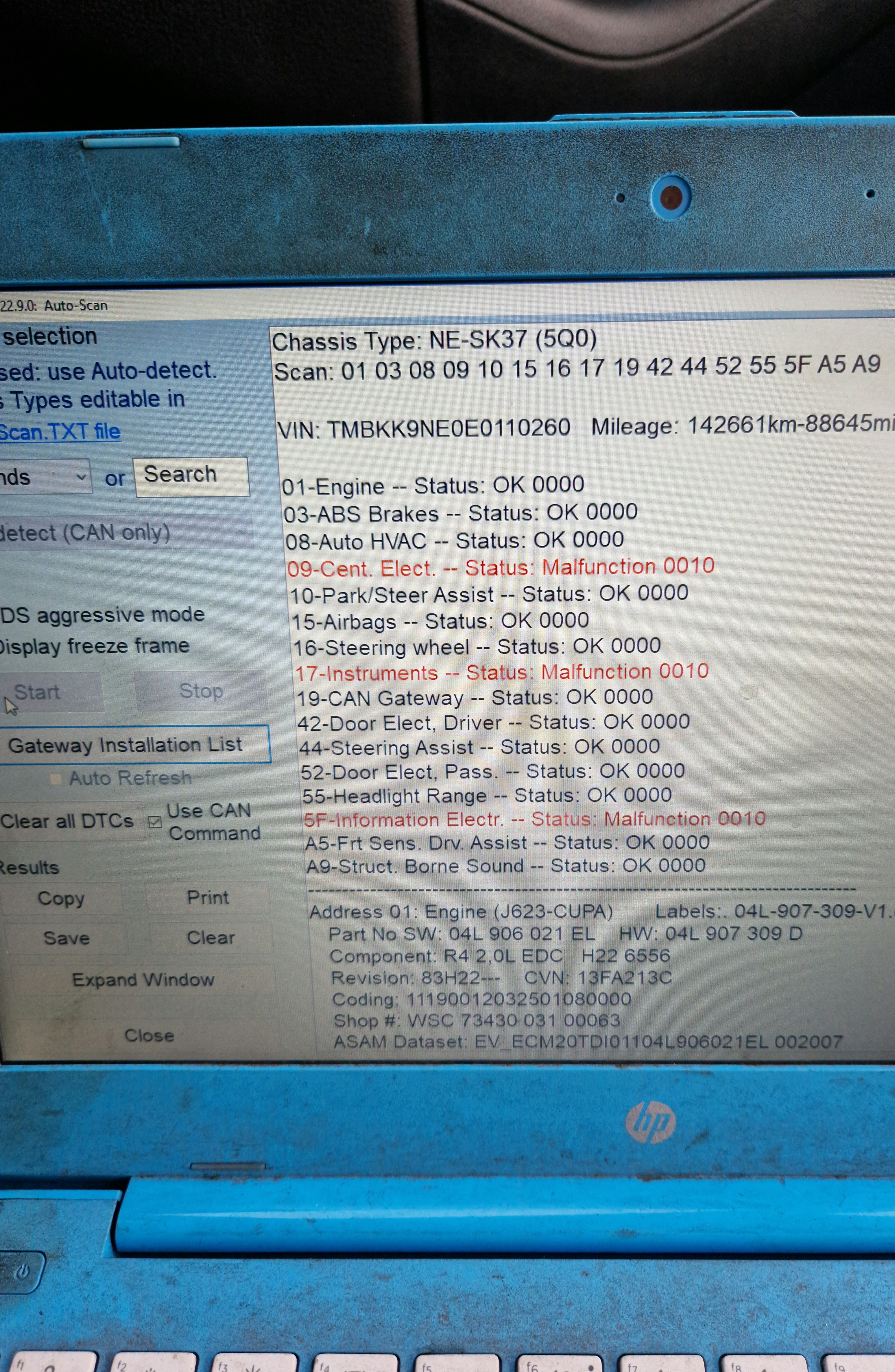

That's what I was hoping so a 2nd hand part should work in my opinion. Thanks for you help

When I get chance to plug it in again I will do thanks for the help- Automatic light sensor!

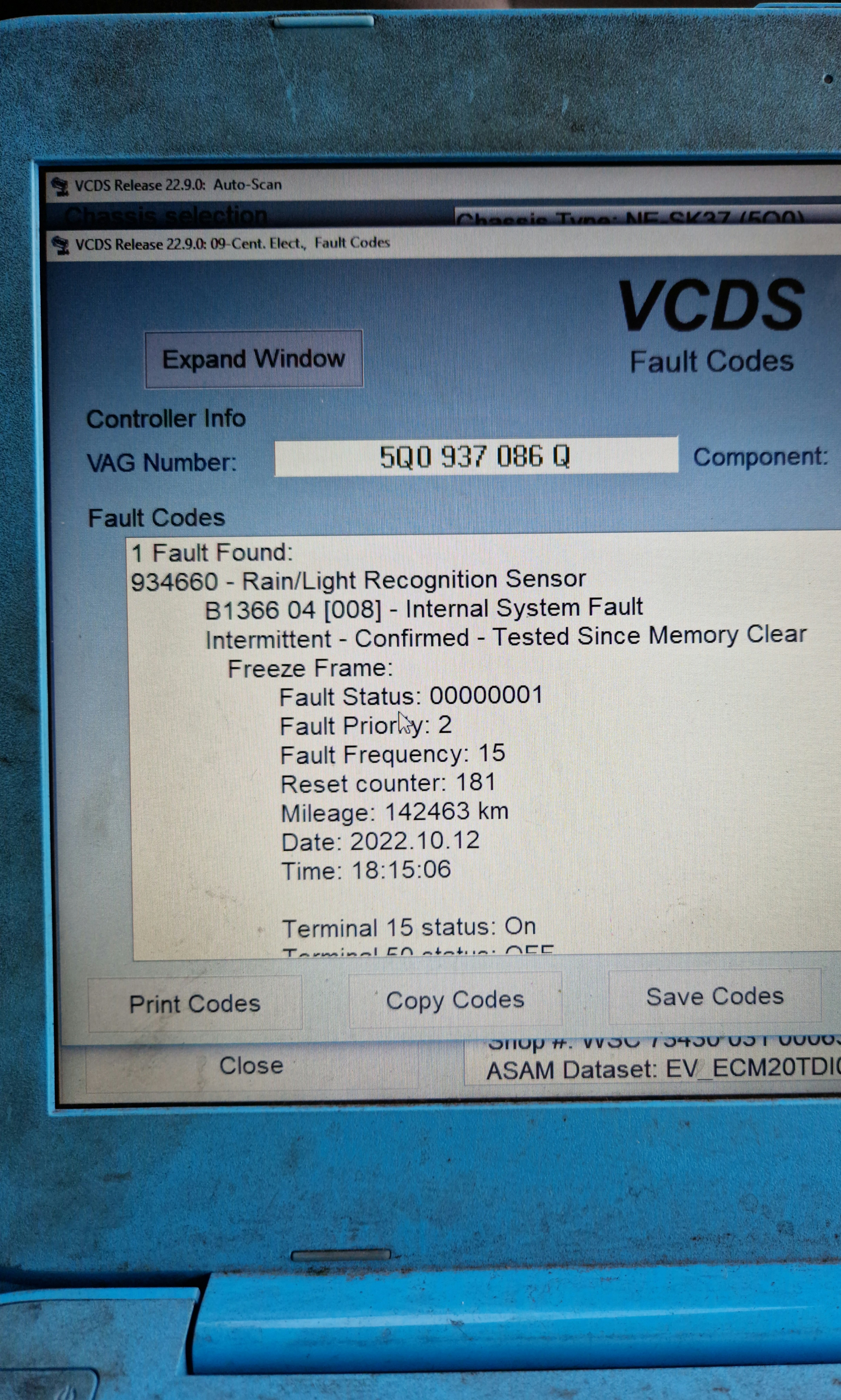

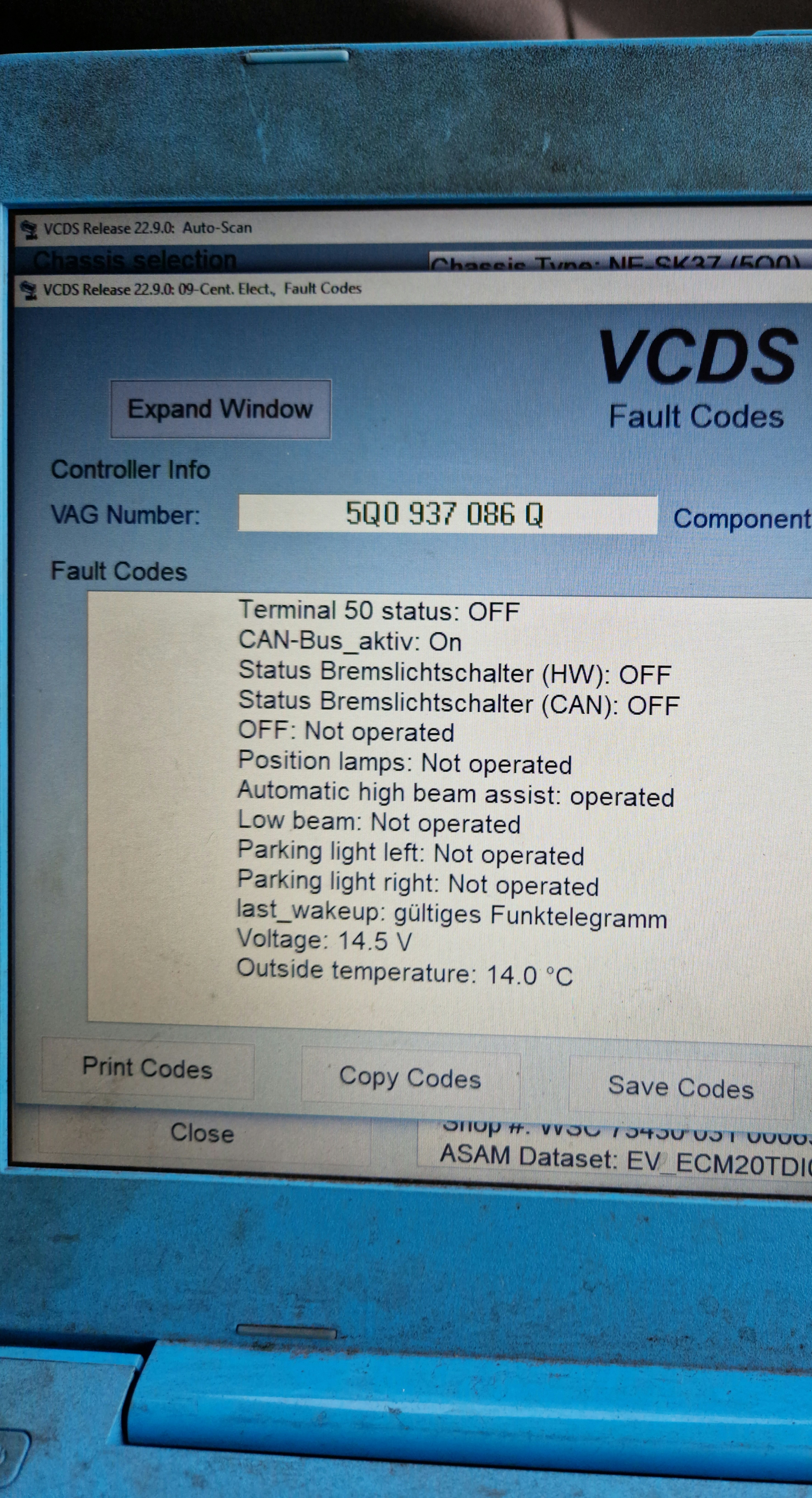

Hello and good morning. I hope some one can help. My octavia vrs mk3 is coming up with an automatic light fault. According to the vcds it is the light/rain sensor on the windscreen. Does any one know if they need coding in? And if so can you recode a 2nd hand one cuz I have a written off standard octavia but according to etka is the same part! Thank you in advance Rob- Rear brake caliper!
