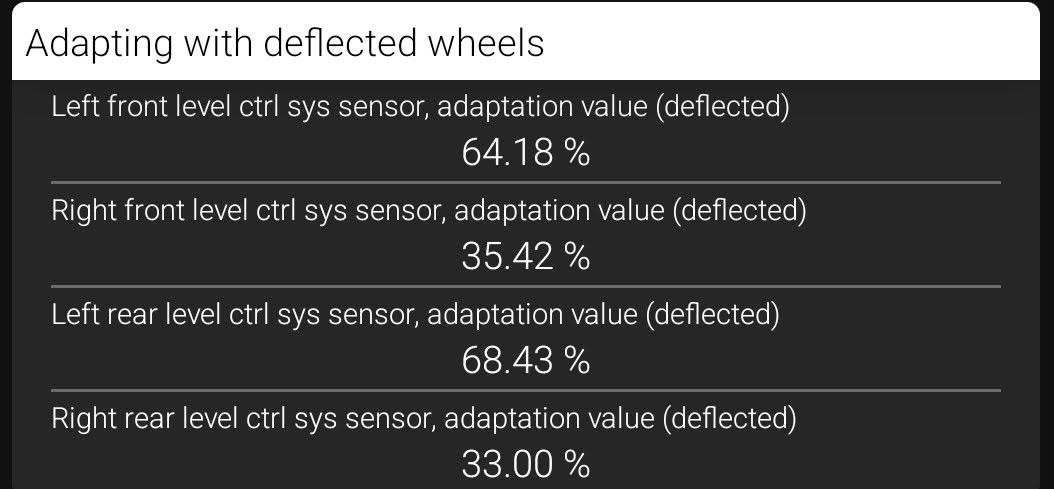

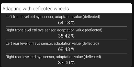

  2. Yeah, sorry guys, now when going through thread again, it's clear about rear sensor, thank you. What I don't understand is the Acknowledgement part - @JR RSwould you mind ? What I did : - lifted car - Control Module 14 - Adaptive Suspension - Entered security code 20103. - entered Basic Settings - Select “Adapting with deflected wheels” - Got error about incorrect sequence Do I miss something? Thank you. I have also tried checking the values in adaptation before basic settings, but that didn't make any difference. OBD11 says that Adaptation is possible, so I wonder what did I miss.

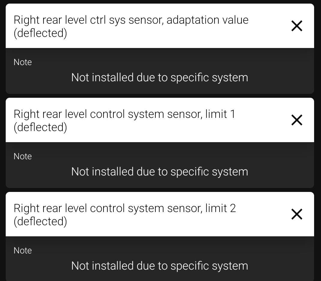

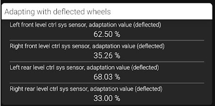

  3. Hi, tried DCC recalibration today but got error "Incorrect sequence" ... I checked live values and found out this on rear right suspension state - do you think it's dead ? 😉 ...adapted values seems to be OK... Thank you
