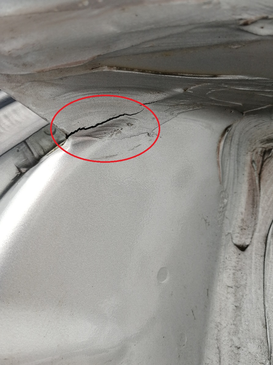

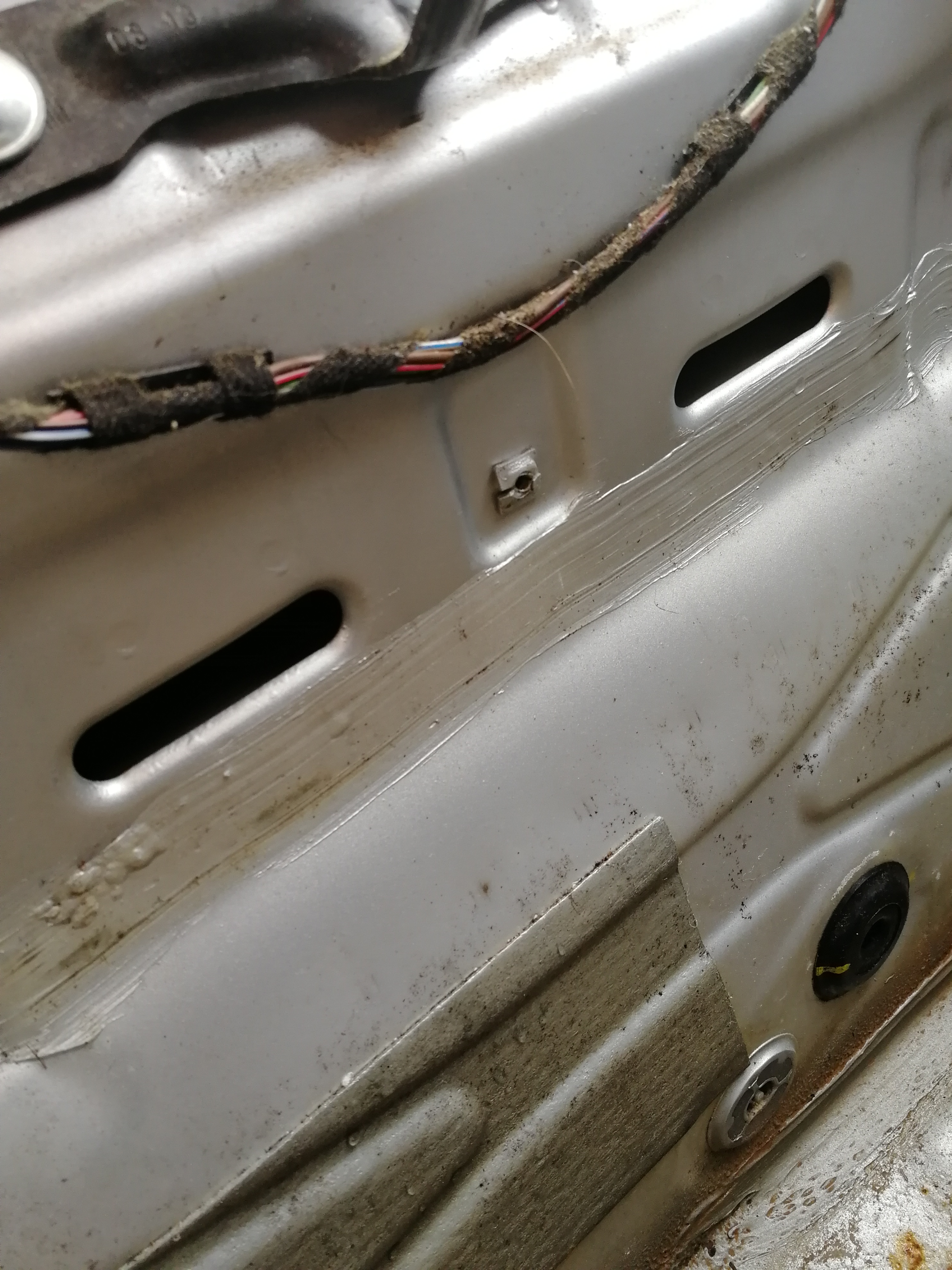

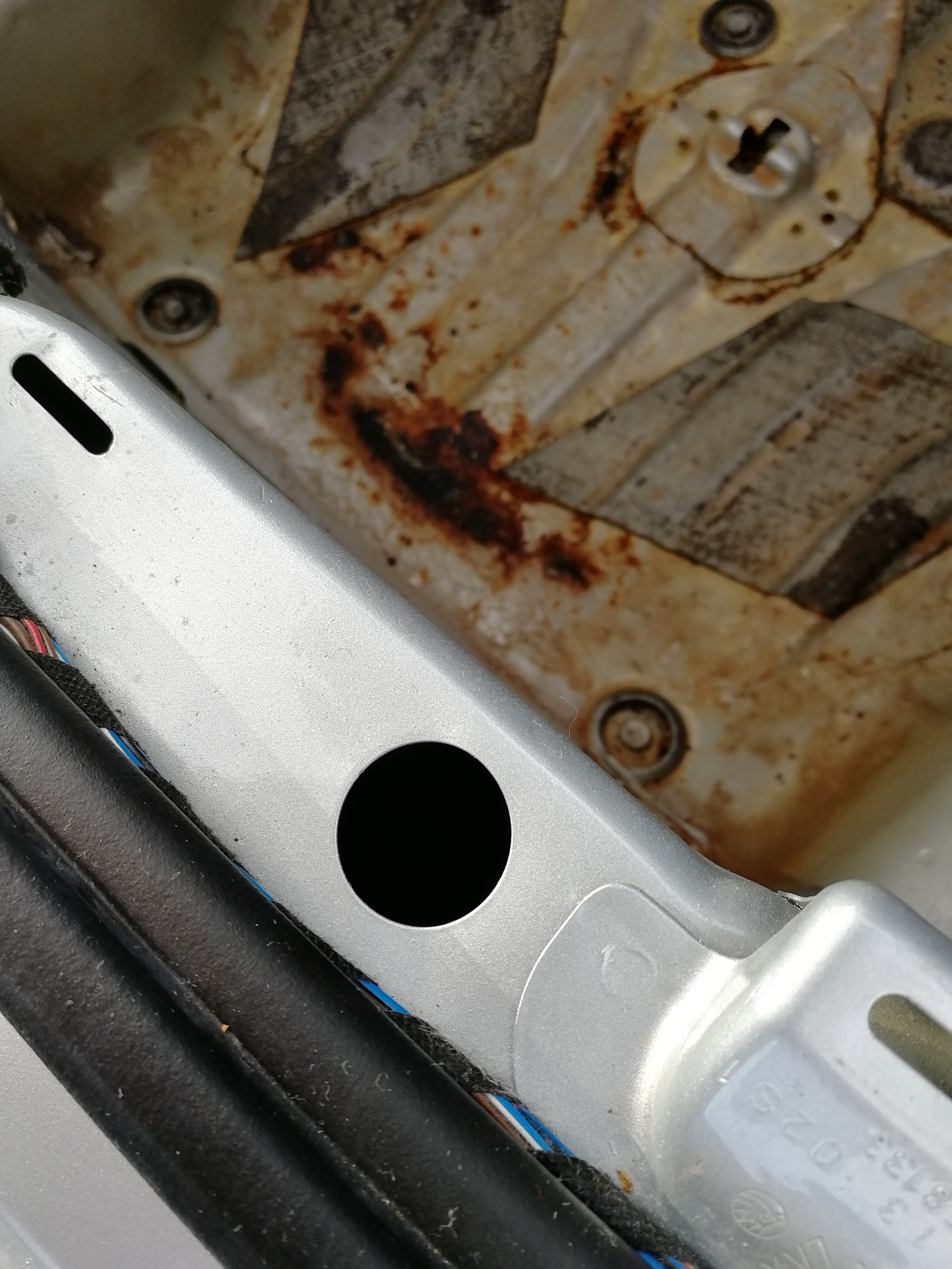

  1. Thanks for all the advice. I think I've found the source of the leak. After removing the off-side rear light cluster I spotted a crack in the bodywork - I've indicated it in pics 1 & 2. Looks like the water tracks through the hollow section at the rear of the car and enters the boot via the cable mounting point I've indicated in pic 3. I'm unsure how the crack got there. I've filled it with non-setting mastic and will visit a main dealer to get warranty advice.

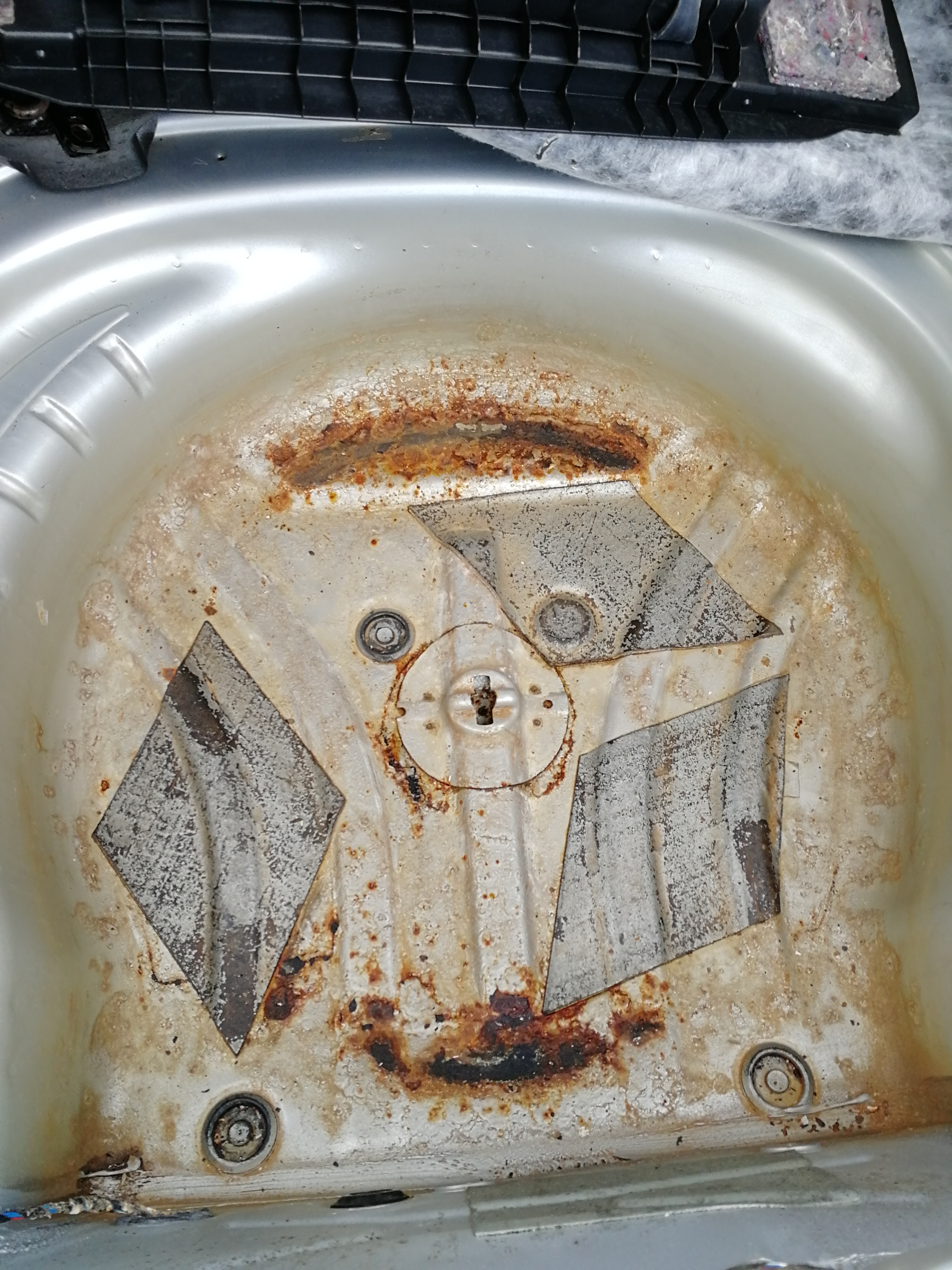

  5. Hi, I'd be grateful for some advice. I've found water pooling in the spare wheel well. Don't think it's coming from the floor area, think it's from pressure-washing. I've dried the wheel-well out but water appears trapped in the box section at the rear of the boot. I stuck the end of towel strips into the holes and they came out saturated - suggests there is no way for the water to drain. I'm asking for advice on two points - first is it likely that water has been forced through the rubber seal where it meets the hatch at the bottom (after washing there is moisture in the channels either side of the hatch but I can't see that this would work down to the wheel-well. Secondly do I just have to leave the residual water to evaporate - I'm tempted to train a hair dryer into the holes to try and dry the panel out. Thanks, Damian
