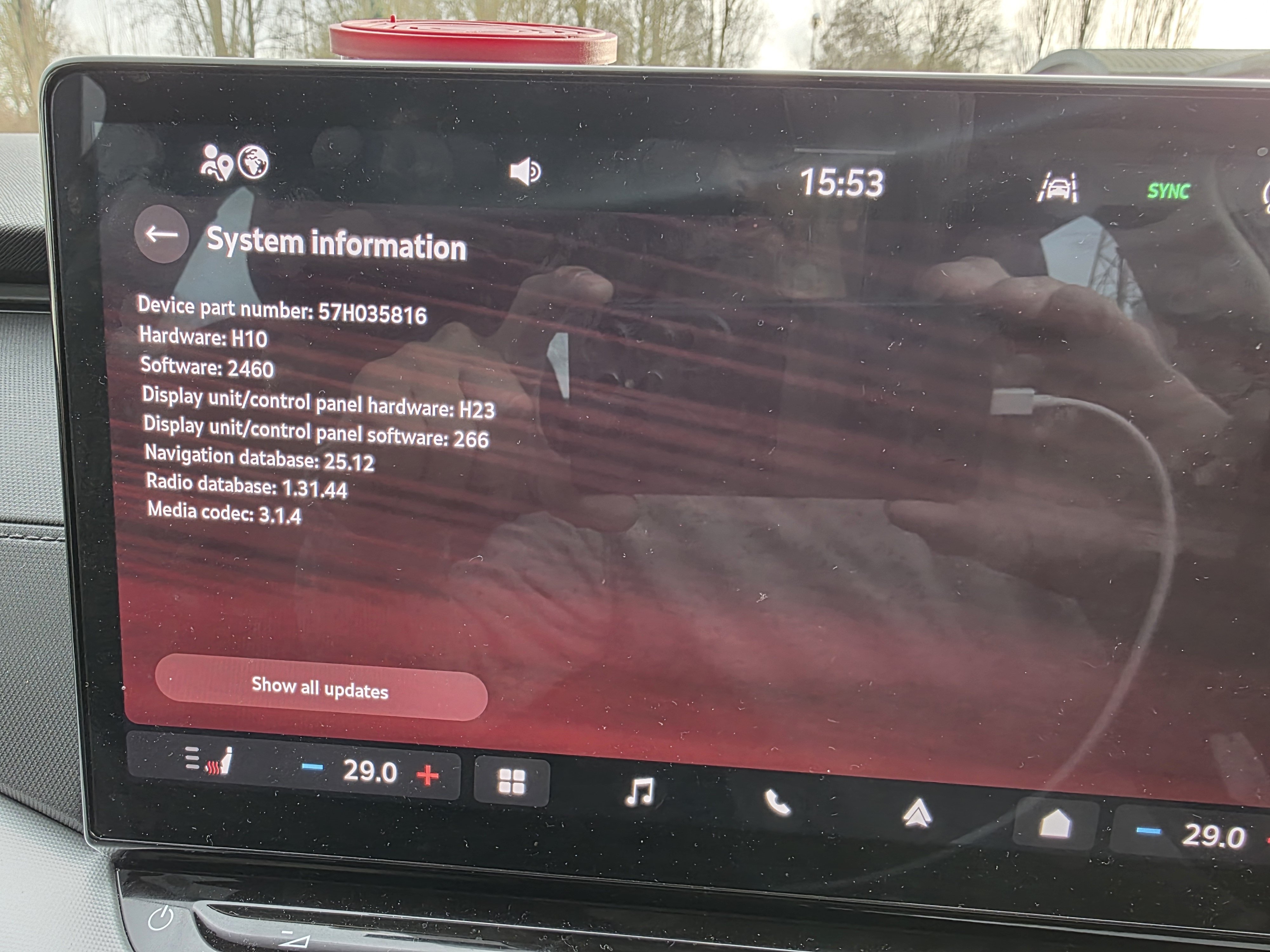

  5. Im now on 2630 all is going well onle issue is samsung galaxy s25 ultra is not compatible with only this model so AA wireless not working all the time.
  6. The connecting problem is still there after a mass update on car software anyone else still having issues with AA and Samsung Galaxy S25 ultra.

  9. Yes thay had it for a week had to have a massive update to a version skoda connect spent months telling me didn't exist incompetent is an understatement.

  13. Update car back today so far all working thay had to update all modules now running version 2630 from 2450 skoda spent weeks telling I was on latest software but like a dog with a bone I didn't let it go and now updated to the software version they said didn't exist. The moral is don't take no for an answer argue with them as they will fob you off.
