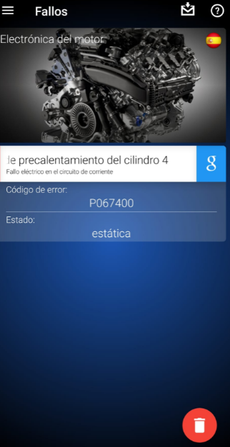

sorry the delay. i bought a OBD2 elevenpro for diagnostic, and i have on motor unit a P067400 fault code. --> fault of glow of cilinder number 4. i replace the glow and clean de fault with obd2 and now problem is solved. Automatic Start-Stop disabled too with obd2. thanks¡¡ -

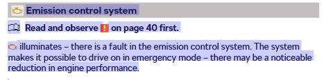

HI all, for a few days I have this light on. Has it happened to someone? I have to take it to the workshop but I can't for 1 week, in case it has happened to someone and it is easier to solve it yourself, thank you! I try disconnect battery for a few seconds but not resolve the issue. my car is a SUPERB MKIII 2015 2.0tdi 150
