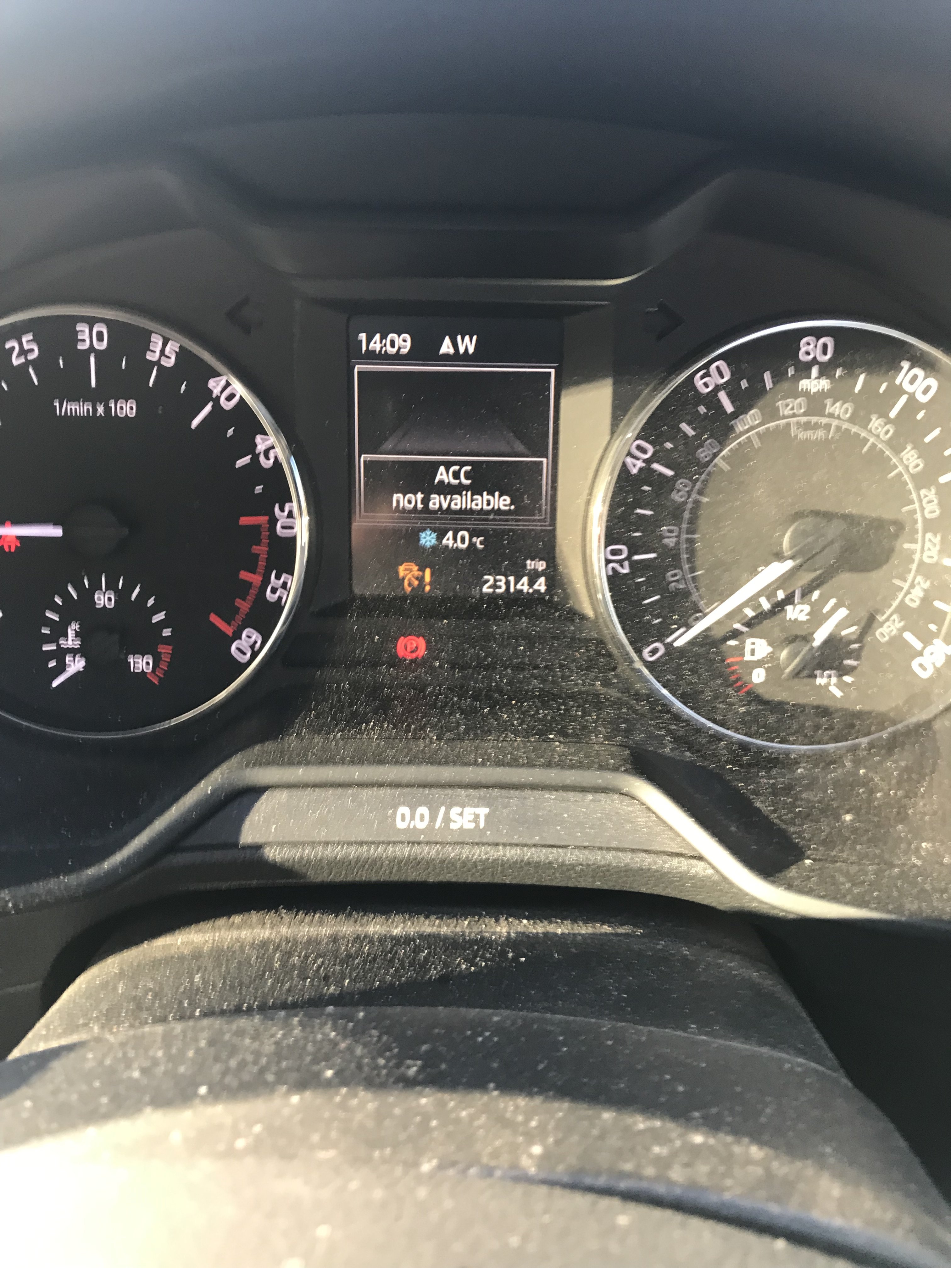

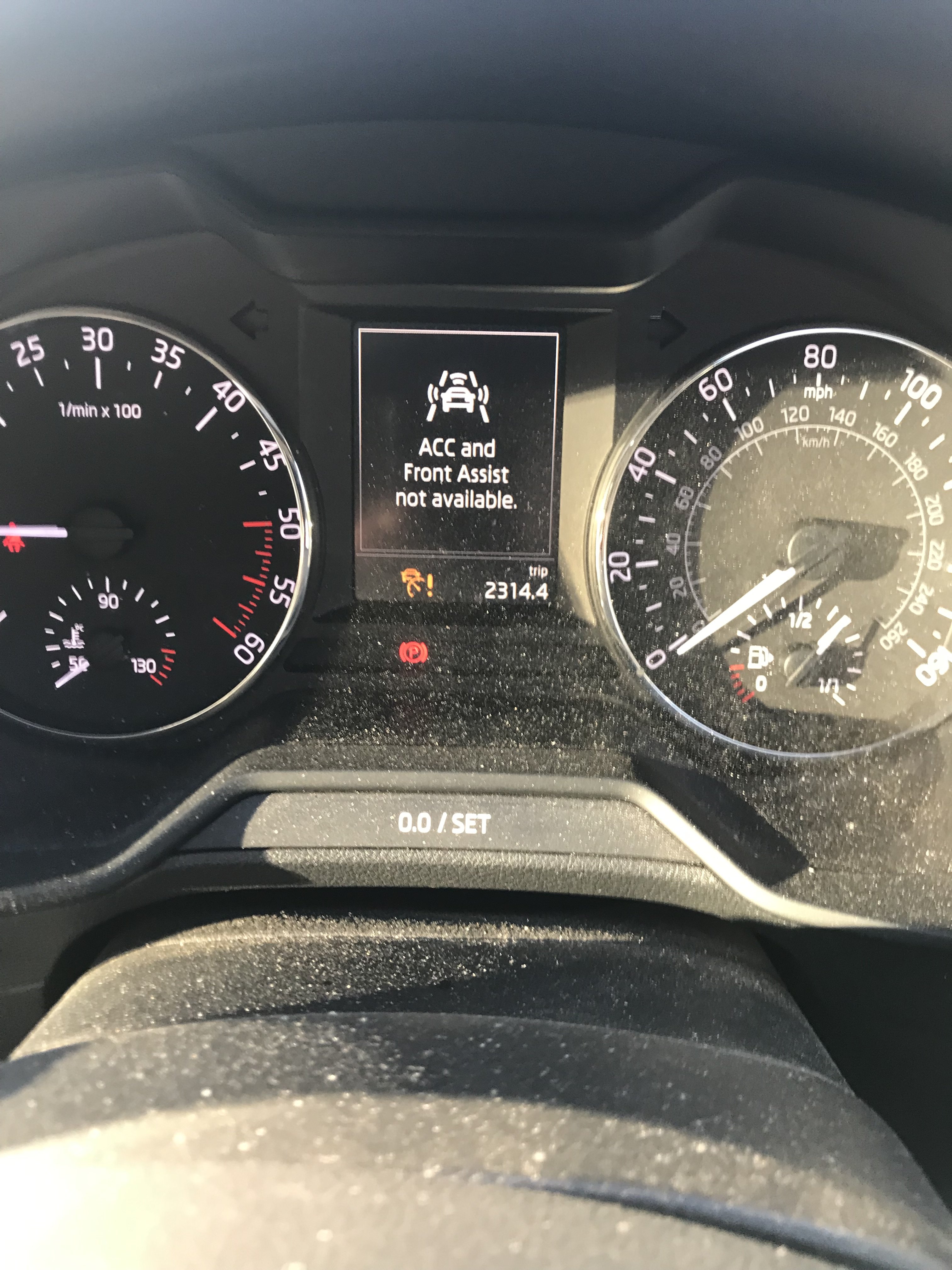

  4. Sometimes when I start the car (Octy3 my2016) I get warnings about ACC and Front Assist however car behaves and drives normally. See photos. Do I need to be concerned or is that normal. Usually happens immediately after a cold start. Thanks Bob
