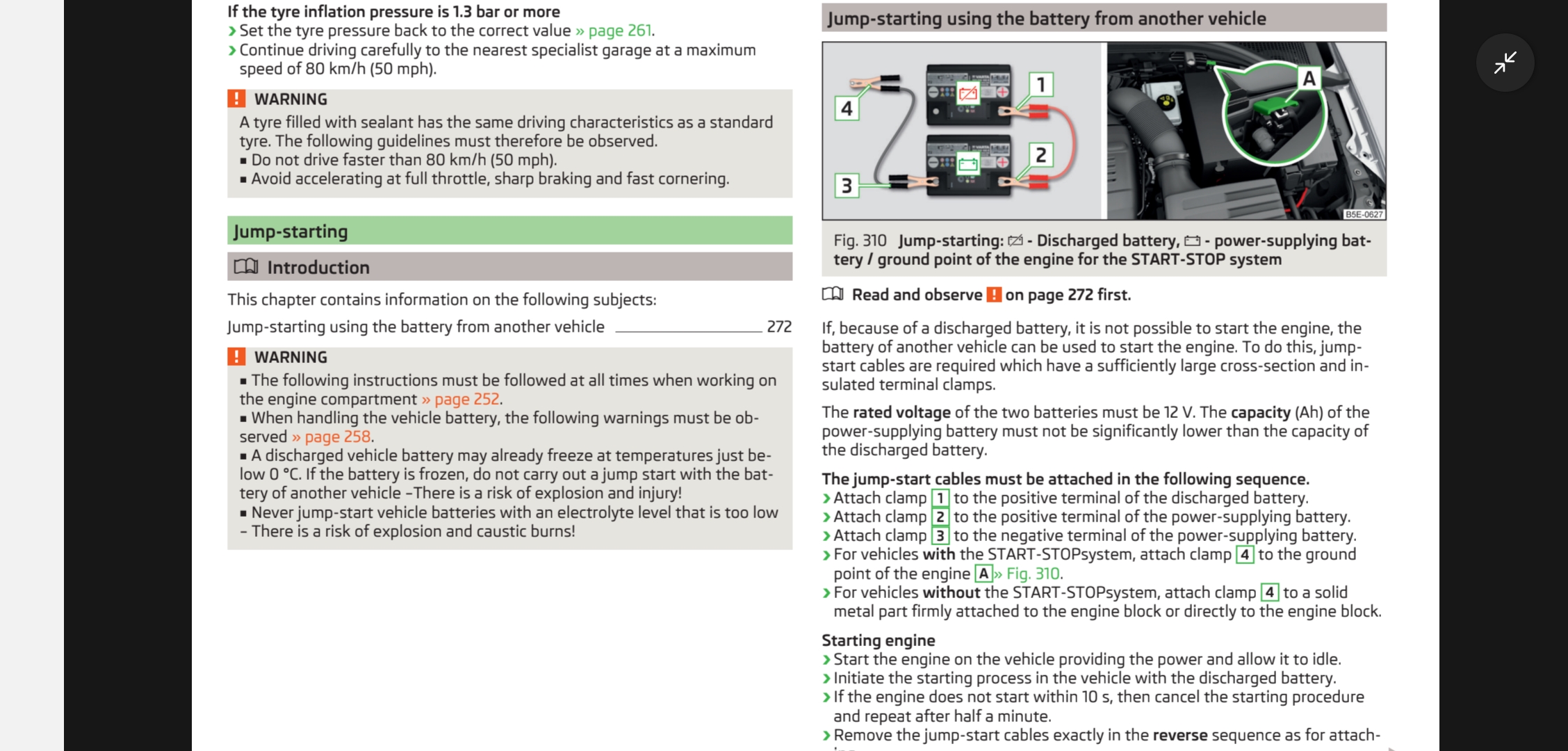

  3. You mean jump-start procedure?

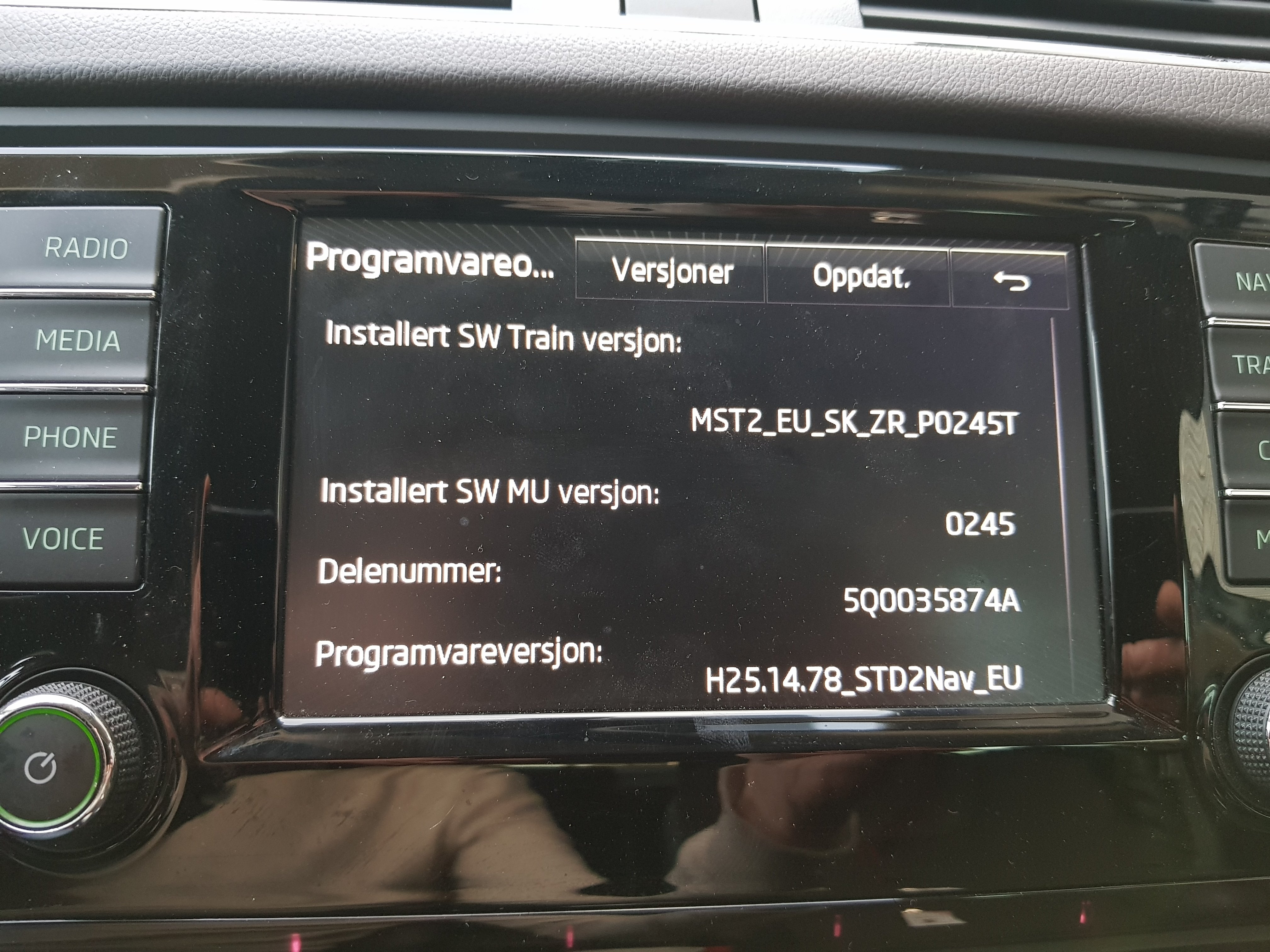

  5. Hello Been lurking here for some time, and this is my first post. My car is a 2016 Octavia estate L&K 4x4 1.8 tsi, love it! Is there any software update available for the infotainment system? If more info needed, I will provide..
