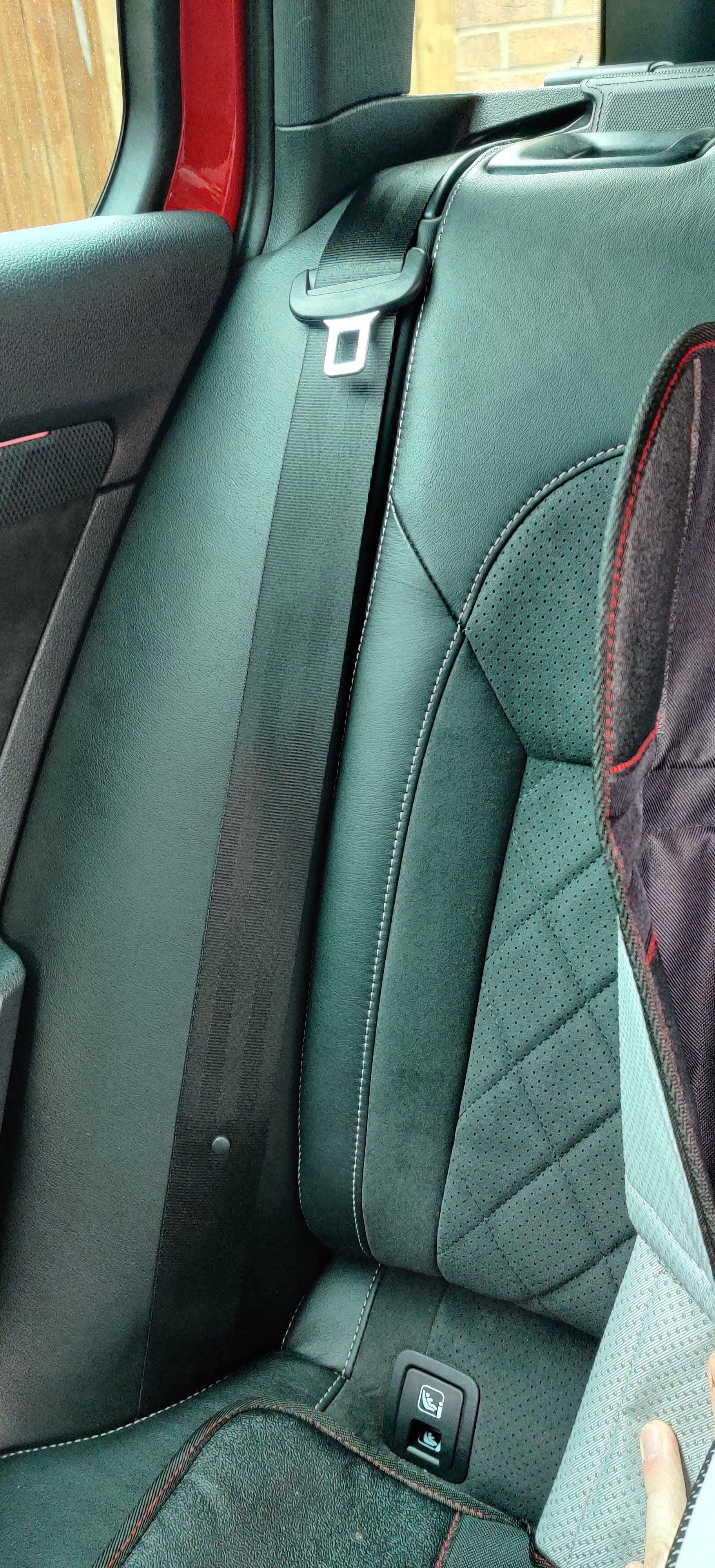

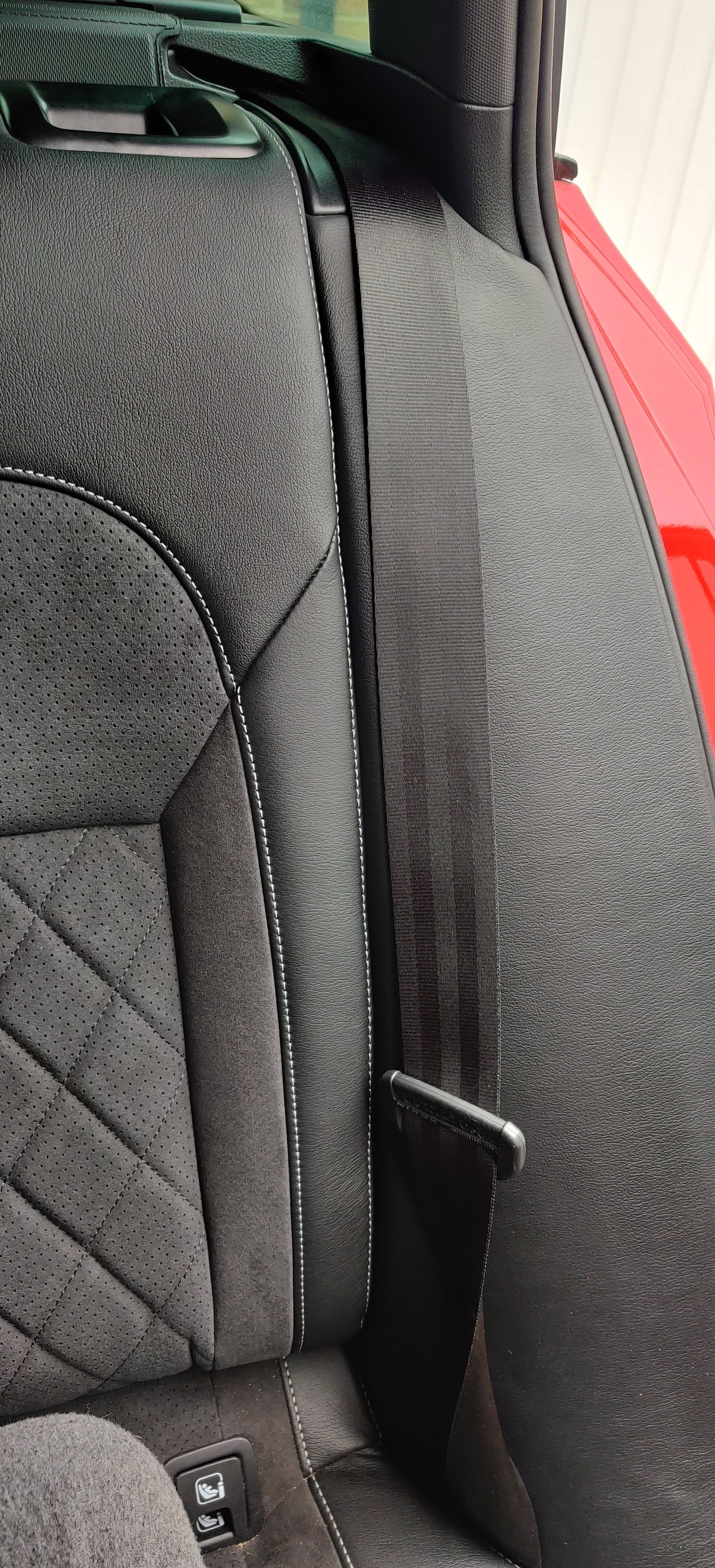

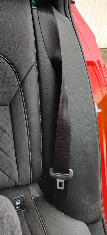

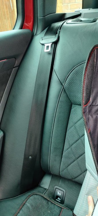

  2. Thanks all, Resolved the issue, pulled the belt all the way out and then fed the twist back through the opening behind the top of the seat.

  4. Yes I'd remove the plastic bungs at the front, they just pop back in.
  5. Yeah langers2k, ive pulled the belt out all the way, like I say I first thought that the kids had just forced the buckle through the belt. But when I pulled the belt all the way and kept it flat it's clearly twisted.
  6. Hi, This might seem a bit of a daft question but after cleaning the Superb and sitting in the back of my own car for the first time I noticed that the rear nearside seat belt looked twisted and assumed one of the kids have forced the buckle around the belt, but when I've looked in to it further I think the actual belt is twisted when its been bolted to the car behind the bottom of the rear bench? I'd of thought that both rear belt should lay flat with the buckle pointing the correct way, like the rear offside? Also looking on picture of other superbs on Autotrader it appears that both rear belts lay flat. I thought I'd ask here before making the trip to the dealers. Cheers.
