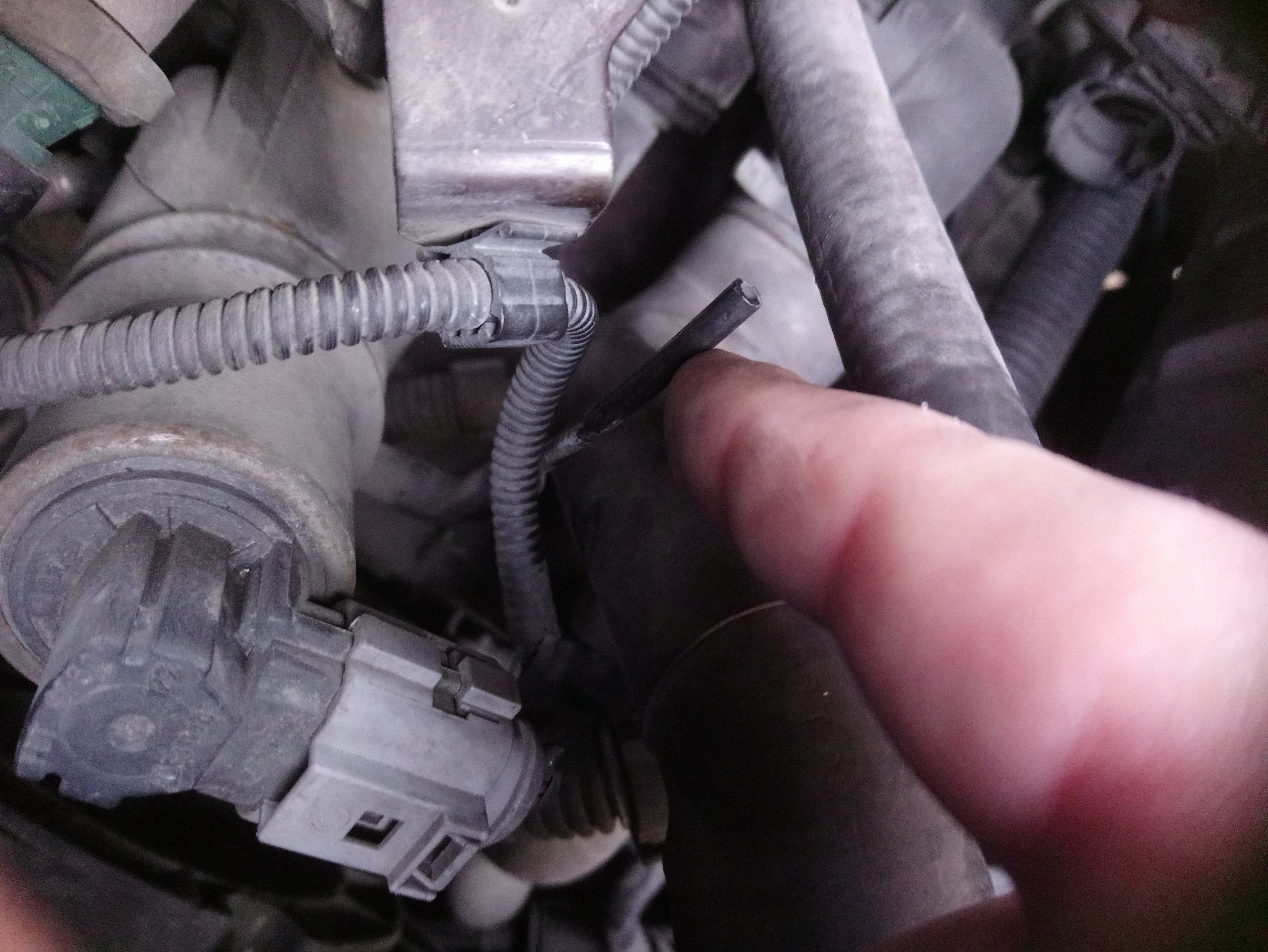

  14. Yes, there is plenty of information on briskoda! I just made a more careful cleaning of the egr pipe and it had some carbon not only on the usual pipe holes but also inside of the tube. I made a short test drive and no fault came. I'll watch it the long term. Thank you, Pete and wish you a happy new year!!!
  15. Thank you, Pete! Your help is always priceless! So, since this pipe doesn't control anything with vacuum, I can't find any other solution to eliminate error code 16785. Do you think I have to remove completely the egr and it's manifold pipe for better cleaning? How can I check the valve is working with vcds?
  16. Good morning and happy new year!!! The check engine light was on yesterday and the vcds showed insufficient egr flow. I removed the TB to clean the suspected inlet pipe but it was still unclogged. So, inspecting the egr area I found this pipe missing one part. Where should it be connected to? Thanks and wishes!
