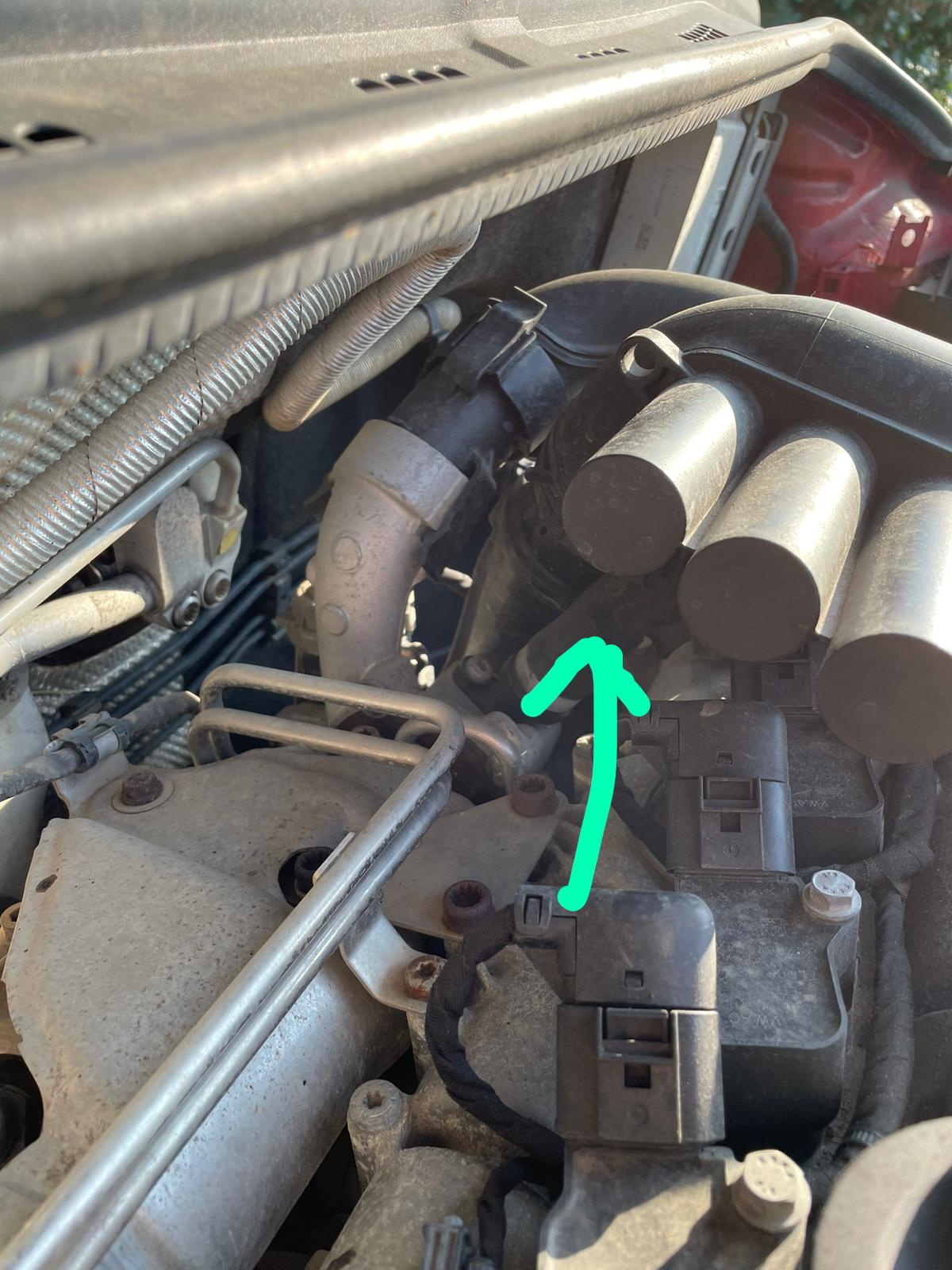

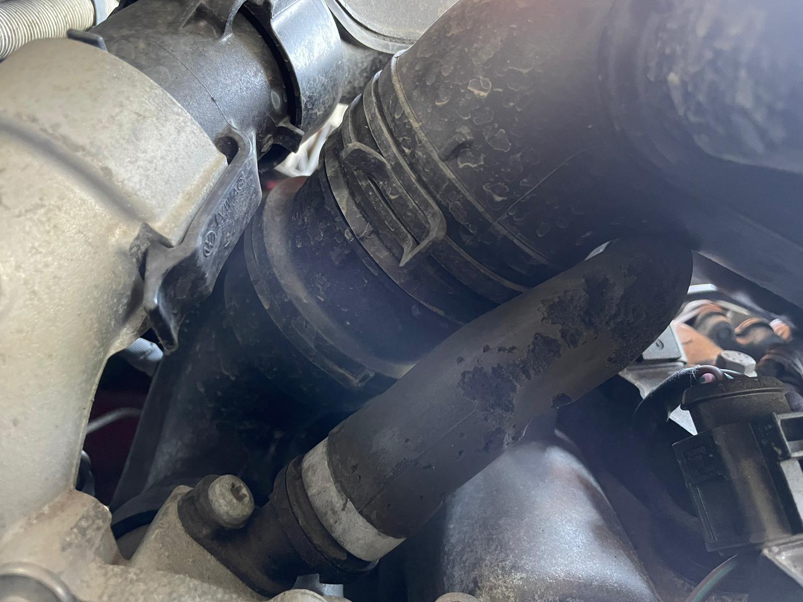

Gnaw marks on tubing in engine bay
ohnoes replied to ohnoes's topic in Skoda Fabia Mk III (2014-2021)
Thanks, that is useful. We live on a farm so there are fields aplenty around our drive, your hypothesis about field mice seems on the money. -
Did a visual check of the engine bay and found what looks like gnaw marks that were not there last time I checked. Can anyone tell me what this tubing is responsible for?
