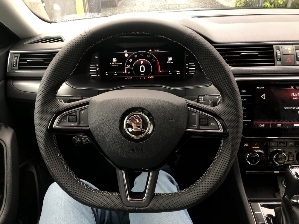

  7. I ordered mine from Superskoda indeed. I’ve placed a few orders with them, and their after sales service can be quite spotty as mentioned above. I have a feeling that most of it comes down to the language barrier and not to unwillingness to help. I’ve attached a picture of what mine looks like.

  11. Finally got around to installing the new steering wheel. I know it’s more of a vanity item, since there was nothing wrong with the old one, but the Sportline steering wheel does feel quite a bit nicer to me. All in all, a surprisingly easy swap, especially with the maintenance manual ready for consultation.

  15. Thanks! I ordered a similar kit from Amazon.de, which should arrive on Saturday. Meanwhile, my new steering wheel has already arrived, I ordered it on Monday, so delivery took only about three days from the Czech Republic to Belgium.
