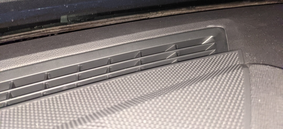

  6. I have an intermittent buzzing from dash. Putting your hand on central windscreen airvent stops the noise so guessing thats the culprit. Anybody had the same and resolved it? Anybody know how this piece is held in place so I can try and sort it?
  7. Turned out it was an 'arm' that adjusts the air recirculation vents. Dash out job to replace the part and it comes in two varieties so visit one to identify it and visit two to fit it once ordered and in stock. Didn't sound like it was the first time they had to replace one.
  8. Did you get it sorted? My Octavia had a similar issue and was a broken part relating to the air recirculation. Fixed under warranty with new part but clearly not the first one the dealer had done!
