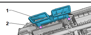

Anybody know how this piece is held in place so I can try and sort it?

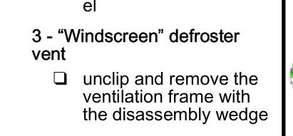

image.png.c9ac9c8ecc65460d5c911544342a16ce.png No pictures of the disassembly wedge or where the vent is clipped but a matter of trial and error.
Once it's out I'd also look at the expanding rivets securing the intermediate piece, too (if you can see them). Endoscope maybe ideal here.
