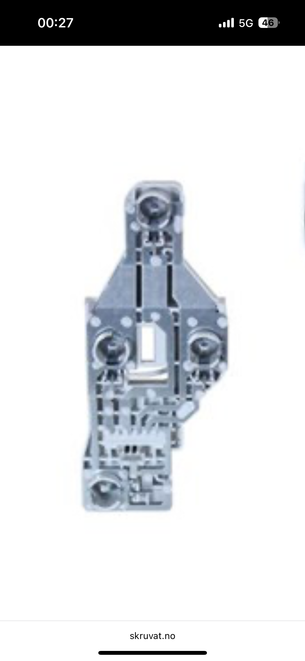

I didn't see your answer yesterday, sorry. The weak lights are the same on both rear lights, except that the "foglight position" at right light has no light at all. I don't know if ithey should be brighter. They are clearly visible through the red plastic, and I would say about the same as the two separate 3W tail lights on each side. The ground pin in the contact on the left cluster was burned. Suddenly there were no lights from the left cluster, and the car failed the MOT. The plastic supports around some bulbs also started to brake up. I replaced both clusters from a scrapyard. I'll check today if I messed up myself when I installed a trailer hook. I might have connected the trailer hook electronics to the right "foglight" circuit.

Ok, maybe you are right. We drive on the right side, and the left foglight illuminates. There is only one center contact for all the bulbs in the cluster, so there can't be any dual filament bulbs. Eg. the top bulb is the stop light, but it acts like a tail light when not pressing the brake pedal. The same with the fog light. The same with the stop light in the right lamp, but in the fog light position there is no light. There is also two separate 3W tail light bulbs outside the clusters on each side.
