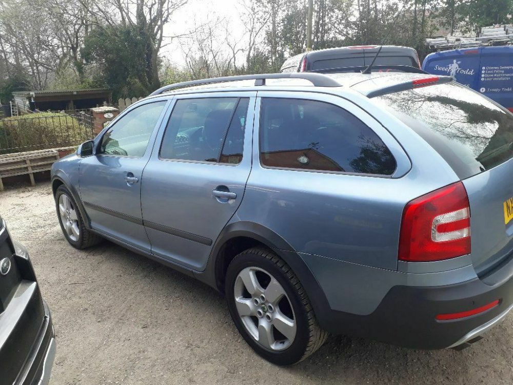

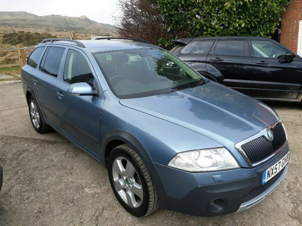

oh I thought they would all have to be changed I really like my skoda be it a bit old I spent a lot on it new cam and followers/belt,brakes all around,steering rack and a few other odds and ends, but saying that I got her 2 years ago for £1500 with a full service history so that was really cheap and gave me space for repairs, but you never know do you, I plan on keeping her for some years so will try and look after it
