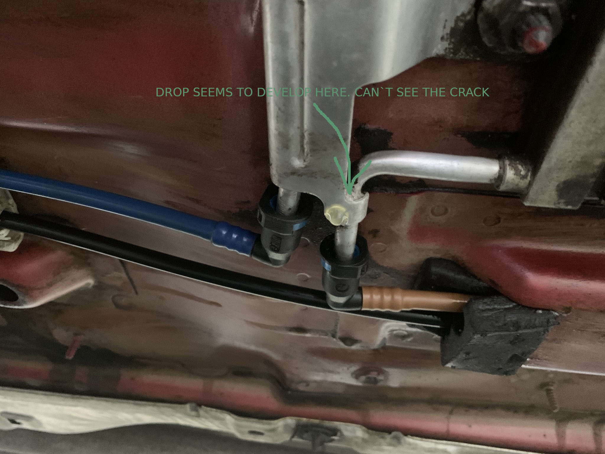

Thanks 🙂 Yes, strange if the pipe has fractured, but there is no drop on the connectors, or the last few cm of pipe before the connectors. If it`s a leaking connector, it seems from the parts catalogue that you have to replace the fuel line with connectors, not just the seal? I`ll clean some more, and try to reseat the connectors.

Removed the plastic cover today. After some cleaning it seems that the leak is from one of the tubes to the fuel cooler. Not sure if it`s repairable, tubes seems to be aluminum. How do I disconnect the black plastic connections from the tubes? Will fuel leak from the connections when disconnected? Is the cooler really necessary?

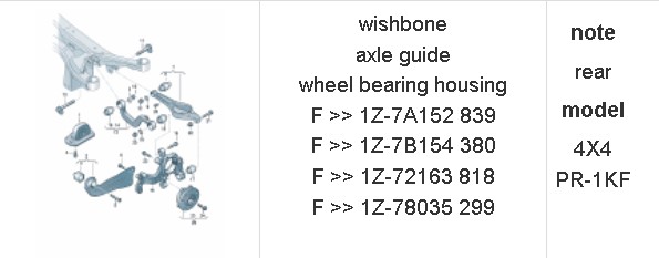

Thanks 🙂 Very useful, but I find two different rear wheel bearings used in 2007, one with partcode 1T0498621, and another 8J0 598 625. There are a lot of different numbers, F 1Z-7.... on the Group Parts. What are those? I enclose an example.

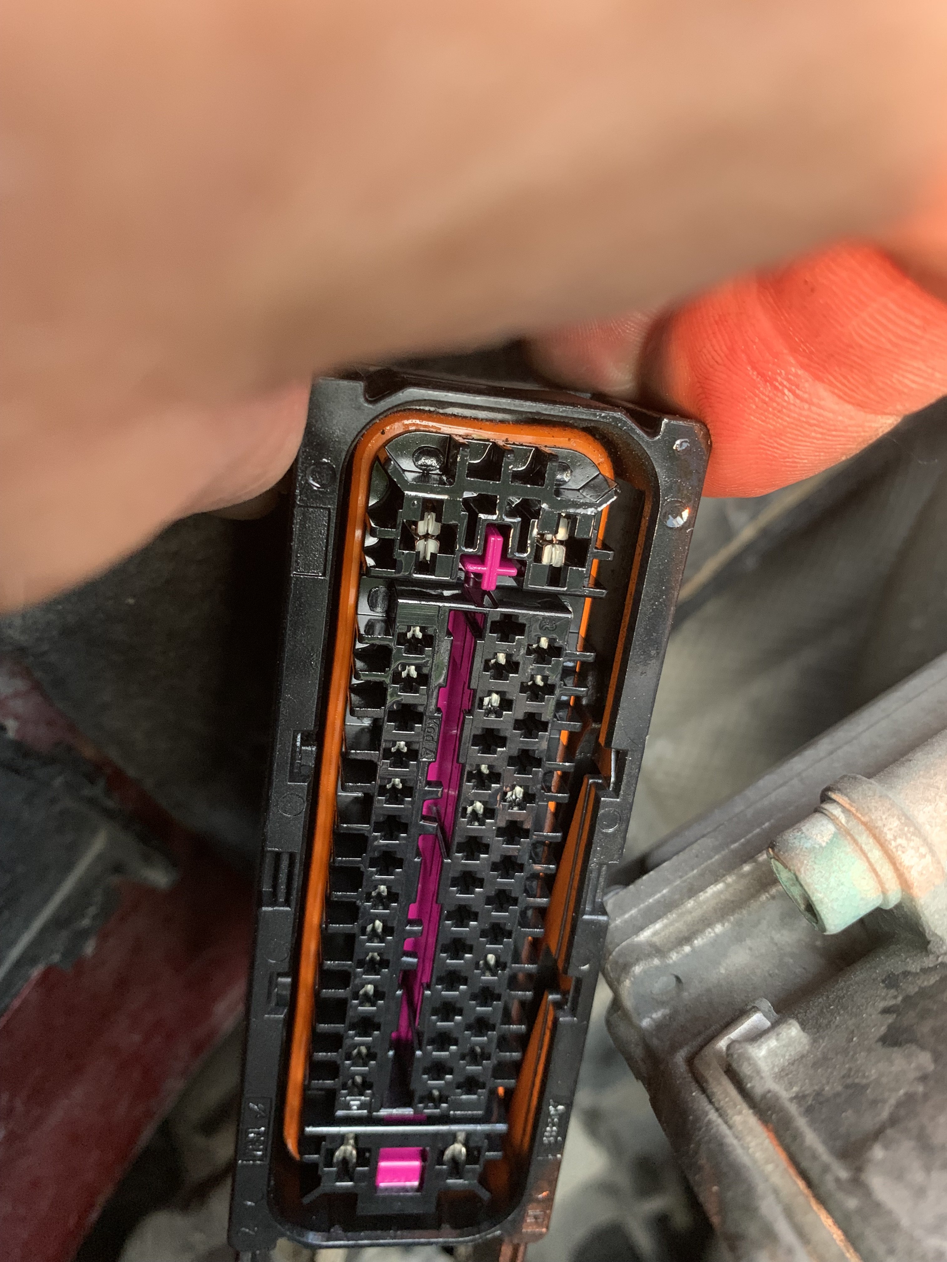

It's a 2007 model 4x4. I didn't mean to swap the sensors, but the connectors that are connected to the ABS-module. I don't know where this module is, so I don't know if each wire has its own connecor, and if these connectors are the same. I know you can swap the sensors between front and rear, but I have already replaced both rear sensors

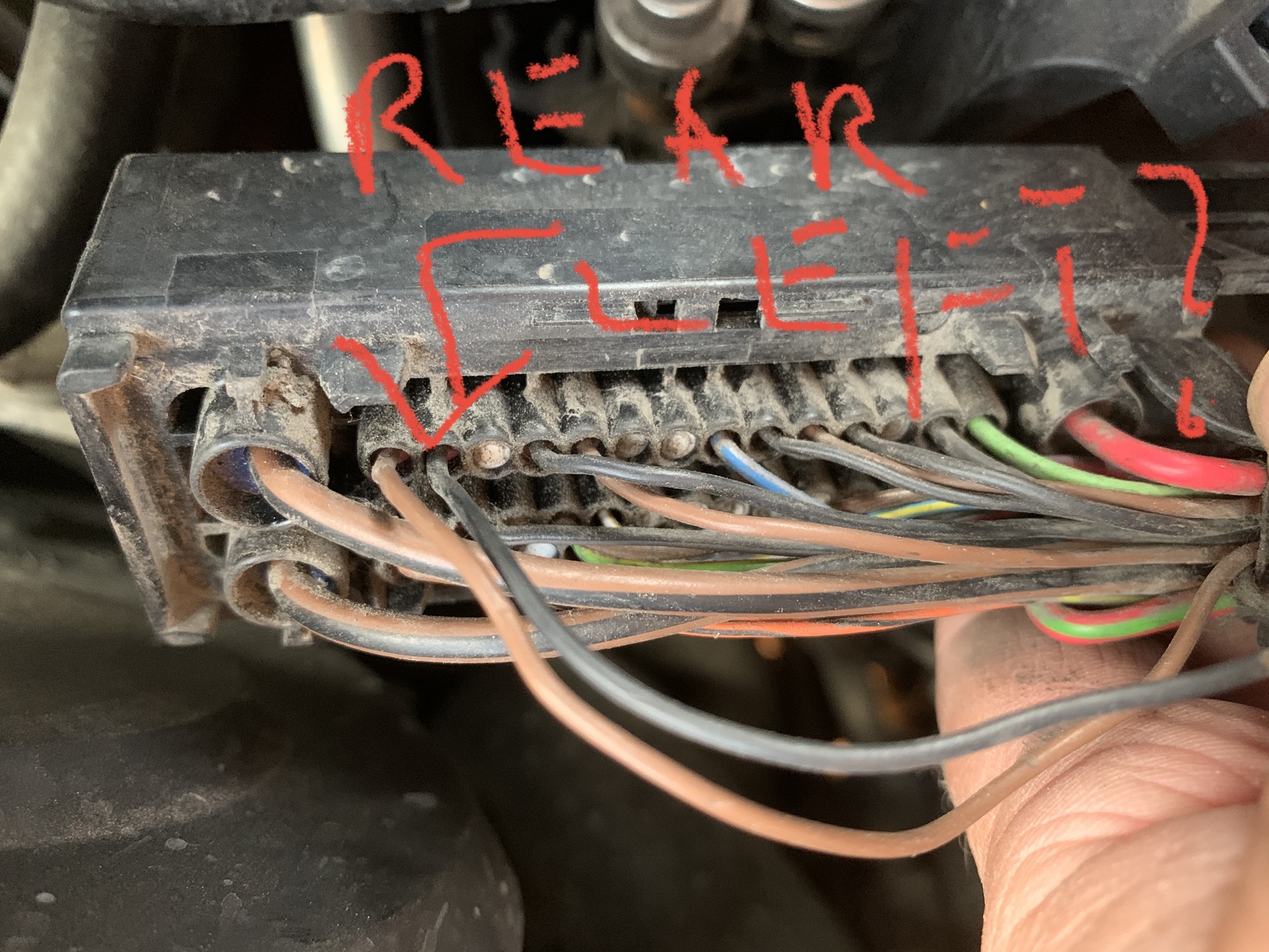

Thanks! I wasn't precise enough when I said "immediately", I drow a few meters before the error reappeared. At the rear the wiring looks very clean, and the connectors are dry and no visible corrosion. Do you know where the wires are terminated in the opposite end?

I got a simple diagnose tool that reports that the rear left abs-sensor has feiled. Changed the sensor, and reset the error, but it came back immediately. Where is the ABS-ECU located? Is it possible to swap two of the sensor wires to check if the error moves to the other sensor? If it does the problem should be in a wire or maybe the sensor ring?
