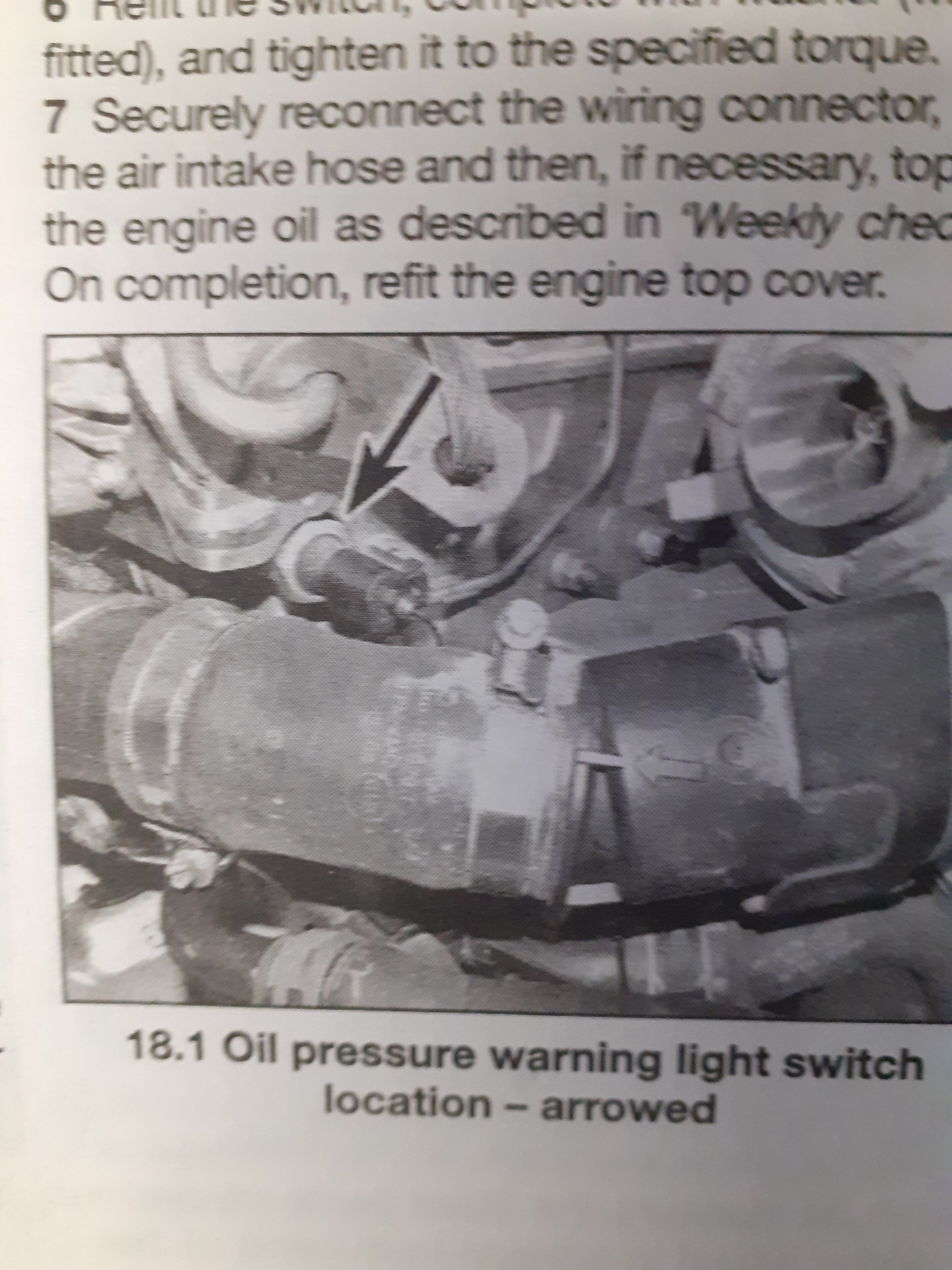

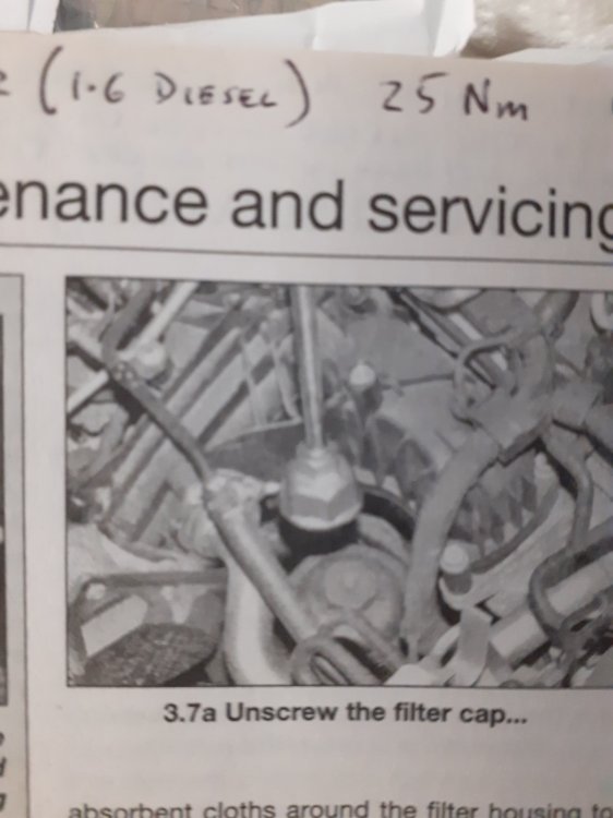

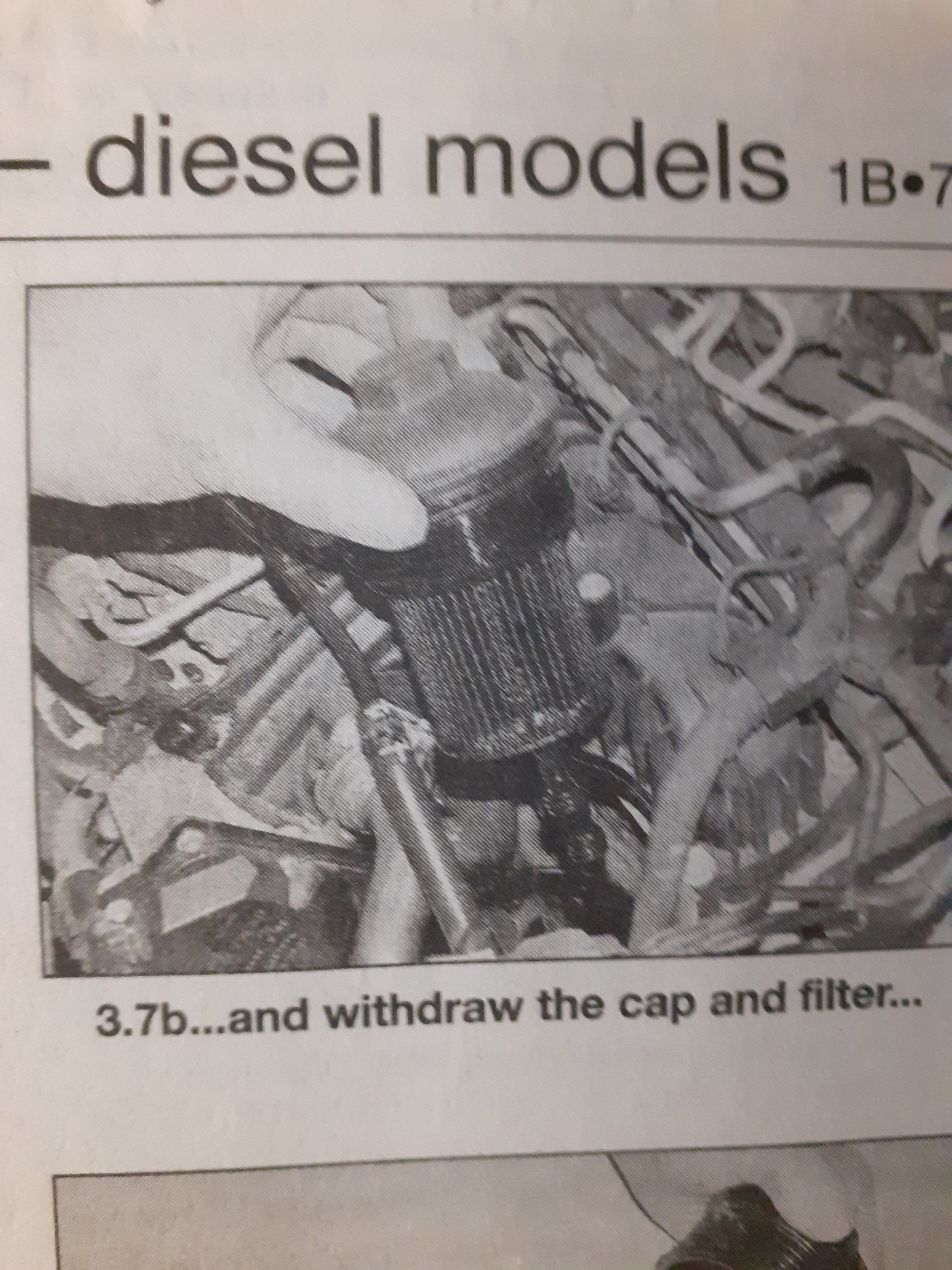

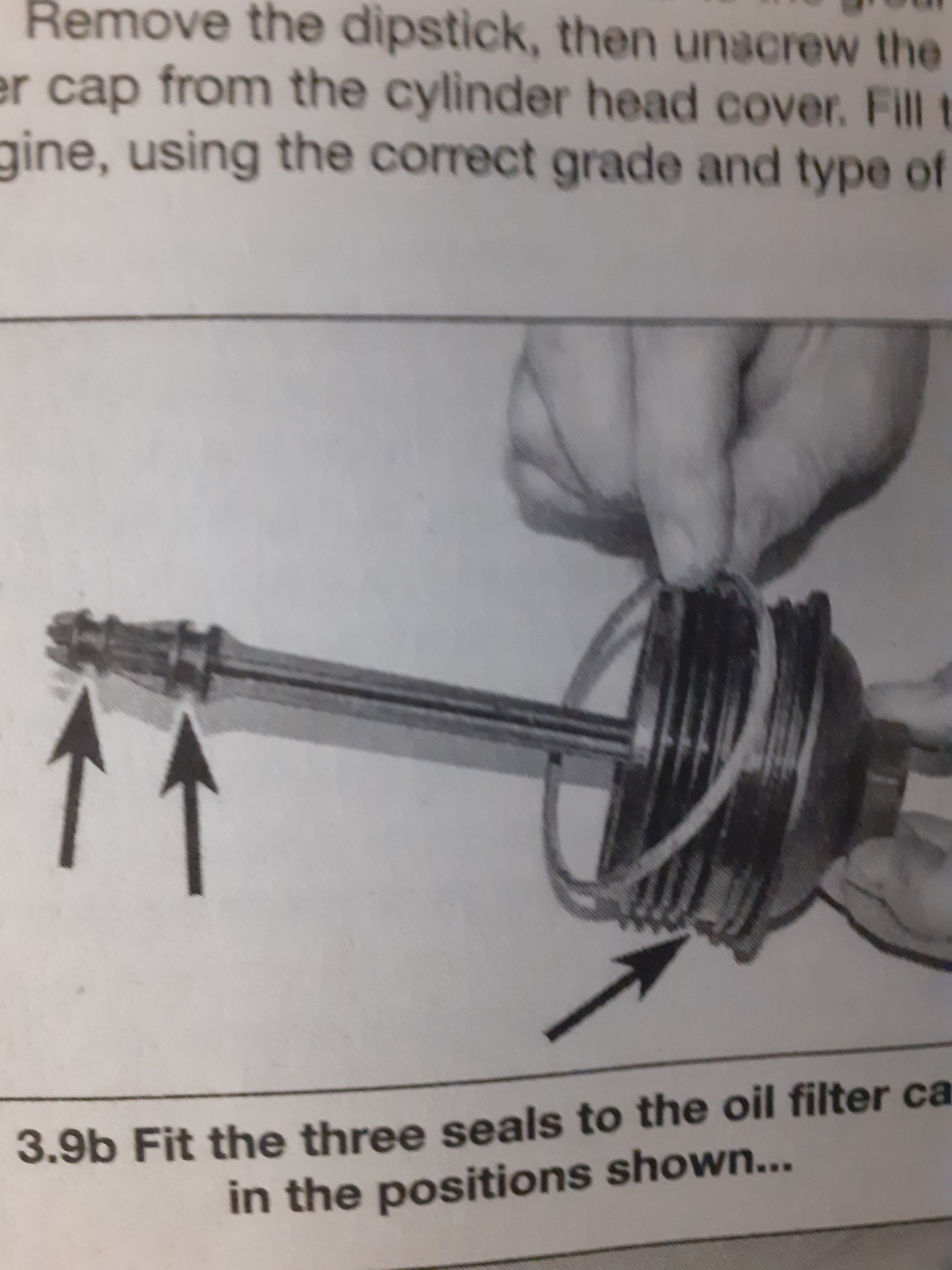

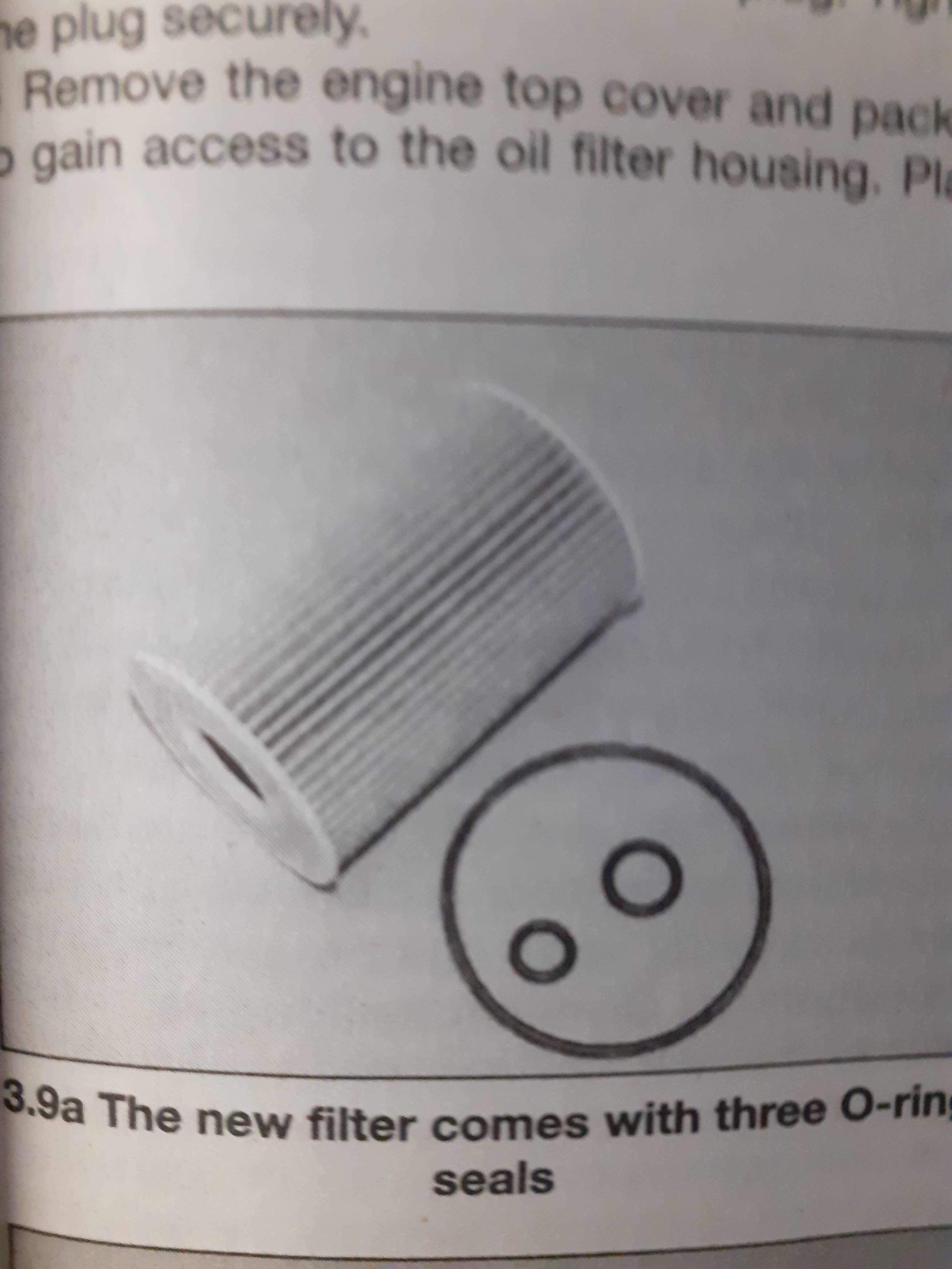

As Alasdair1 said. Oil Filter is a cartridge type (not the spin on metal canister you may be accustomed to on petrol engines). It is accessed from the top on this model and you will need a 32mm hex socket (not the 12 point version supplied in many socket sets as these can round off the plastic "nut" on the top of the housing.) and an extension bar on your wrench to reach it (the one I use is about 10 inches long). If I remember correctly you may need to dismount a bracket above the filter in order to get a clear space to insert the filter straight and vertical. There is an oil temperature and level detector mounted on the bottom of the sump. An oil pressure swich is mounted on the cylinder head (probably need to remove inlet air pipe to get at it.) There is a Haynes manual for this model - plenty of the "paperback" version available on eBay, or "premium" version (hardback and better quality paper and pictures) for twice the price from Haynes themselves. I will now attempt to attach some pics from the manual which may help you.
