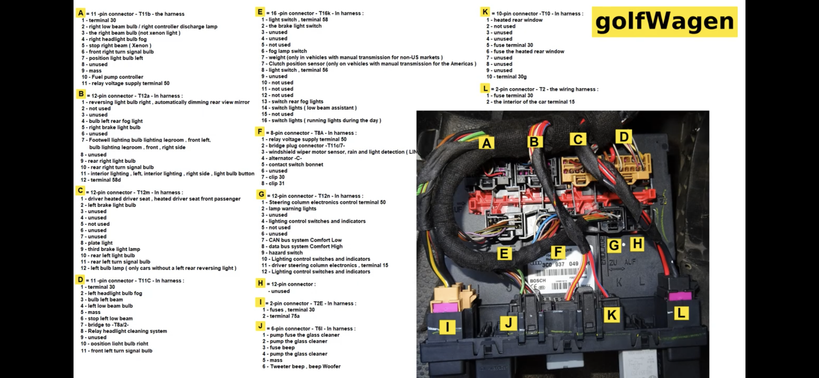

  3. Might have to splice the footwell lights tho. Can’t see two connectors fitting in the one pin 7 on Connector B.

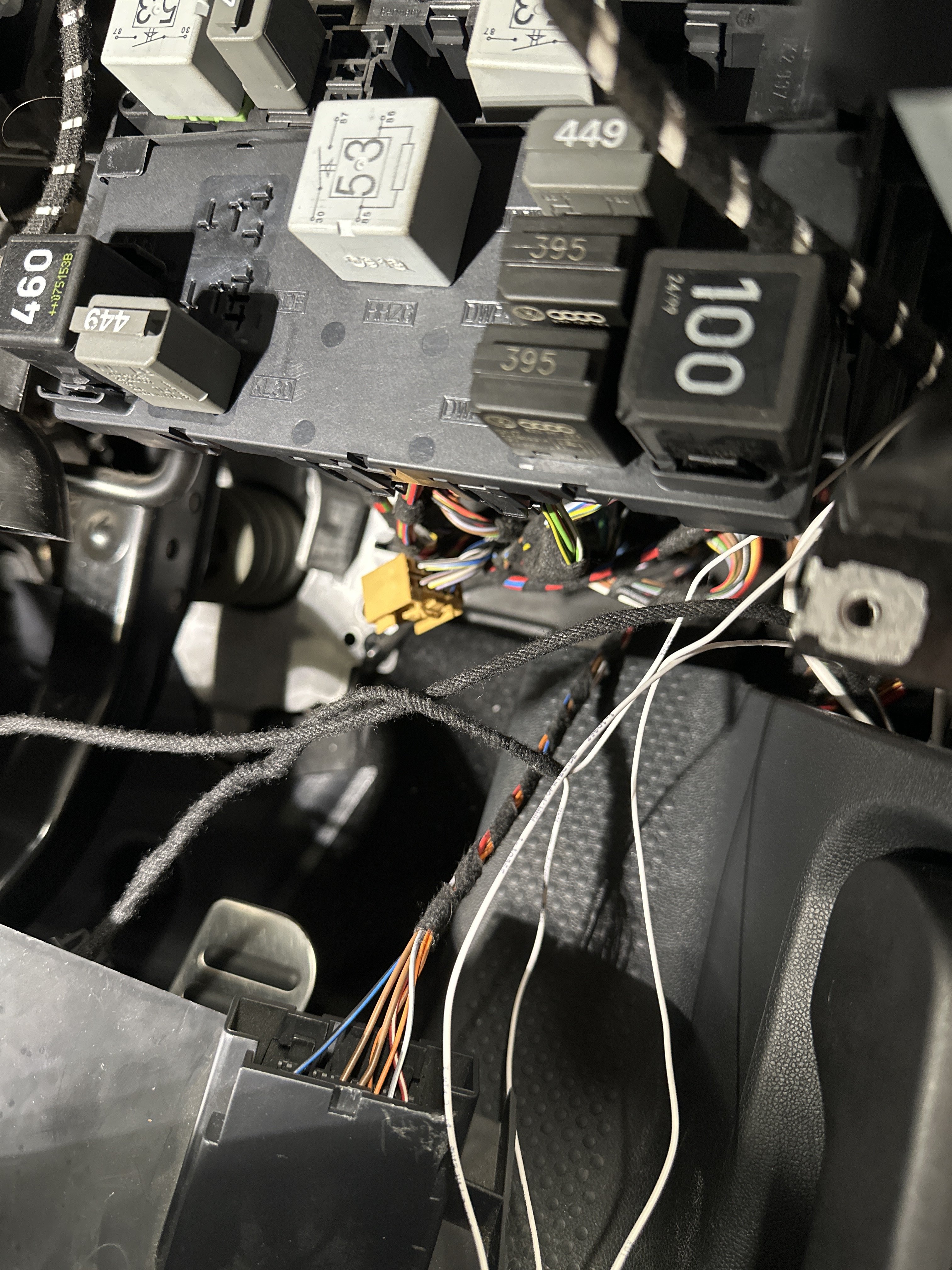

  4. Nice thanks man. Currently putting the first cable in the cecm. Have it unconnected and putting the heated seat in C pin 1. Thanks Jack

  7. Hi Trevor, Mechanic is sort of messing me around so tempted now of just completing the job myself. Have it 99% done at this stage but not wired in. Wires are where they need to be so just matter of finishing it. To start with, the CECM, what’s holding that in place? Is it two screws one pointing outward under the steering wheel and one on the outward facing fusebox frame? Also as I’ve two footwell light CECM cables, will both fit in the same pin you reckon? I have 3 cables to go into the CECM, 2 into the fuse box, 3 into the climatronic unit, and 4 to ground. I’m good with the latter two just the CECM and fusebox concern me. Don’t want to end with shorts or firesšŸ˜‚šŸ˜‚ Fusebox, which ports did you tap into lad? Would I be right in saying that the normal heated seat port will be dead as it wasn’t a fitted option in the car? I know there’s the ignition plus and 30 amp breaker owed source cable to be put in the fuse box. Just not really interested in waiting for the mechanic just messing me about now! So close and this should’ve in two-three daysšŸ˜‚ Thanks man! Jack

  12. Perfect Trevor thanks! Just confirming so for: Heated Seats Connector C Pin 1 Footwell Lights Connector B Pin 7 I know I’ll have to code both the footwell lights and heated seats in using VCDS should be the easiest bit of it haha! The door handle lights are supposed to be just wired in with electric window switches on the passenger doors and the mirror adjustment switch on the drivers door so no coding needed. Going to do the rear footwell nights now as the centre console is coming out and the rear footwell loom goes to the same place as the heated seat looms so no better time! Thanks, Jack

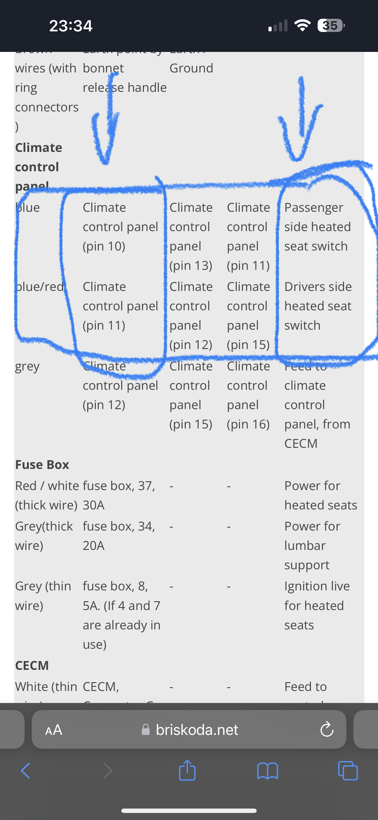

  15. Hi Trevor, I know this wiring diagram was from the GTi owners and from around the time you did your retrofit when the kufatec loom was wrong, but for me now with the relay box under the passengers seat would these two circled below be the opposite so drivers is pin 10 blue and passengers is pin 11 blue/red? Plus the blue Red connector has two small connectors vs the single blue connector, there is only one small connector wire on the drivers seat main connector but 3 on the passenger seat main connector. I understand Eddie-NL had to switch the underseat looms so his relay was under the drivers seat. Just thought I’d check to be sure! thanks! jack
