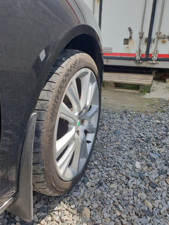

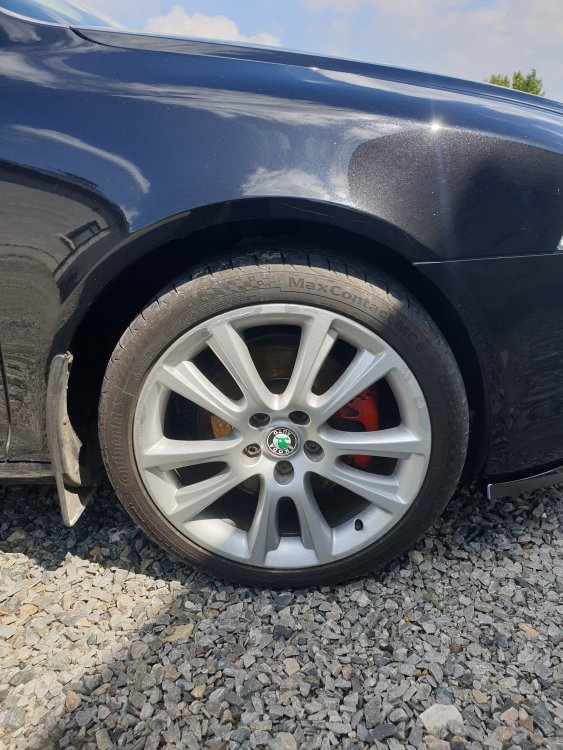

Hello Thanks for the replies Damien. Would they make any difference to this? Front in the first picture is like an SUV the back isn't so bad. Im not looking for crazy low but something just to sit like a sports car as such haha.- Coilovers
