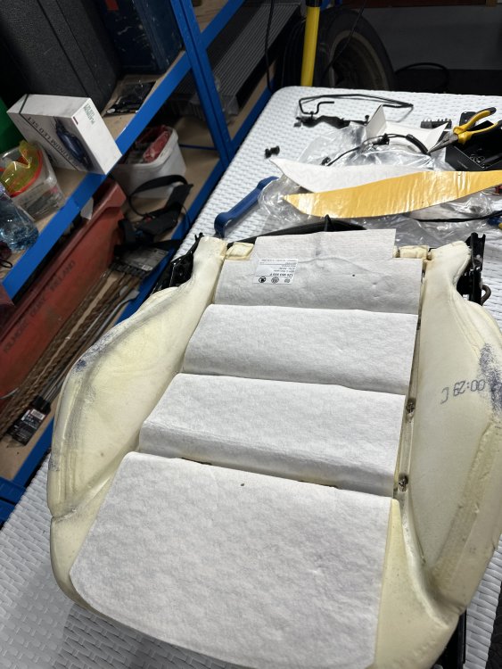

  2. Sticky time now! You were right perfect fit. Must do the side ones and then the backrest then all back together.

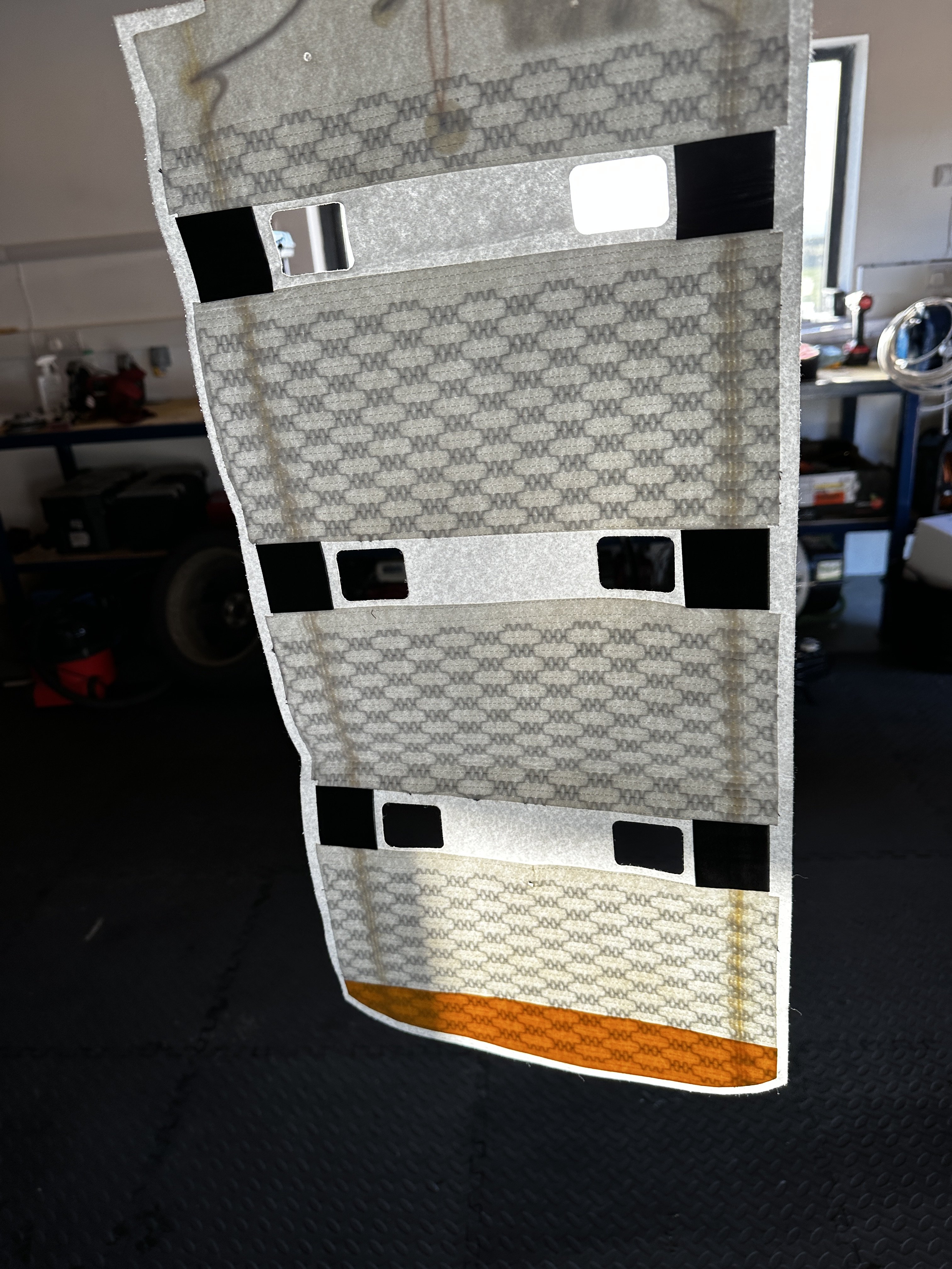

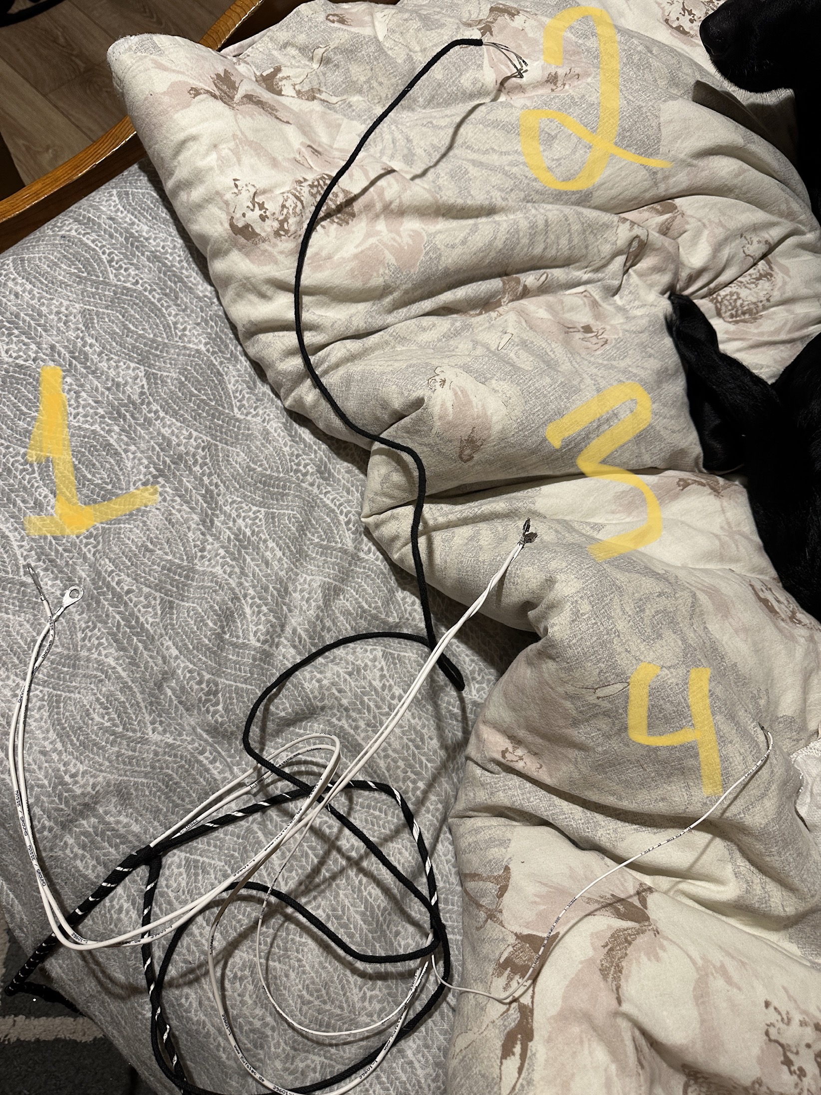

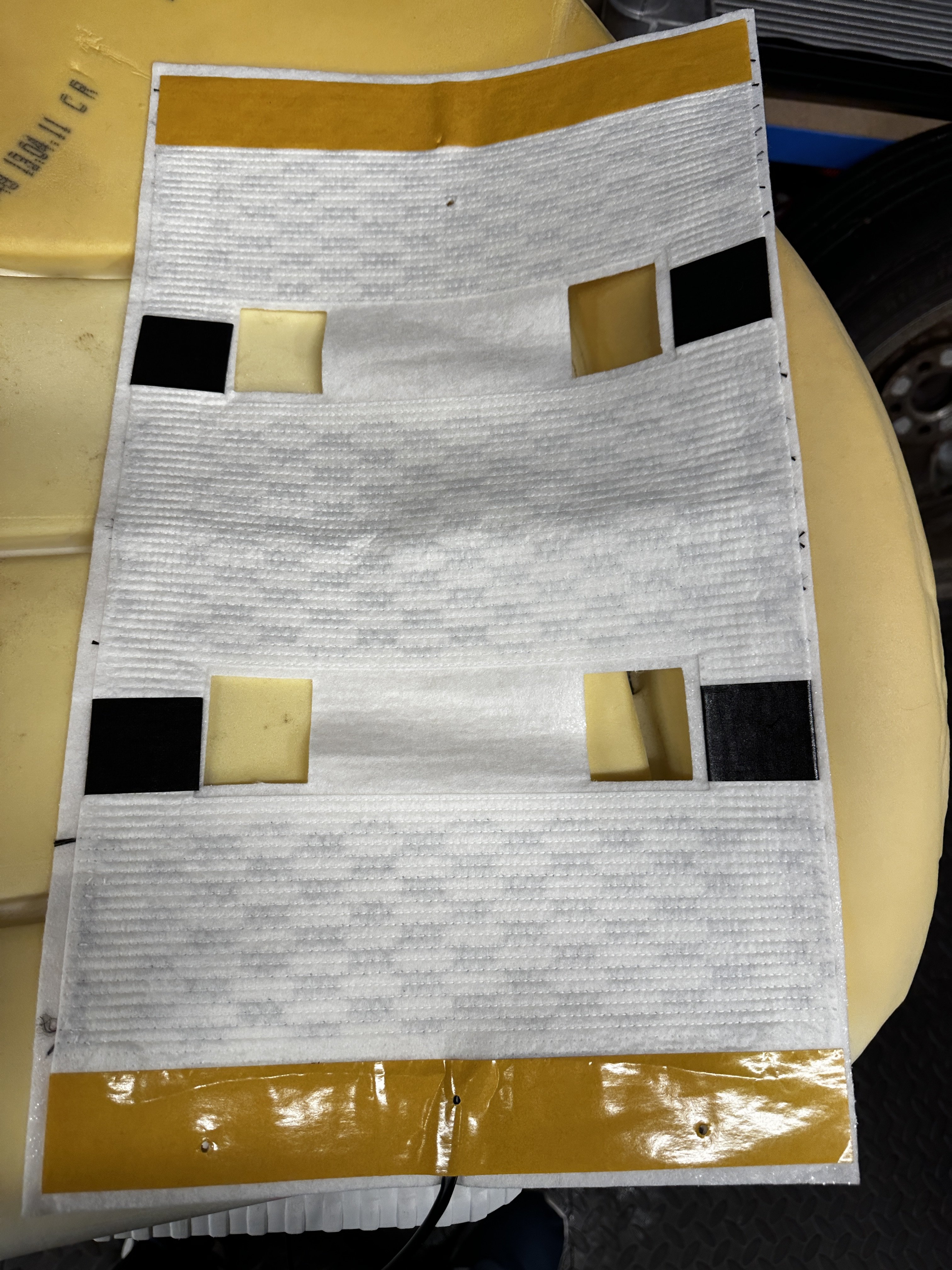

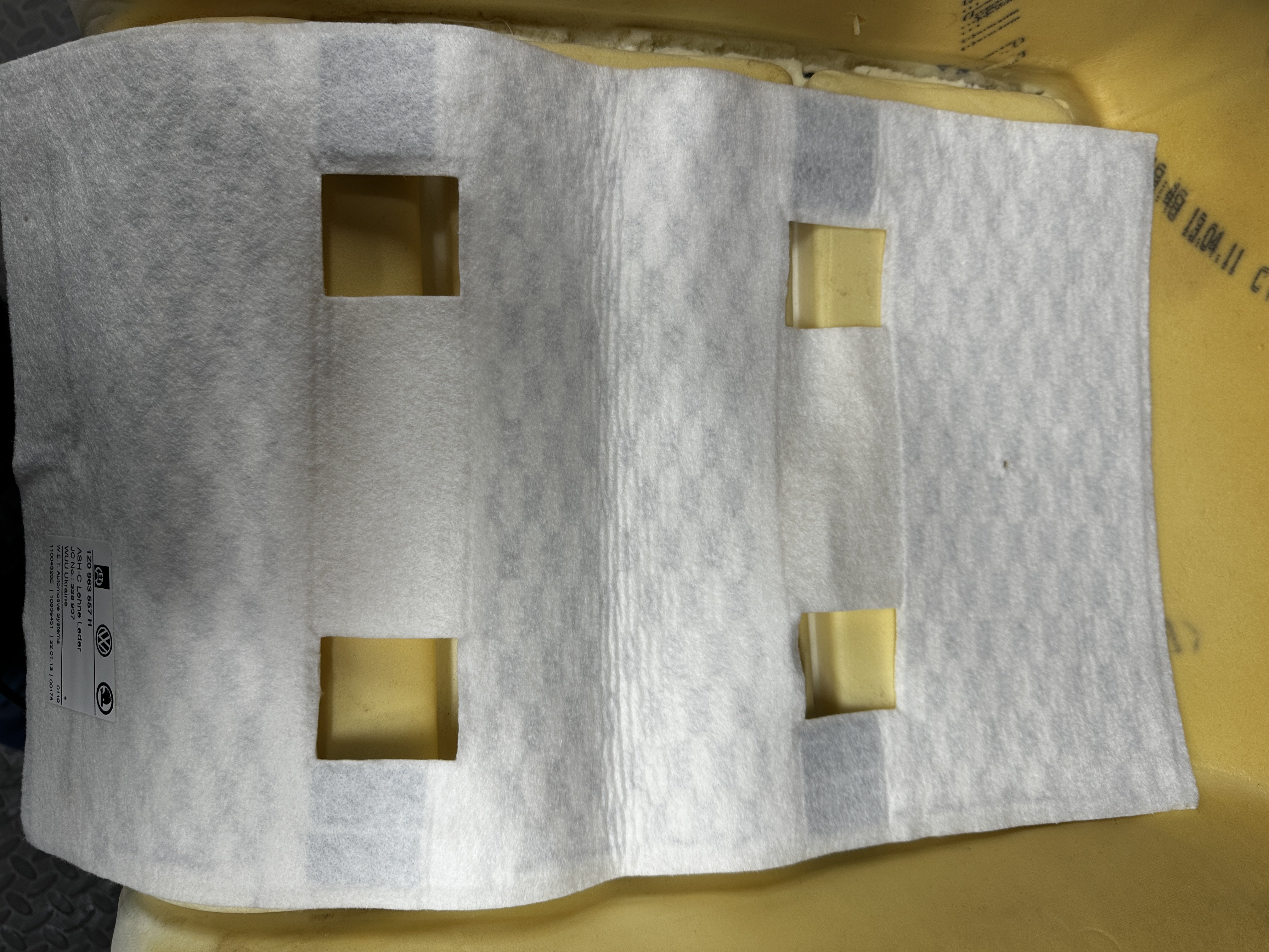

  4. It could be just that the leather seat is larger and has more surface area than the cloth one. Just not gonna know till I start splitting and putting them in! Picture 2 is what the coils look like in the leather version.

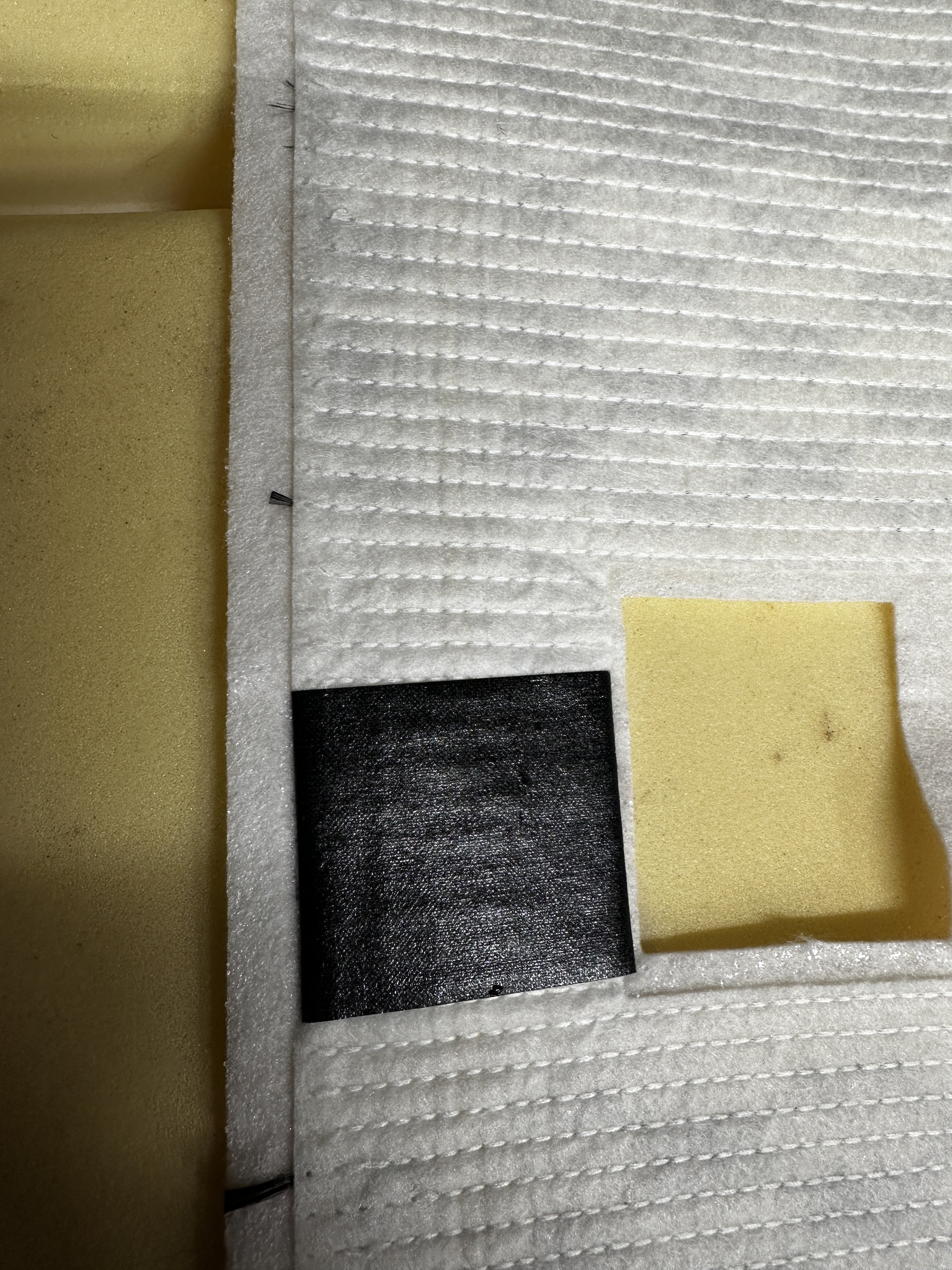

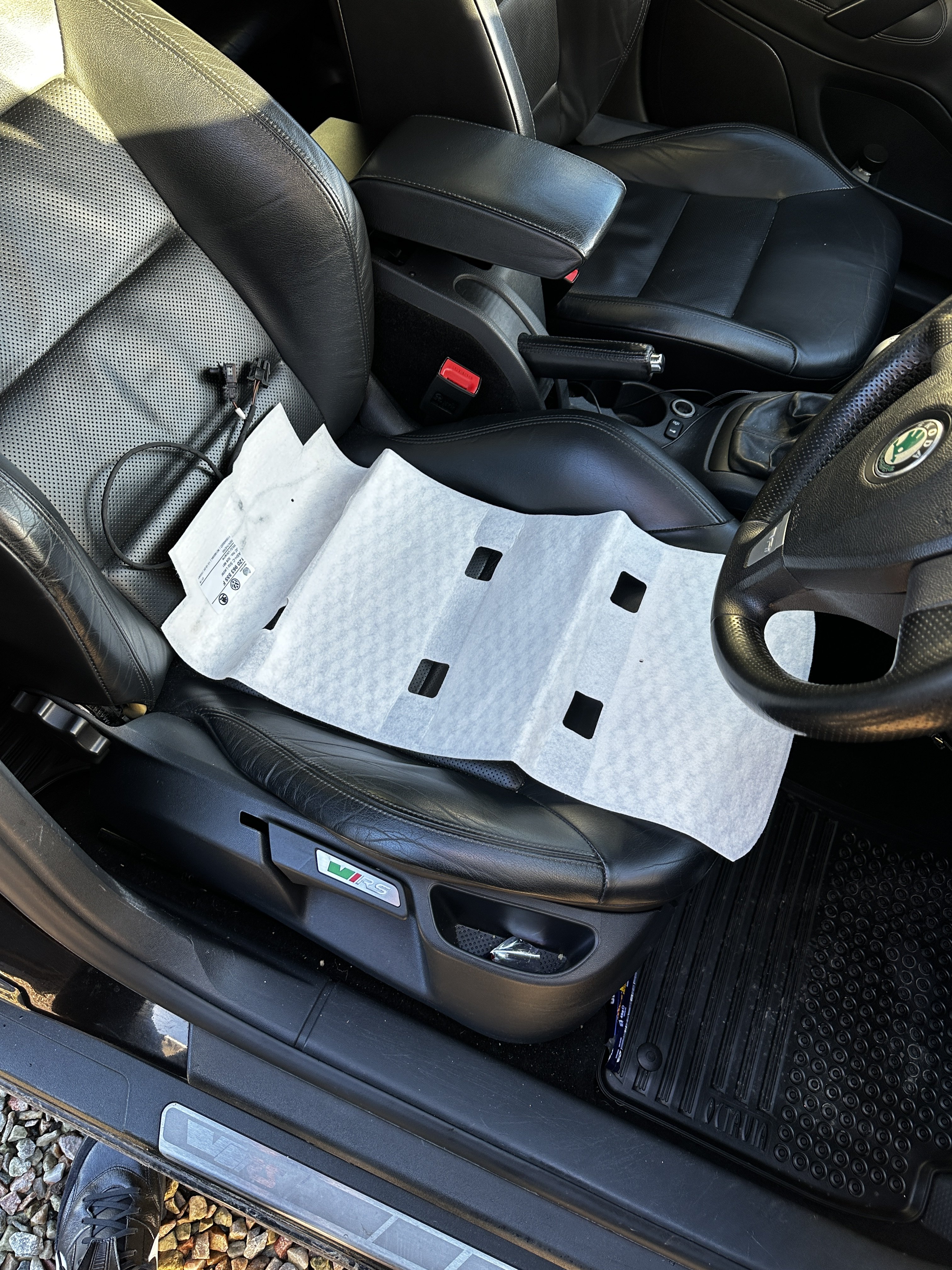

  5. I was also out messing around with a spare ordinary Octavia seat I had split open to look at it. I lined up the pads just to see how things would look and bared in mind you said the pads had to sit in the valleys so wires etc didn’t break. There are these black squares on the leather pads where the pads should sit in the valleys. I take it these are the connections between each section of pad? It will bend with some pressure applied but is it safe do you think to bend these parts into the valleys? thanks jack

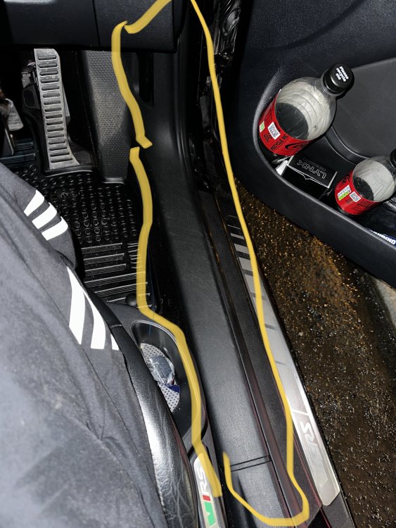

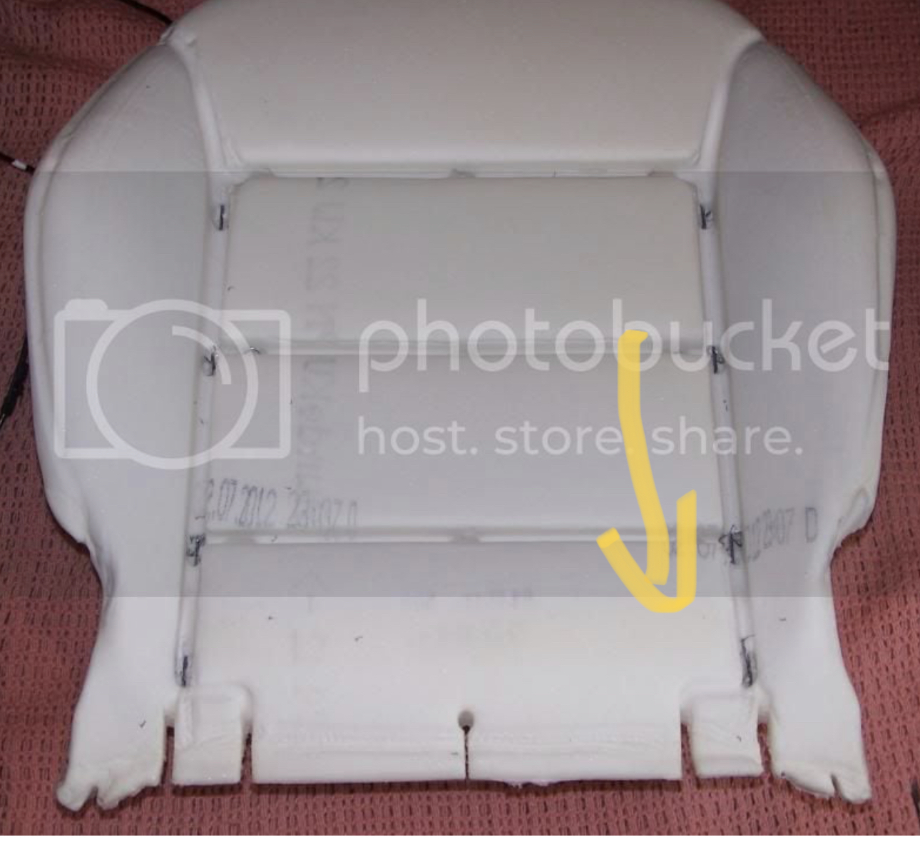

  8. Thanks man! So it will be down along here under the marked area? jack
  9. Thanks man! My plan of attack is to get the pads into both seats and put them back together and wire up the under seat looms together for the pads and leave them out of the car. Then pull the centre console out to put in the new hand break sleeve and put the loom in and direct the wires to where they need to go. Where did u direct the kufatec cable for the drivers side to? Through the centre console or under the carpet near the driver door jam? Seen it done that way on the GTi site where they pulled the drivers side door entry trims off and brought it down that way. I’d be inclined to bring all the cables down under the centre console for the kufatec loom and then under the carpet to the holes in the floor to connect to each seat loom. thanks! jack

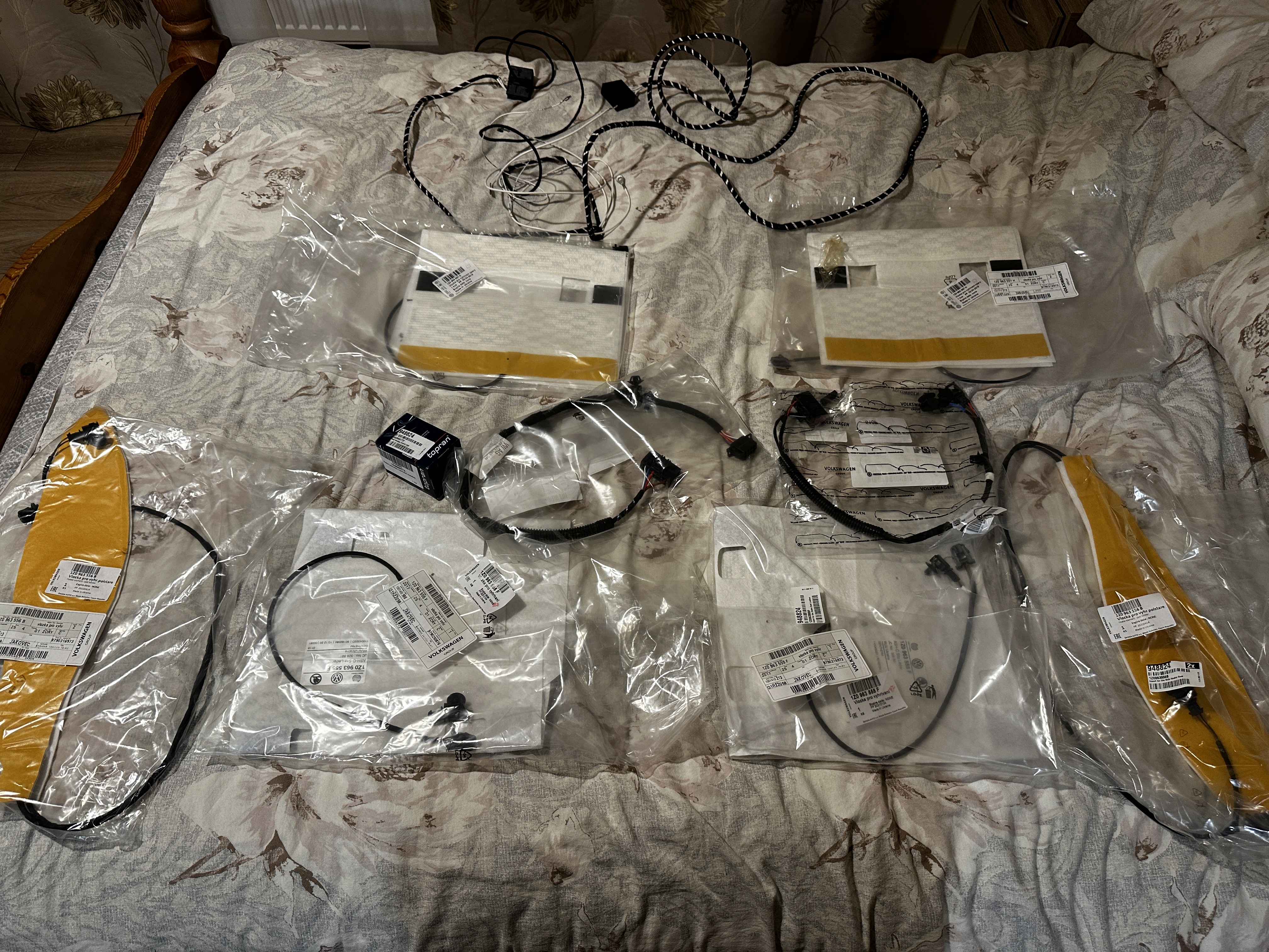

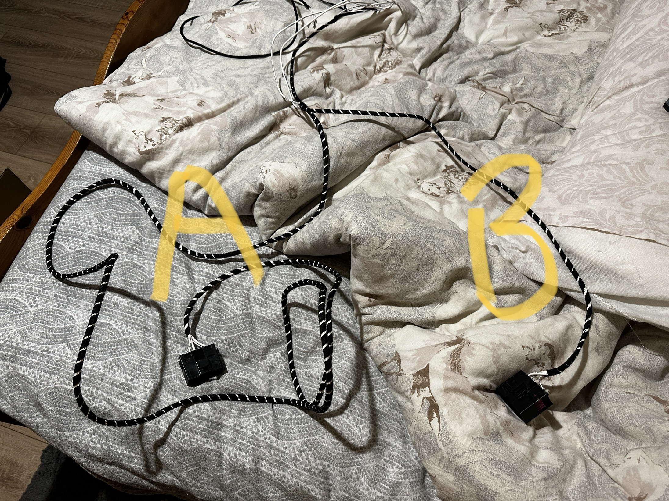

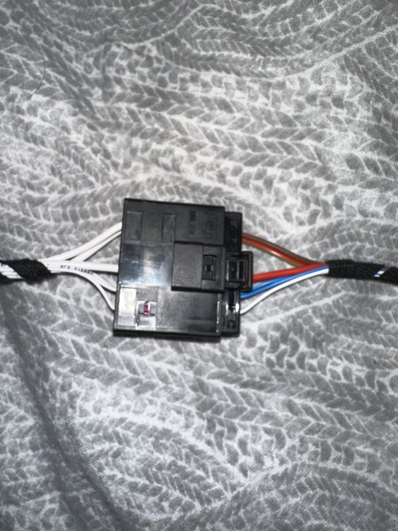

  10. They must have! Yea sorry ment A was the connector on the kufatec loom for the passenger side and has all the wires for the relay etc and matches perfectly with my passenger seat under seat loom connection that has the relay connection on it. Tbf they have the wires grouped nicely so that you know where all is going and where. Must’ve made big improvements by the sounds of it!😂 the picture below just shows on the left the kufatec loom with the longer cable side for passenger matched up on the right to the genuine under seat wiring loom for the heated seats and relay for passenger side. moral of story I think they’ve actaully got it right 😂

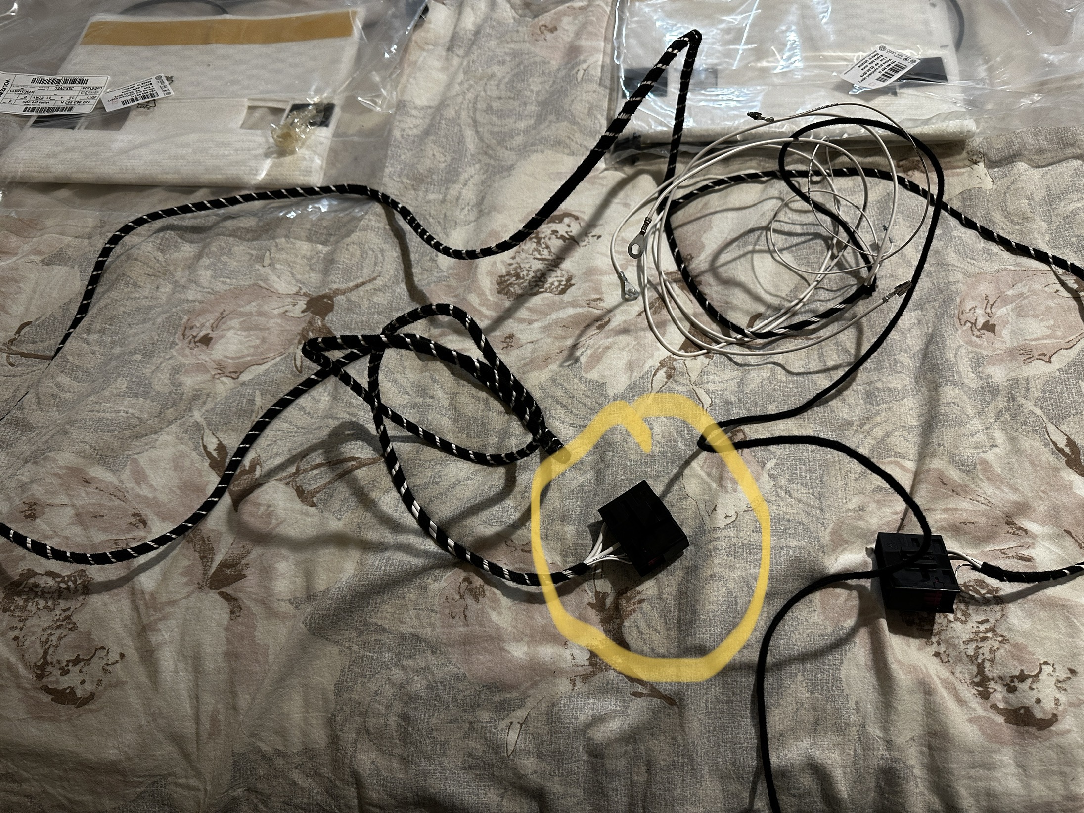

  11. Perfect man that’s the one I was looking at easy to understand too! In the kufatec loom I have the connections grouped on where they’ve to go, so; #1 2 x grounds to drivers footwell for each seat #2 3 x cables to the climate control unit #3 2 x cables for ignition and power to fuse box #4 1 x cable to the cecm module and the two plugs that then connect to the under seat loom. Don’t think I’ll have to swap the looms over as it appears the cable is correct for a RHD which is odd. Longer cable is going to the passenger side and has the most wires on it to allow for the control panel. I did read about yours where the wire wasn’t long enough for the passenger side as it was a LHD based loom so you swapped the under seat looms which is a good solution. The shorter wire on my loom has the least amount of cables on it so I take it it’s for the drivers side. (A) is the longer side and has more cables on the plug and matches with the passenger side underwear loom I got (genuine parts). Kufatec in their guide states this goes to the passenger side. (B) is the shorter cable with less wires on it and matches the driver side under seat loom. I got all the bits from Skoda based on genuine part numbers apart from the kufatec loom. thanks for your help! jack

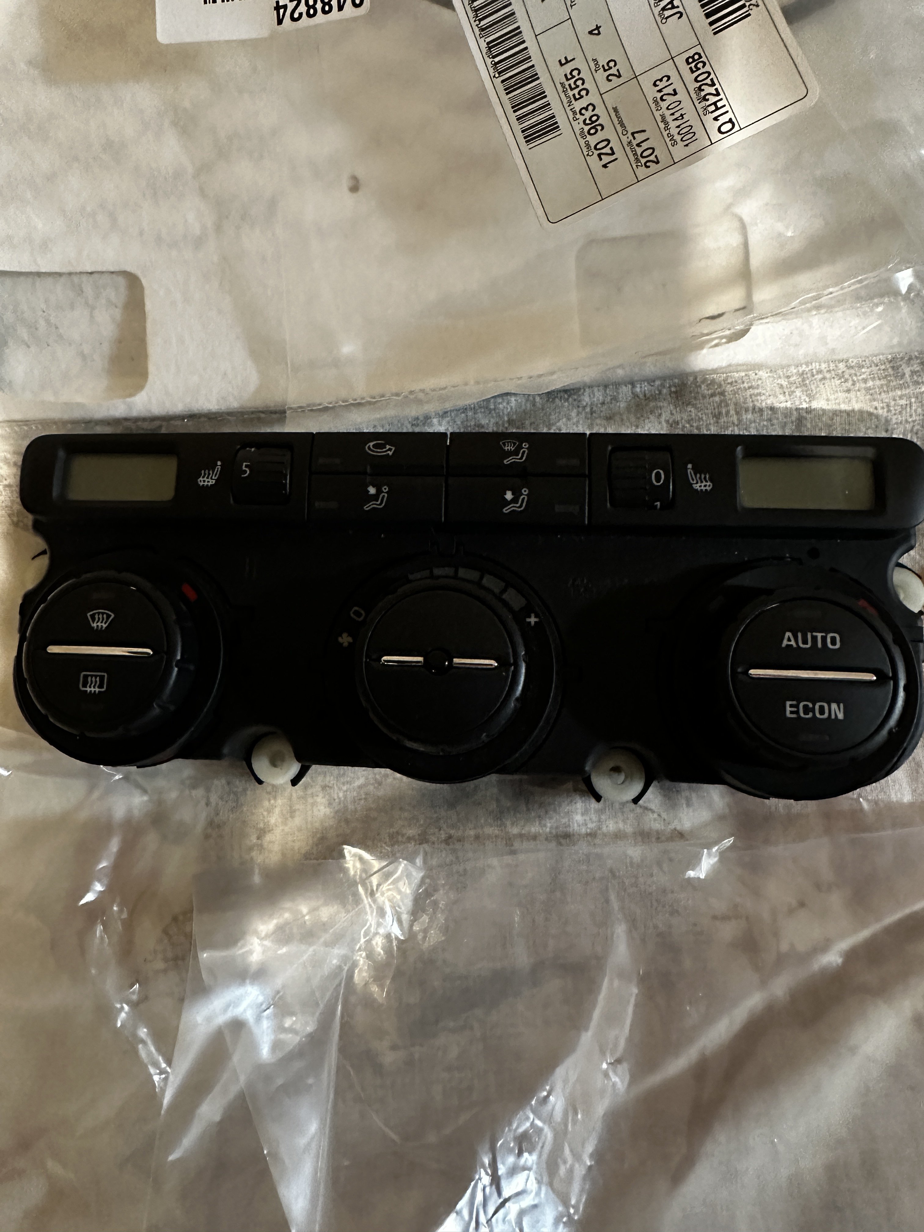

  12. Hi Trevor, Pretty confident with it tbf! Only wires I’m not sure of is the cecm wire I know it’ll have to go to the cecm module. I also have the climatronic unit here too and I understand I’ll need two wires going here too. It’s just going to be more work really than a mk4 golf/bora. I did a bora before but all you needed was the loom everything else was there the pads in seats already and just some switches. Now I’ve to do it all from scratch but will be worth it! Would also maybe attempt the back seats too but will wait to see how I get on first😁

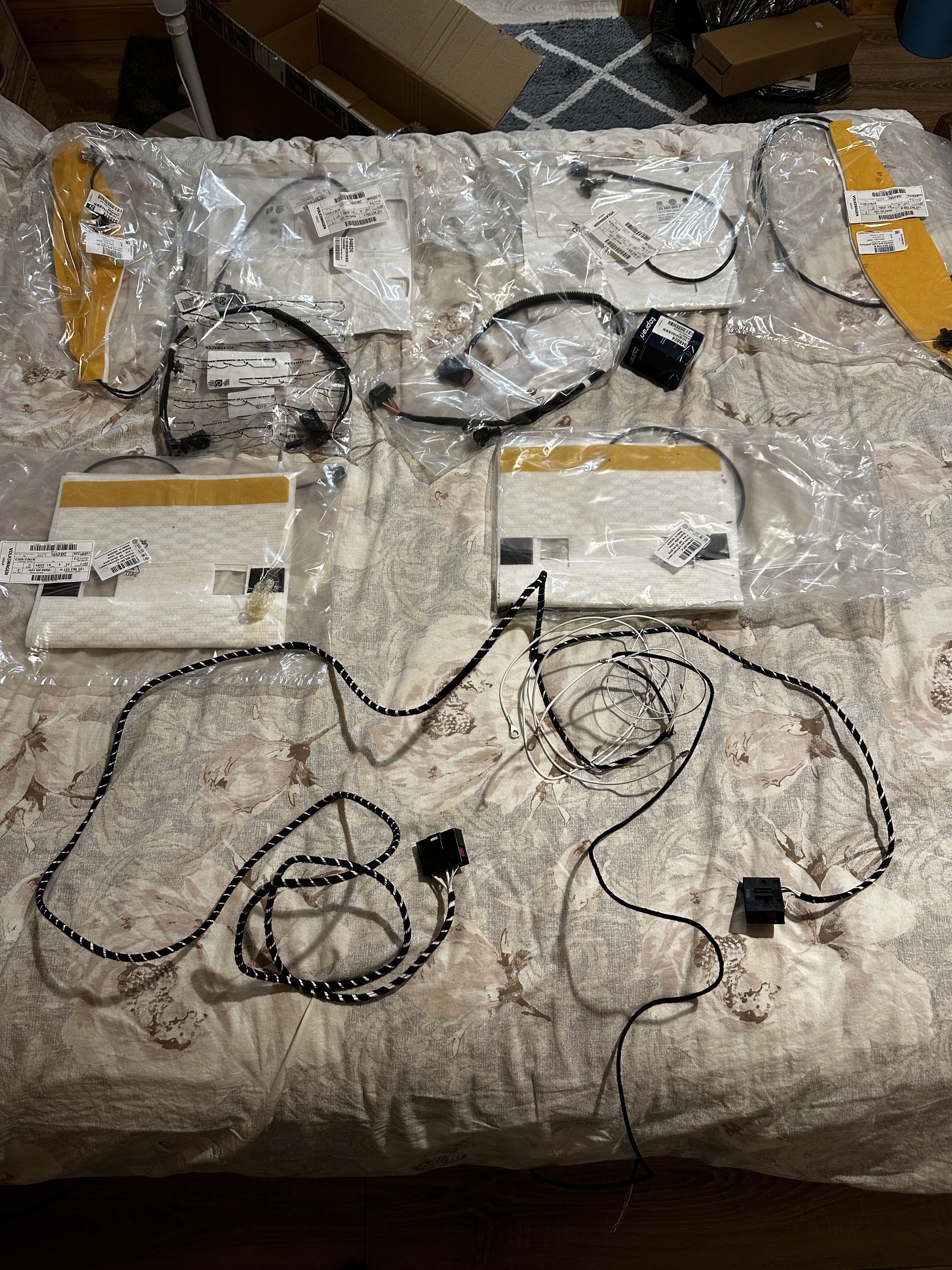

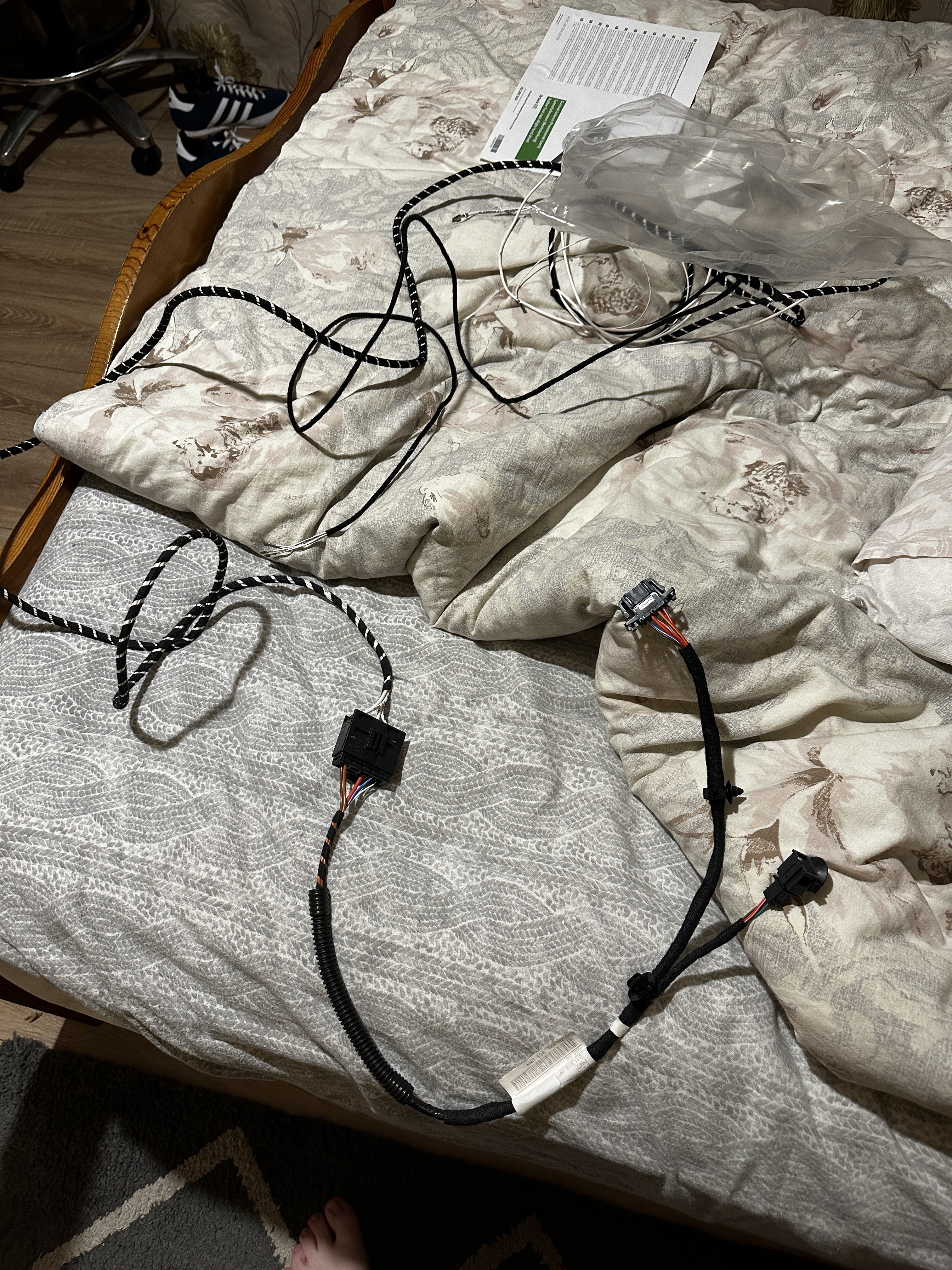

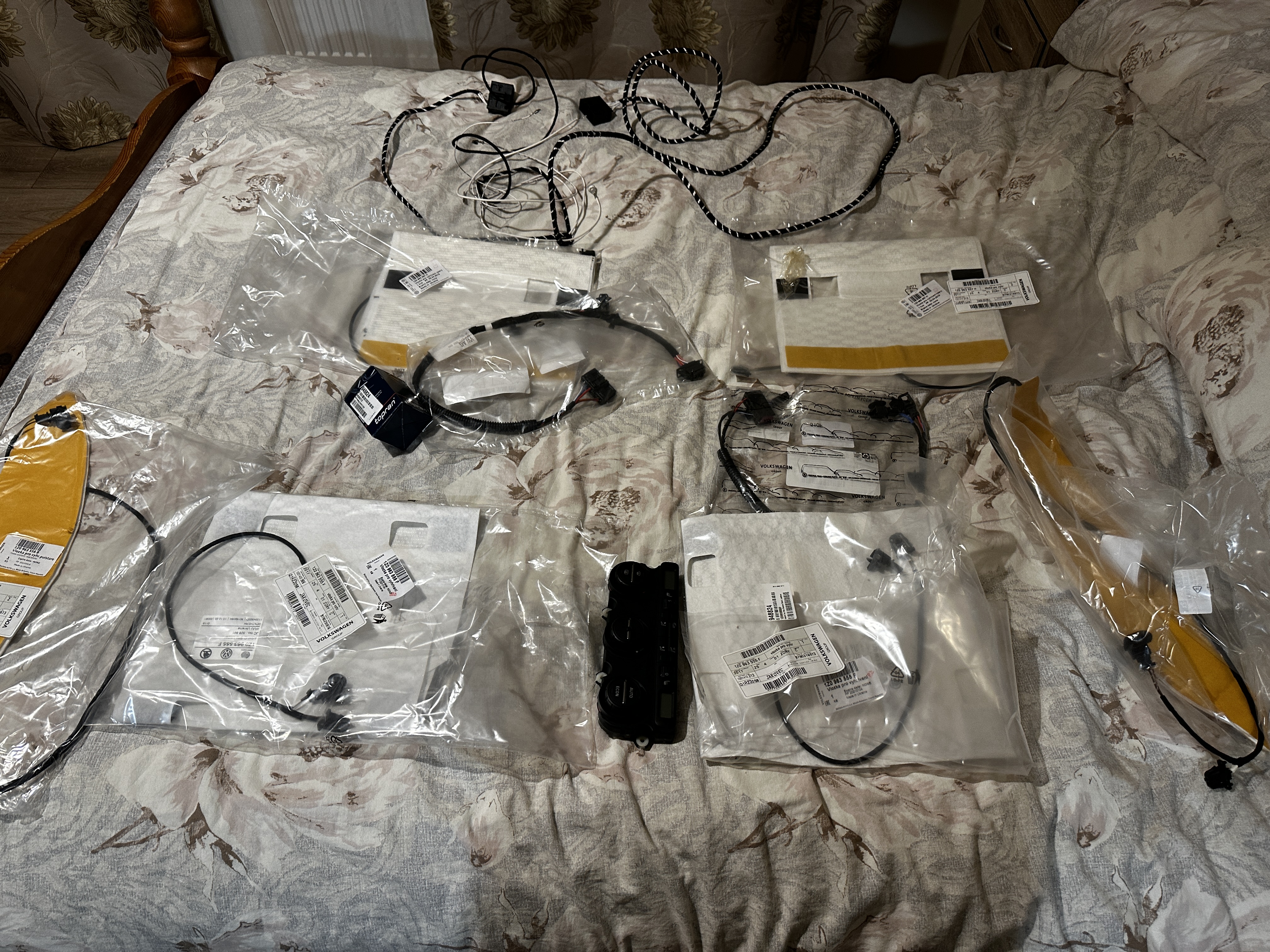

  13. Hi Trevor, Thanks man! Yep got everything for full leather as I’m doing it on blackline full leather seats. Got the under seat looms, controller, side pads, base pads, backrest, and Kufatec loom. Plenty stuff as seen in the pic! On the second pic you can see the longer cable has the most wires going to the plug and according to kufatec this one goes to the passenger seat for the controller. Yep I read a few forums including yours and I thought they were only LHD looms. I think they do have my vin. thanks! jack

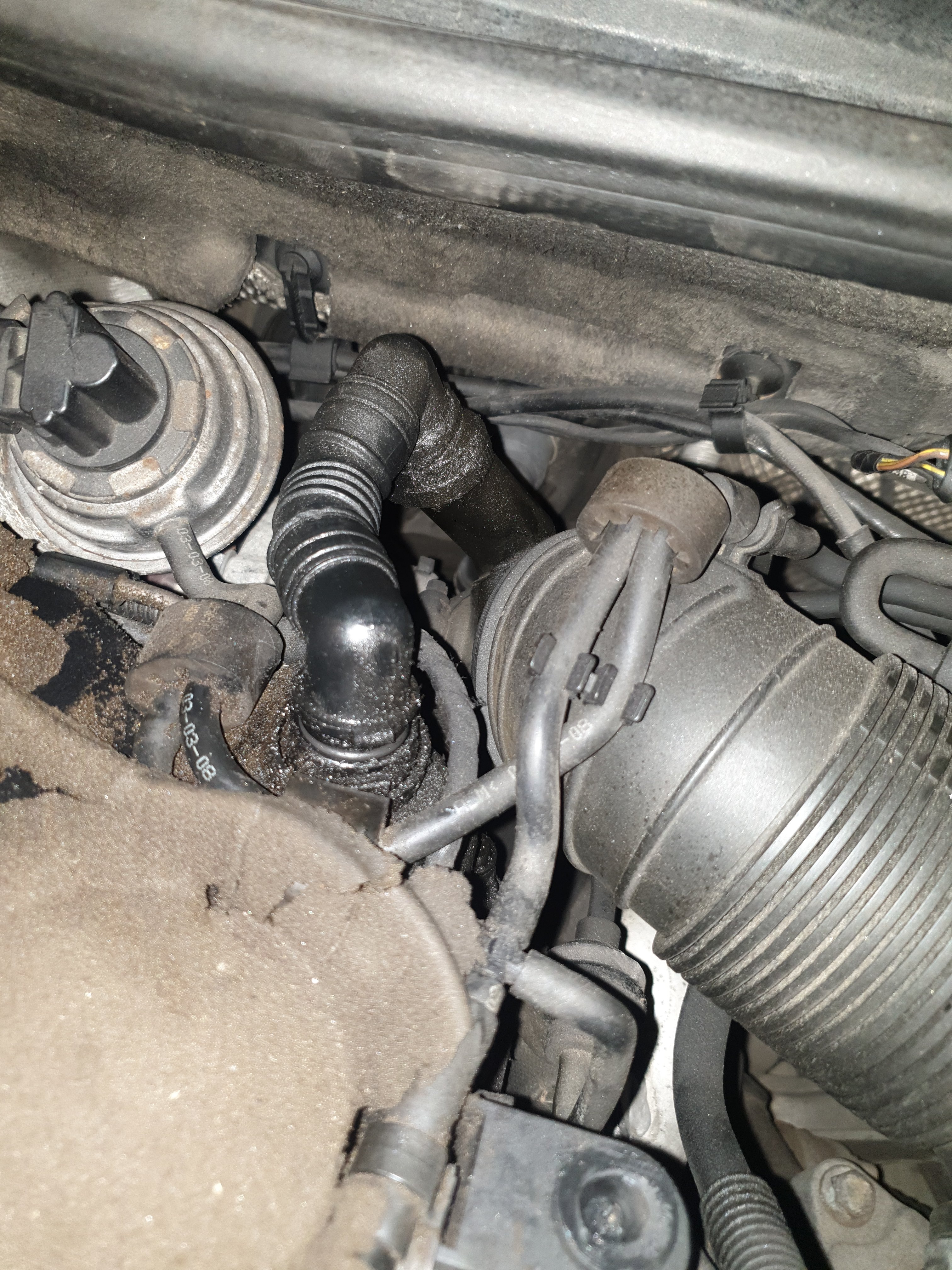

  25. Ah I see. Im learning haha. Whats the hose or is suppose to be loose with this wetting around it?
