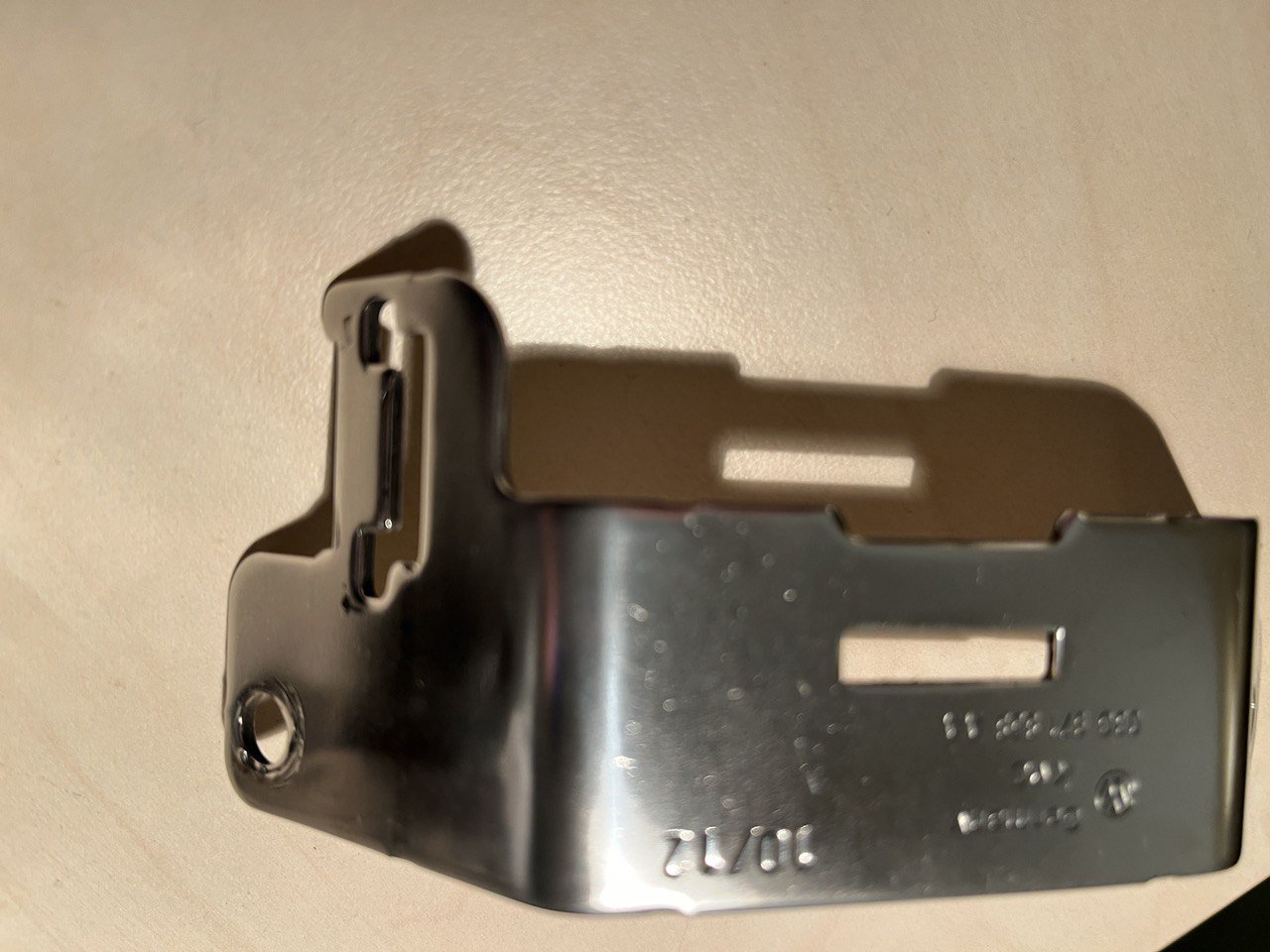

  5. Some garage idiot guy removed my turbo bracket and my turbo wires fell onto my turbo and burned. The garage guy does not know where the turbo bracket is and swears it was never there. Funny my turbo wires didn't burn until my car came back from him. Now I have the wires sorted out and have bought a new turbo bracket (part # 03G 971 858 AA), I'm trying to source the parts that fit into slots onto the turbo bracket. I think this is one of those challenges for the deep knowledge folks on here, as neither the dealer nor I can figure out what the parts are even looking at the ETKA drawing which he sent me a screen shot. Just for clarity, on top of my Borg Warner BV43A turbo which is in the VRS TDI model, there is a heat shield with a crinkly edge (part #03L 129 969 A). Atop of this is the 'turbo bracket' I have referred to above, and it is on this part that are cut two slots. All knowledge immensely appreciated as always. Hopefully images will help!
  6. Marvellous! Look, no scratches or scrapes from careless technician. Now wait for the careless technician and make them buy the next new one.

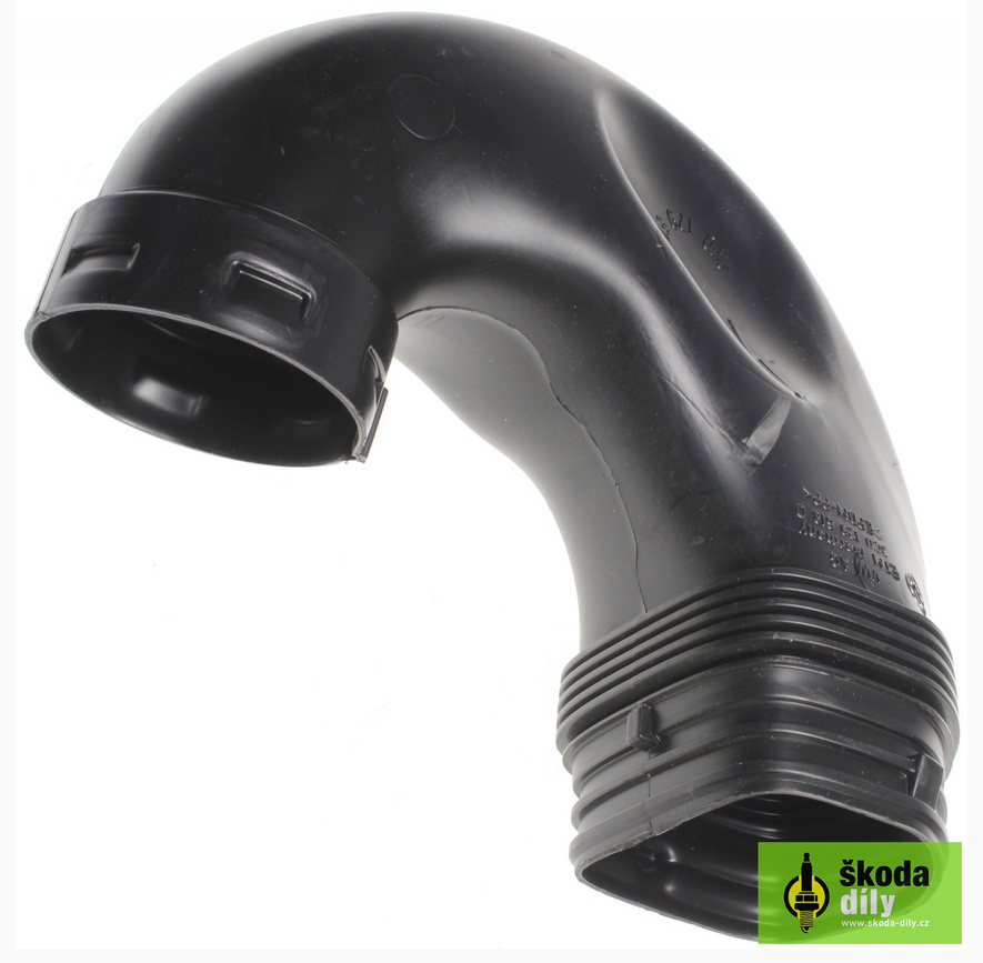

  11. I recently decided to replace the arched airbox intake pipe on my Octavia mk2 VRS so I found one online and bought it. It seems to be the right and perfect fitting part but I noticed a strange difference, It is a 2013 part and my car is 2011. What I saw is a 2cm diameter hole in the intake just where it is dished in, where there is an arrow pointing to the centre of the dished area and I see there the hole whereas on my existing intake pipe there is no hole, just circular markings where the hole would be with the raised arrow pointing to it. Very strange difference I have not seen documented. I'm sure experts here will know what it is. Is it perhaps a place where another pipe can be adjoined via a grommet push fitting to put refrigerated air into the intake? Is it simply to increase the intake capacity. As the air rushes through that area, does the dished in section speed up the air or turbulate it? Any ideas? Please share your theories or knowledge! Rich VRS mk2 2.0 TDI
