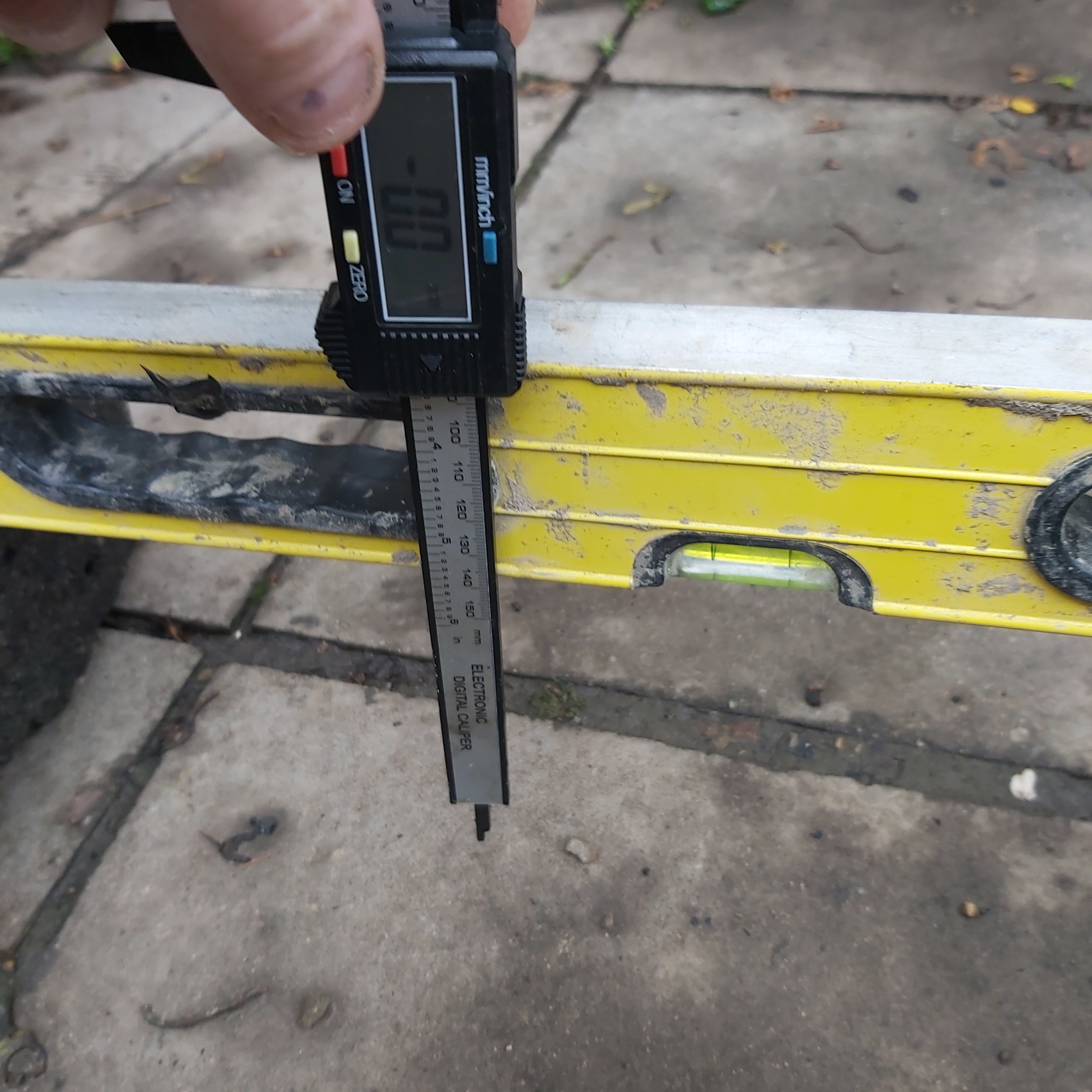

Gazza72 replied to M22 DKB - Darren Beattie's topic in Skoda Fabia Mk II (2007-2014)
sent you a pic i just done to give an idea of setting the clutch up i didnt use the level i used a piece of metal flat bar the same way and put it across the gearbox put the end of the vernier to the clutch plate and put to zero then it accurate if there is no play ie plates are tight redo it as its incorrect it has to have a small amount of movement of it will not work and cause damage 1 clutch i got to 0.2mm and the other was 0.7mm and works a treat -
a digital vernier with a metal flat bar across the gearbox found it on youtube measueed at 3 points i ised a digital so i could get it accurate -
hi mate i was but do it from home now can tackle most jobs this isnt for the faint hearted its a ball ached but worth it in the end if you clutch pack is slipping it could just be the mechatronic unit do that first unless you are doing both together my advise check everything i had rhe gearbox out 3 times tolerance on the clutch plates is less than 1mm on each i used a digital vernier with a metal bar across the gear box removed clutch pack with bearing puller and a piece of metal flat bar cross the gear to relocate you will need the tool for setting up the packs use 1 way for 2 and turn it over for the other check youtube loads on there what isnt clear bit will jelp if you take the mechatronic out make sure you ise the software or place the key in the car and put and leave in neutral the disconnect the battey drain oil out of gearbox and drain oil from mechatronic unit before you open it as its under pressure refill before reinstalling as the filler hole is your drain hole 1 liter special fluid not gearbox oil.you will need software i used odis another tip 2 pieces of screw thread about 5" long put them in you top screw holes to relocate mechatronic unit the take back out and make sure the forks are located properly with loads of grease on the pistons on the mechatronic unit if the grease has gone in the groves then you can reassemble if you get stuck message me check the piston on the mechatronic unit for broken clips i used the circlips found on turbo actuator as i had them already -

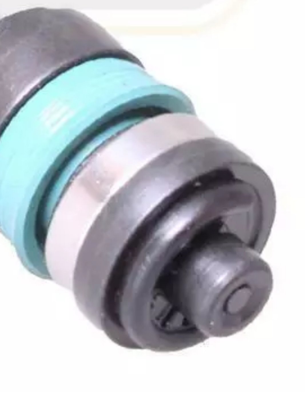

hi there did you sort it out i had the similar problem with mine just got to the bottom of it it was 2 faults i replaced the clutch myself and still had the problem it was the mechateonic unit would work for a week or so if i did quick gear changed went into limp mode or stuck in gear orders a new actuator housing as these are prone to cracking and on replacing the unit came across poss the part or all the problem the piston for 1 of the forks the plastic clip on the end that holds assembly in possition was cracked and pieces inside the chamber blovking the hydraulic hole car has been back together a few days and runs like a dream -
