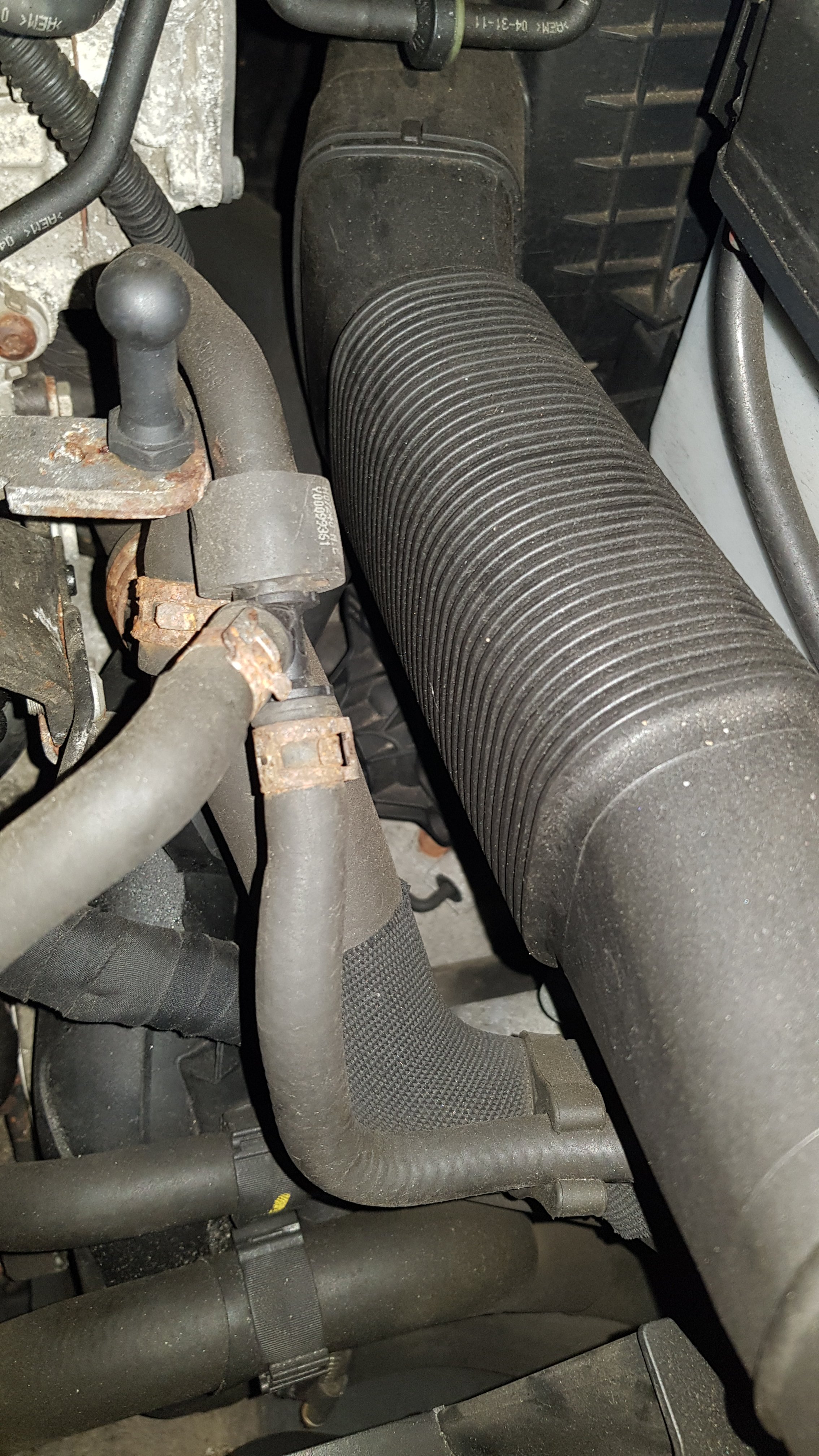

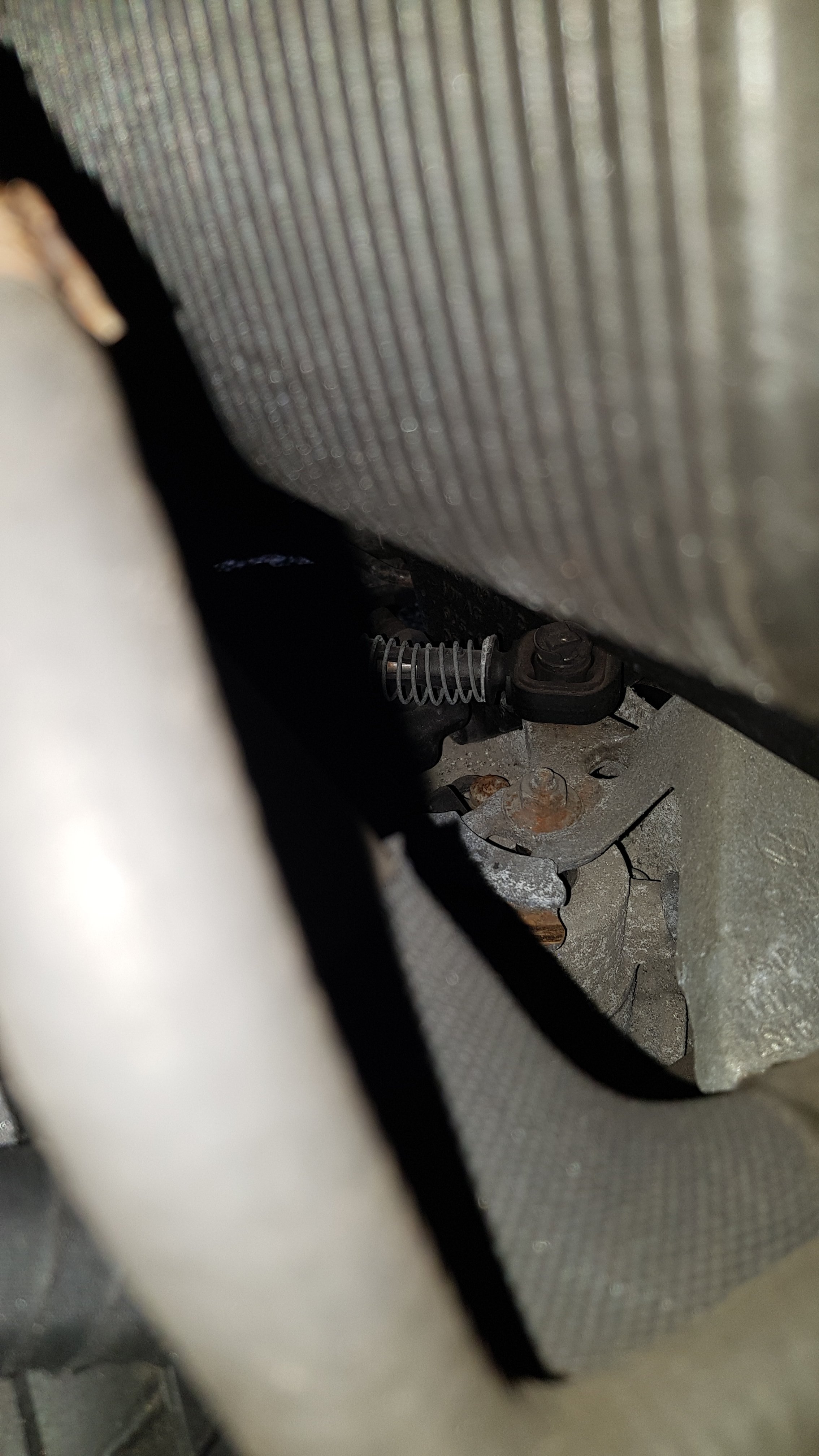

Skoda mk2 1.6tdi gear transmission fuse?
Hey guys, Had this fixed now, the gear linkage was just seized up had it realigned and greased, he said gearbox might be abit ropey so could be a future thing, But feels brand new now. Cost £80 if any one is interested.
Thanks for that, looking at that part it's almost built to fail. The wd40s not a bad shout tbf but I'm worried that oil could just attract some more dirt into it in the long run, I think it's the alu casing that's got gunk / corrosion so needs to be smoothed where the plastic rod slides in, but this is just me guessing, I'm sure itll be the whole gearbox that's broken knowing my luck lol. Cheers.
If I had the tools I'd have a crack, that's the downside too living in a 1 bed flat no storage space and awkward place to work. Do you know the name of it, I'm guessing it's called the gear linkage? seems like a common problem. because of lockdown shes been sitting there and I think it's just corroded and needs a clean, lots of parts that where fine 6 months ago seem much more rusty.
Hey guys, Had some issue with my gearbox recently sticking and not bouncing back too neutral. Ive done some digging online and I think it's this bad boy but I'm not 100% sure anyone know the name of it, I cant seem to get much google hits on this at all. https://www.skoda-parts.com/spare-part/34d711202-transmission-fuse-skoda-18974.html Anyone know if this is a costly job looks like a nightmare to get too. I'm hoping this part replacement and transmission oil top up will sort it. If anyone has any possible ideas/ solutions? Thanks guys. **added youtube link.
