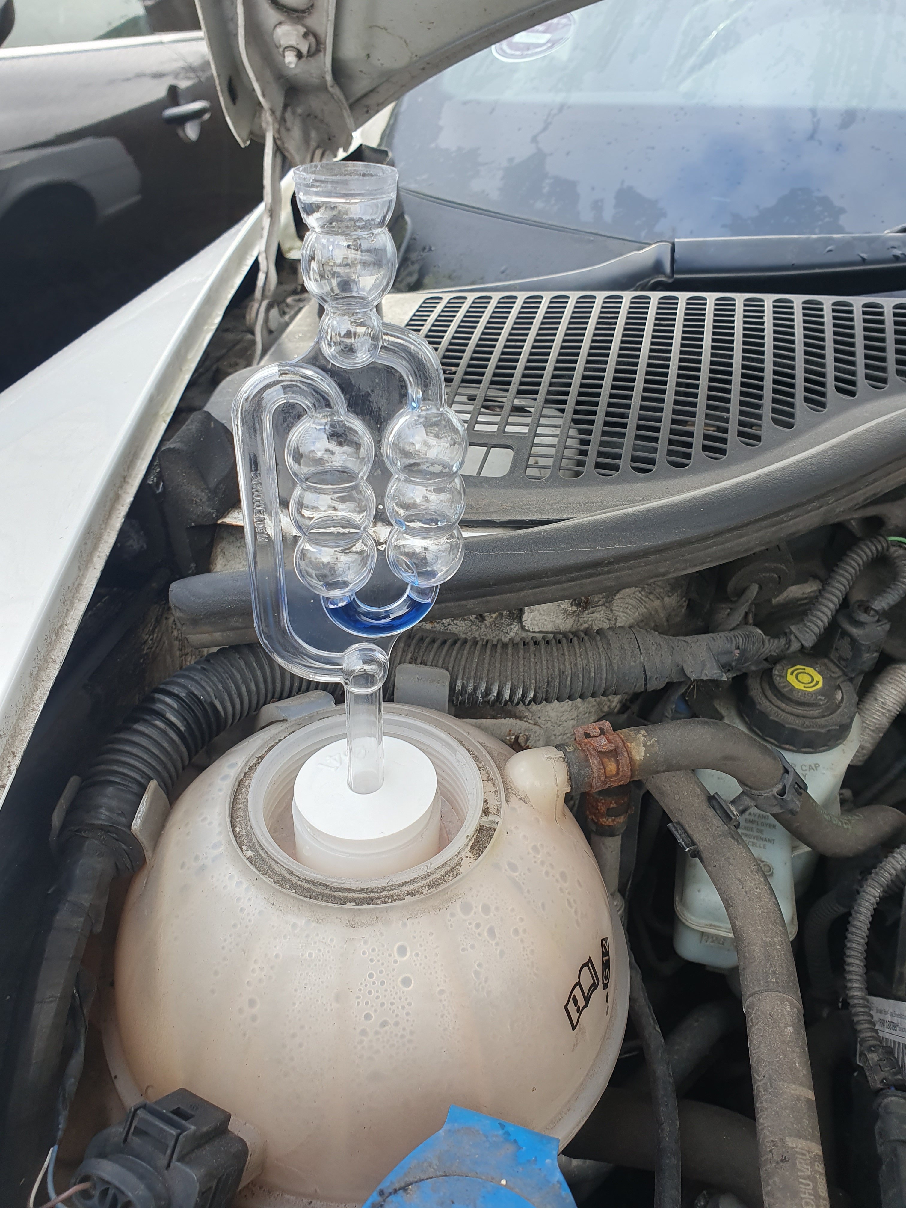

  3. Update: so today I done a combustion test all resulted negative which is great news for me! I just still need to find my coolant leak. One thing I did notice was a rather noisy rattle and high vibration from the chain case left of the engine block, I turned engine off and looked at my oil levels which is sitting mid way from min to max so I think I will give that a top up and see if it quietens down. Unless someone can relate that to coolant loss and let me know. Next I will be doing a coolant drain, flush with water and coolant refill then add some Sealit liquid and hope it seals my water leak. Its a shame I can't upload the video I took doing the test, its 1.3GB
