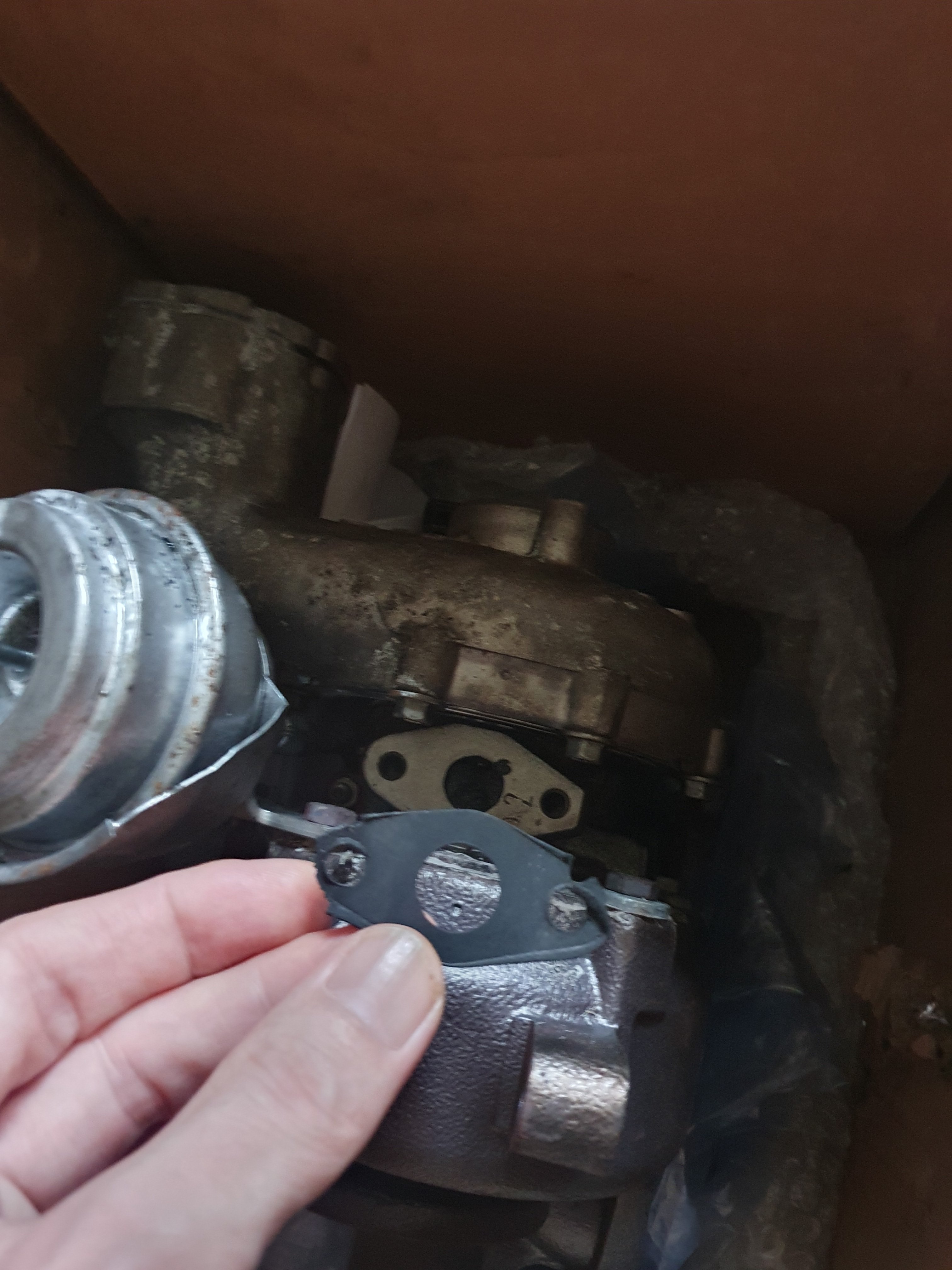

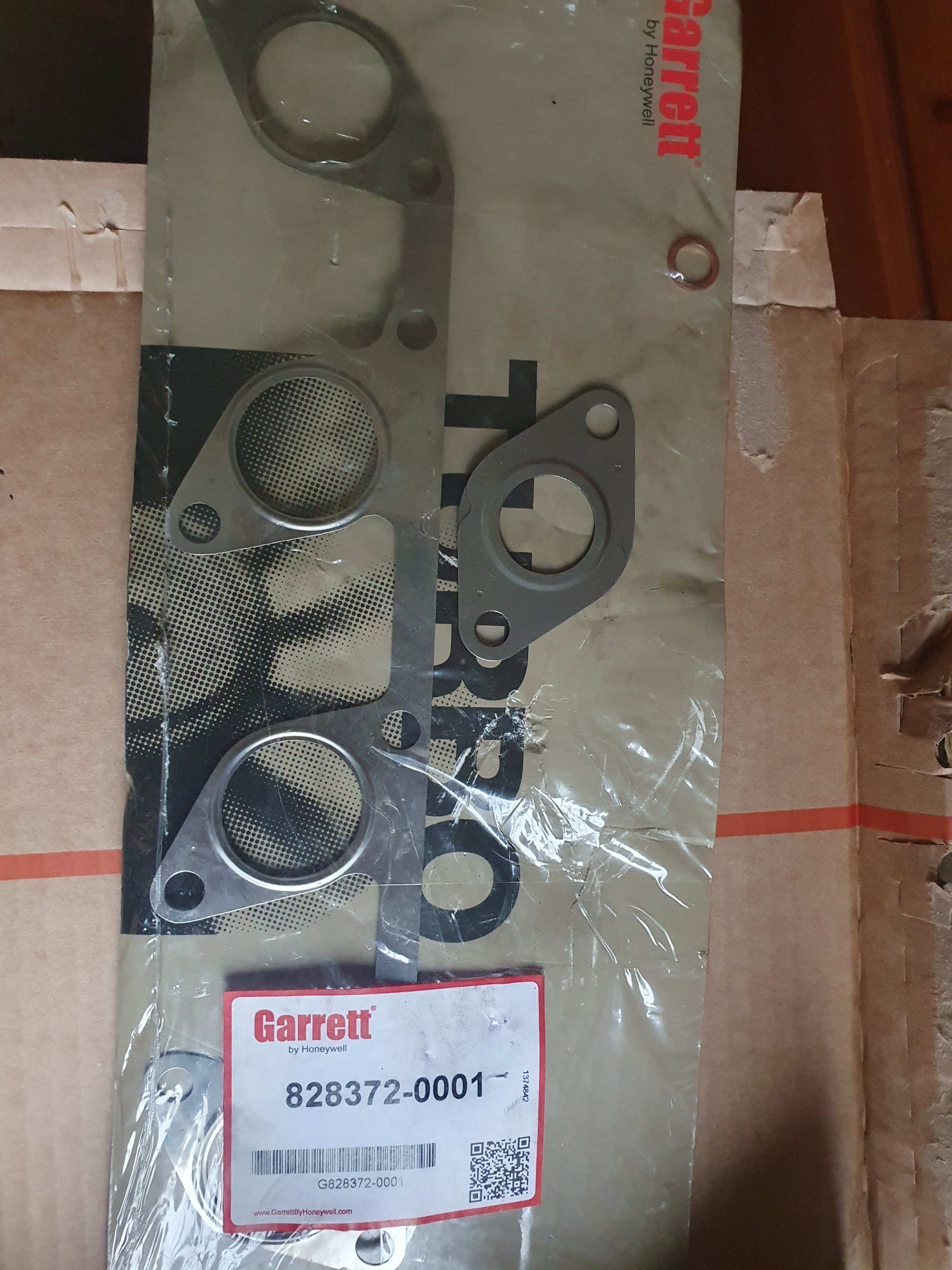

New turbo leaking already!
I bought this because I changed all the gaskets. You just need the 1 gasket, get a oem maybe from skoda dealer or a trusted supplier. That gasket you need should be less than a fiver.
- New turbo leaking already!
Bingo.. the one I used supplied by Garrett is like a hard thin black plastic not metal.. I will send a picture of the old one taken off- New turbo leaking already!
Also was the new turbine garrett or an import from China? A new garrett is 150 China 50 and they will fail rapid. So many turbo recon companies and rebuilders now use cheap import to save costs. The garrett gaskets and the one from ebay are like chalk and cheese- New turbo leaking already!
I done a turbo change on my Sons bkd last month. It's an audi A3 2005 but the same. I found the turbo gasket kit my boy got was not great, it included oil return gasket aswell. After fitting 2 days later under boost and engine light. Thought straight away those gaskets are poor. I bought a gasket kit from Garrett and changed them, boom problem solved and running a dream- New turbo leaking already!
