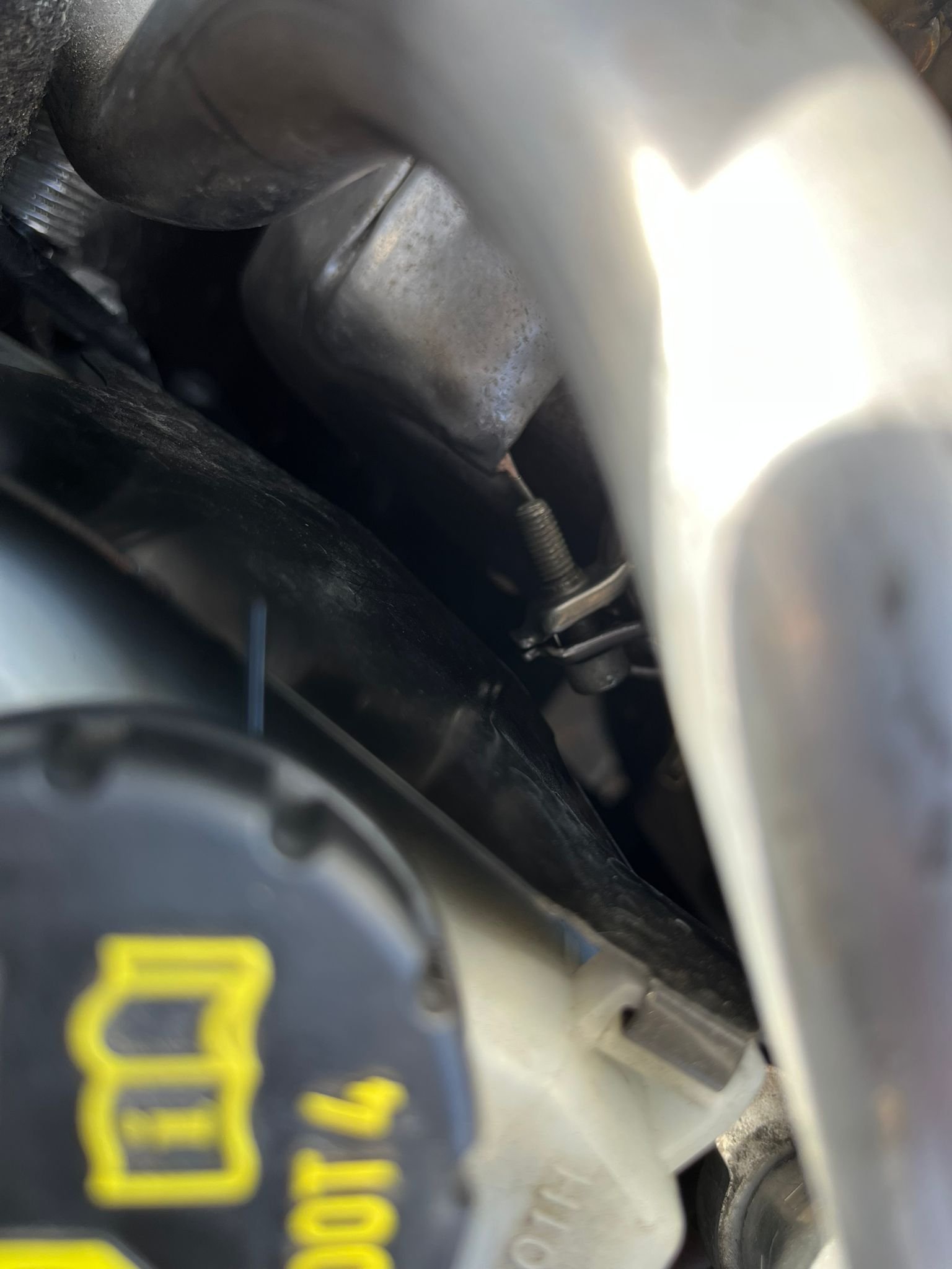

  1. I thought I'd share the eventual story behind this. I took it back into the garage and they agreed there was a bit of a squeaking noise at idle but decided that it was likely to be the auxiliary belt. Ok no worries let's get that sorted, I understand that when lots of stuff has been removed and replaced other things do get knocked or become more apparent. Noticed today that the noise is drastically more noticeable when turning left.. Doesn't sound like the auxilliary belt to me for a multitude of reasons. Figure perhaps it's the suspension, get the car up on stands and mess about a bit, yeah bit more noticeable but not obviously suspension on load or unload. A bit of fettling later with the bonnet open managed to nail down where the noise was coming from. It looks like the heatshield on the brake fluid reservoir is rubbing slightly against the Jubilee Clip next to it. (I guess what's happened is it's been removed during the service/cambelt change) and replaced in a very slightly different alignment. Problem solved temporarily with a couple of cable ties to pull the fluid reservoir away from it. The clip itself is a right nuisance to get to but given it seems to be an error from the garage I'll ask them to shimmy it round come MOT. Photo and video attached just on the off chance anyone ends up with the same issue. WhatsApp Video 2022-09-17 at 12.50.34 PM.mp4
