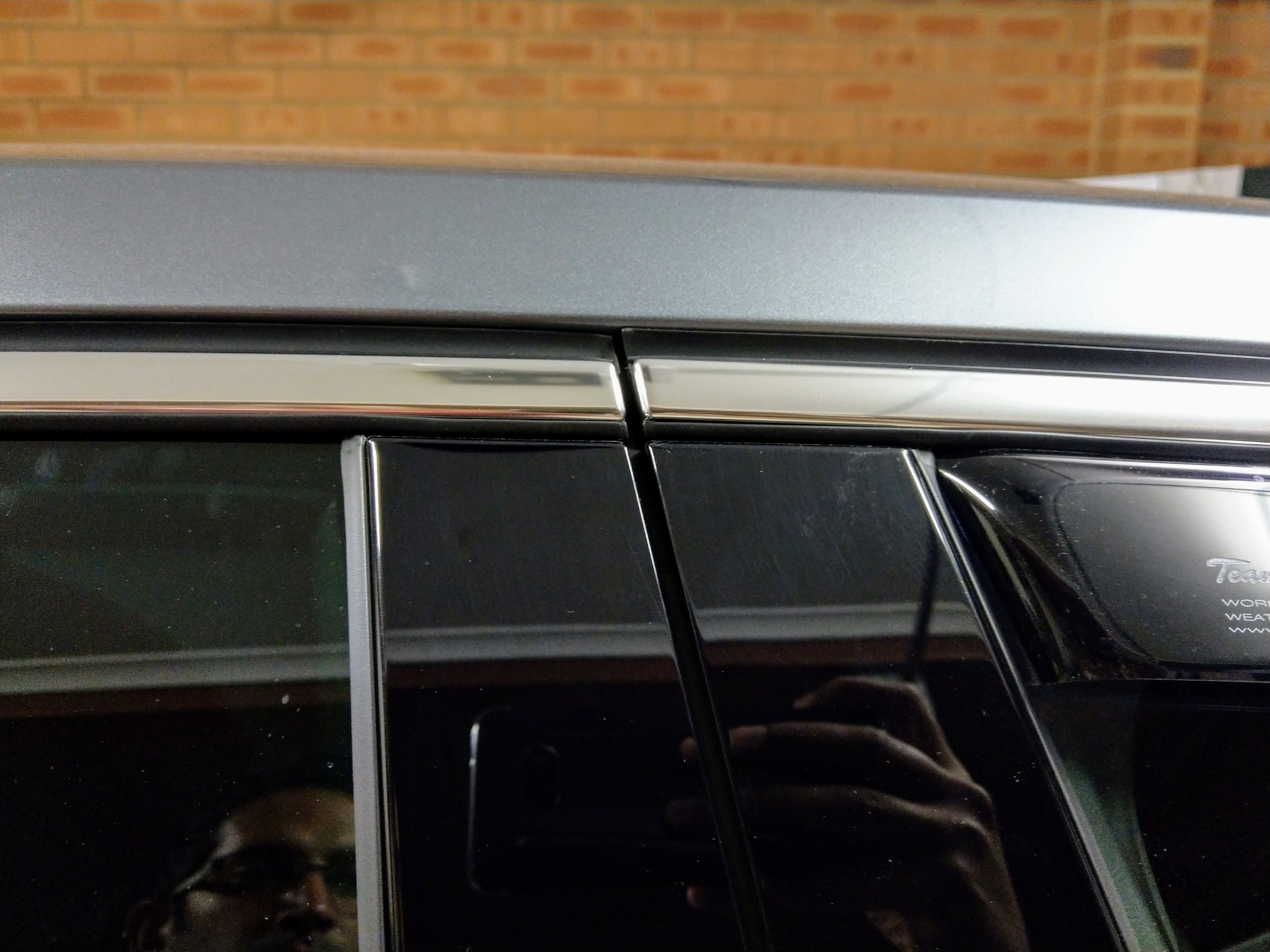

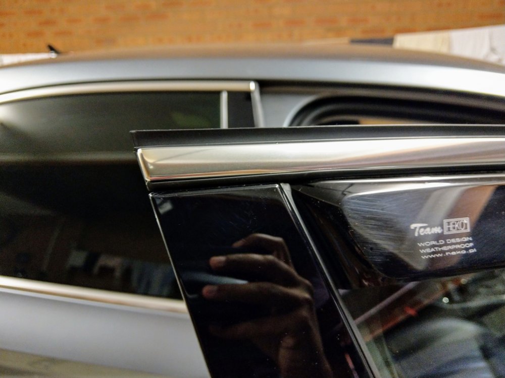

I sent this photo to Marshall Skoda, Croydon. They've booked me in for Monday morning, so not too bad a wait time. I offered to stick it down with crazy glue. They said, no, they'll probably replace the whole trim. I'll let you know how it goes...

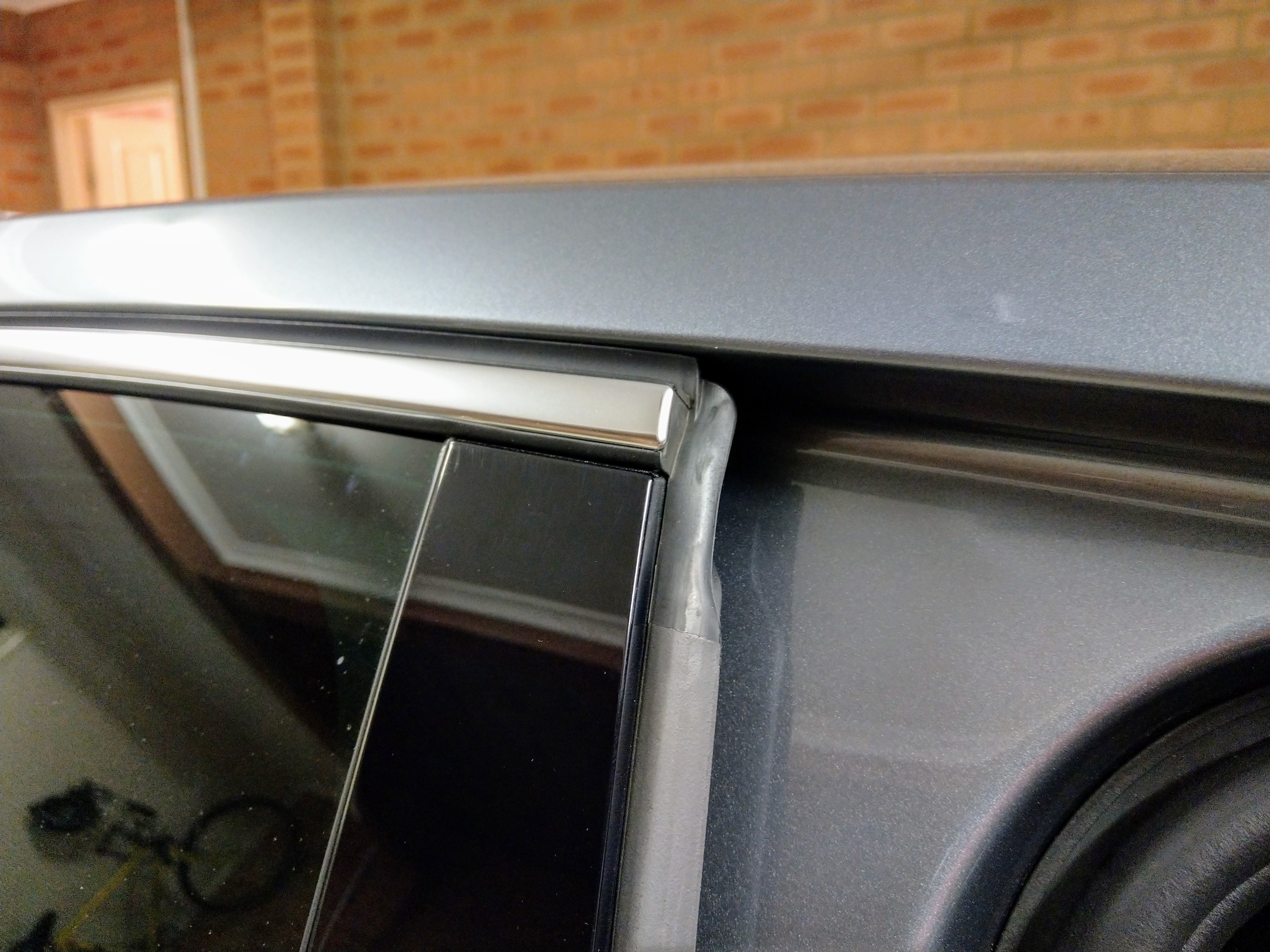

On Saturday the car started the same fault as the OP but on the n/s.  After 3 dealer "repairs" to the o/s chrome strip I thought a DIY repair was in order.  The strip is easily removed - bottom edge first. Easily straightened by hand (assume the black trim is the same metal), surprised how much "bend/distortion" - well past the point where the strip left the seal.  Replaced the trim as far back as possible on the rear door starting from the rear edge of the door.  Hook the strip onto the top "rib" of the seal and after about 6" in place start pressing in on the bottom edge whilst pressing in and down on the top edge and work  forward ensuring the "pushed in" bottom edge is kept well behind the hooked on top edge.  I could see no visible change at the front /back door join but it hasn't occurred since.

The tolerances between the front and rear trim are quite tight... obviously over time too tight, the replacement will be better as there is a much bigger gap.
So am I understanding correctly that this happens because tips of front and rear trim toutch together? :blink:

for reference, here is the door trim from an MY17 model, which doesn't suffer from the dreaded trim issue.
MY16 is notorious for the door trim issue.

Just an update. I took the Sportline in Monday morning (Marshall Škoda, Croydon). I was greeting by an unnaturally cheerful young lady in the service department and we filled out paperwork. Then we walked to the car. She took an iPad tablet 360° video of the car. I showed her the problem. She said she'd call when it was fixed.
Tuesday, 11:45 I got the call. I was cheerfully greeted by the receptionist and the service department head, sat until my car was pulled around front, was handed my key and she said, "All done". Itemised workshop sheet will be sent by email, if you like. All covered by warranty. I opened and shut the door a couple times, you could see the gap was proper, so they didn't just glue it in place but shifted the whole trim. Perfect.

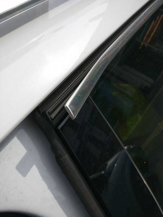

I had this problem, it's just fallen off. Trying to find myself a part number for a new bit!

Unfortunately not, I've been able to find the chrome type ones. I've asked my local garage (Heritage Skoda in Gloucester, they're useless and have actually completely put me off purchasing another Skoda) multiple times and had no response. I'm going to reach out to a couple of others and see if I can get a response or quote to get it fixed. Logically there must be a part number somewhere, and it must be a 30s job to sort it.
