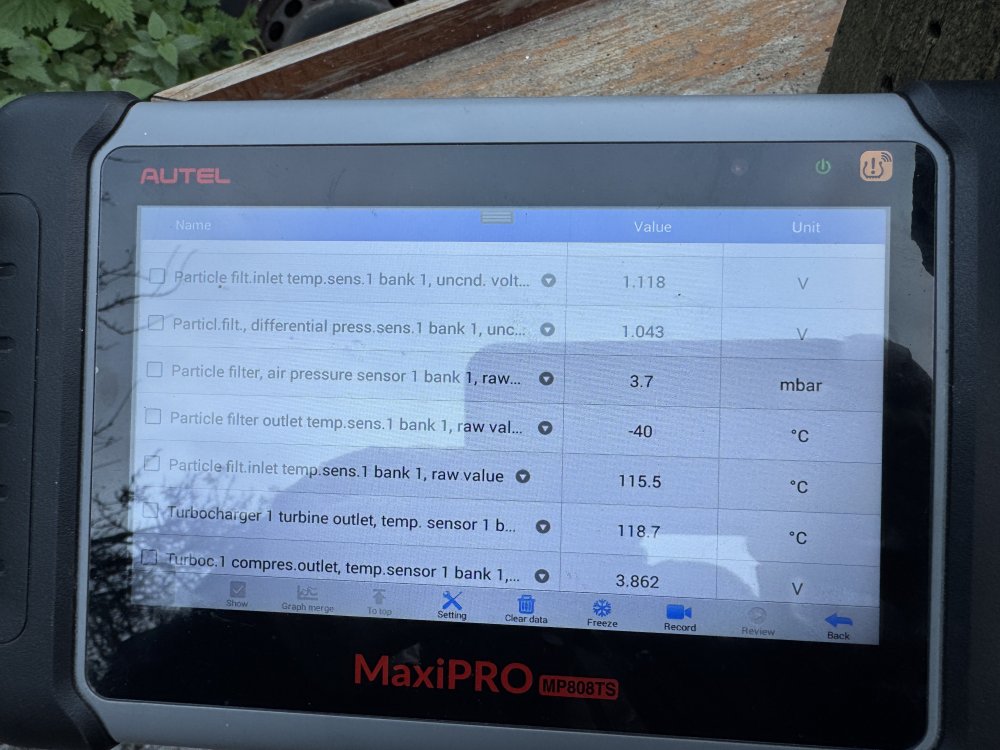

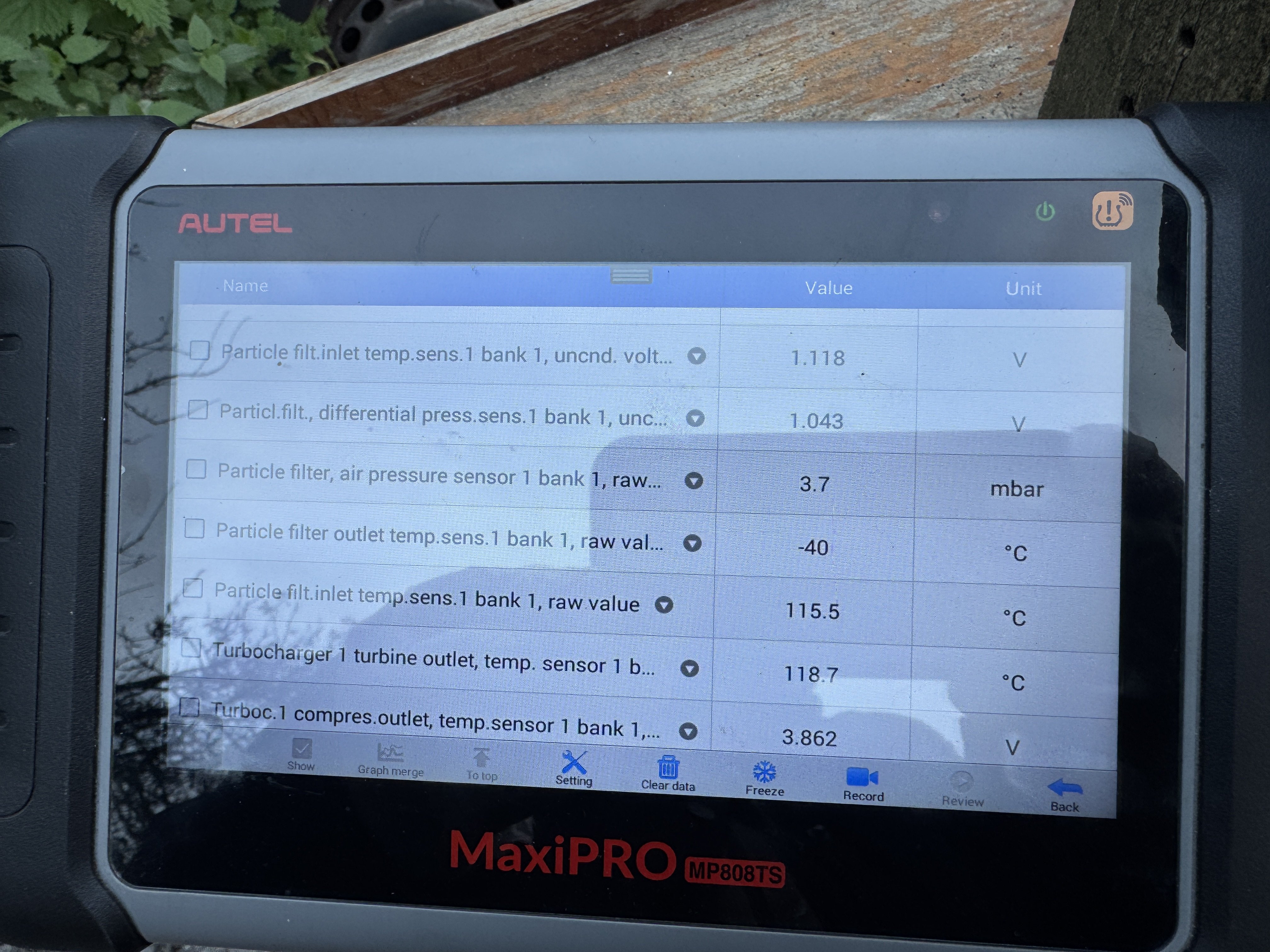

  1. Thanks for reply, I found another thread somewhere that this reading is as there is no actual sensor? and that the reading is shown on his also, I have removed all 4 injectors and taken them for testing, I hope I shall be told one of them or maybe 2 are faulty so I can get the car running nicely again , , Hope everyone here is ok

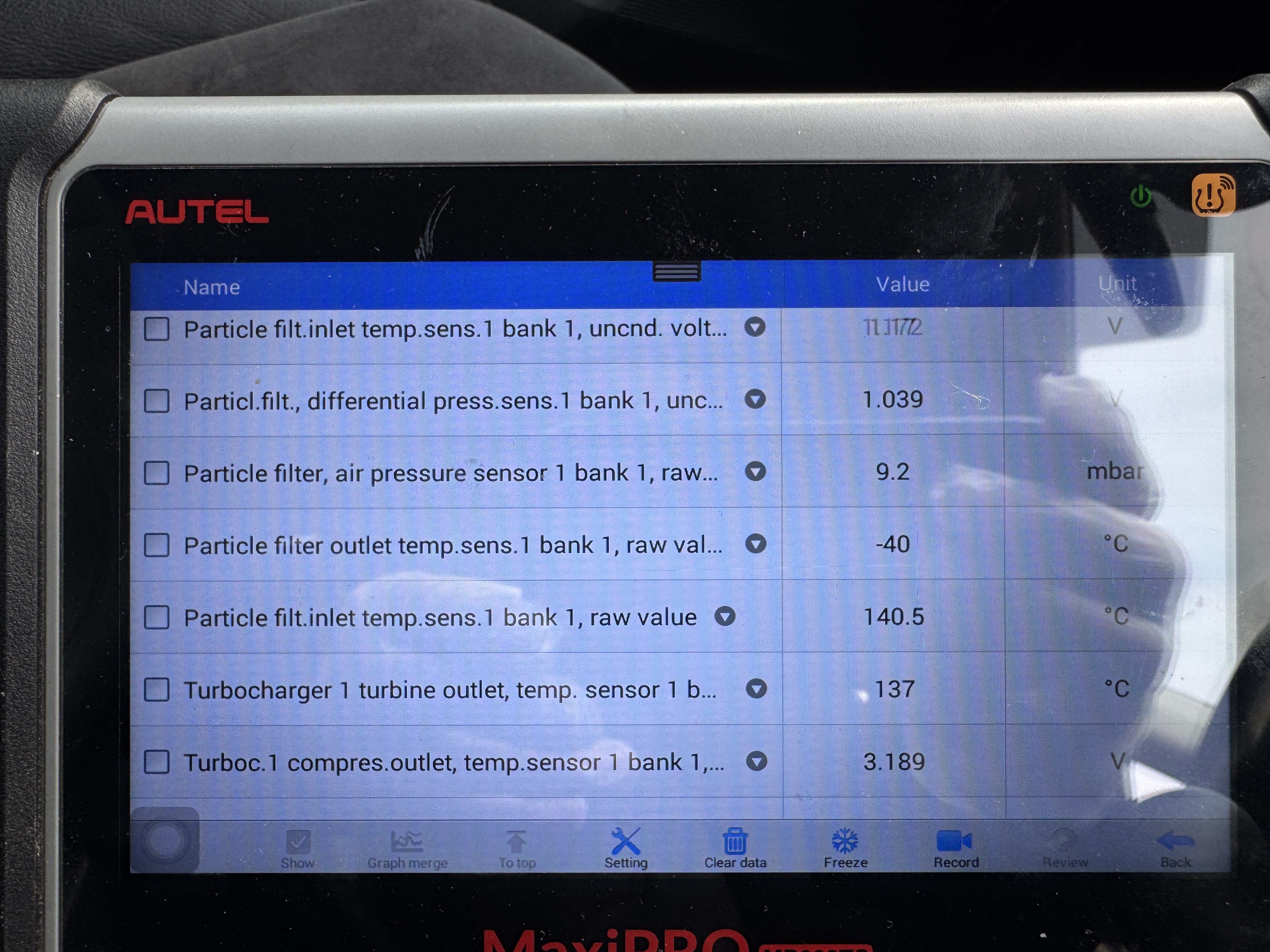

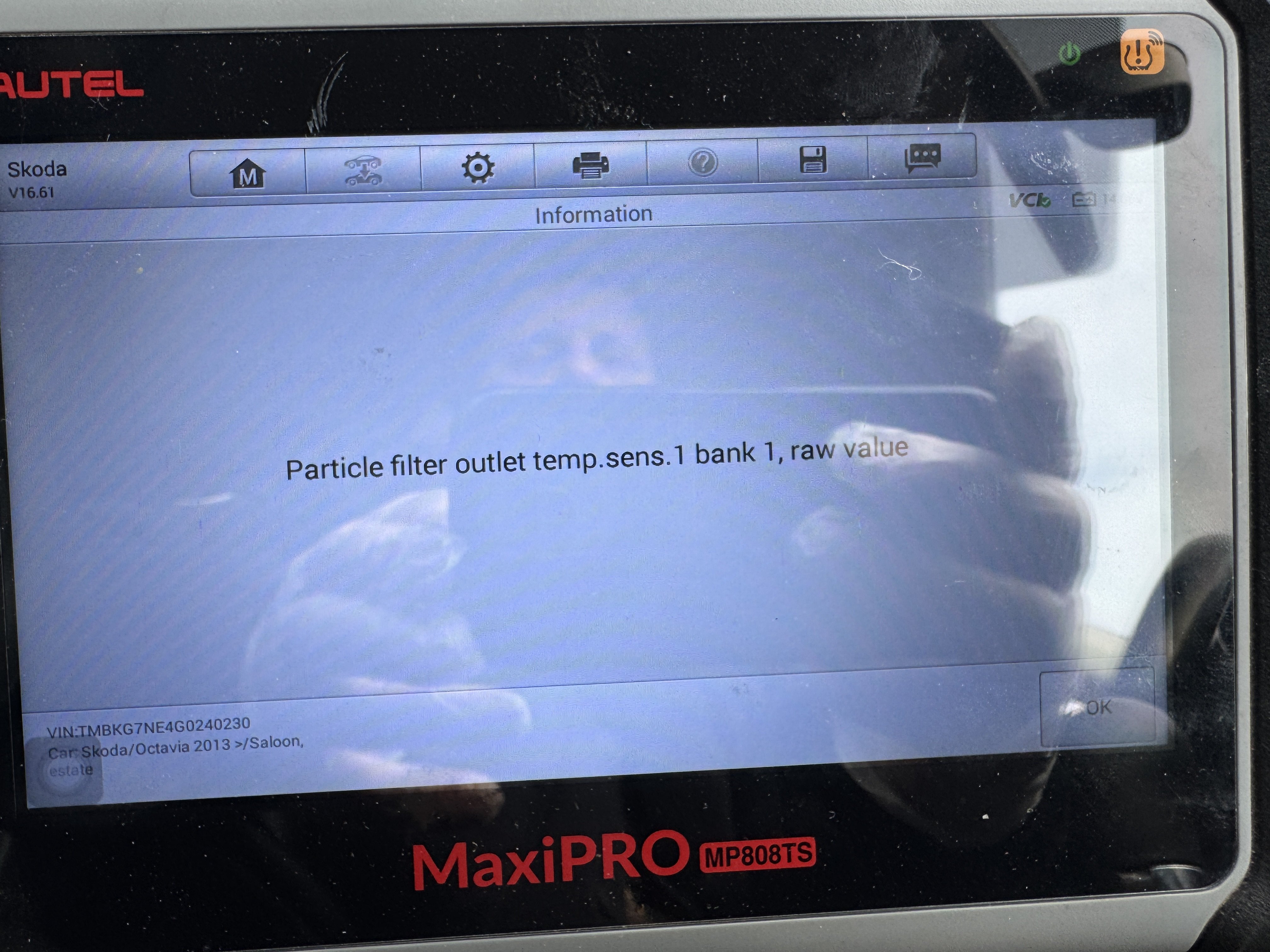

  2. Hi there guys and girls, I just purchased a second had Octavia 2016 model, nice car, has 140k on the clock, Just having an issue with it, First thing in morning it really difficult to start , turns over, fires runs really lumpy engine shaking all over place, put foot on accelerator otherwise it will conk out and engine stops, so I am thinking it could well be injector issue, Im not getting any codes which is really weird, So I took for good run and had lot of smoke coming out the exhaust, I attempted a forced Regen but computer kept saying fault and unsupported ........ So car was running hot the revs sat at 1000 revs as if the car was doing a normal regen while i was driving it, the smoke stopped after about 20 mins but the revs never dropped, I looking at live data and the car was not doing a regen according that so I am wondering if there could be a bad sensor that will not make a fault show, I dont want to take injectors out and have tested until I have explored the sensor part first,, also I found one reading at -40 deg on outlet temp sensor bank 1 and also coolant temp sensor 2 ,,, I never come accross this before!! anyone got any ideas thanks!

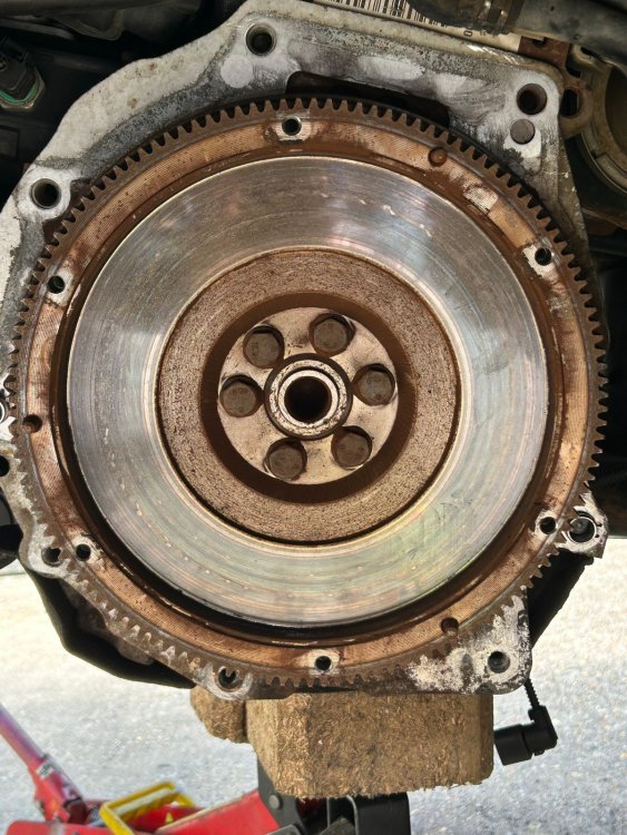

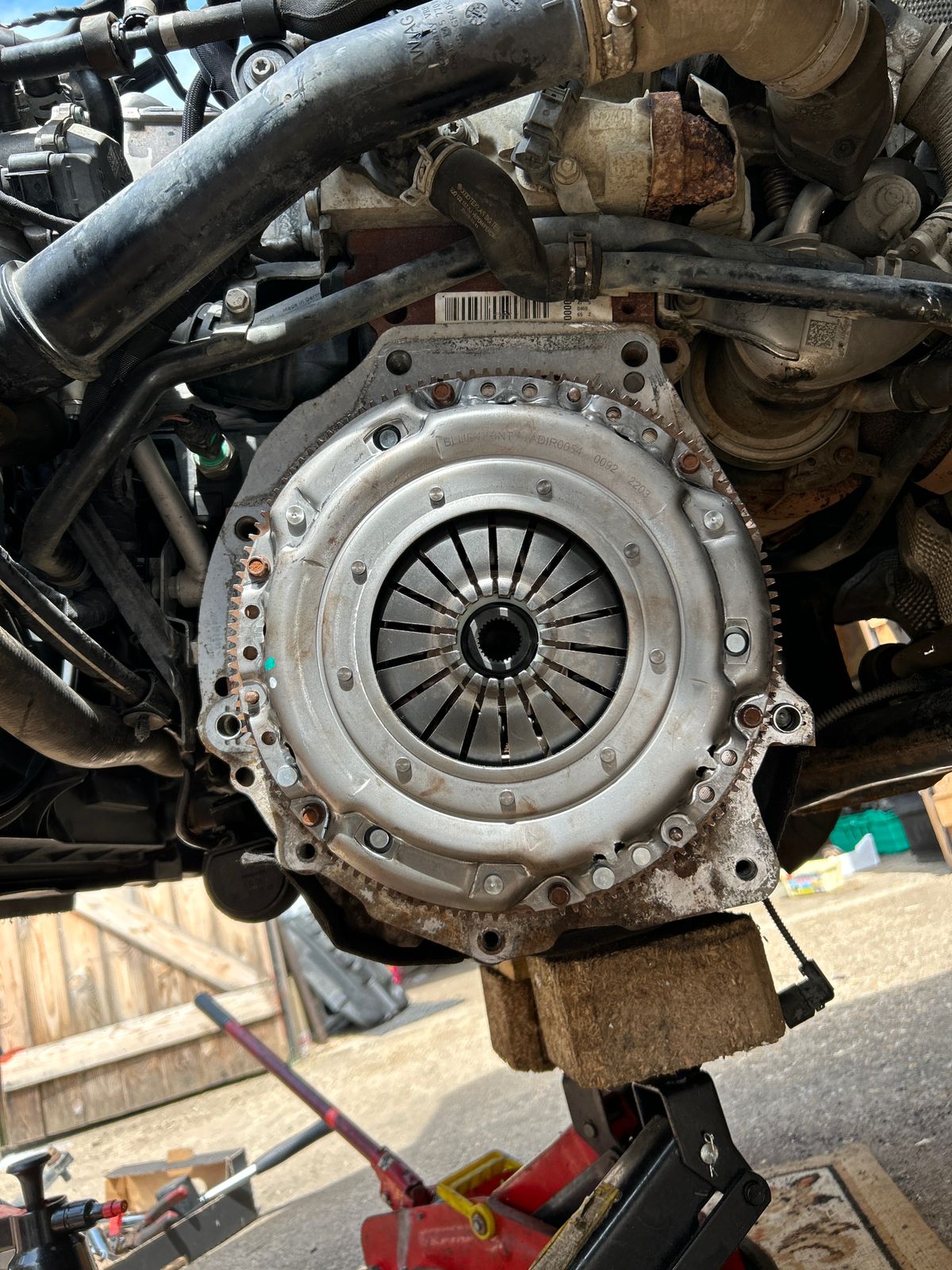

  5. it is indeed, i didnt make it clear sorry,, i have a mk6 gold 2012 tdi 1.6, with a dual mass failure ... well thats what it says on the receipt from the garage that was supposed to have fixed it ,, they prob just scammed the previous owner as the engine (bottom end) has gone , and according to them it was an injector

  9. Can anyone tell me if this video the arm thing is correct? When the noise I had was just like that arm thing rattling about , I did a kind of test on the gearbox but it did not make any unusual noise please can any one who knows about this things advise ! dabcc49a-8882-4da5-8a14-259d43bfd74a.mp4 My video of the drill taped to the shaft was to large to upload
  10. Hi All. I could really do with some advice please ,, Are the 5 speed gear boxes known for issues? I have now removed mine and i am not sure and i dont think a gearbox expert would be sure without dismantling it, if it is faulty or not! I would have thought any problems would have been ironed out with the newer boxes, the clutch still has a bit of life in it., i will have to change it while its off the car , otherwise no sense really , I am looking at putting another gearbox on as i dont know if the noise was the gearbox or clutch,, i dont want to have to repeat this process so maybe just be sure and get the other gearbox 😞
