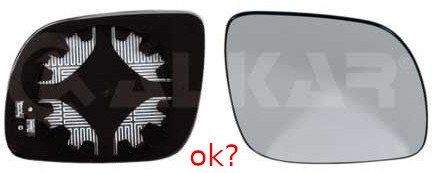

  1. If you're ordering a mirror for an MK1, I've seen two different models: one with a visible rim and one without. The rimless version is often too small.

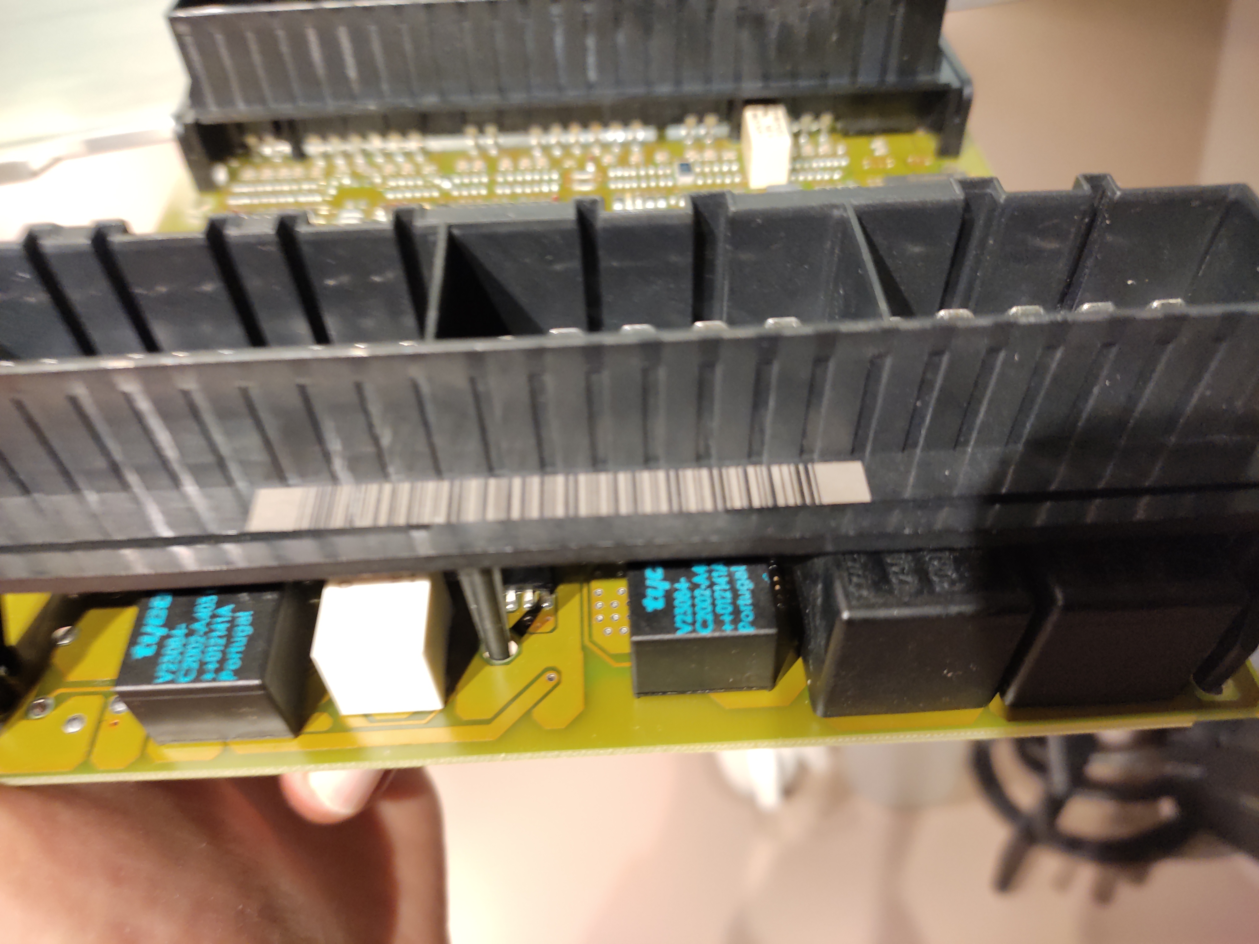

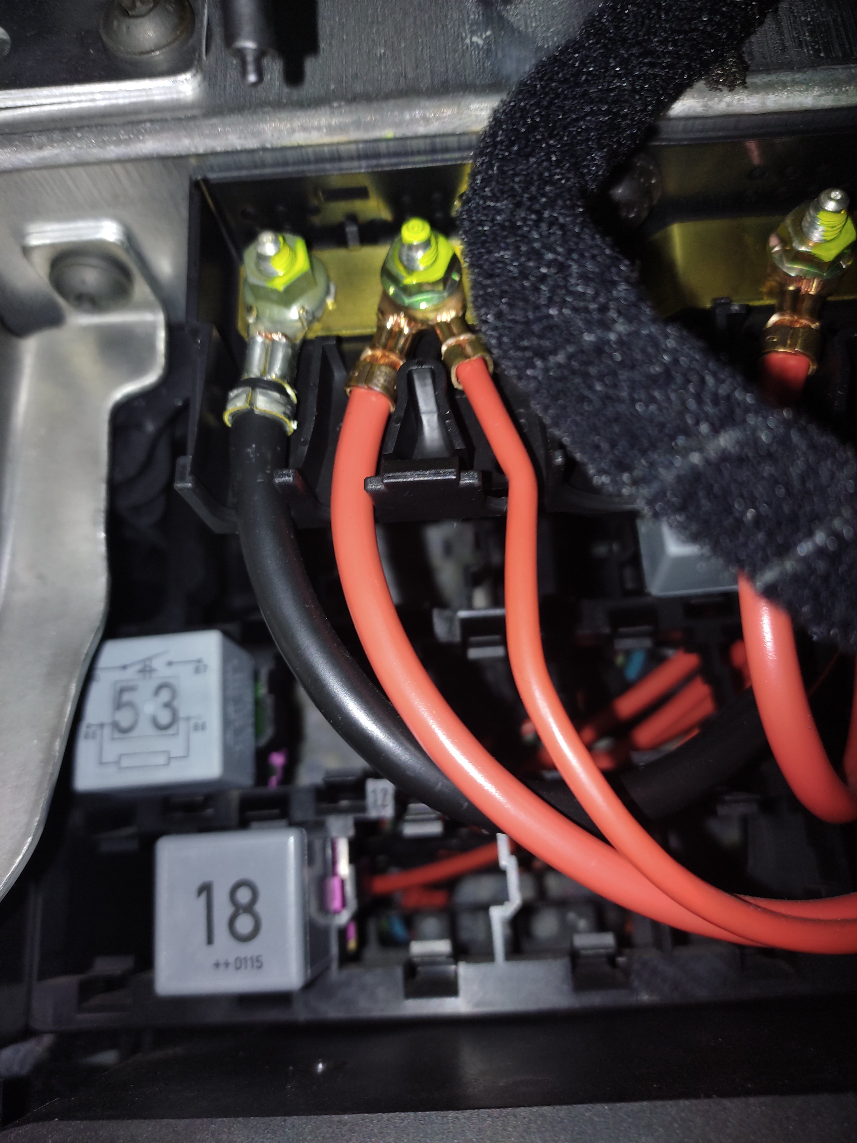

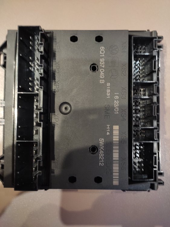

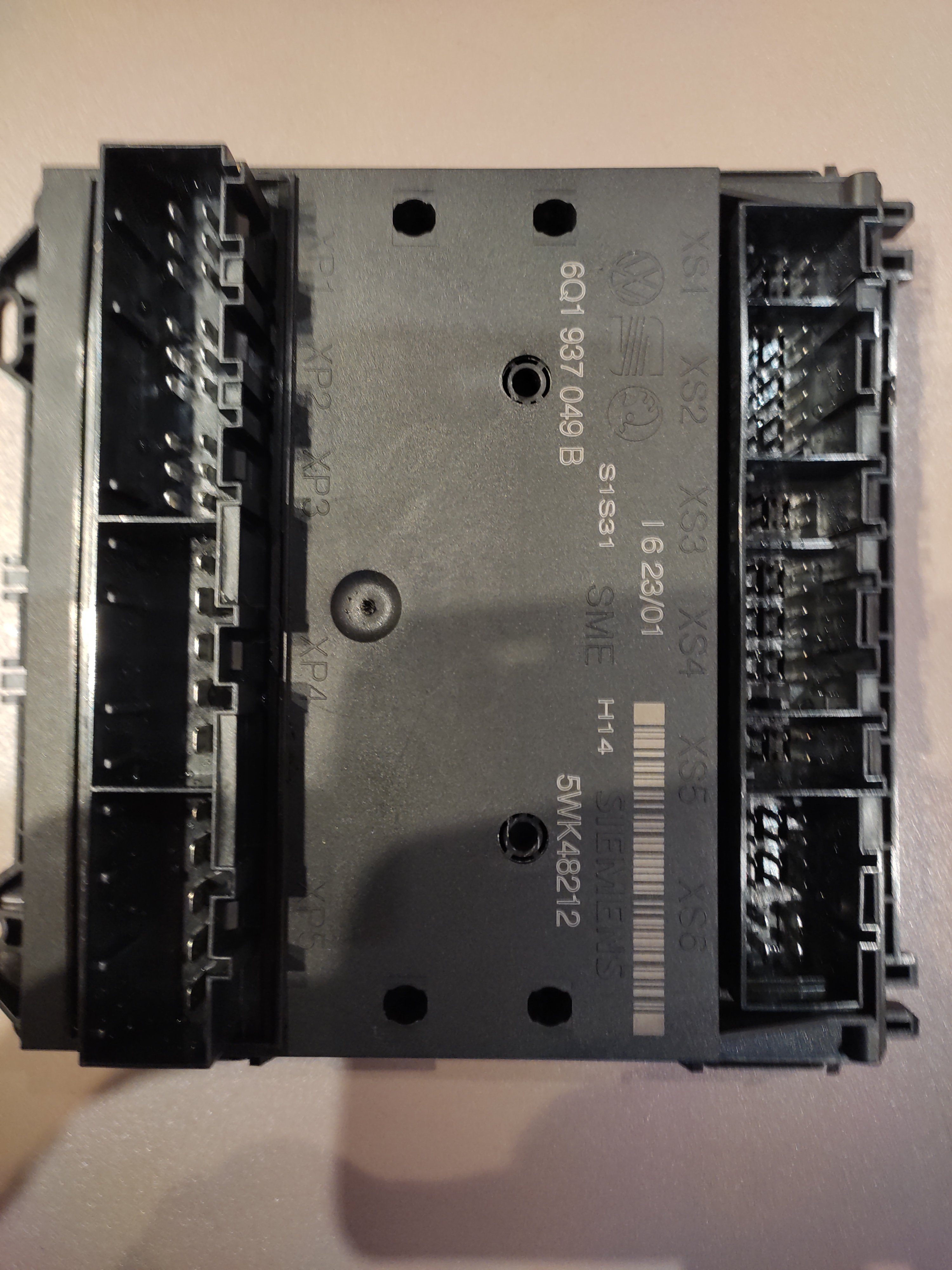

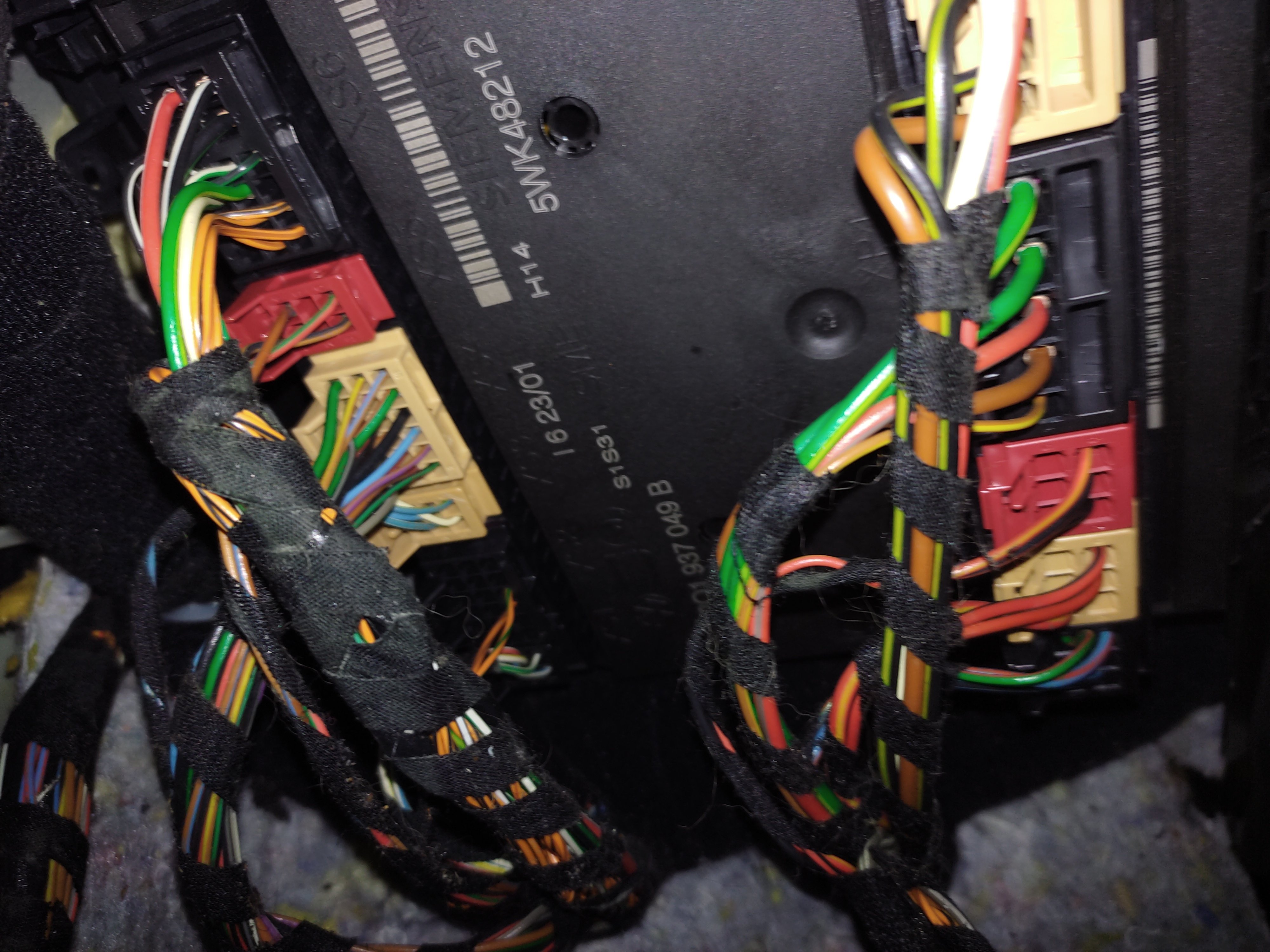

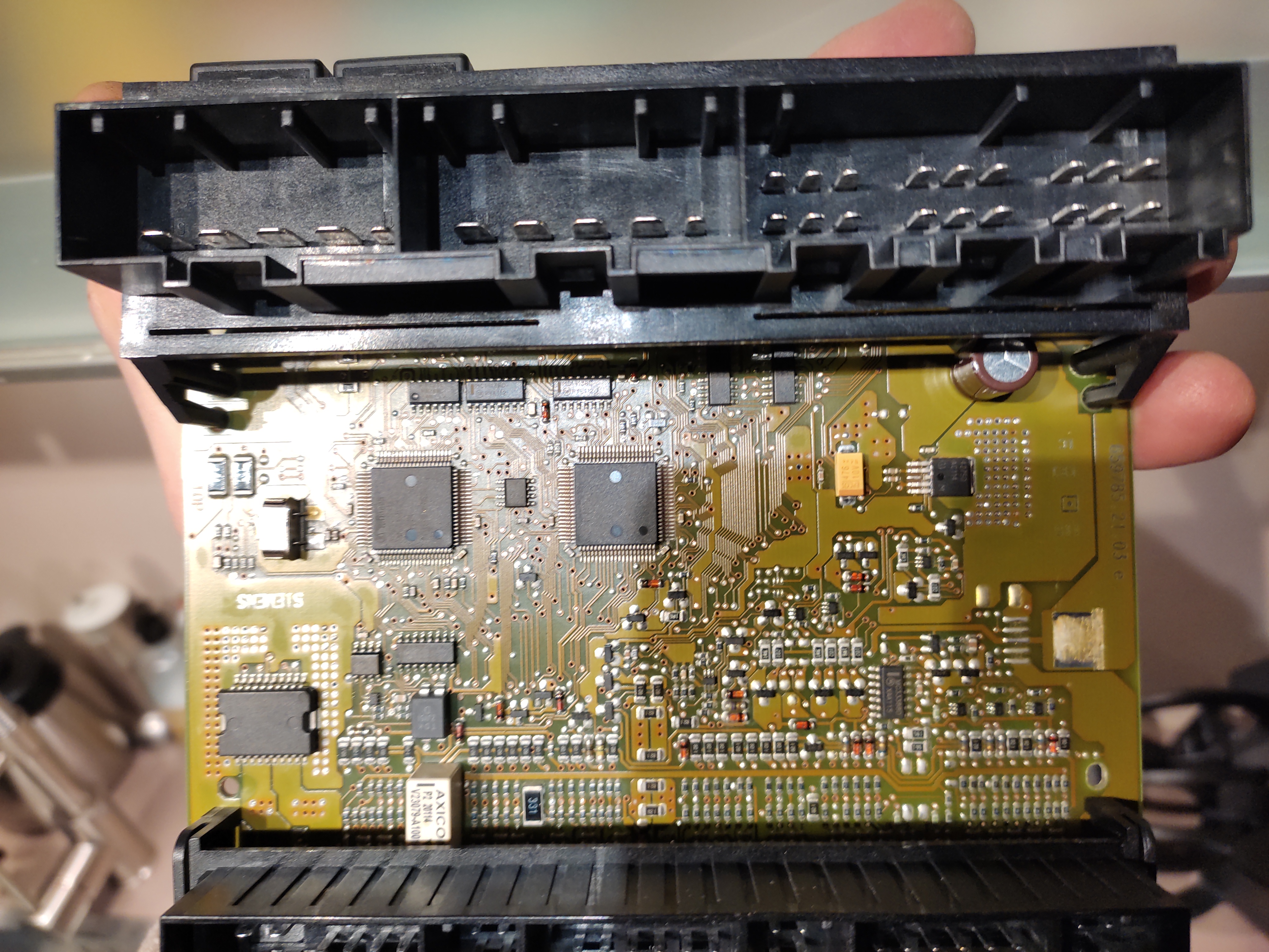

  6. P.S, I made a post in 2017 about the old alternator, and the L and DFM voltages are still the same now as back then. The load was reported correctly even in the VAGCOM logs. I hope I still can get a new alternator that will meet the OEM specs of the 047903015Q. "* The two signal cables (L1 and DFM) at the alternator read 11.5v from the car with the contact on (not running) and the signal cables and connectors look good. Battery light stays off when the alt. signal connector is disconnected when on contact > ok " Here are some pics of my BCM in case anyone need them (if they have issues with L1). Including some pics of the relaybox and positive connections in front of it.
  7. Today I finished cleaning all major positive contacts, cables and fuses and got a 0.10v improvement in the measured voltages but only 0.02v improvement on the voltage drops. Especially the positive junctions above the relays near the steering wheel needed some cleaning and tightening. Same goes for the relay contacts. I also took the BCM apart, en didn't see any broken connections. And the buzzing relay is still there... somewhere... Maybe it's a relay in the Comfort Convenience Module or CCM. And that's for another time. While scanning all the modules in my car, I got a "17911 - Load Signal from Alternator Term. DF: Implausible signal - P1503 Intermittent. * I measured 11.02v and 11.22 on the DFM and L1 at the alternator, so the wires are fine. * In vagcom, at "Engine" > "Measure blocks" > block "053", I see a load of 30% when the engine is off and it goes all over the place when the engine is running. So I assume this "70A 305.526.070.010 PlusLine" alternator has a bad or incompatible regulator.

  11. Yes, the loss is 0.15V on the positive wire path between the alternator and the battery during half and full load. That wire should be 25mm2 according to the manual and I guess the length is 1.5m. So if you have 13.8v, you should expect a drop of 0.06v at 70A at just the wire, excluding the drop on multiple contacts (4x-6x 0.01v?). You can always pull another cable to the battery-box from B2 if required. Reving up the engine to 2000rpm did not made a lot of change on the voltage during one short load-test. Which is quite concerning to me and I expect some design flaw is also in place. I've already noticed in 2017 that soaking most of the contacts and wires first with soda (dissolve aluminum oxide), then soaking with cleaning vinegar and scrub it with a toothbrush (dissolve copper oxide), rinse with water then alcohol (de-grease) and lastly applying solder on top of the wires, made a huge improvement back then. So, I'm going to try this again and share my findings for this quite common issue on my cars.
